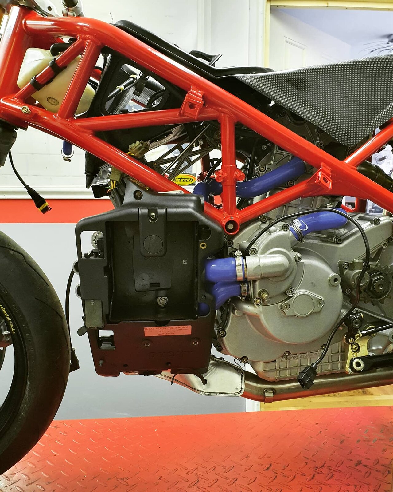

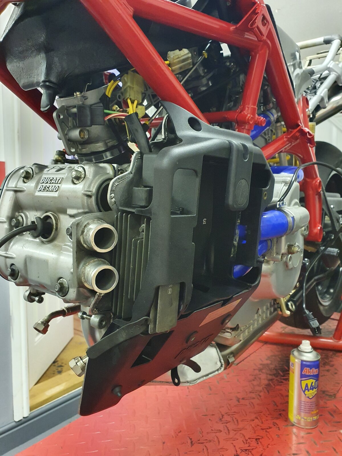

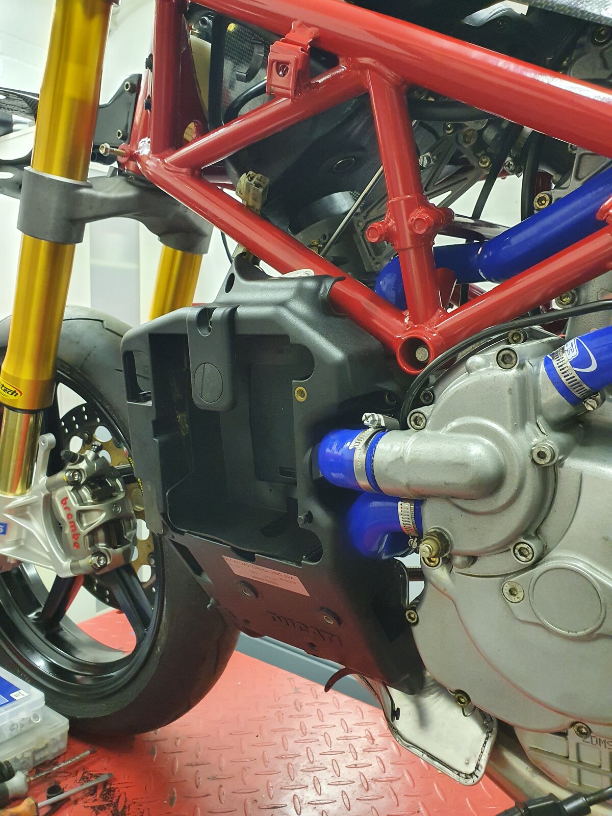

  12. Had a 999 battery tray delivered from Kev Moose off the forum. Must say, great quality used item with very swift delivery.
    I'd like to see if I can run lights & indicators, so fitted the whole tray (helps having a 999 thermostat housing) Just waiting on some 28mm frame brackets to secure the top of the tray.
    If I cant run lights etc, I'll cut the 999 battery tray down, relocate the reg rec to the right of the bike and run a Corse water union inc pipe work and run the bike with a daytime MOT only.

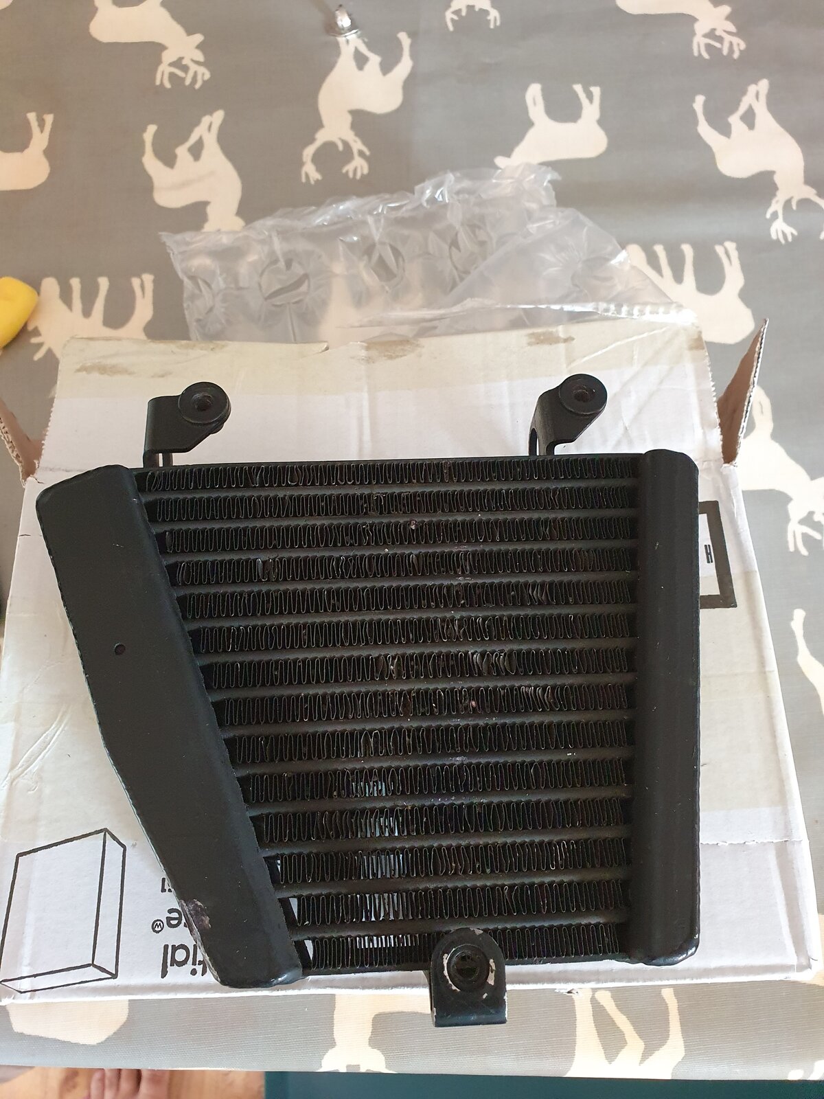

    Had a new oil cooler delivered too. The cooler that came with the bike didn't fit and was cable tied to the mounting points. After closer inspection, the original cooler was from a KTM:thinkingface:

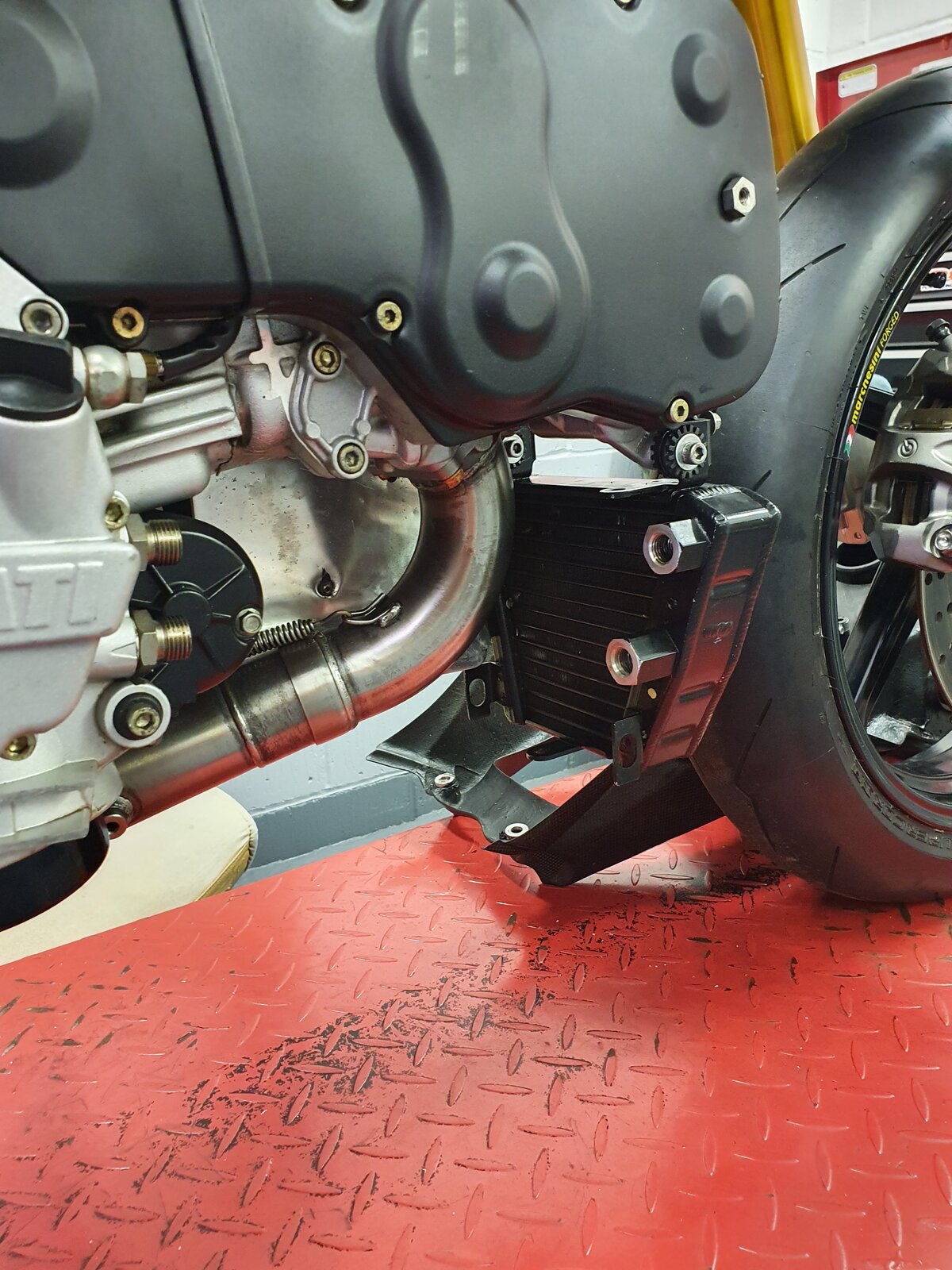

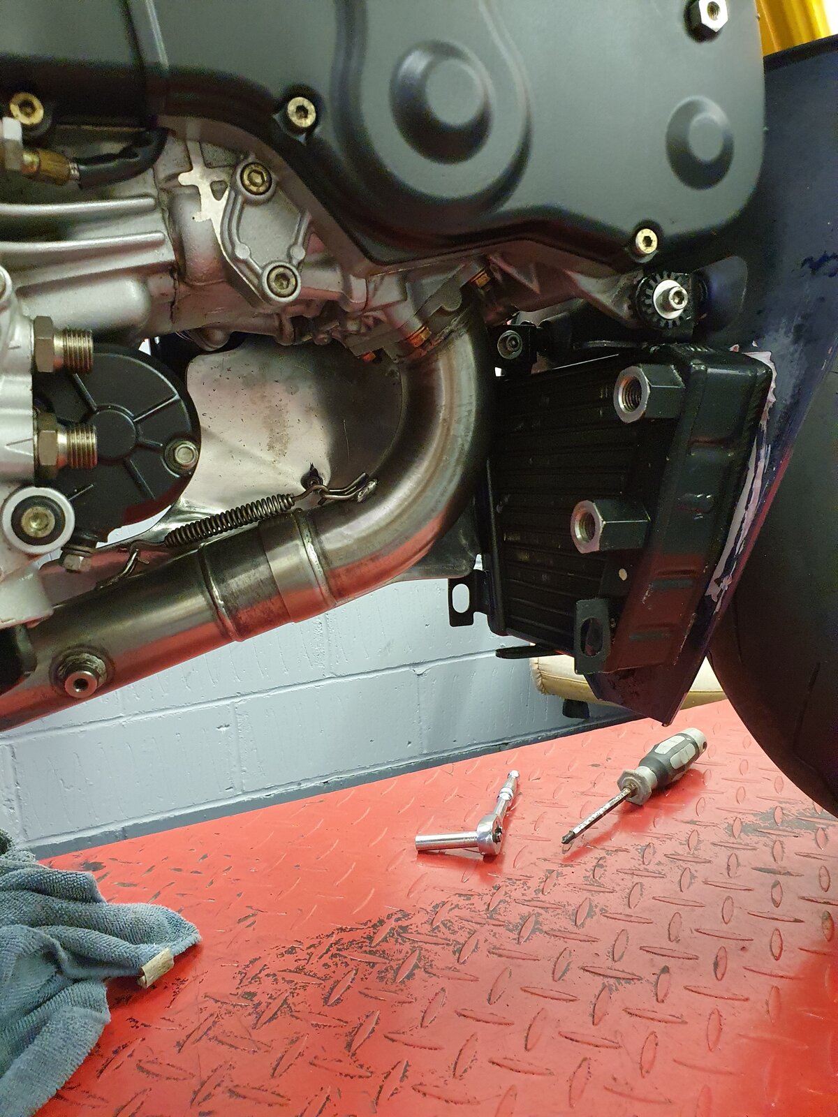

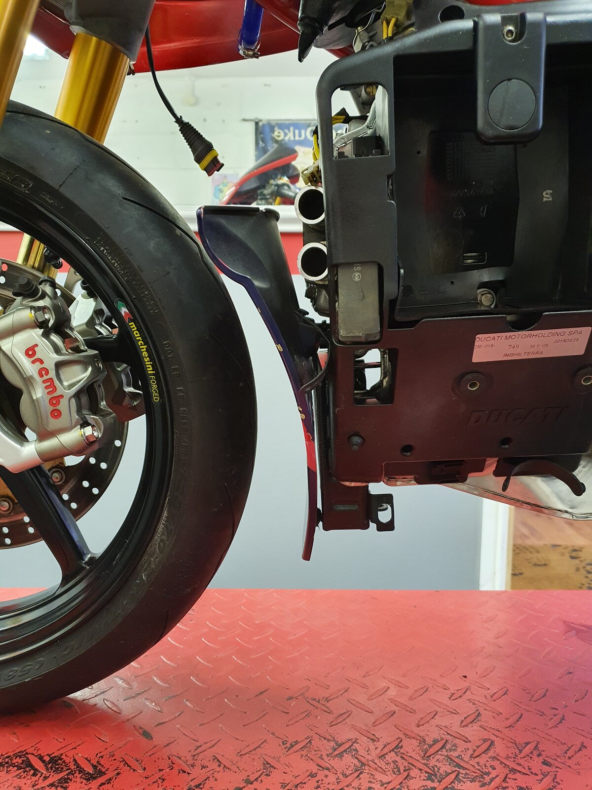

  17. Fitted the 999 oil cooler up today. And test fitted the left hand fairing and v piece. Got the old panels out and offered them up. The air scoop fouls the 999 battery tray, but not by much. I think 998 fairings, minus the air scoop will fit nicely.

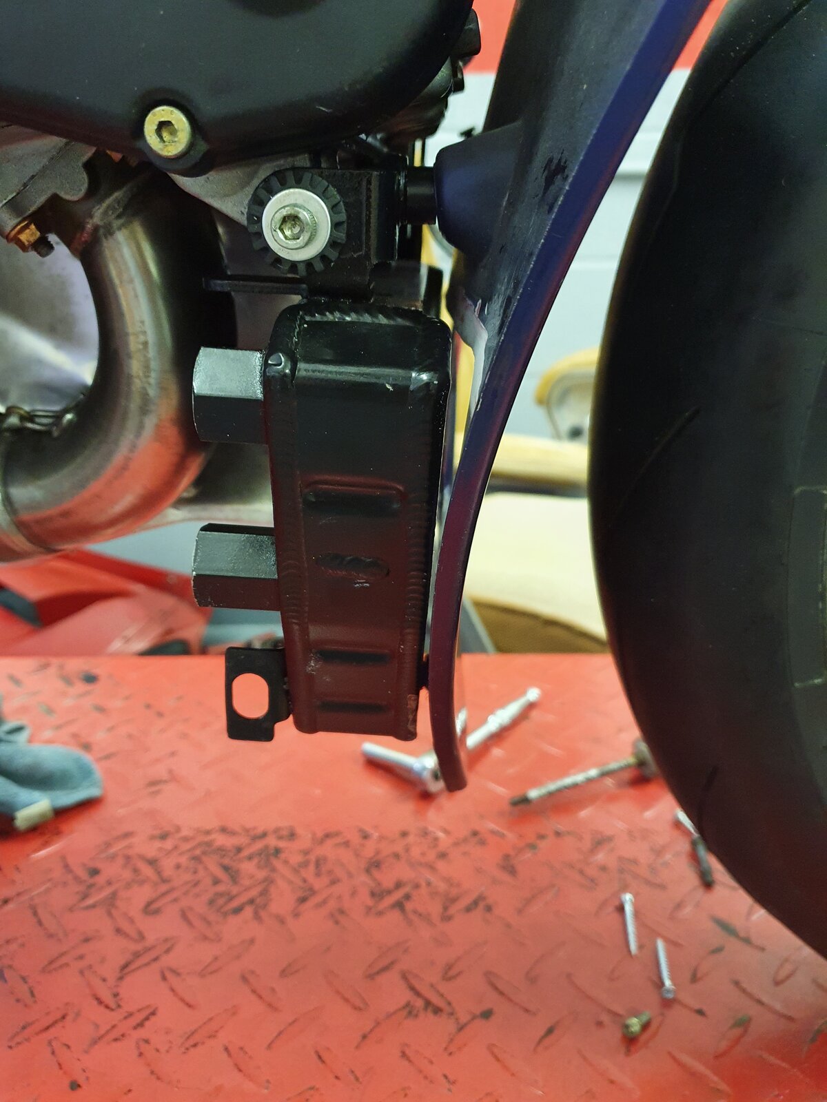

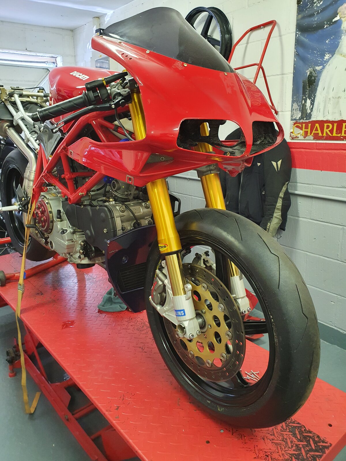

  18. Offered all the fairings up and fitted the V piece. Had to space the V piece out at three points and trim the aperture. Its tight, but fits well.
    20200508_162610.jpg 20200508_162547.jpg 20200508_160807.jpg 20200508_160743.jpg

  19. I’d move the oil cooler back by making a new mounting bracket ... because
    Measure the rearmost part of the front tyre up at the same angle of the forks same travel of the forks what 120mm... make sure you don’t touch front wheel to v piece!
