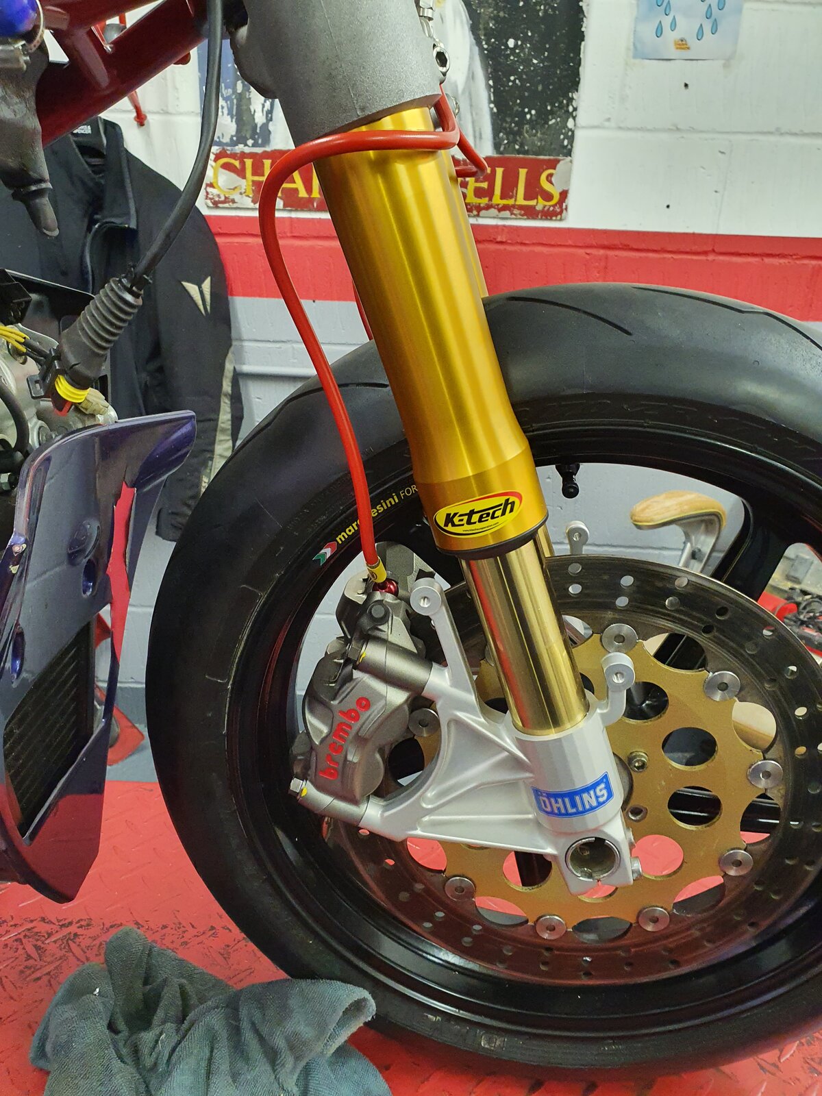

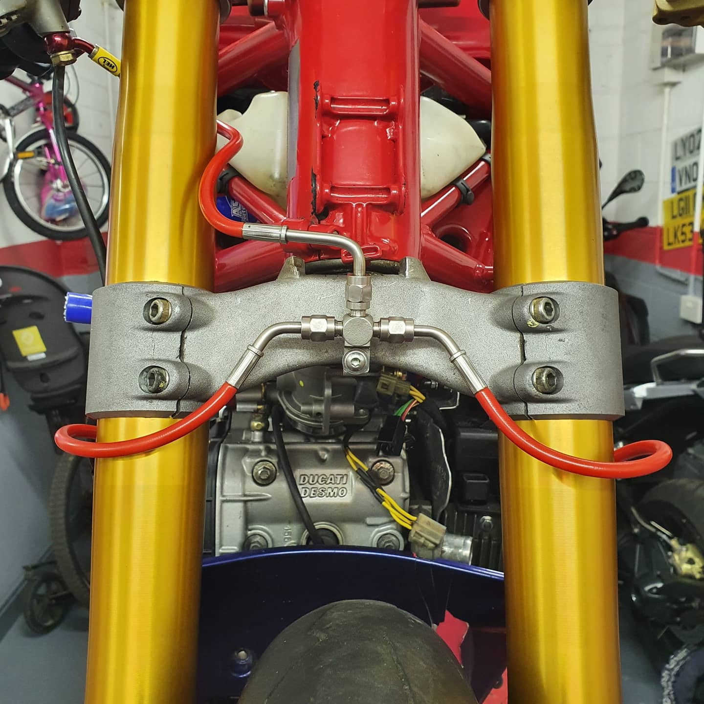

  9. Fitted some HEL braided brake lines and splitter this afternoon. Big thanks to Bettes for the parts. Really happy with them.
    #289 Russell, May 13, 2020
  10. I see the frame lock stop has been involved in an incident of some kind.
    Out of interest - why go for a splitter rather than twin full lines?
  11. Yep, the previous owner hit a wheelie bin when out one evening, coming back from Boxhill back in 2004.
    Rubbish went everywhere!!! :joy::joy:
    @RickyX No real reason re: Splitter. Bettes offered them to me and I needed some lines, so just took what he had. Does keep it nice and neat though.
