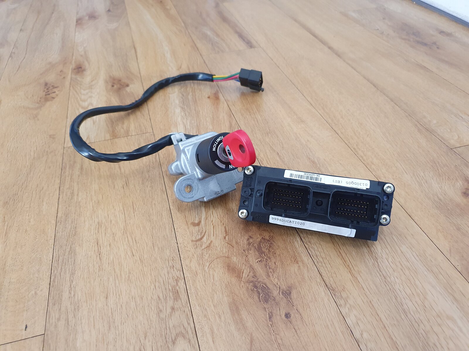

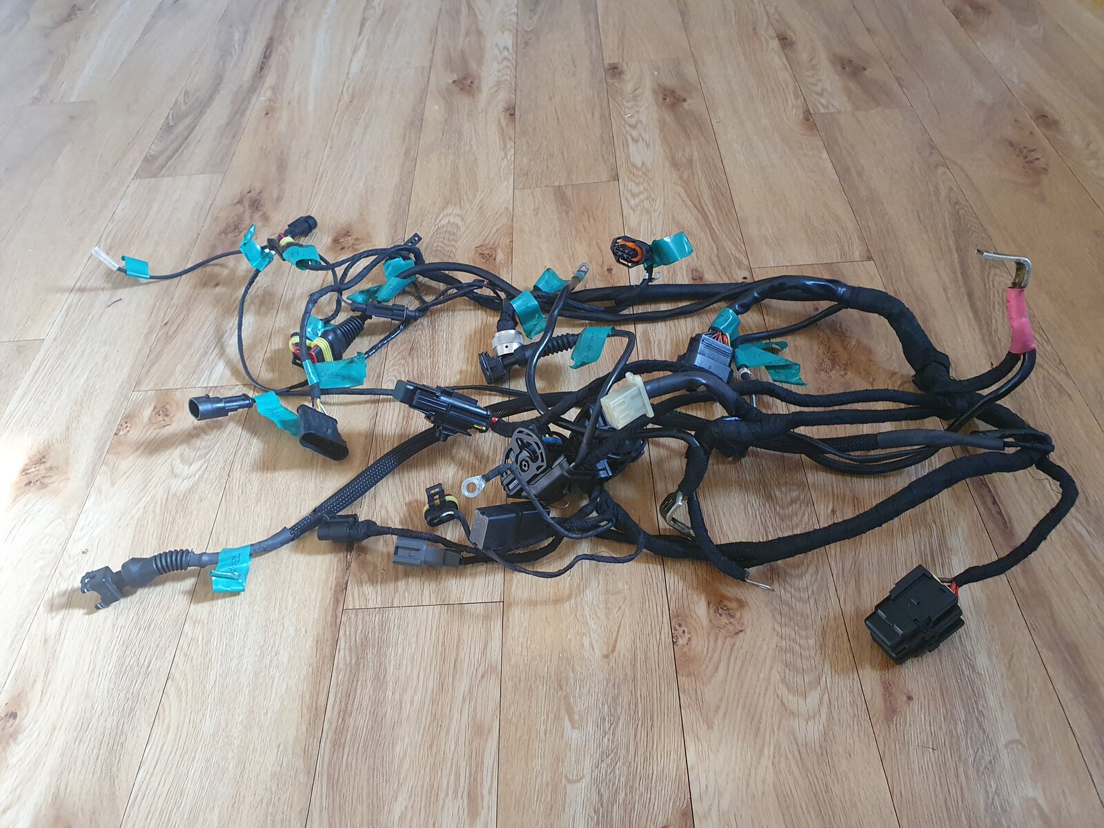

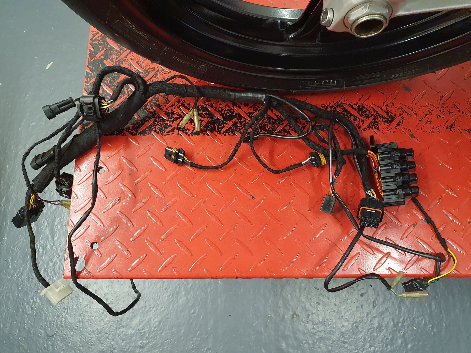

  12. Picked up a 749/999 loom yesterday. Big thanks to @RickyX for looking after me on price ;):upyeah:
    ECU/ignition barrel/Red key turned up yesterday too. ECU is being sent off today for flashing/unlocking. The bike is hopfully only a few parts away from being started.
  13. Once the ecu is decoded, you can run the bike without a dash connected
  14. Can you?? Did not know that!

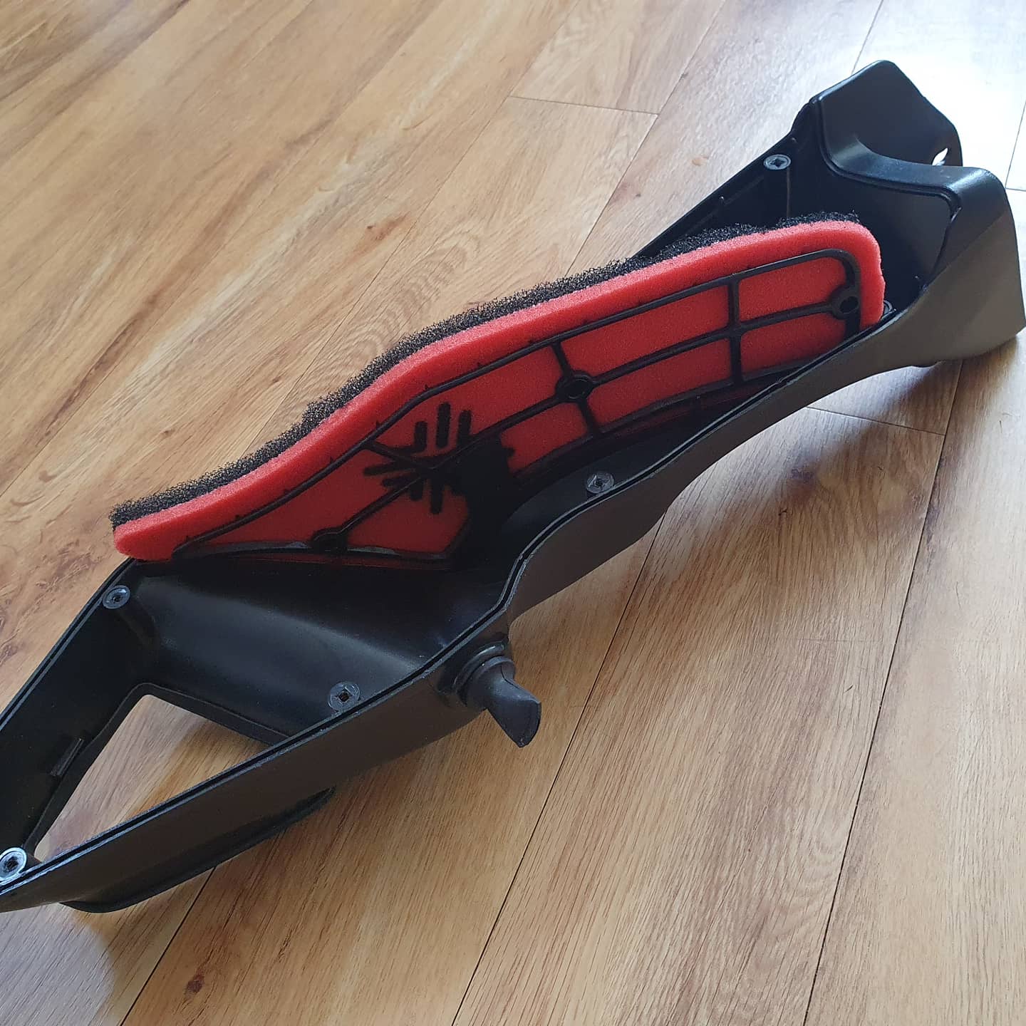

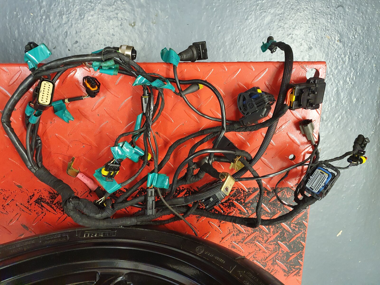

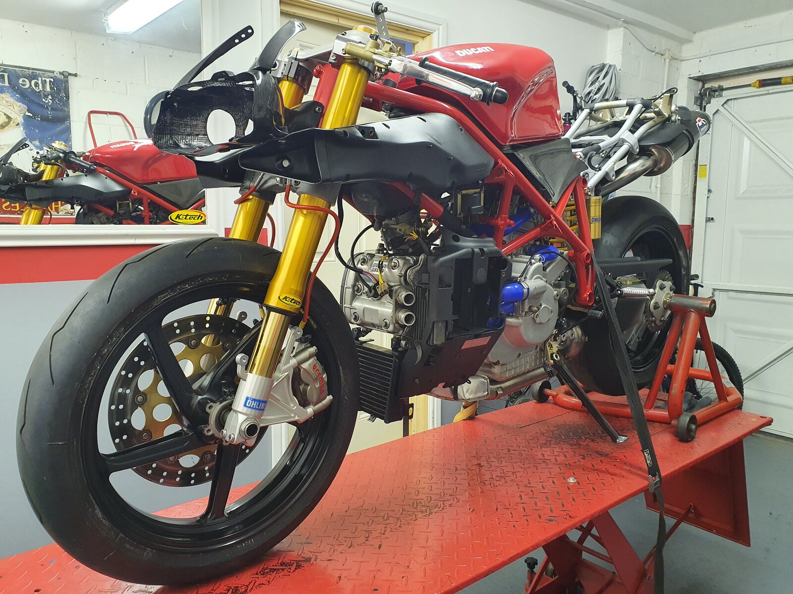

  15. Had a few parts delivered yesterday, so spent some time on the bike. Cleaned and fitted new Pipercross filters to the air tubes, fitted all the factory fixings for mounting oil cooler. Stripped back all the old tired wrapping from the looms, cleaned, checked and re-wrapped. Ordered some oil lines for the oil cooler and also some RH switch gear.
    It's starting to take shape nicely. I wanted to get the bike started by next Spring, but I think it'll be the end of this Summer. May even have it rideable.
    Thanks again for everyone's help. It's been invaluable :grinning::upyeah:

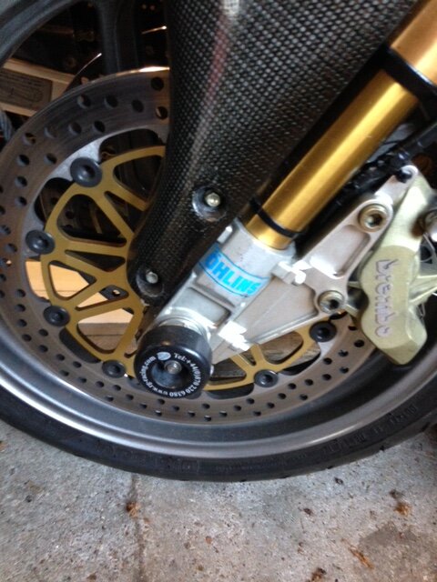

  16. @Russell give mode performance a call.
    They have a few sets of the 12.5 (15mm) offset disc carriers and they'll make up a set for you.
    Damn, I wish I knew there was a 998 loom up for grabs! I'm looking to use one on the 916 so that I don't have to junk the corse oil tank. - nice find. :)
  17. It's a 999 loom
  18. I settled for a 999 loom in the end. Trying to find a 998 loom proved almost impossible. Had to change a few things, but wasn't too much hassle.
    Thanks, I'll check out mode performance.
  19. I know they were using non brembo made carriers with brembo rotors.
