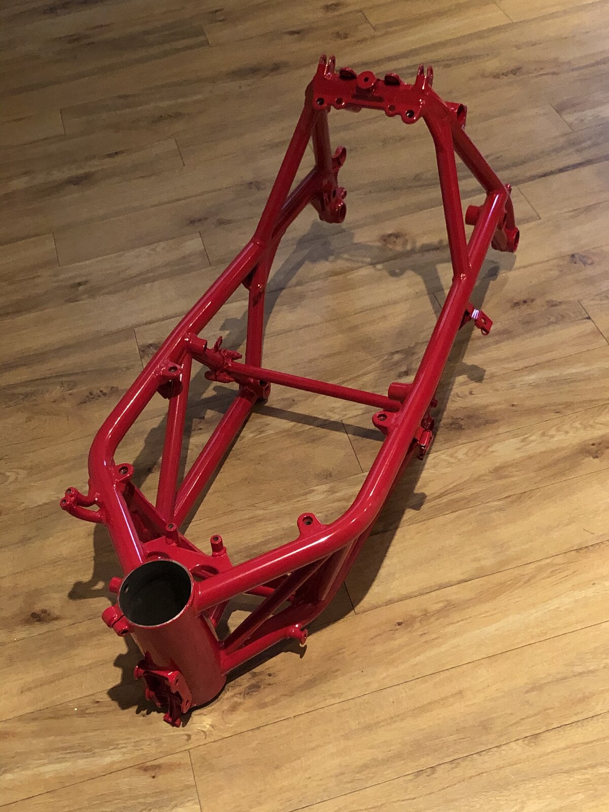

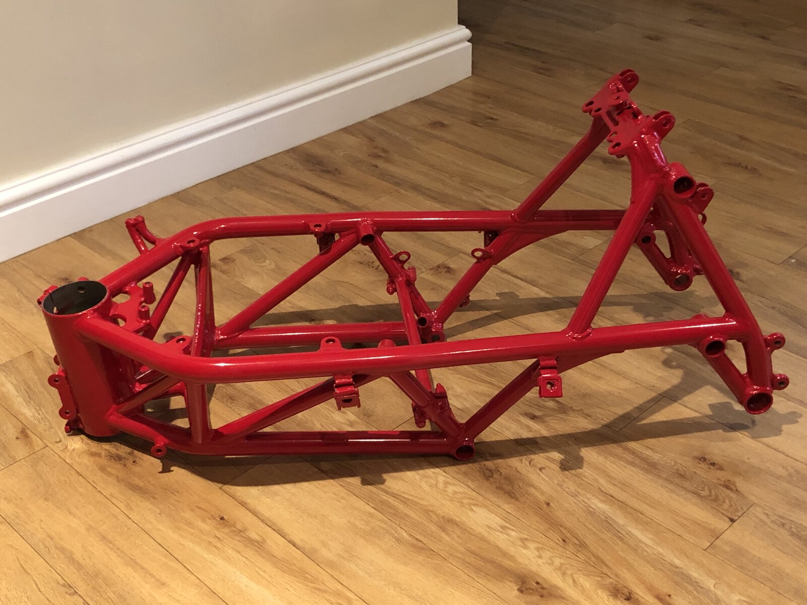

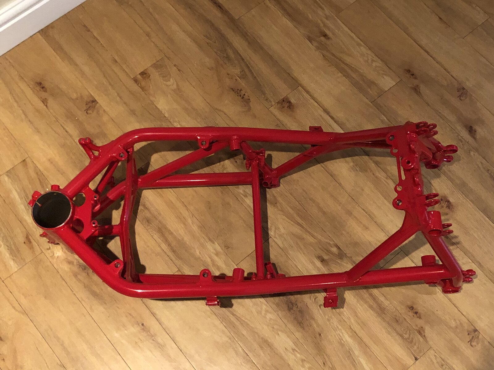

  3. Picked the frame up today. Looks fantastic. over the moon with the final finish. Was a little concerned when I heard the RAL code I chose can come out a little orange, however this has come out perfectly. Looking forward to getting the thing back together. Dropped the wheels off when picking the frame up. Wheels are going Satin Black :):upyeah:

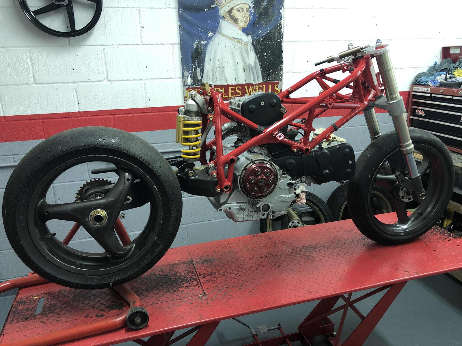

  5. Pulled my finger out this afternoon/evening. I’m back to a rolling chassis.
    Can start with a few little odds and ends over the next few weeks, whilst I’m waiting for the wheels to be done. Still not sure whether to fit the 748 loom back in or keep looking for a 998/999 loom. Been told I can use the 748 loom to run the 999 engine, but I still need some clarification from a professional (absolutely not me :joy:)
  6. 999 or 749 loom probably your best bet, I searched for a 998 and they are rare which when they do show means £££.
    People run the 1098 etc conversions on the old 16m ecus so that is a option but you don't have coil mounts anymore.
  7.

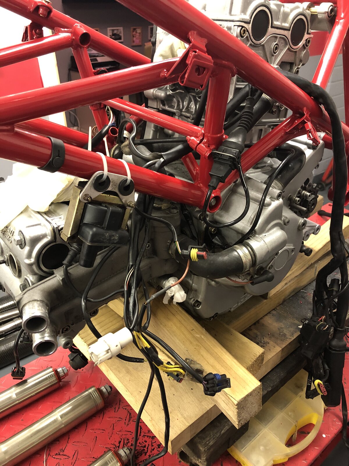

  8. Thanks Jon. I’ve got the coils cable ties to the frame, unless we weld tabs, that’s the best I can do.
    So I could use the existing loom and re-map the ecu? Ideally I’d like to keep the original loom, only because it’s all in the right place. I’d imagine a 749/999 loom would need some modifications etc

  10. Where were the coils originally mounted Russel? My 748 has mounting points for them on the cross member just ahead of the vertical cylinder. I’m just wondering why yours doesn’t:thinkingface:
  11. Pretty sure they were attached to the cross member that was taken out to accommodate the 998 air box. If I had a welder, I’d of added some :worried:
    Again, thanks for all the comments and interest :upyeah::)
  12. Has losing that cross member made any noticeable difference to the handling or any discernible frame flex? I know the 748Rs had a revised cross member to accommodate a larger airbox but to remove one completely:thinkingface:. Just curious.
  13. There are many different types of tube clamps that will help mount your coils - this one is the first I found in the USA but plenty of different types in varying tube sizes available... you would also be able to mount a frame brace too if you wished...
    https://house-tuning.com/collection...ght-bar-holder-tube-clamp-for-light-bar-whips
