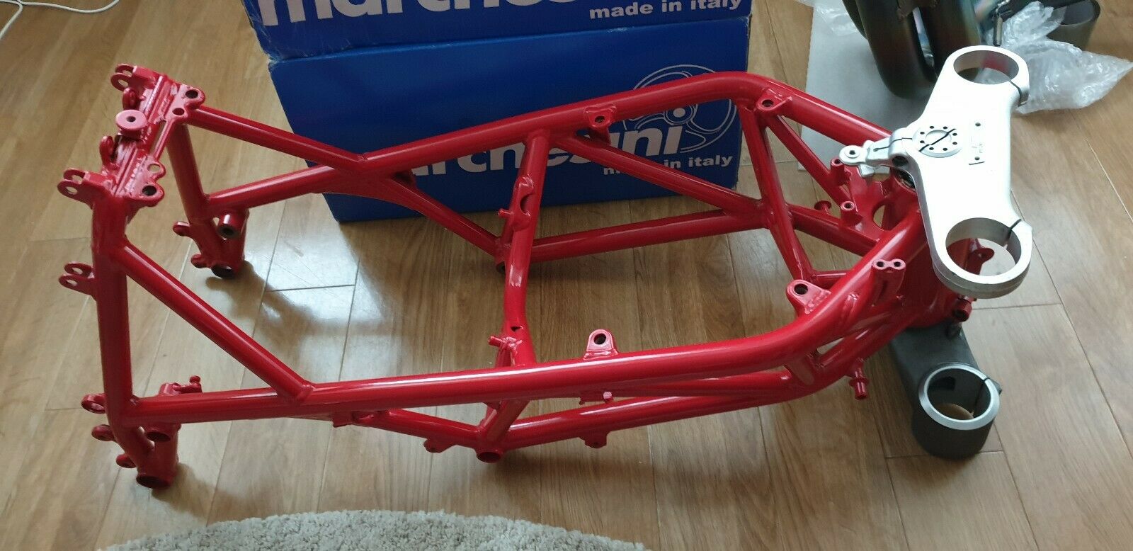

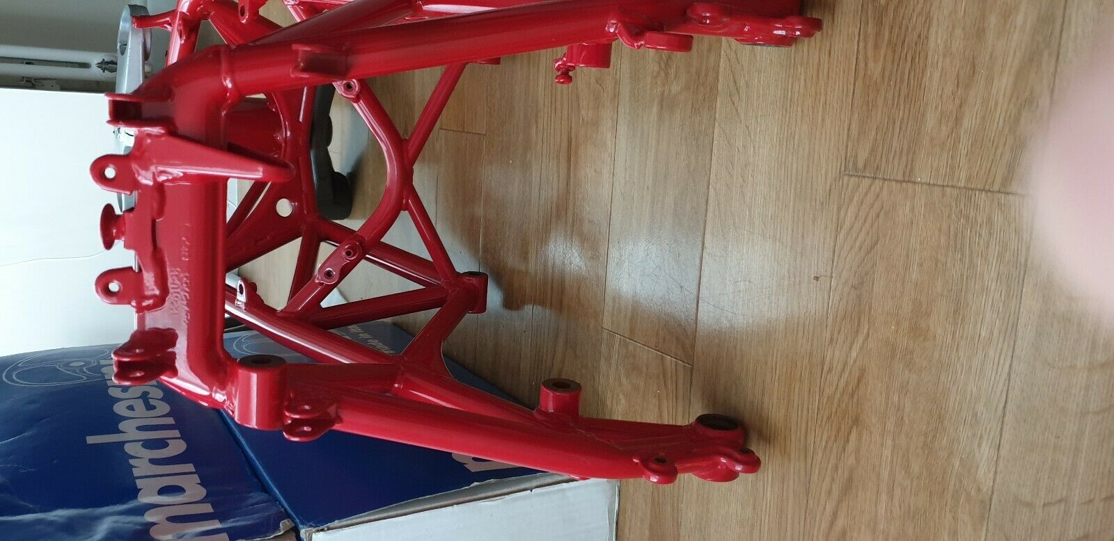

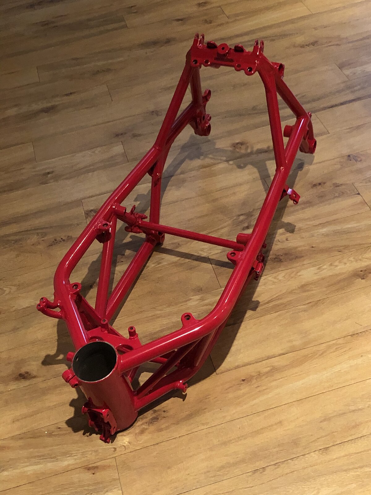

  1. If you're putting it on the road a 998 loom would be the best way to go as you could use 998 throttle bodies which use the old tps and all the wiring for lights is in the same position so there'd be no messing about then, problem is finding one. Otherwise it may be easier to stick with the 1.6m loom but you'll need to sort out the chip, probably still use the 998 throttle bodies for the tps.

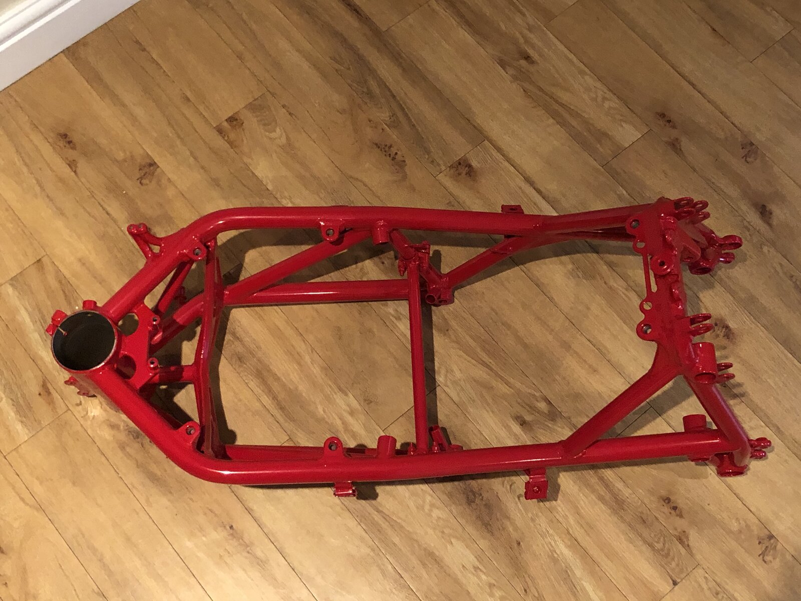

  2. Ahh I see. Mines braced in exactly the same place... Pretty much. CAE3C739-5829-4523-9E15-01B44A2738CF.jpeg BCC06B6C-D72B-4B65-B08F-345B4F951580.jpeg

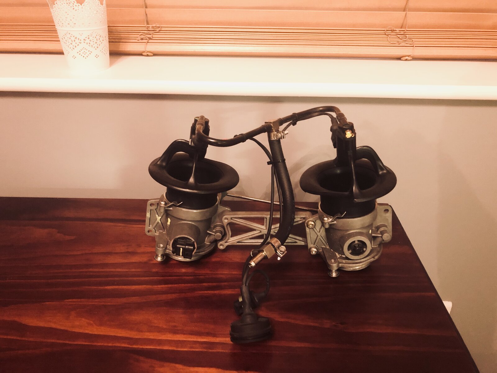

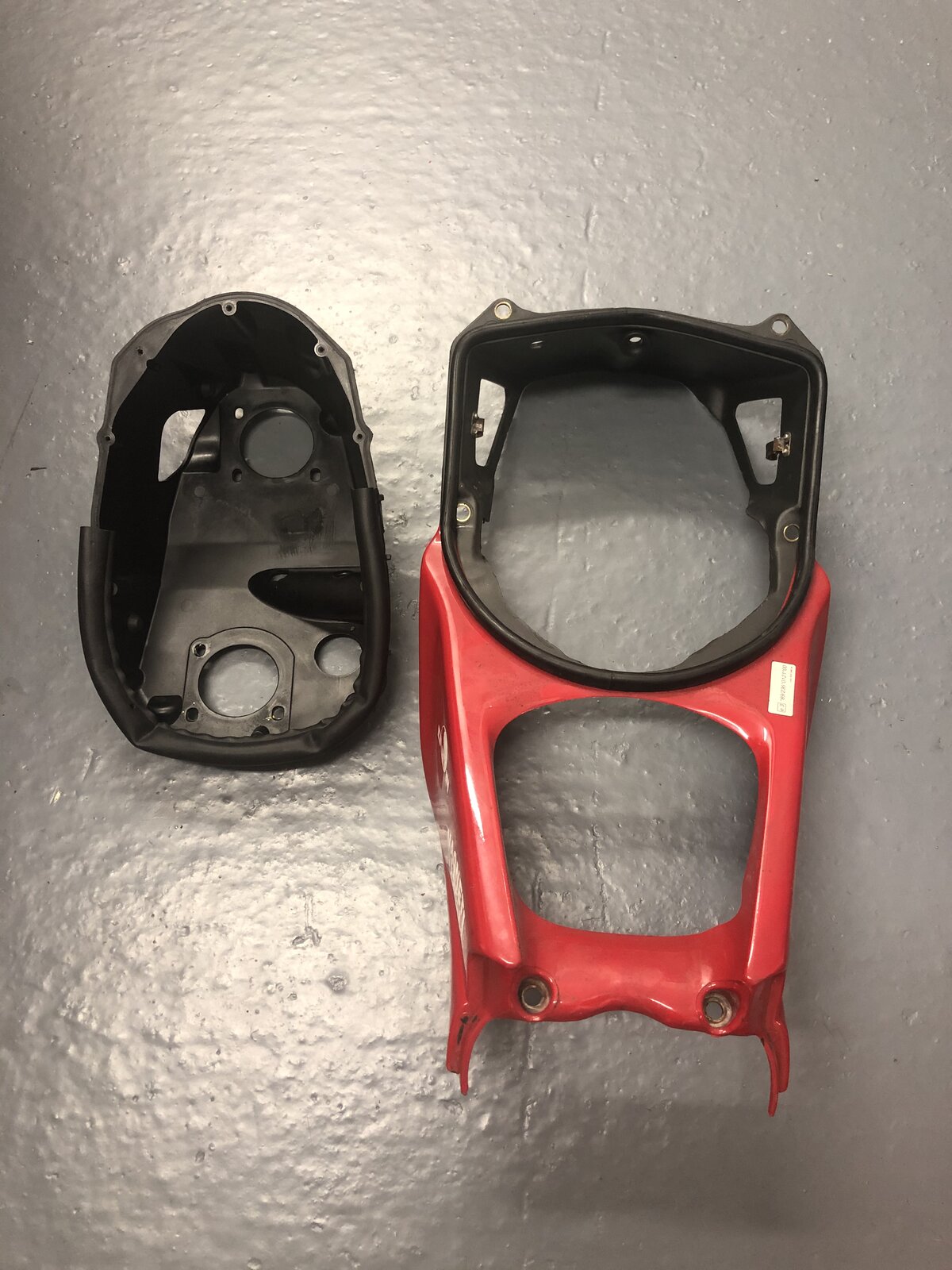

  6. Spent some time in the garage this morning, having a good look at the 998 air box and throttle bodies. Looks like the air box isn’t a 998 box, but some kind of bastardised thing, which obviously didn’t seal properly at all. It could be the cause of the flat spot in the Rev range. Not too sure.
    I need to speak to the guy who originally did the conversion and ask why that air box was used. Ideally I’d like to replace with a carbon one, however I now need to know which one to purchase :confounded:
    Removed the throttle bodies. If anyone can clarify that these are 998 throttle bodies, that would be great. Currently sitting on my office desk as a bit of an ornament :joy:
    #106 Russell, Nov 17, 2019
  7. 999 throttles
  8. Brilliant. Thanks Jon. I’m guessing the air box must be a mix of 999 and 748.
  9. Looks like someone has cut the bottom of a 748-9xx one and then used the 999 bottom rather than just getting a 998 one.
  10. Though that could be the case. I’ll pick up a 998 air box. I’m hoping the 999 throttle bodies will fit.
  11. Probably used what he could get his hands on at the time. Still a good basis for completing the build properly.
  12. Think you’re right. When the conversion was started, not may people had done it. I think a lot of it was guess work if I’m being honest.

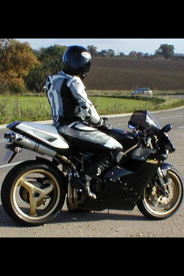

  13. I’m glad my wheels have found a good home :upyeah:
    Not sure red on red works tbh. A black bike with red wheels and vice versa looks awesome though.
    Red bike plus gold wheels looks great, but I don’t think you can beat a black bike with gold wheels, like the JPS F1 cars livery.

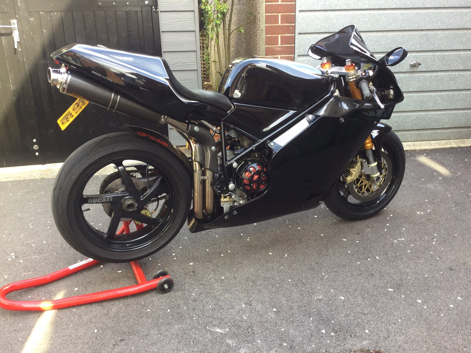

  14. Naaah...black on black (cue gratuitous shot of my old bitsa)
    6CB56BFC-2BA9-4B9B-B0B7-AA1258E1E105.jpeg [
  15. Dropped the wheels off at the powder coasters on Friday. Being done satin black
  16. That looks great :upyeah: What’s the spec?
  17. Cool. As someone else commented, black wheels go with almost everything
  18. I think they’ll compliment the red frame and blend with the carbon bits I have planned :upyeah::)
  19. 916SPS spec motor/P8 ecu and injectors Arrow 50mm system.
    DP slipper
    Magnesium Marchesini’s
    P4 calipers and HPK discs
    Maxton internals in fake Ohlins forks. Ohlins shock and steering damper
    Slab side race Fairings with single projector light and teeny-weeny LED rear light.
    Smattering of carbon in the usual places.
    DP rearsets.
    Other stuff that I have forgotten probably.
    Chucked me over the bars at 100ish at Brands in 2009 but crashed really well to end up as above.
    Sold it waaaay too cheap a couple of years ago...:joy::tired_face:
