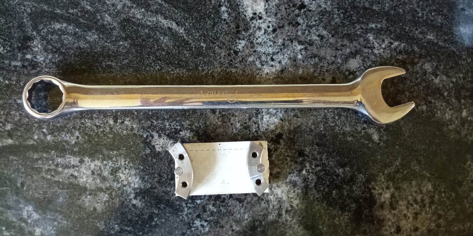

hi team. i decided to give doing my own belts a bash. watched a few vids and im away. except i had no 22mm spanner so ive just bought 2 from halfords with slightly different offsets. neither fit right and the open ender aint worth a wan.... am i missing something? do i need to get the grinder out to modify spanner? also the 12mm nut will turn along side the 22 without holding the 22mm adjusting nut, does this mean the stud is lose in the engine casing or is that normal?

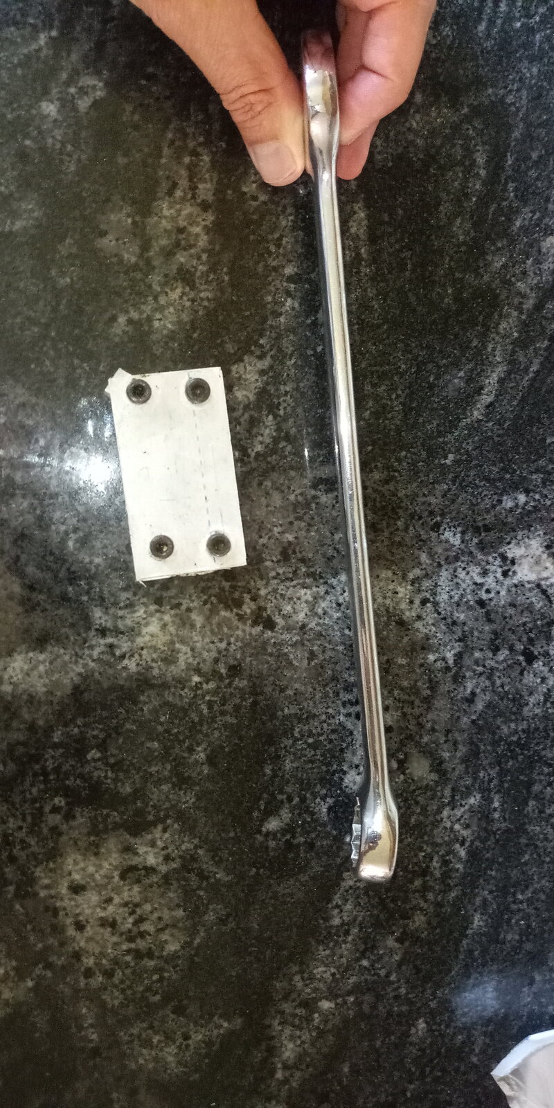

spanner loox about the same degree as mine. anyhu mine wasnt seating right so i ground some of the bac out and it has done the job. but i have managed to losen the studs! what now? remove loctite and reinstall?
I used a 22mm box spanner that I cut down with a hacksaw so it fits in the gap between the adjuster and frame tube. Then I used an adjustable wrench to hold the box spanner. The 12mm nut was tightened through the short box spanner. Cheap but effective.
