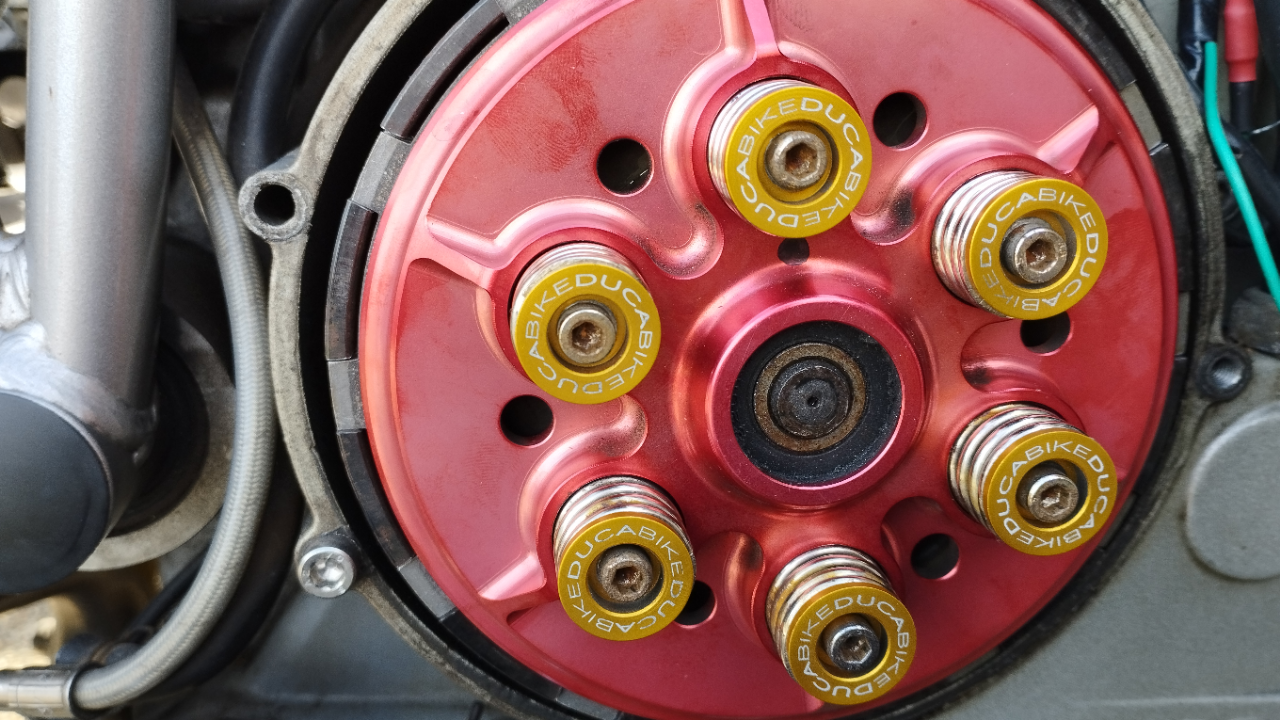

    new here, just got myself a 748, the clutch drags a little and its difficult to get into neutral. i've checked the clutch stack, its 38.5. i'm only seeing 1.45-1.50 mm of clutch lift measured at the pressure plate springs. this seems like its not quite enough?
    its got an oberon slave cylinder, the correct length push rod, i've bleed it several times, including at the banjo at the master cylinder. I've also removed the master cylinder from the bars, and tipped it to allow any bubbles exit etc. no leaks or loss of pressure overnight.

  7. You are right, 1.5mm is on the low side, but can be enough depending on plates. You only need 2mm generally.
    with clutch cover off, and hand lever pulled in, can you detect play when you grab one of the clutch plate tangs and wiggle it - e.g. - can you make it "jangle"? This can give a clue as to whether you have enough travel for adequate disengagement. Without going through the usual suspects, just a long shot - have you tried testing with clutch cover off? If you have std steel cover but haven't also fitted the std rubber "gasket" then this can produce your symptoms.
  8. it almost jangles, it does if i rotate the pressure plate backwards and forwards, but if i try to spin it, it stops as soon as i stop apply force.

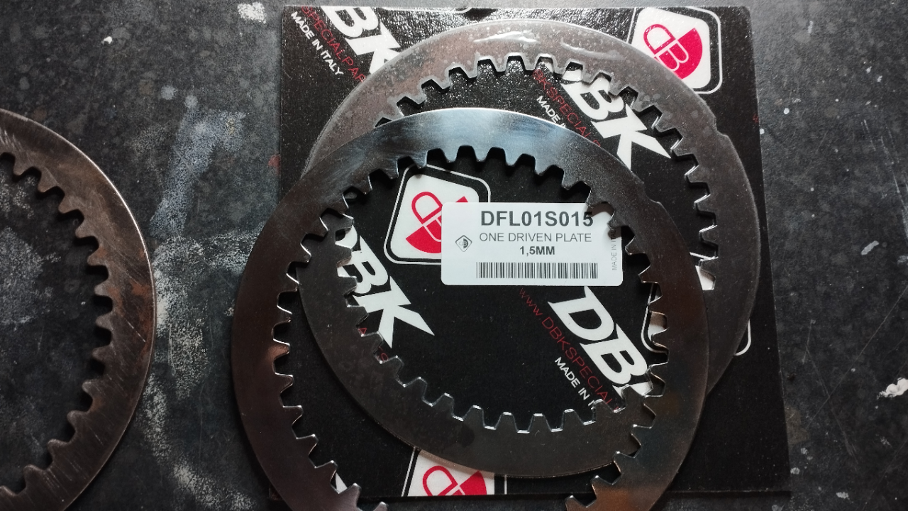

  13. thanks guys, this is very helpful, i'll play with the stack height and let you how i get on. if i want some 1.5mm plates, is there a good UK source for these
    cheers
  14. I found some on ebay but, otherwise Ducati dealers can supply them.
  15. to close this out, and to thank those that gave advice.
    original problem was on a newly bought bike that had been stood for a good few months it was hard to get into neutral with the motor running. It was improved by restacking the clutch, and giving the drive plates a good clean and a bit of a polish, but it was still not perfect. after lots of clutch bleeding and staring at the Oberon slave cylinder i was no further forward.
    After getting advice here it seemed the 1.5mm of clutch lift was about right, so i looked at the clutch stack again. Swapping 2 of the drive plates from 2mm to 1.5 has brought the stack height down from 38.5 to 37.6. now it all seems to work normally, with just the slightest bit of freeness when you spin it by hand. The free float of the lever at the very end is about 11-13mm, and it feels great when trying it out on the drive way. just need to get a dry day to get it hot and give it the beans.
