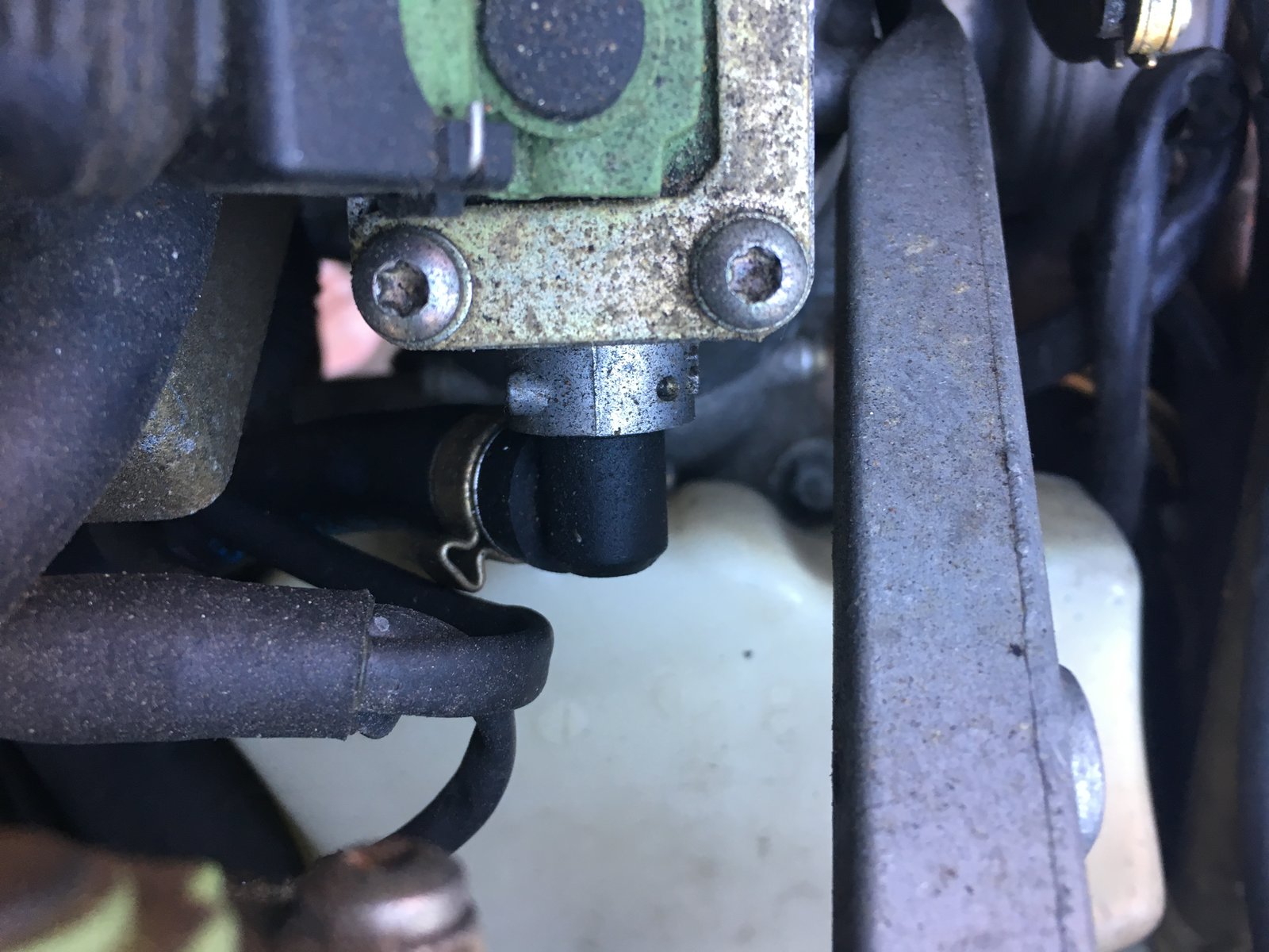

  1. Hi all, thought I’d go out for a quiet ride while the football was on, fired her up and peeing out petrol. ( smelled a bit last nights ride)
    One of the fuel lines has split... meh
    How do you get the line clip off the injector ? And what to use as replacement/where from ?
    Ta
  2. Double ear clamps. I cut through one of the ears using snips or a hacksaw. Replacements are cheap on eBay (to suit pipe diameter). There is a proper tool to tighten the ears but I use a pair of pincers.

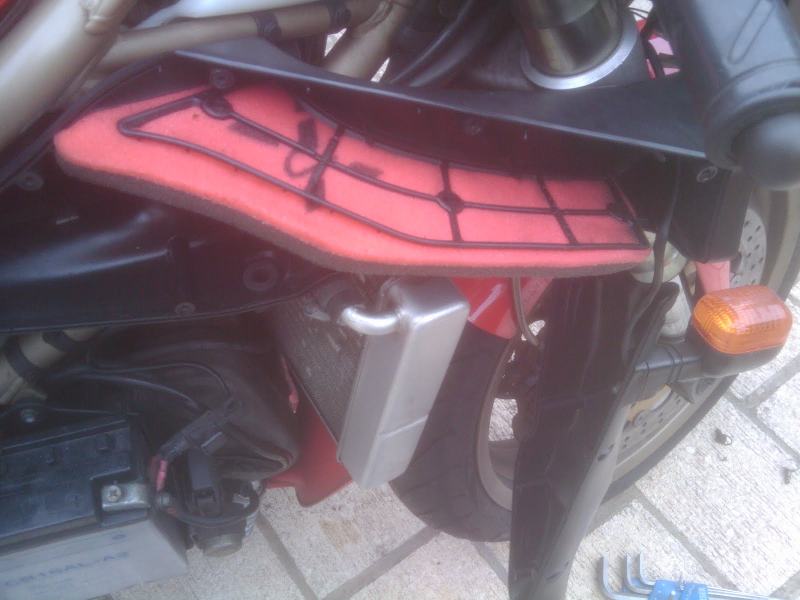

  6. Anyone got any pics of their air filters ? Mine doesn’t seem to have any
  7. You should have something like this.
  8. Cheers will have a look tomorrow. what do you reckon to the piper cross ones that go under the tank?
  9. Some say they are not as efficient, upgrade the standard ones with pipercross replacements, others will have different opinions though.

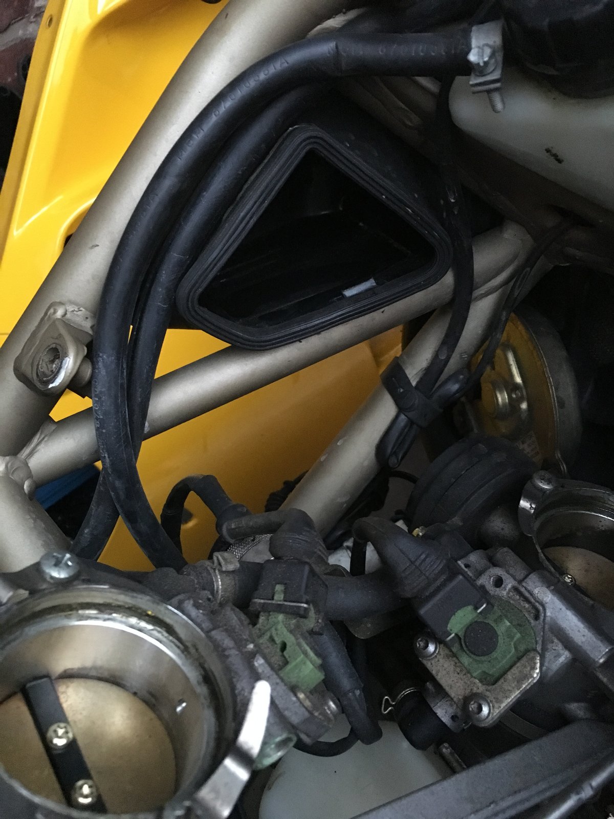

    Steve
  10. Where's your two bell mouths:thinkingface:
  11. Took them off to take the air box off ?
    Btw, one has a rubber o ring and the other doesn’t, clumbsy service at some point ?

  13. answered my own question, sawn the clip off, jubilee clip to follow as soon as I get a pipe!
    edit; got the pipe from a motor factors, its 5/16ths or 7.5mm if anyone needs one and for some obscure reason its marked on the pipe as 8mm. To be honest 8mm would be far easier to fit, 7.5mm is a pig to push on under the tank!
