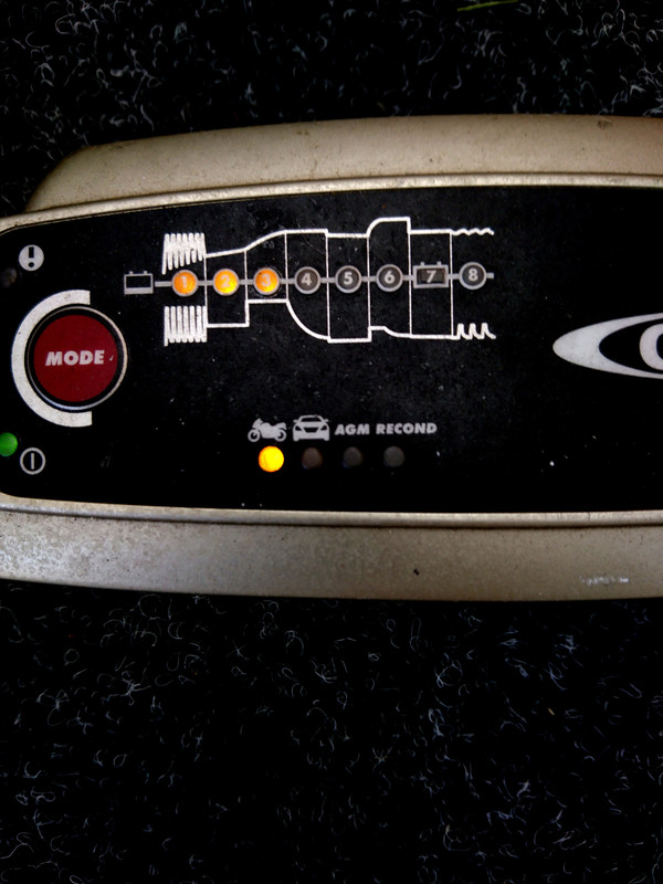

  1. After 14 hours on the Cteck now at level 3 charge. Not looking too good.
