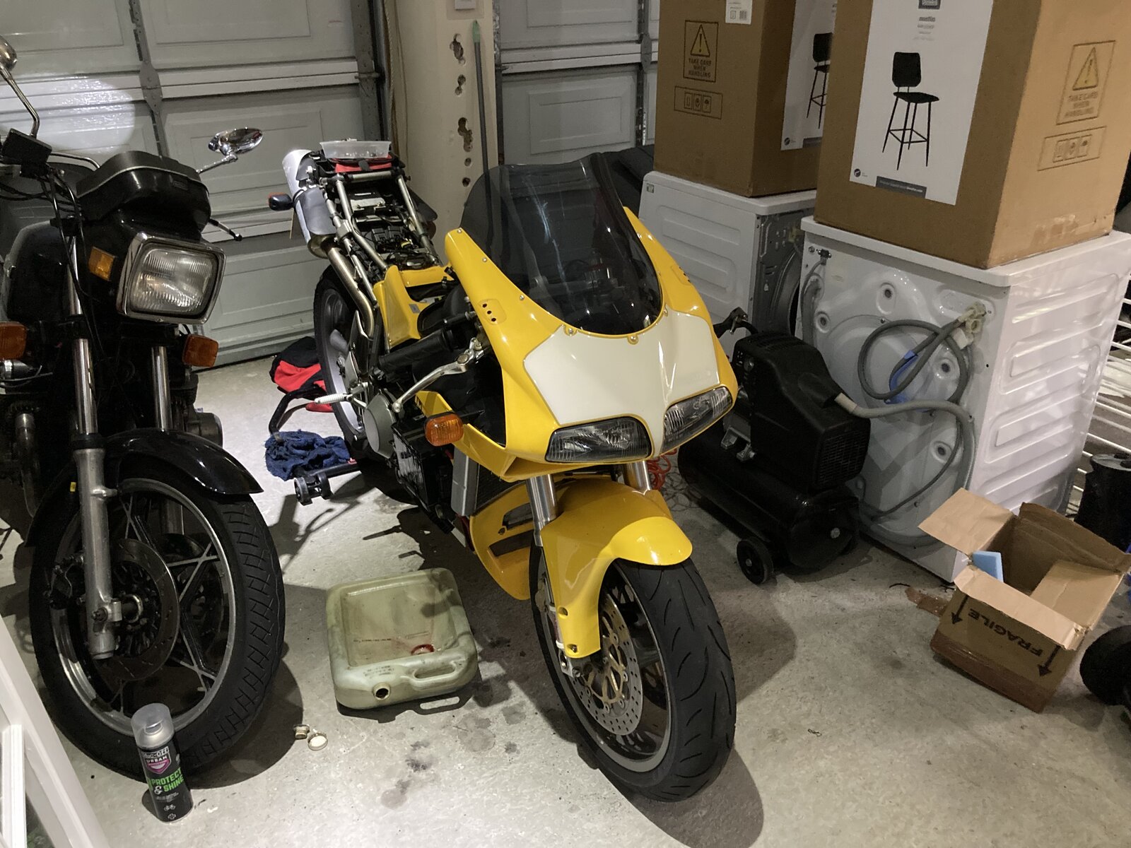

    Bike was due a service, including the belts, I'd normally do it all myself but with the oil weep needing attention I thought I'd tackle all the standard bits myself and leave the weep, belts and valve clearances to the garage, more on that later.

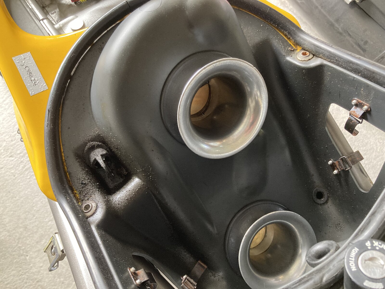

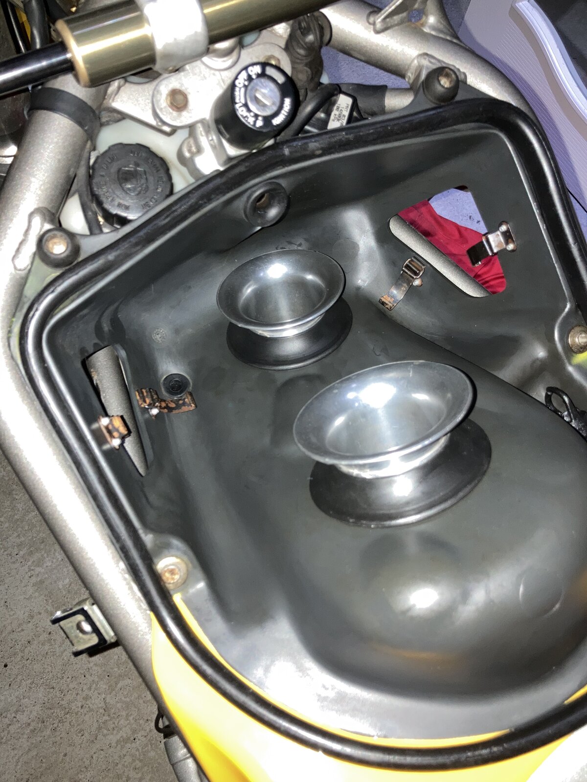

    I'll be honest I've not been the kindest to the bike during my ownership and under the fairings it was looking decidedly grubby so first on the list was to give everything a good clean down. It's well serviced and gets a good external wash fairly regularly but it's not had a deep clean in a long time. Fairings off and tank removed and drained the first thing I noticed was how filthy the airbox was. Seemed to be a combination of oil reside and fine sand, I'm hoping the oil got a hold of most of the sand! Cleaned it all down and replaced the airbox seal as it was looking decidedly second hand. As I was going over things I noticed that the fuel feed pipe between the tank and the injectors was looking worse for wear so that got replaced. I then cracked into the tank to replace the fuel filter and check over the pump and hoses. I was amazed at how clean the tank is for a 21 year old bike! All the hoses and the rest of the assembly were in great condition but the fuel filter was stamped as 2008 so it definitely needed doing. On reassembly I was a bit baffled by the gap between the pump flange and the tank but as you may have seen from my other thread 'they all do that sir'.

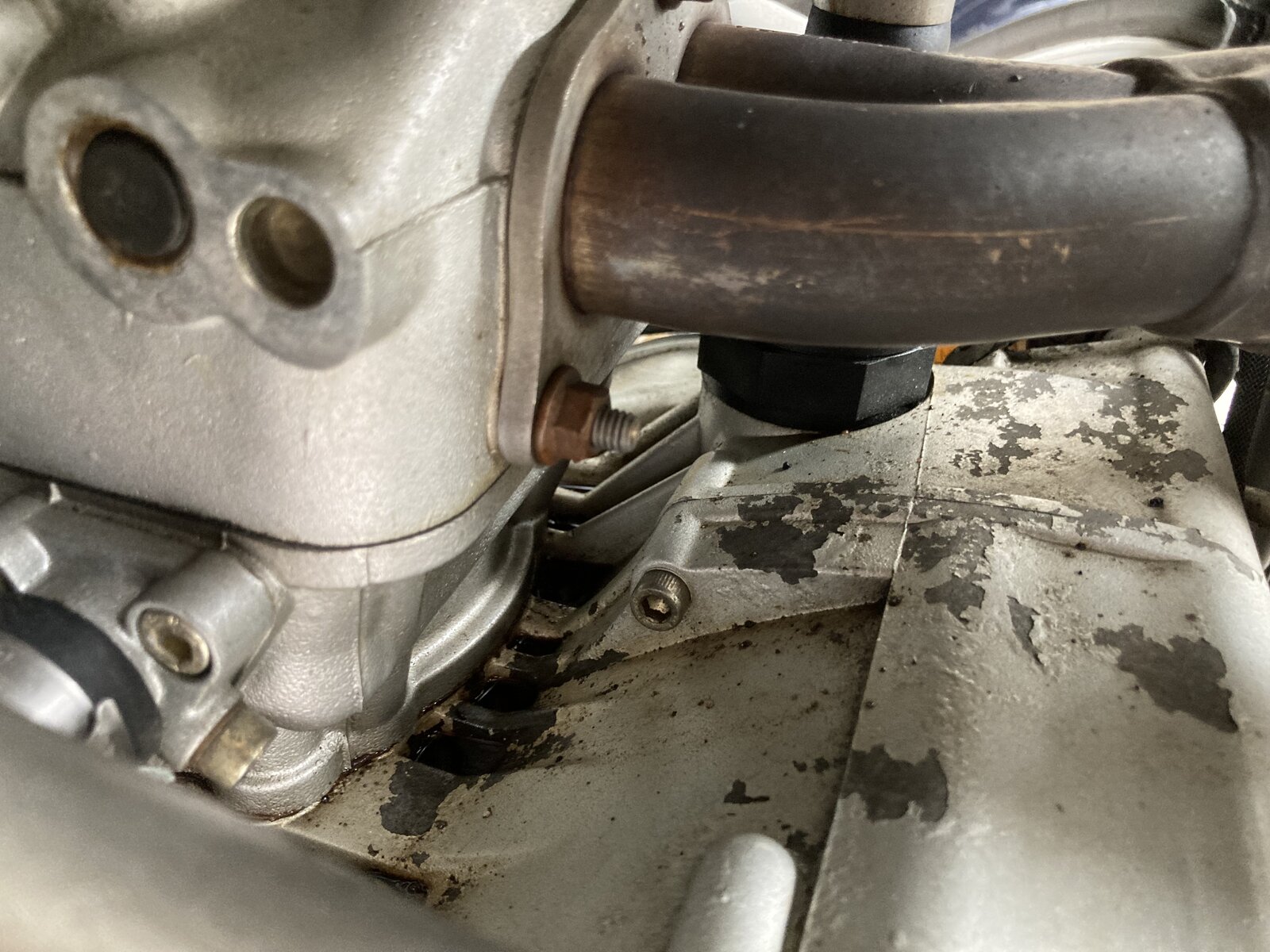

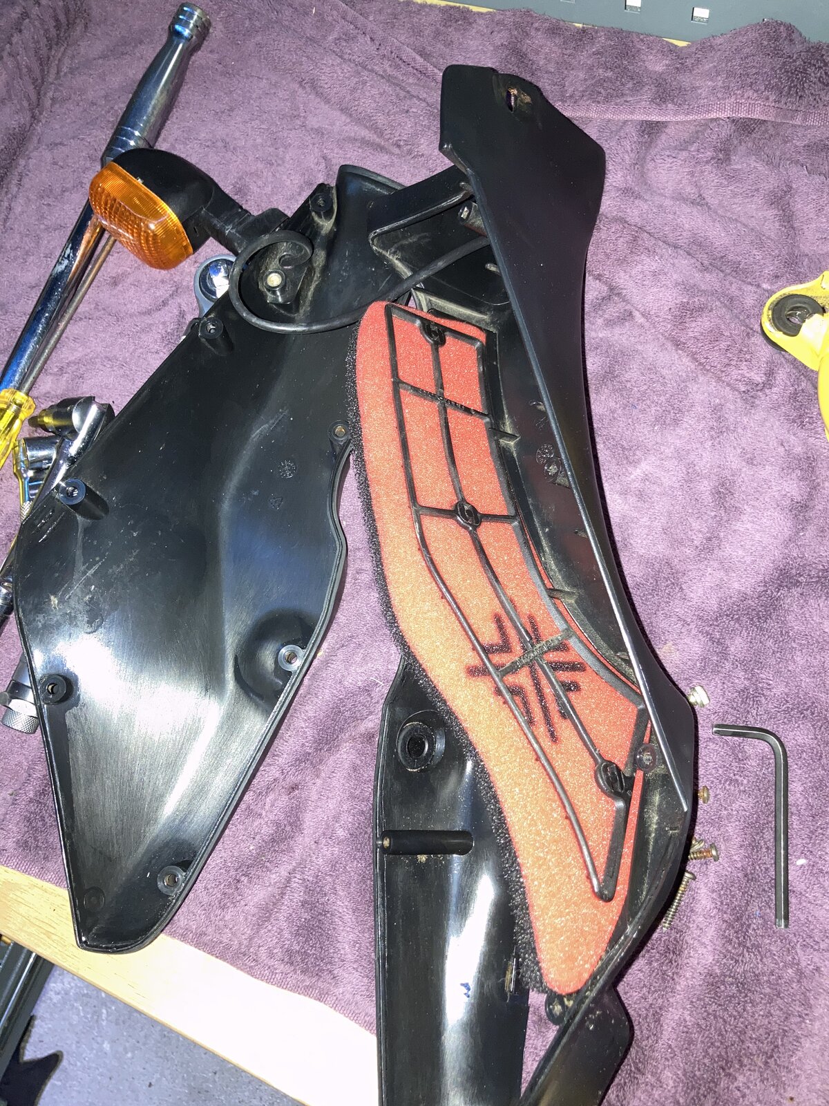

    Next up was an oil and filter change. The last filter never seemed to seal correctly and I was always chasing a little weep. Checked the mating face and all was good and thankfully now the new filter is on there is no such issue. While everything was in bits I also replaced the spark plugs and air filters (went for pipercross) for good order. I noticed a tiny bit of oil around the vertical plug, I can only think that this is due to a tiny amount of porosity in the head. Very small though so hopefully not a huge issue but definitely something to monitor. Brakes stripped and cleaned and clutch checked and cleaned of dust and we were all good to go again.

    I then had the bike booked in for MOT and the outstanding works this week, the general feedback from the garage had been that about £1200 was a good base figure assuming that the engine could stay in the bike. I got a call confirming that the source of the leak was the vertical cylinder base gasket however it would be an engine out job to sort, the new estimate...£3000:scream:. I told them to pass on that, MOT the bike and that I'd come up with a plan. I was then in the garage this morning getting the BMW MOT'd (clean pass thankfully!) and asked what their estimate would be if I was to remove the 748's engine and hand it over to them for the work. A bit of head scratching and they came back with £2000!
