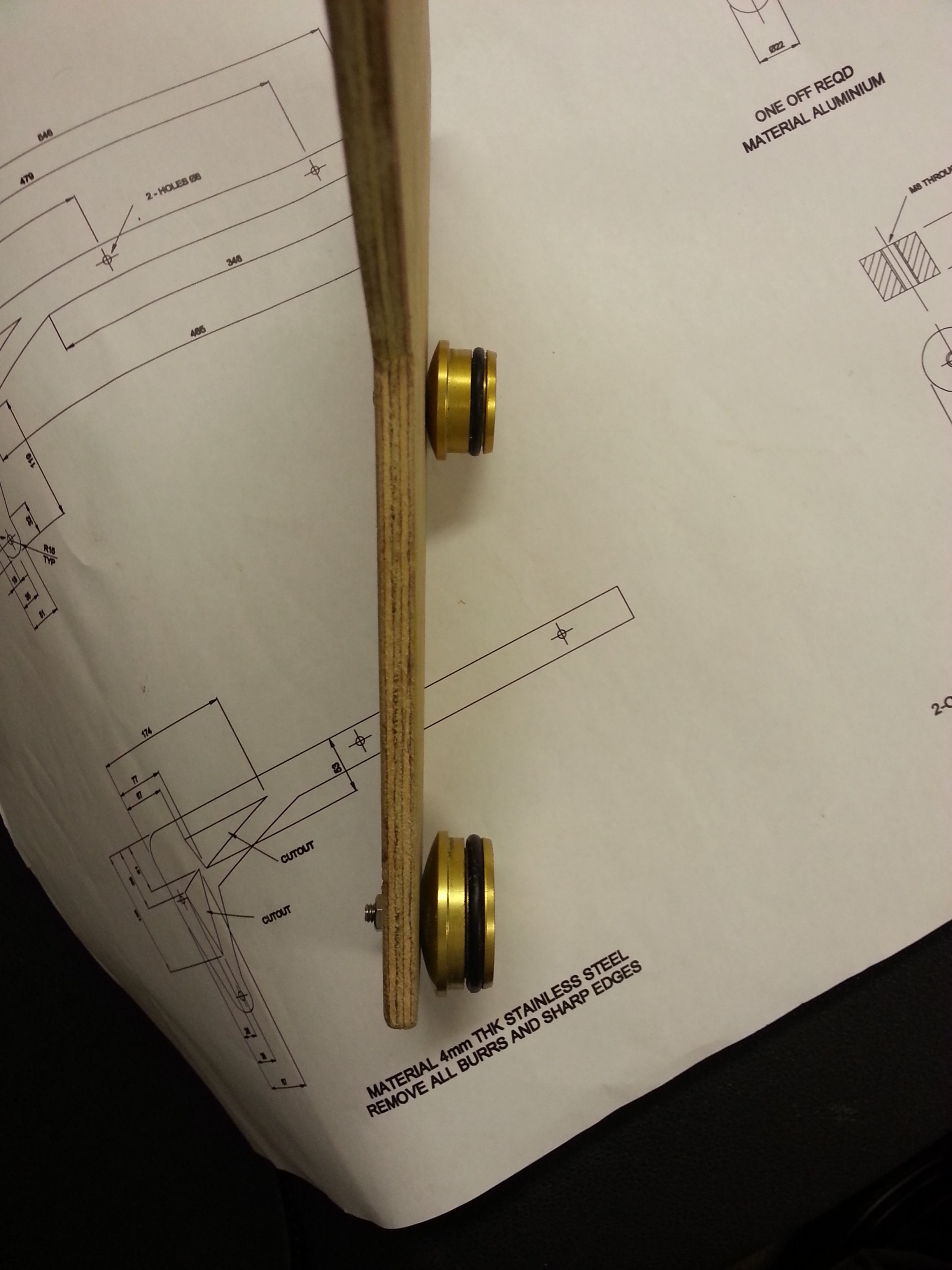

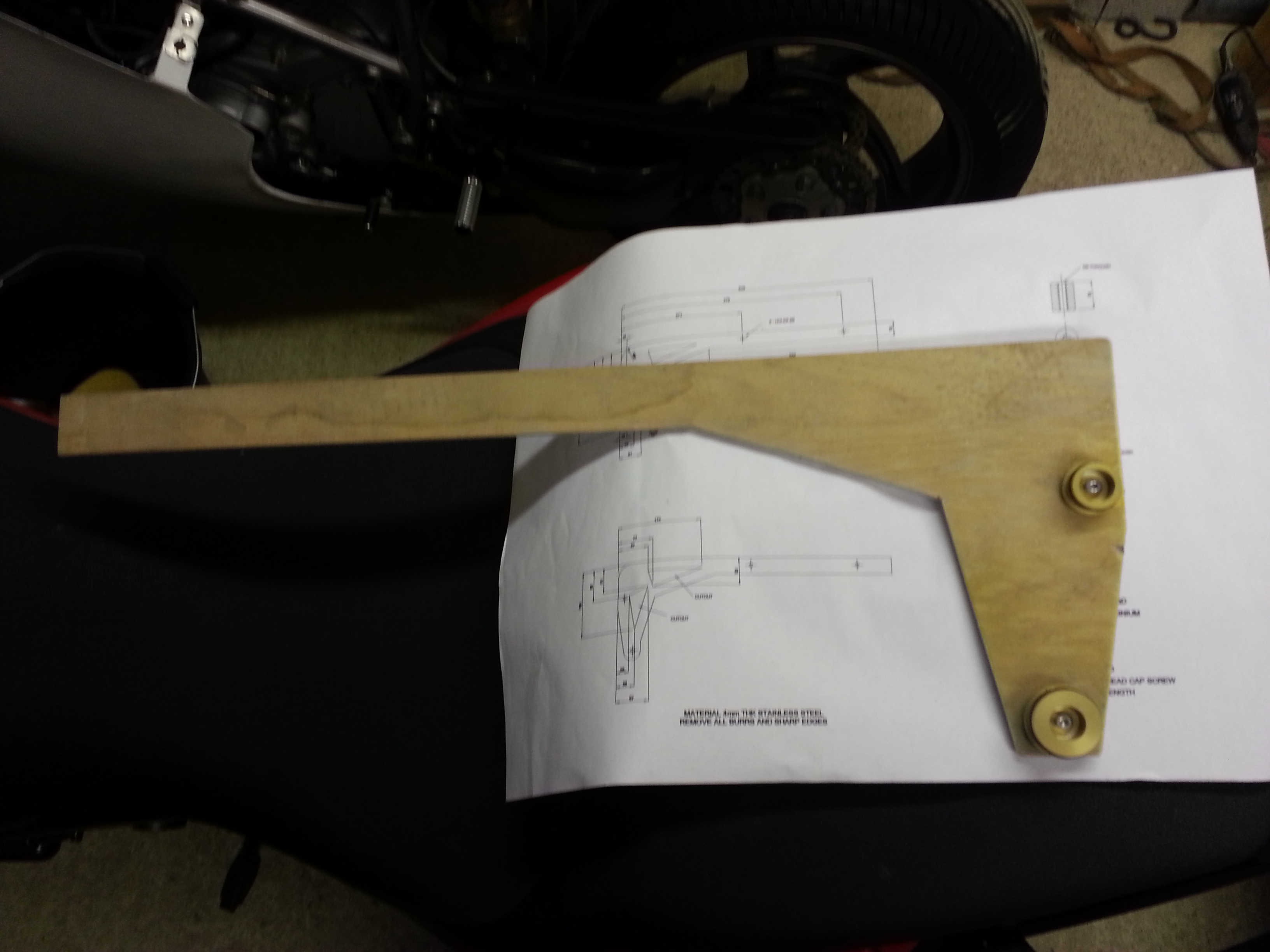

  3. Sticky backed plastic and empty washing up bottles ? Eat your heart out Blue Peter ! Take a sheet of plywood that has been kicking around the garage for a while, 2 ghastly yellow anodised Pro Bolt frame bungs retrieved from the scrap bin and slightly modified, some nuts and bolts, a few basic tools and a drawing supplied by Cranker V2 and this is what you get.
    20140618_202240.jpg It fits perfectly, it's definitely paralell to the ground and is actually quite robust. Took a quick measurement and I reckon my rear ride height is about 7 or 8mm low on the 245mm base figure in the WS manual. As I'm putting the Metzler Racetech K3s back on for Tuesday it will be an ideal time to adjust the set up to be slightly more aggressive. Andy
