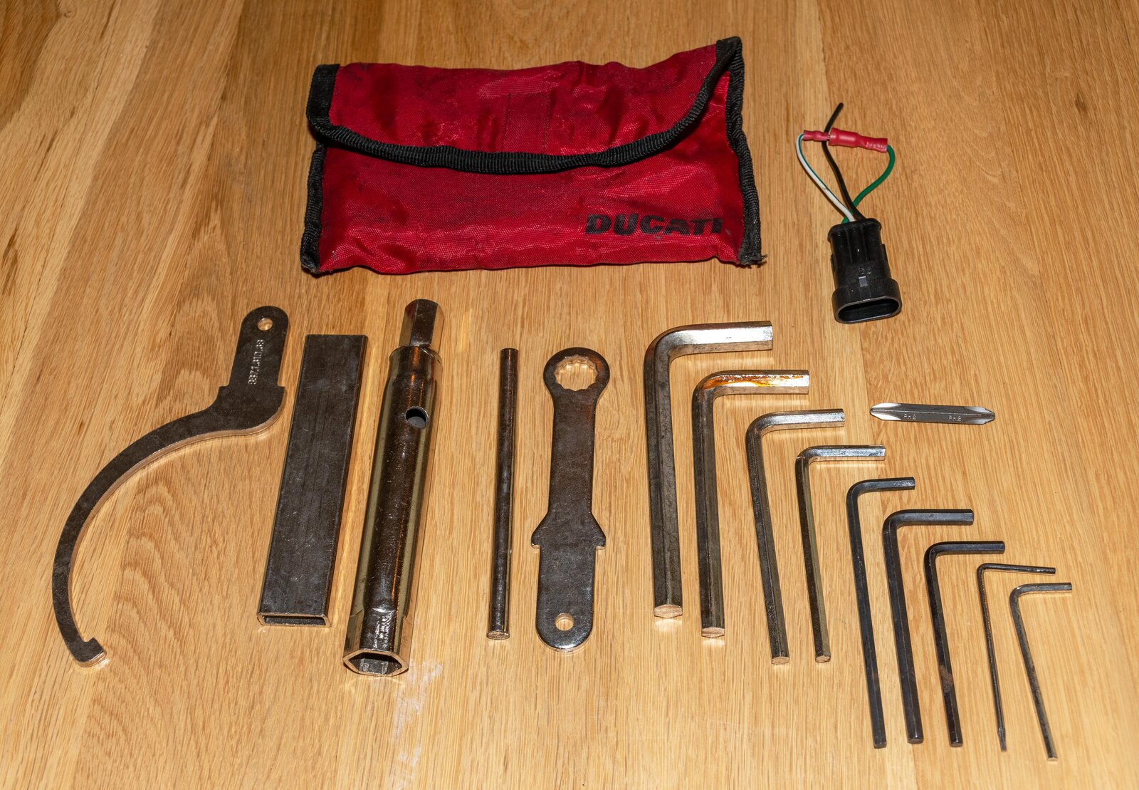

    Sorry bit of a geeky question, but does anyone know what tools came in the underseat tool kit from factory? I have a number of tools in mine with part numbers on but also some allen keys/spanners/screwdriver bits that I think have been added, so just trying to work out what should actually be in there!
  2. That's the full set from mine, this is the first time the tools have been out of the bag.

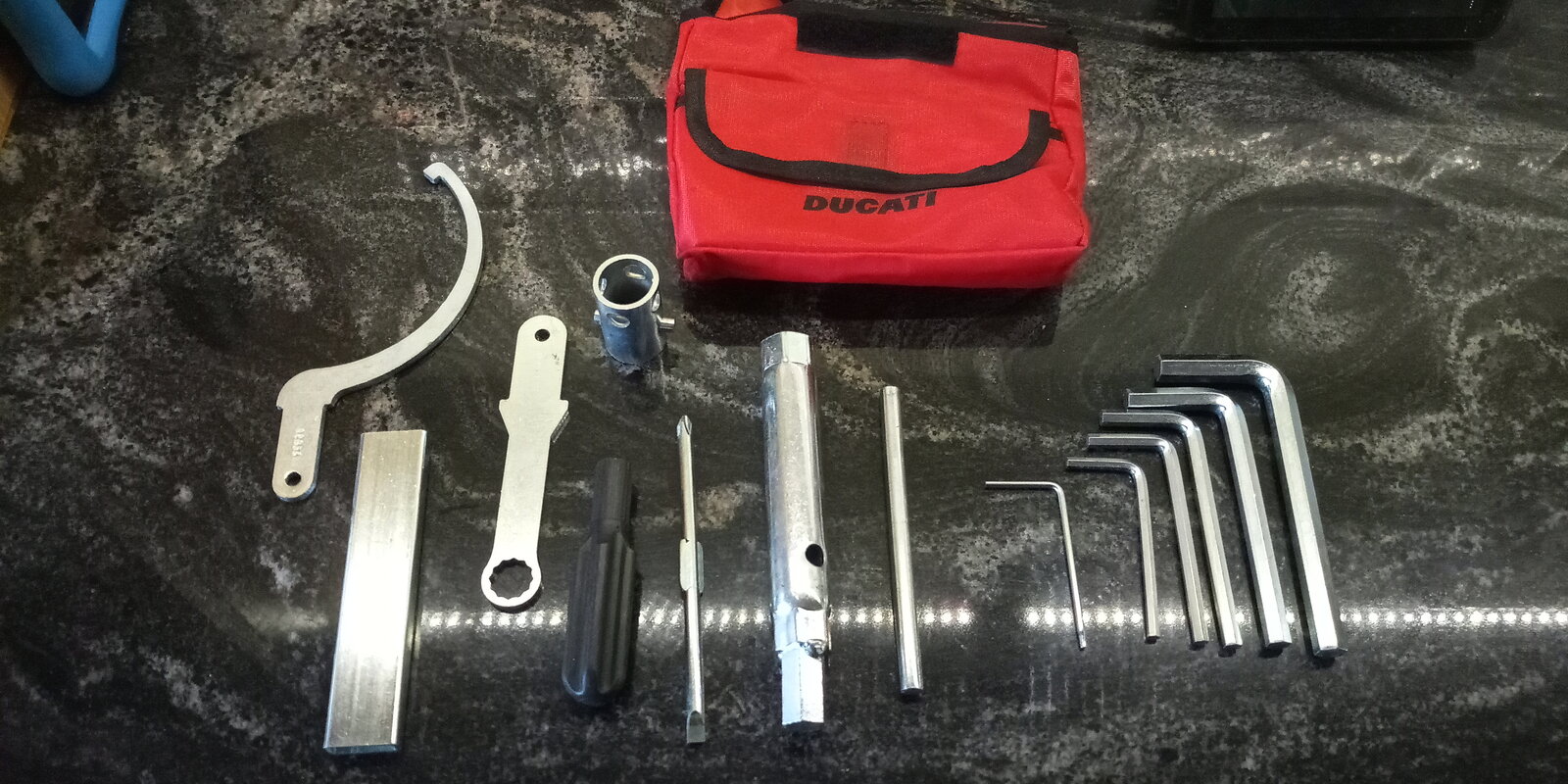

  3. Complete & utter bastards Short changing me again in life.:(
    Also = @Expat Jack ^^^^^^^^^^

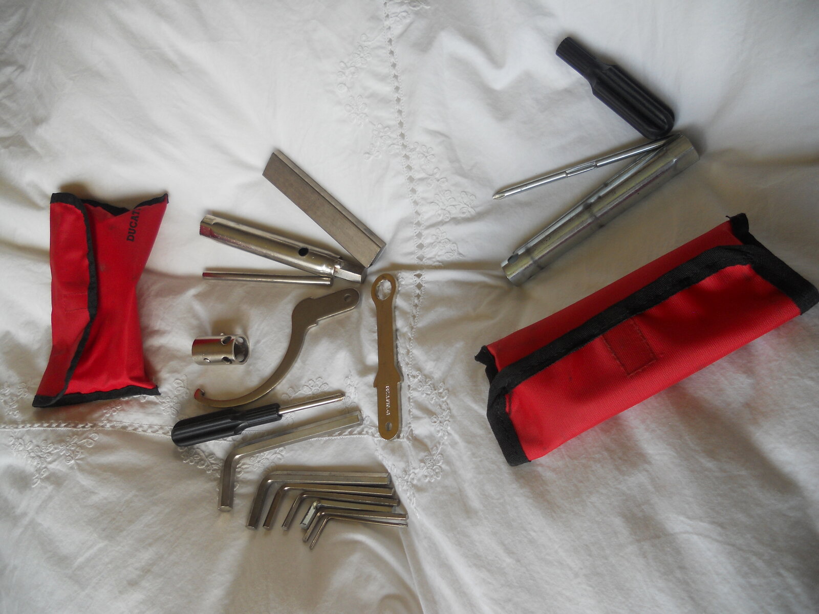

  4. these also are missing:-

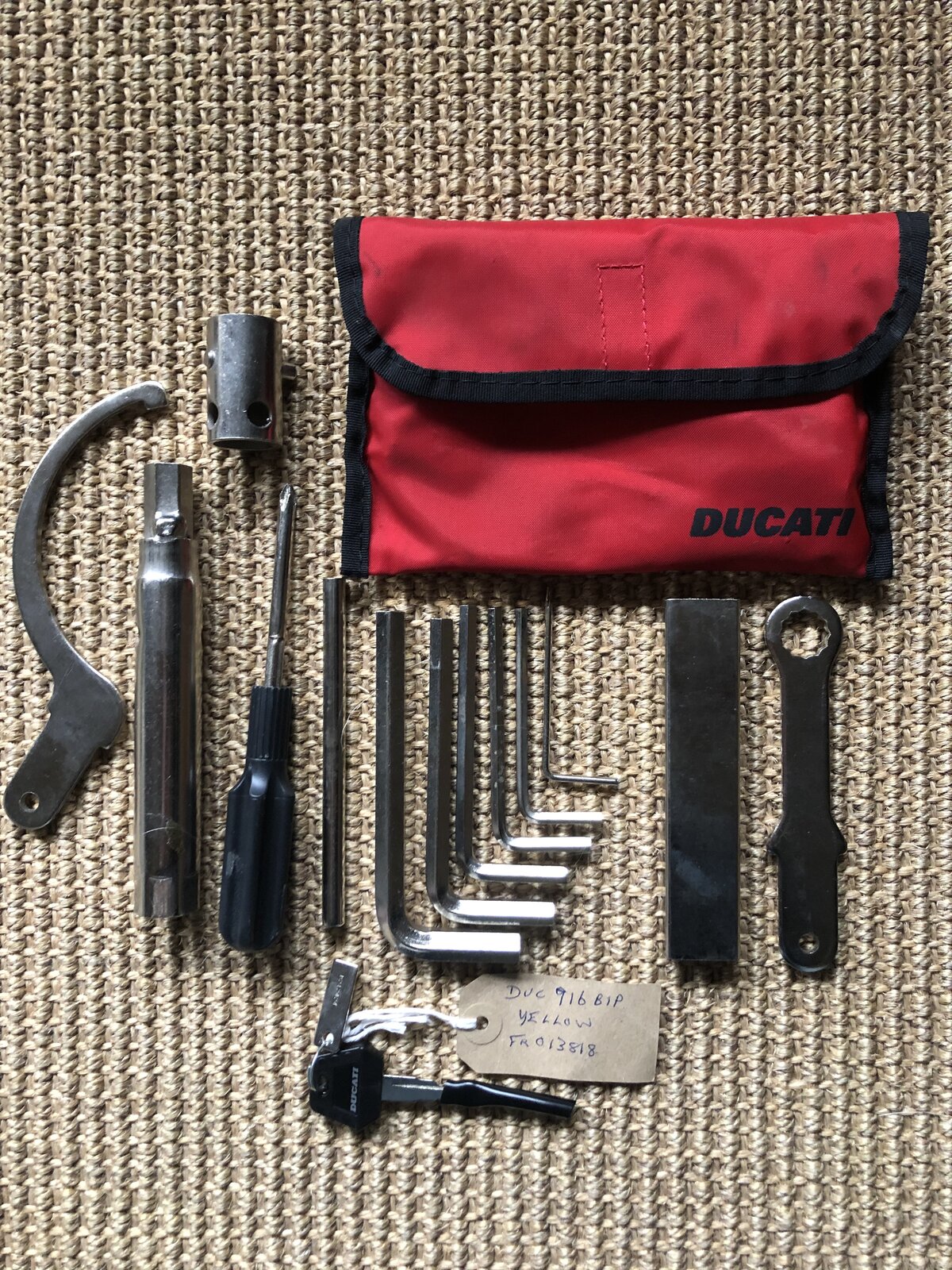

  5. My original set, if it helps ….
  6. Yours has 13 bits the one above has 14 bits?
  7. Actually they are both the same
