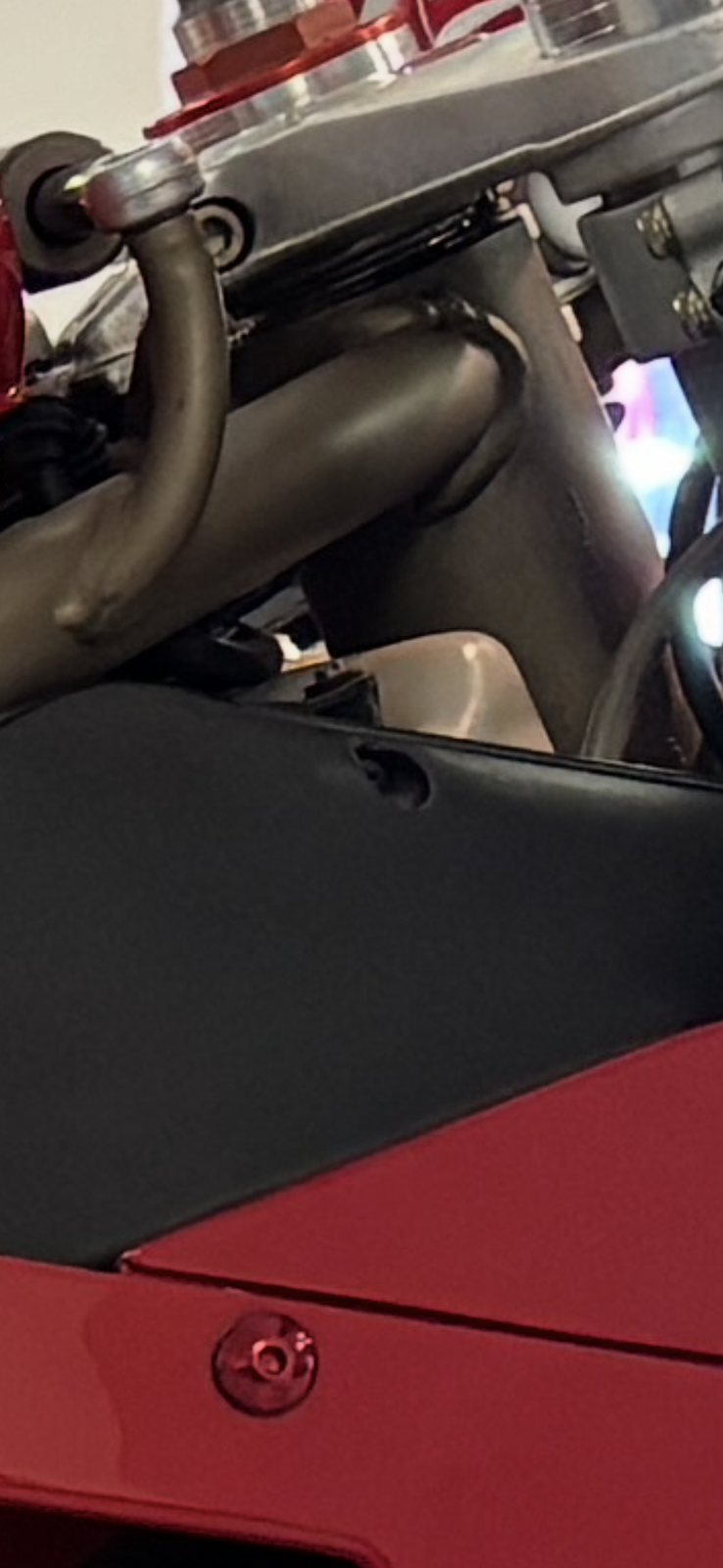

  3. Simplest way is the adjustable headstock has 2 steering damper mounting points on the frame like this;
    Also, the headstock is smaller diameter and without the adjustment nut plus the bottom yoke is different and the steering tube thinner.

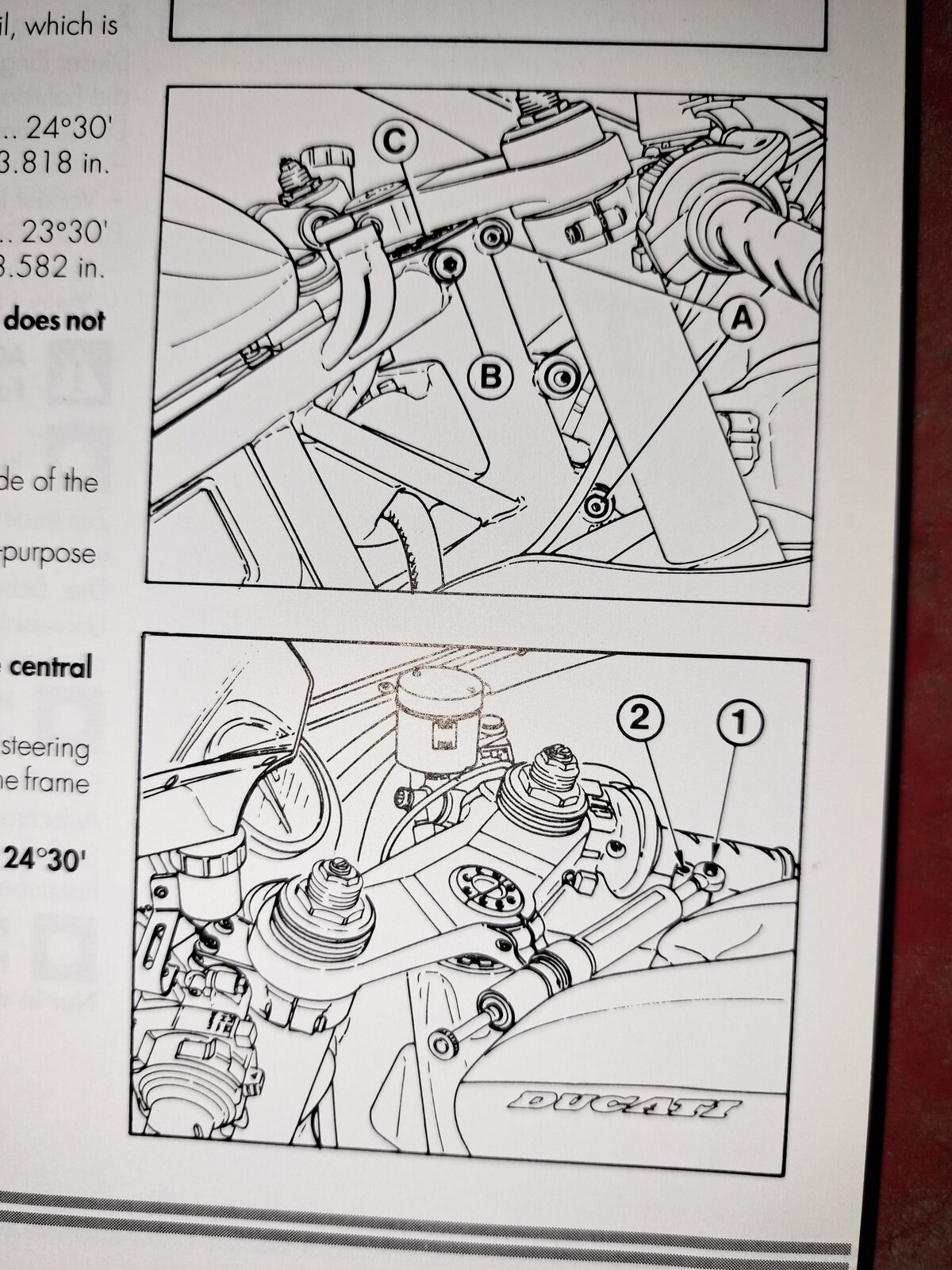

  5. 20251021_131424.jpg Point B is a locking bolt. Loosen A and B turn C 180 degrees then tighten.

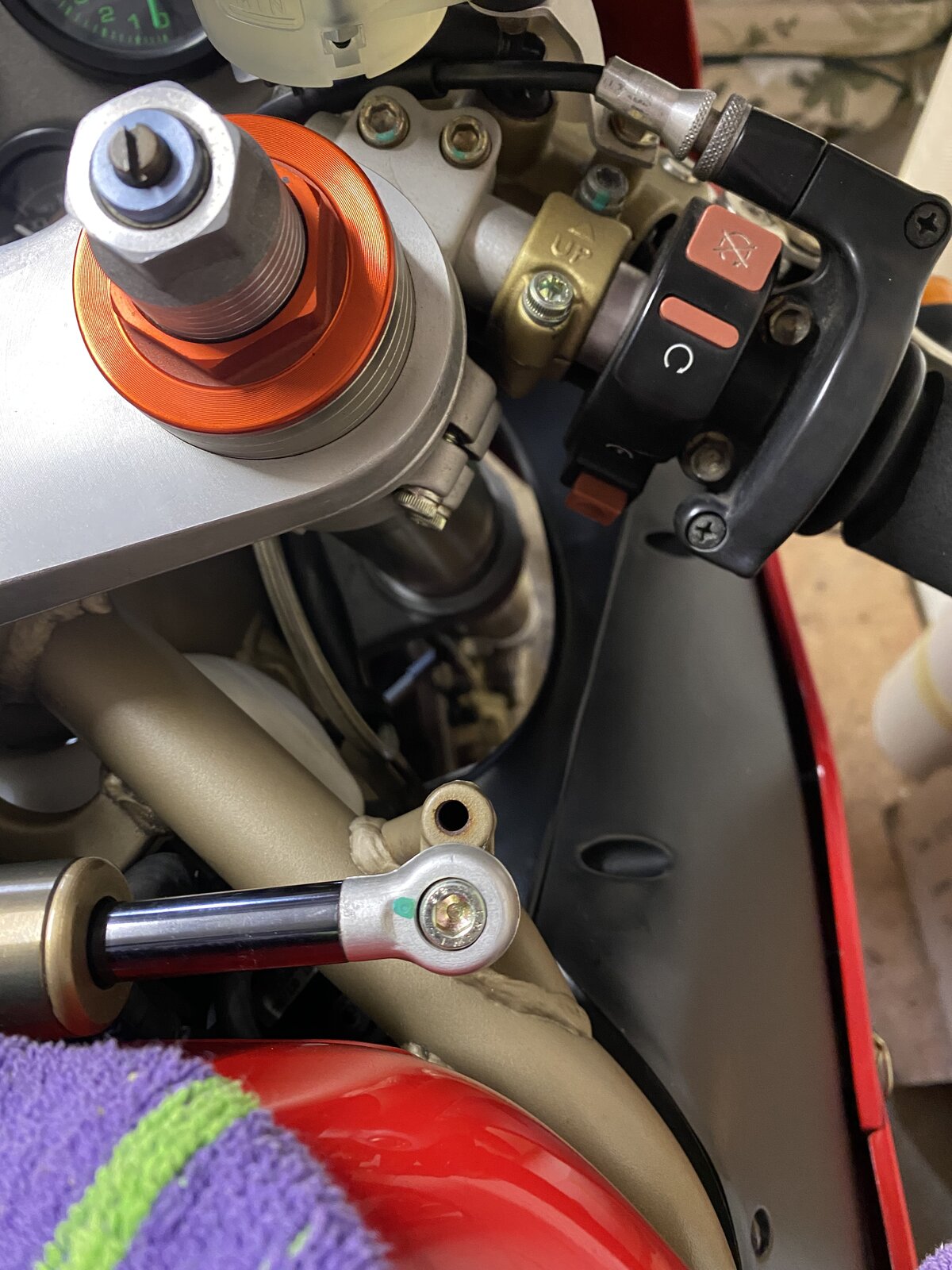

  6. My 1999 748 gold frame, has adjustable steering,

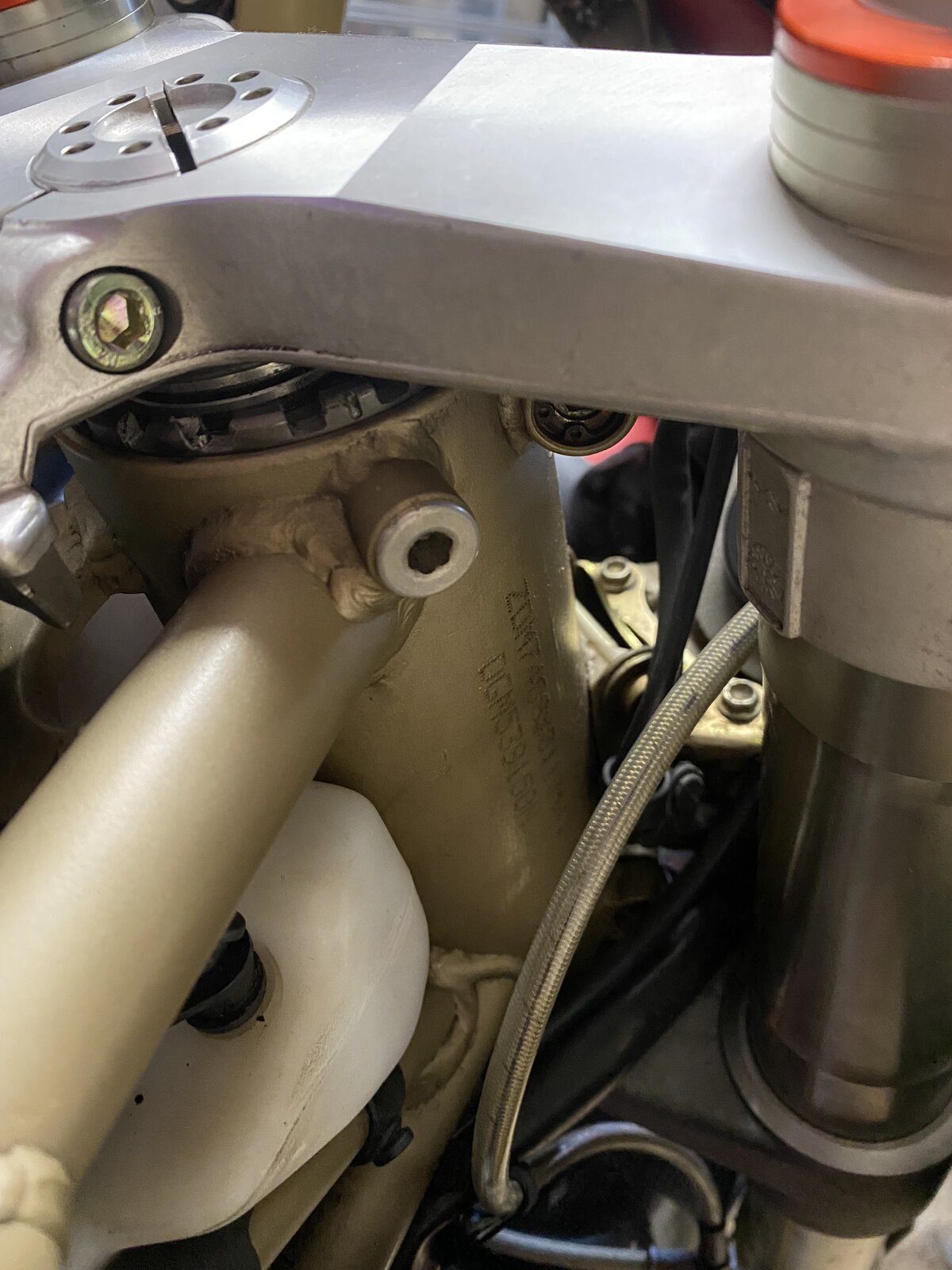

  7. IMG_2844.png I see now, so this is none adjustable and the E model not a BP?

  9. Looks like it Cossy Mike.
