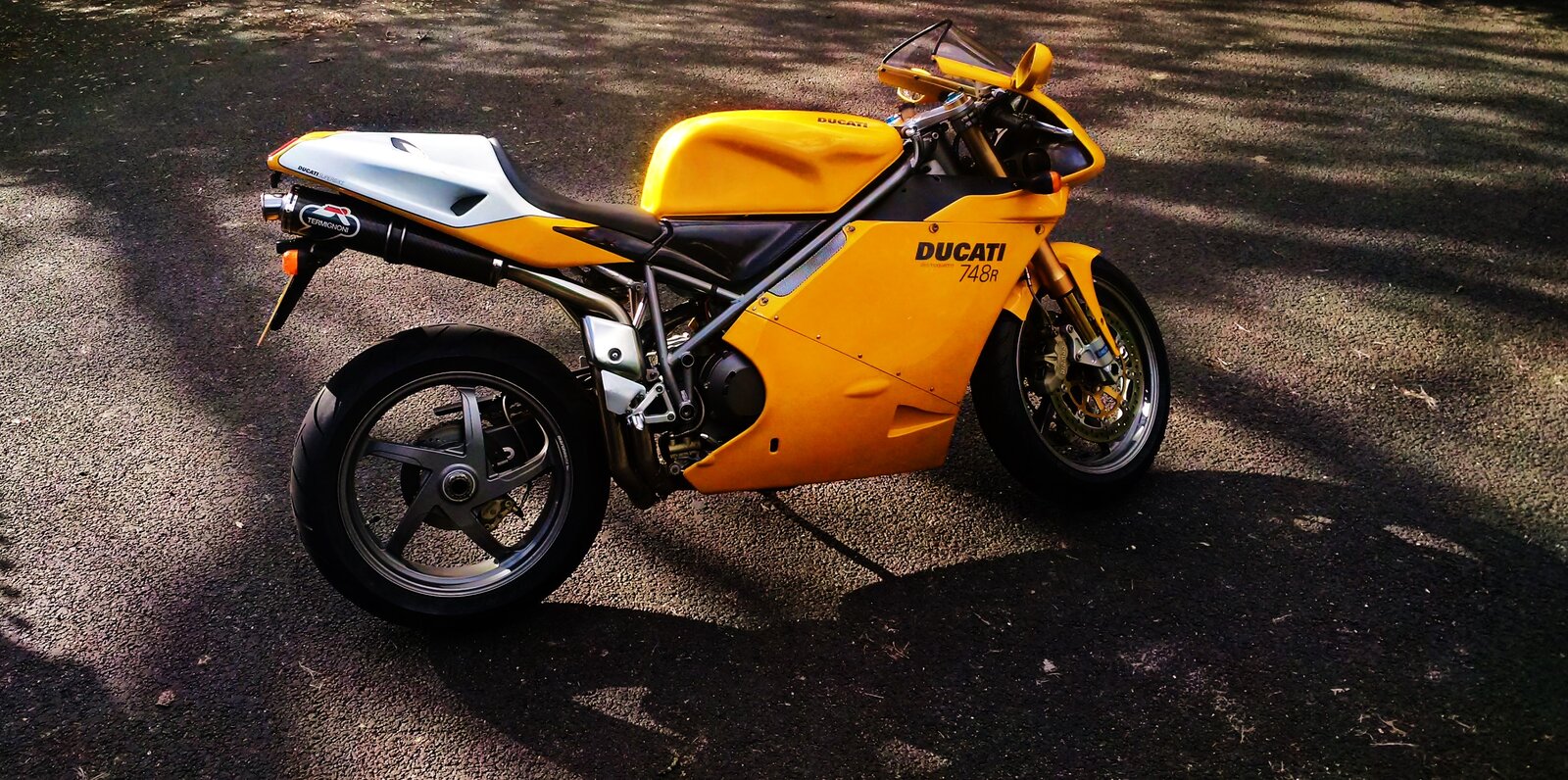

  4. I know the invoice value for my full monty with Baines when i first got my MY02 748r about 3 years back was less than 1600 inc vat including new clutch basket, clutch pack, valve clearances, belts, fluids, a couple of rockers, fitting and balancing tyres etc etc
    gratuitous pic time

  9. Whoa, what a lot of posts since I last looked!
