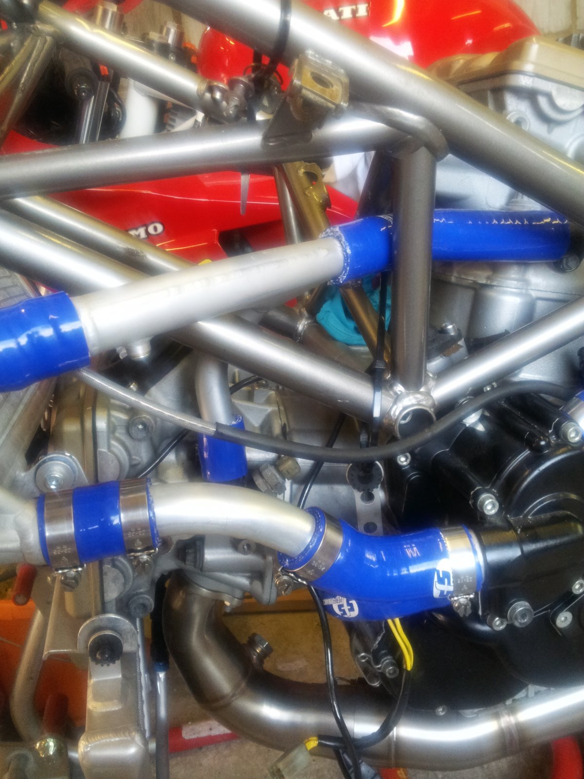

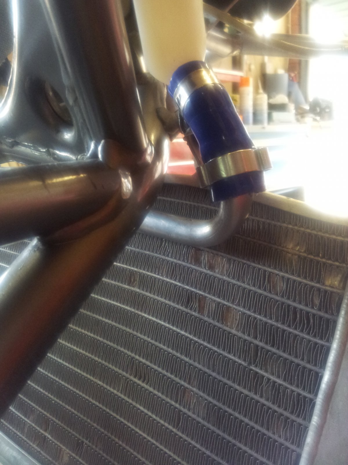

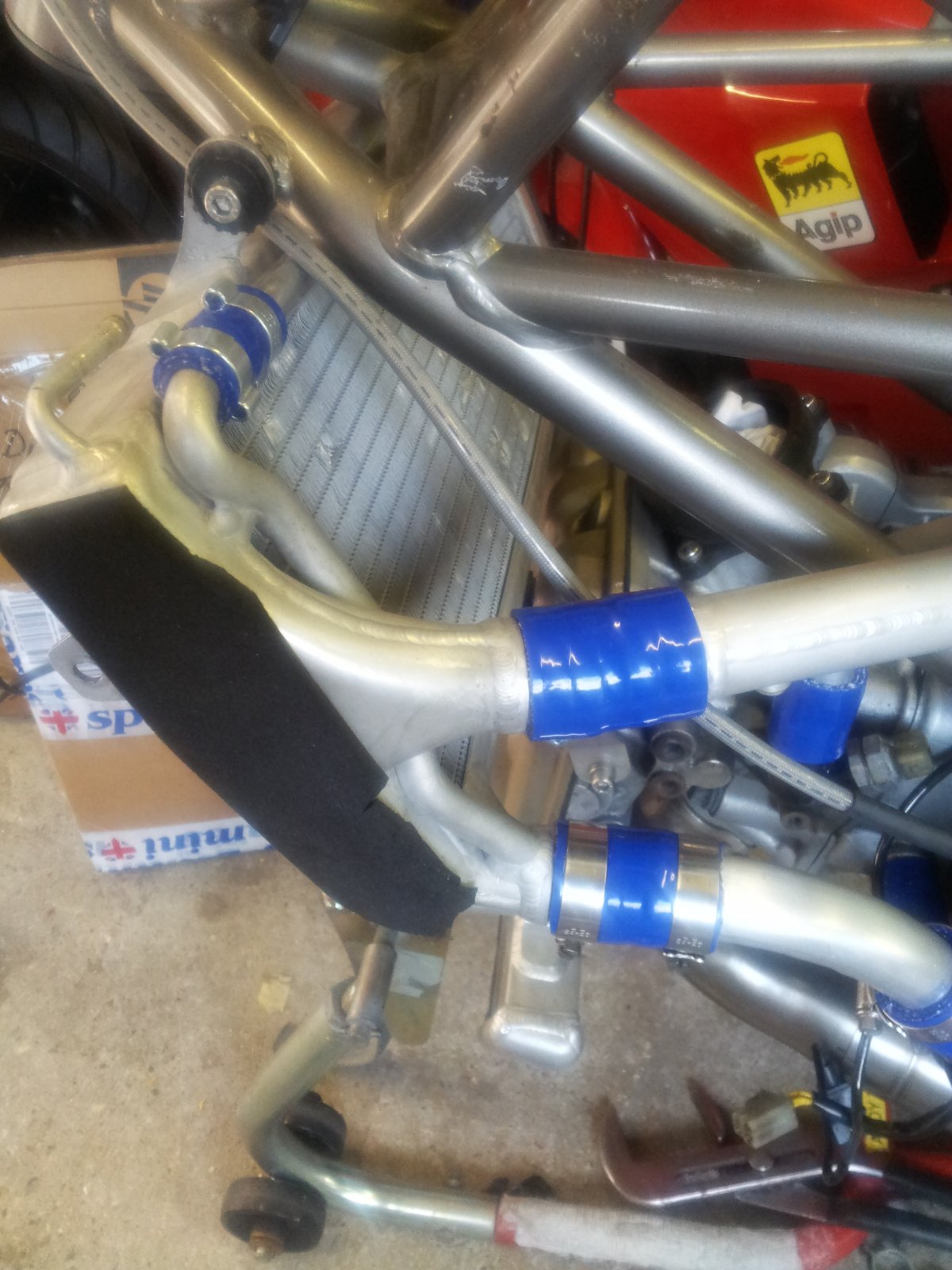

  2. Started to fit up the coolant hoses.

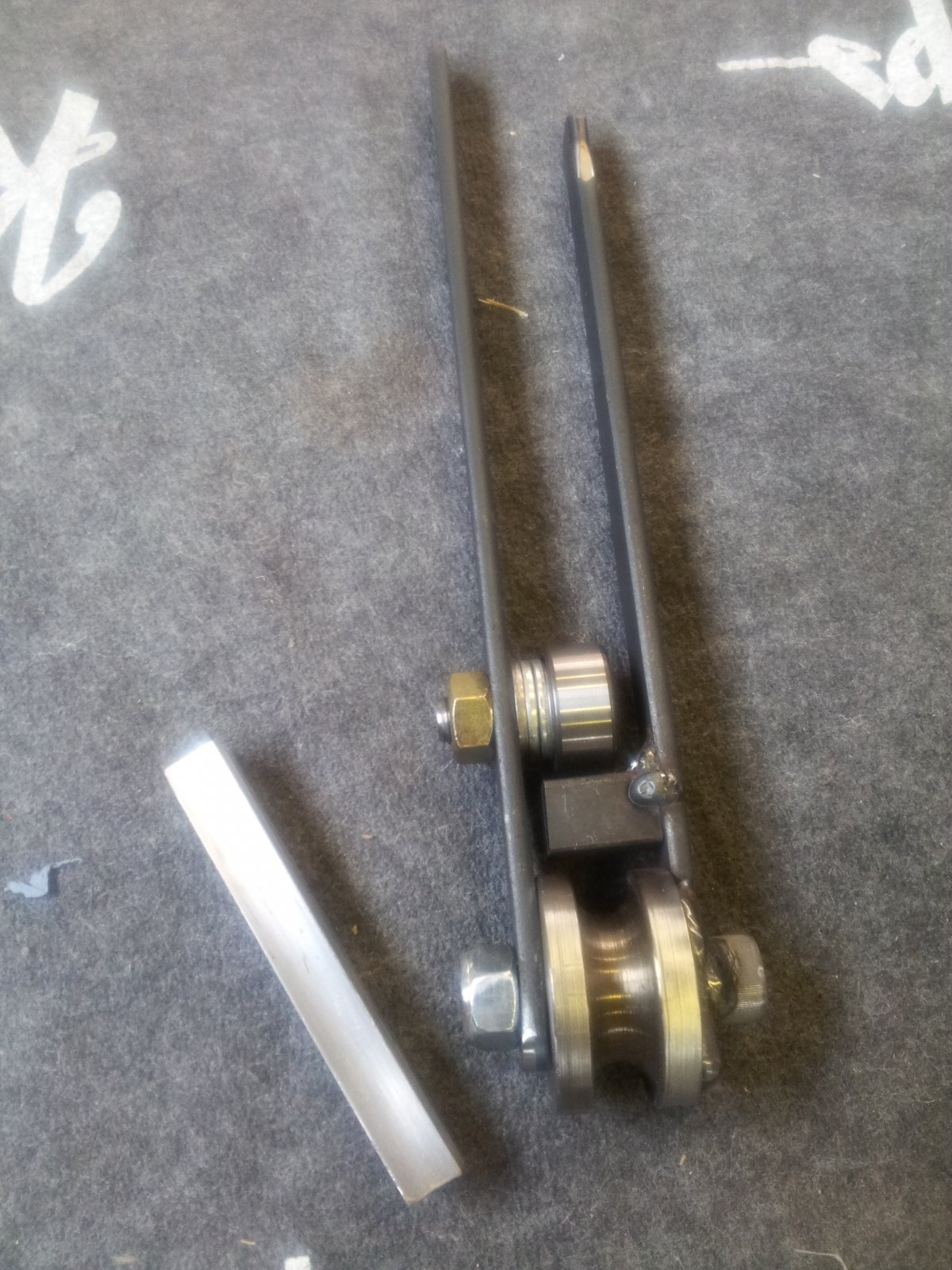

    Bent some 25mm ally for the lower rad pipe but the smaller 12mm hose needed a tight bend in it. So after annealing the pipe, I made a pipe bender to get a nice tight bend.

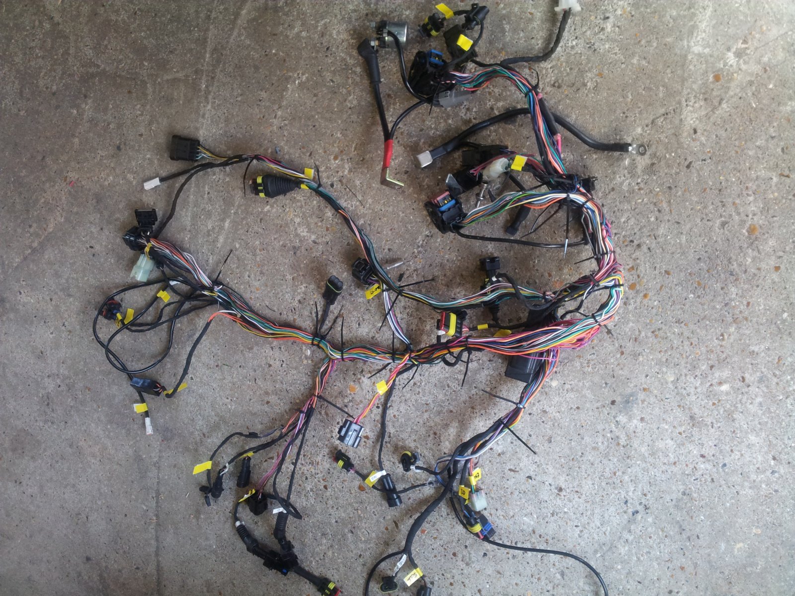

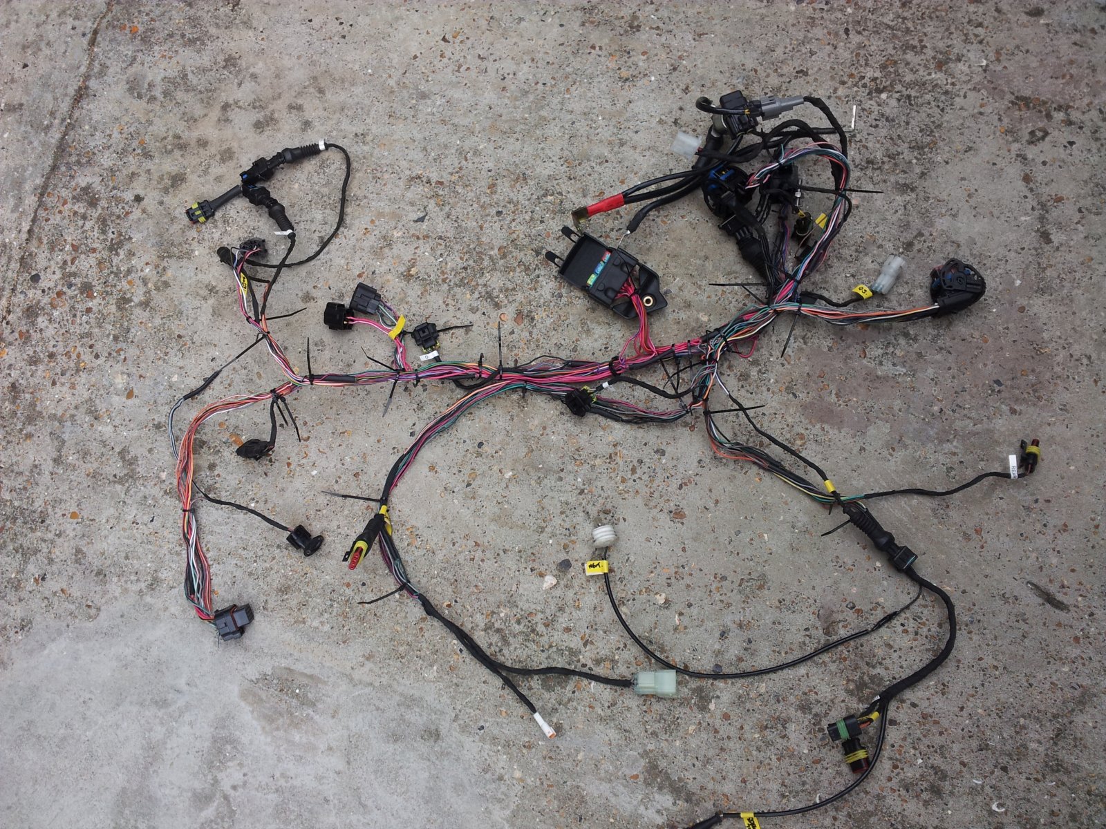

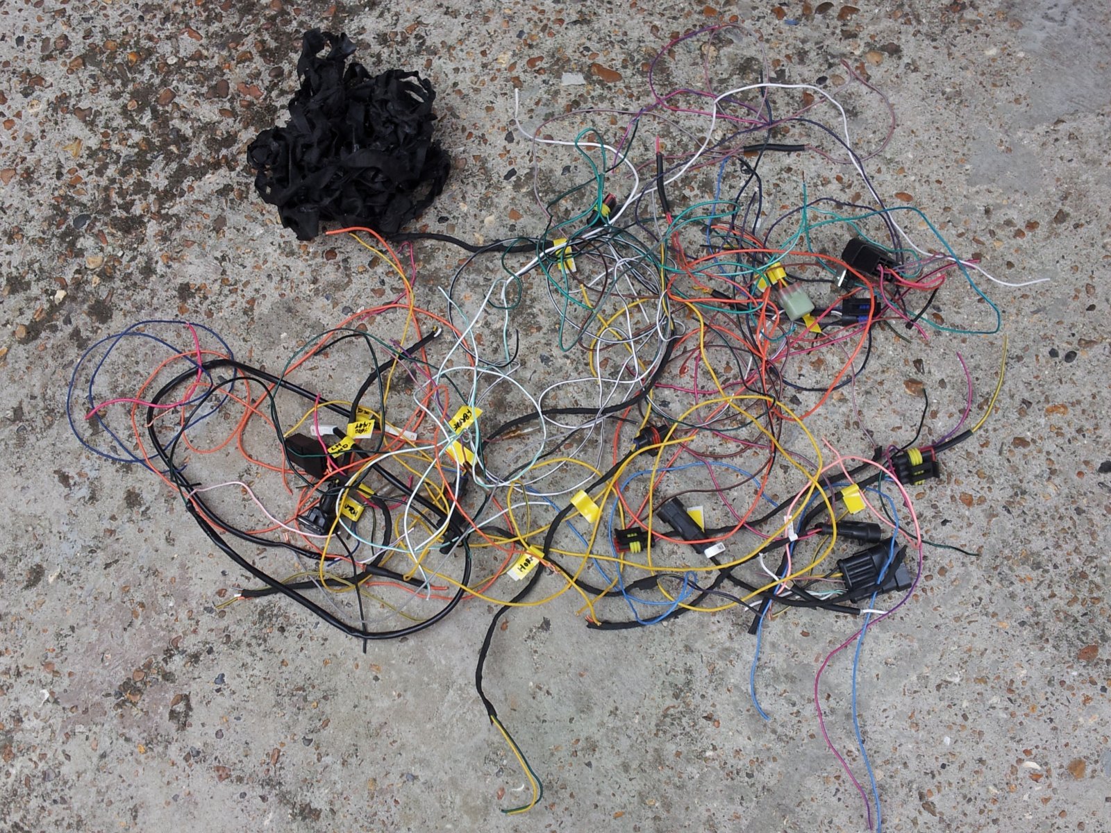

    Finished chopping all the unwanted plugs rom the loom. Just got to wrap the loom back up now with loom tape that's coming from the UK's Corse dept.

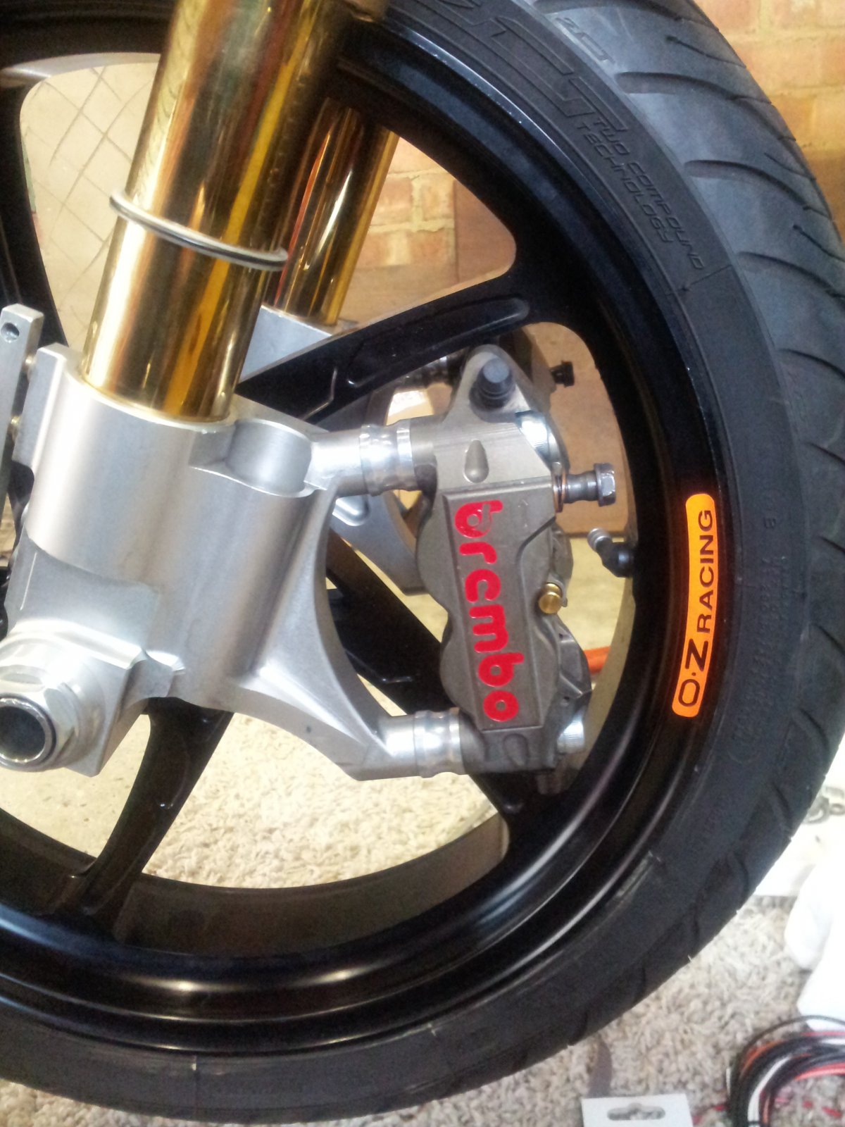

  5. I was going for some r&t forks but ended up with some 46mm superbike forks.
    These needed some108mm calipers so got some billet Brembo calipers.

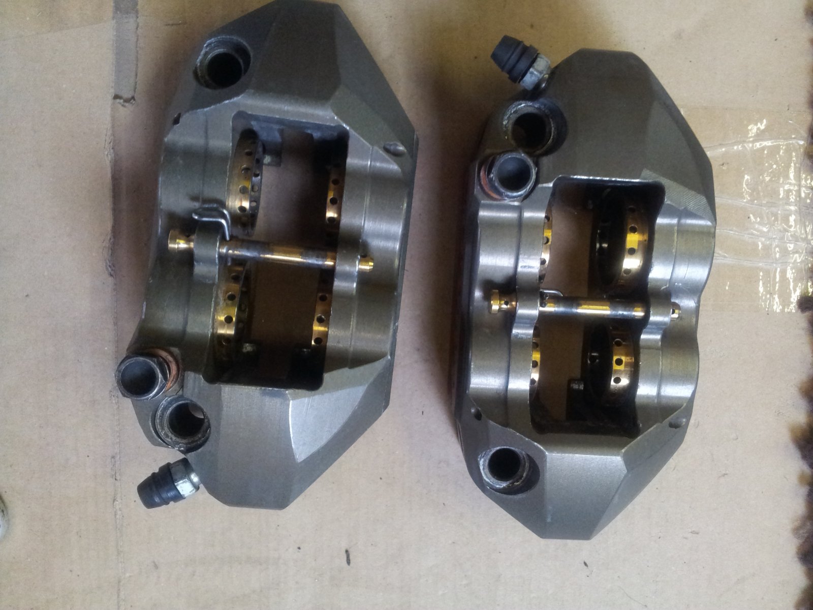

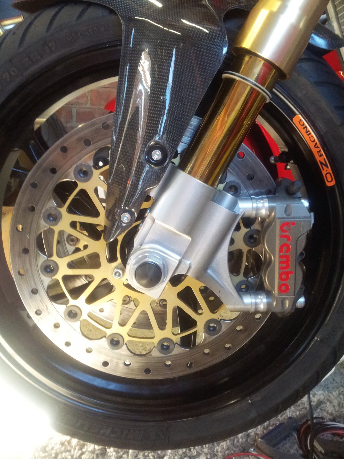

    Need to look at some Brembo narrow track discs with a 10mm offset. 20150829_152320.jpg 20150829_150719.jpg

  7. Yep!
  8. Nice :) don't know what the Piega's fixing PCD's etc are just thought the 290's would fit without the calliper bobbins, don't think you'd be short of stopping power :D

  11. The Oz wheels are the same as 5 hole Ducati's 72mm bore with a 90mm PCD.
    The fork bottoms and calipers negate the 15mm offset, so 10 is needed.

  15. Managed to source some 999RS discs (Two pairs) They needed 1.5mm shims to centralise them in the calipers.
    The front spindle was for wide track yokes, so I had to shorten it but also increase the thread length to make it work.
    I used the fender mounts that were with the legs but they don't give a good fit for the fender. So will look at making some that allow better fitment.

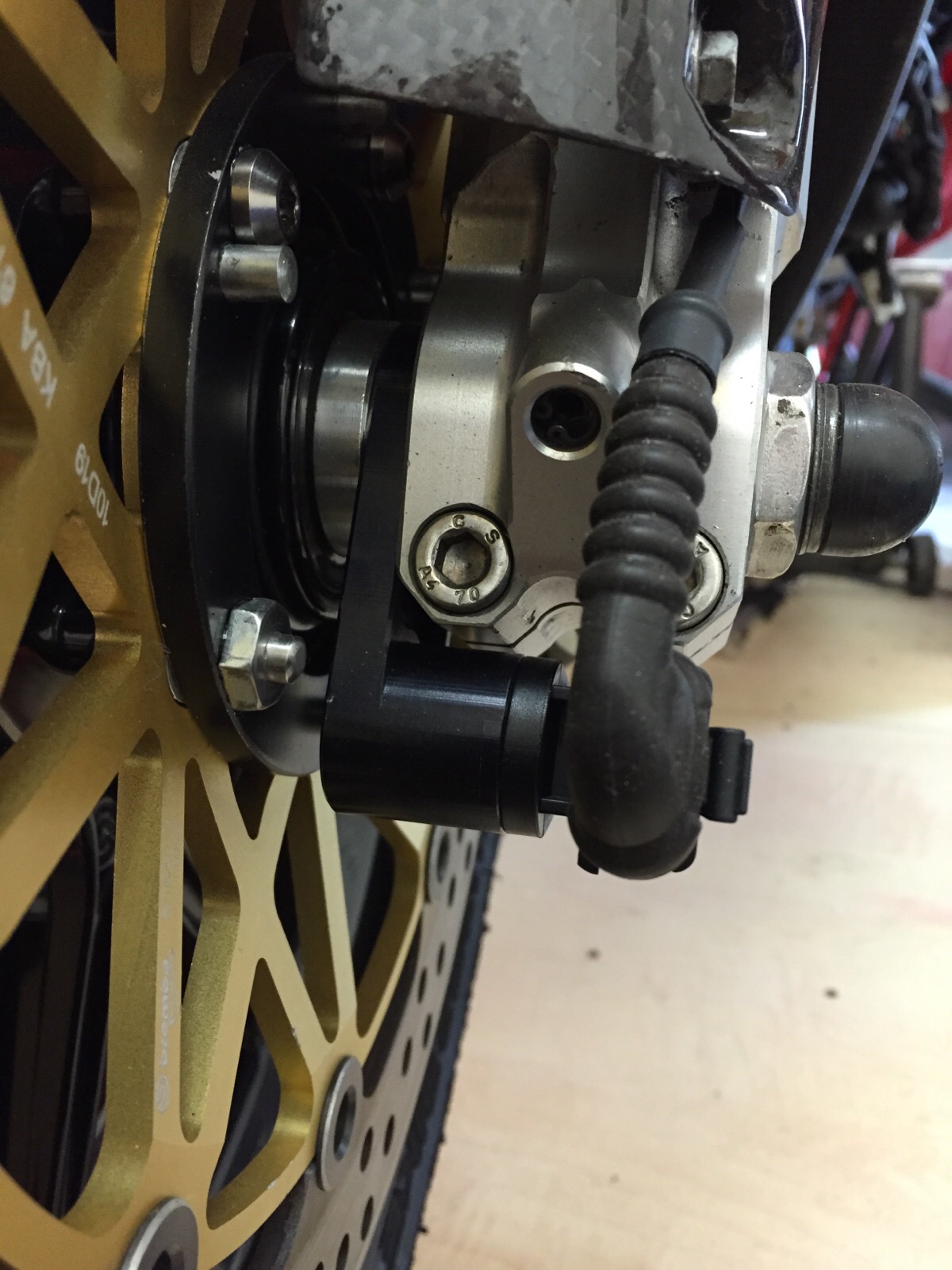

    Because I am no longer using the dtc discs, I have to make a pick-up ring with 6 pips and mount the sensor under the fork. Similar to the Nemesis tc set up. Here is a picture of Andy B's bike, with the pick up ring I made for him.

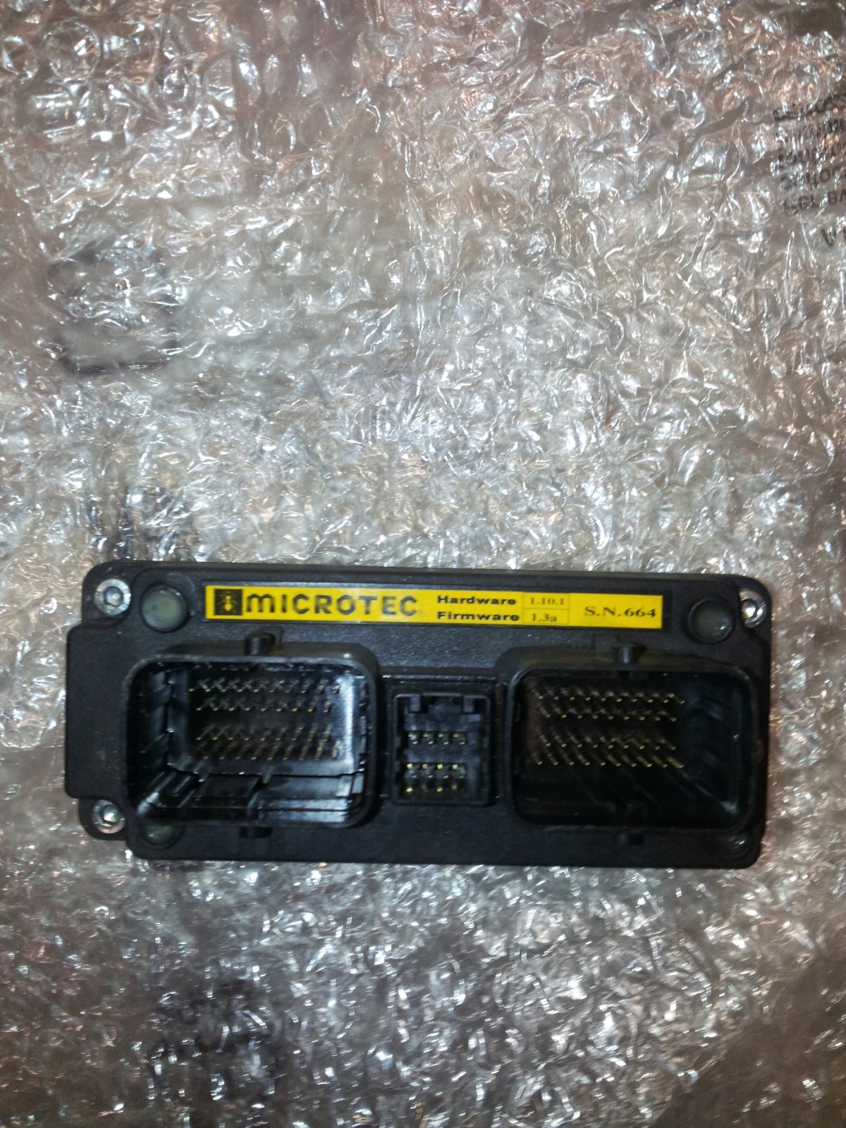

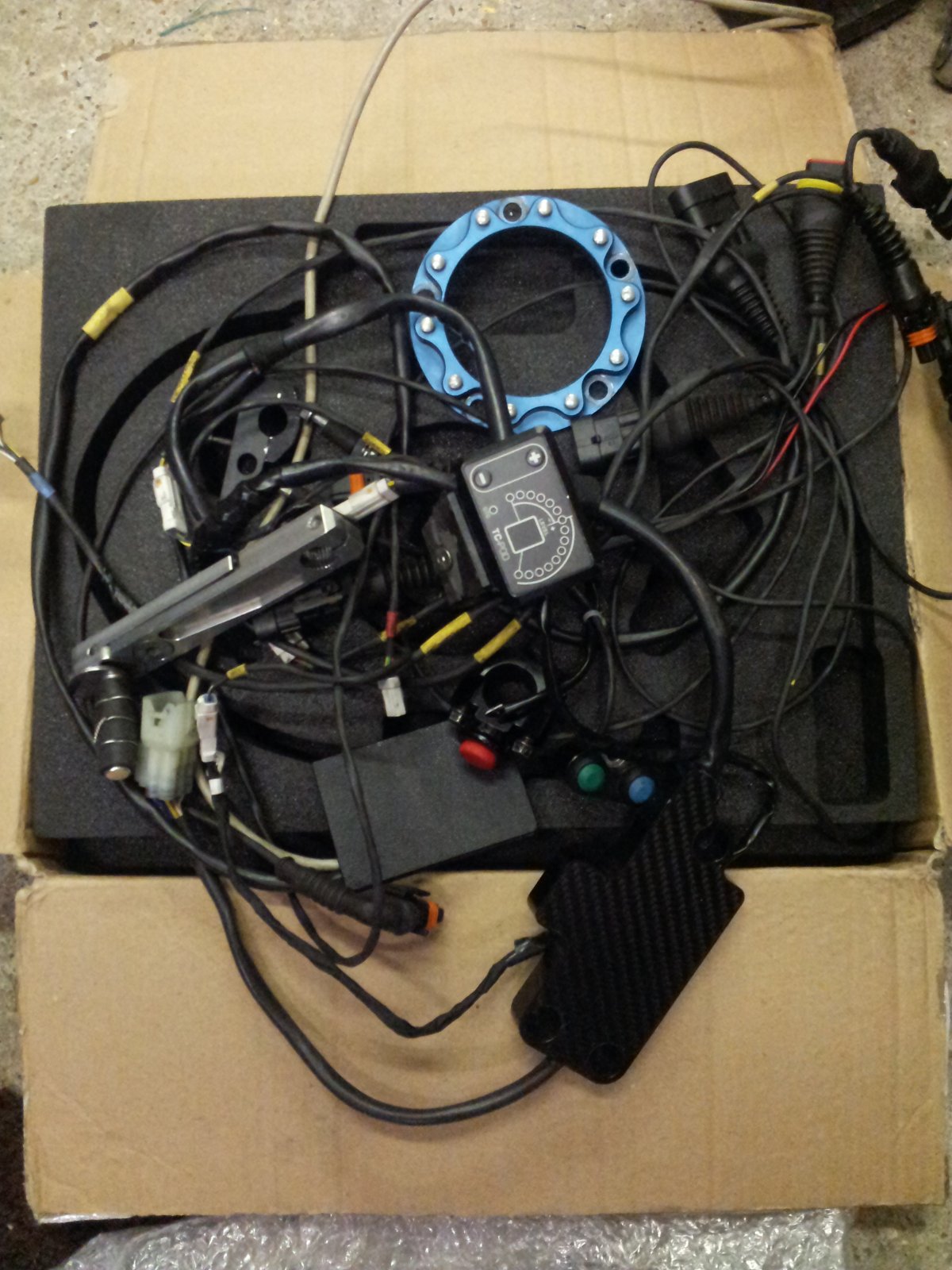

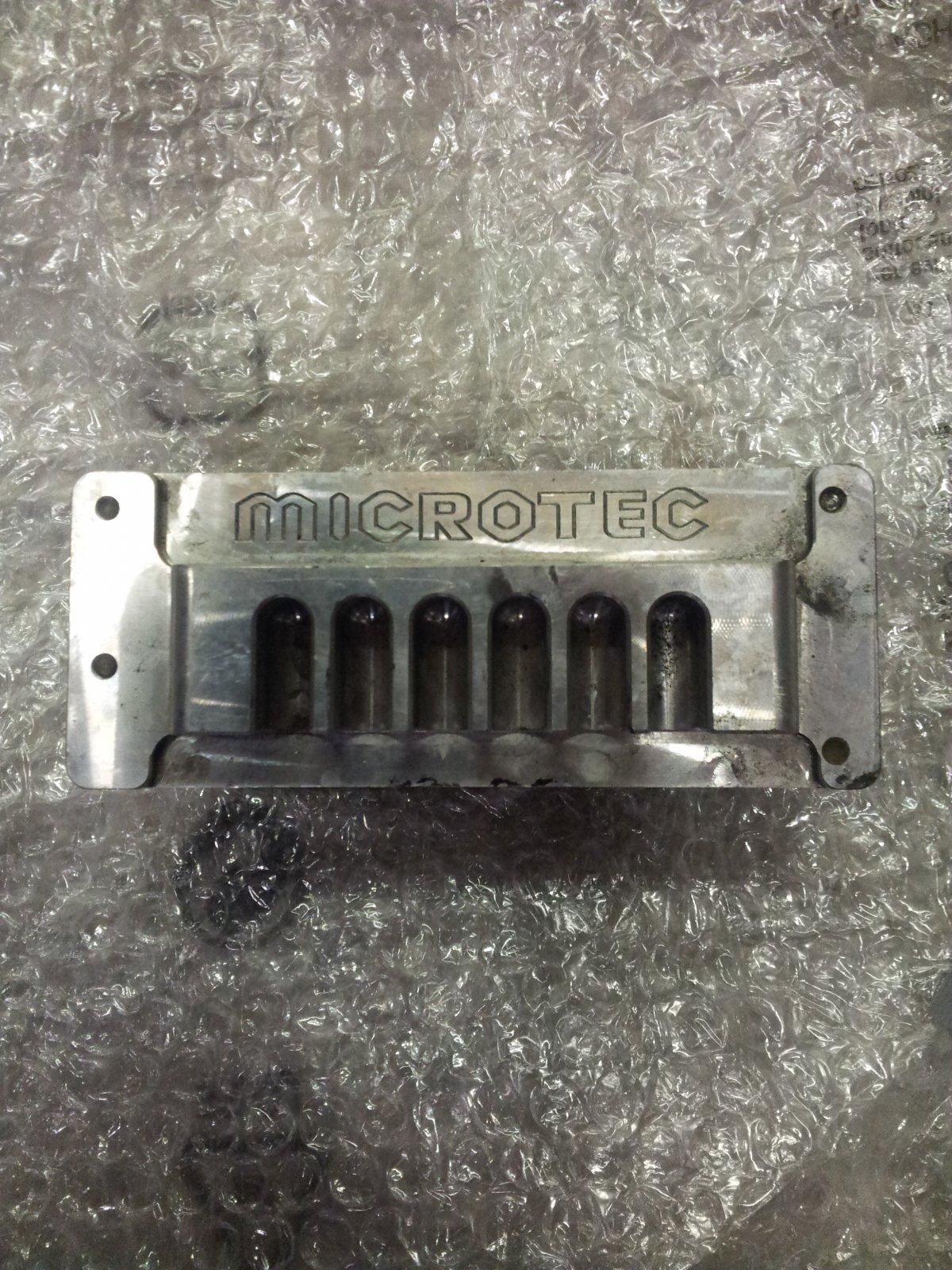

  17. Due to Chris, tutankhamon, selling some parts from his racebike, I now need to install a Microtec M197 and a full Nemesis TC system.
    Need to sit down with some instructions and work it all out!
