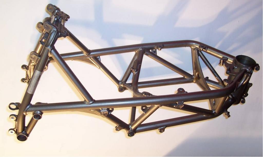

    Cranker I disagree, the MY00 Rs had Showa shocks and the TiN forks, the sub frame is an alloy mono as fitted to the R at that time, Ohlins did not come in until MY01 bikes.
    As suggested already the belts should be slightly wider, it should have an oil cooler with a slipper clutch. Also the frame number for Rs is the only one that varied the letter after ZDM748 which for an R was "R" instead of S for all the other 748 models at that time. The engine number also varied on the R with ZDM748R4 instead of the ZDM748W4 on the other models. An easy way to check if it is genuine is to look for the Kyalami frame or get the engine/frame numbers and check with Ducati. In the pictures the R is the second one, it has a deeper curved centre cross member which allows more space in front of the vertical cylinder for the larger 14litre air box.
