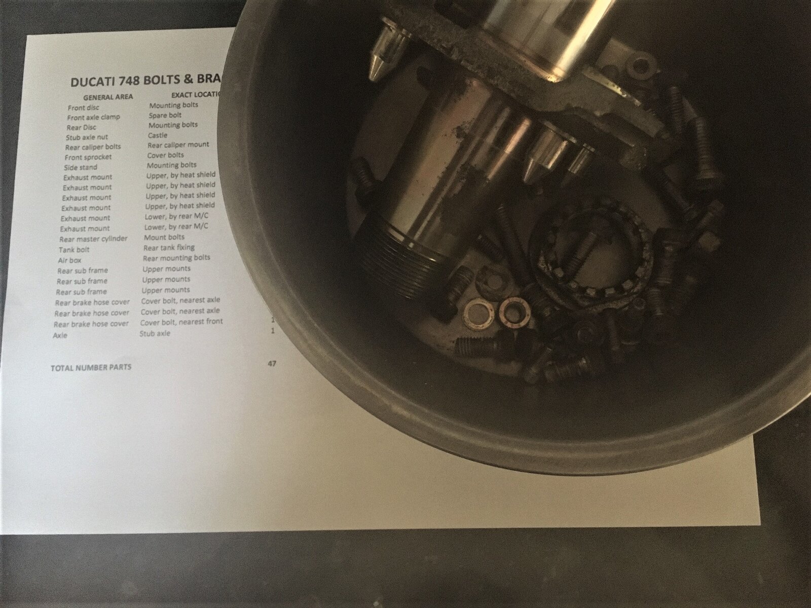

  4. More fun stripping bits off today. Thanks to @Birdie, @West Cork Paul and @XH558 I have removed the disc bolts (Birdie and WCP) and the stub axle (XH - I was being lazy before!) plus more bolts. All have gone down to my man this afternoon for some tasty yellow passivate - another 50 items in total. I cant believe how many there are but, this is pretty much the last leg for the plating at least. Hope you like the list again:p - it says 47 items because I got them down there and then on the way home remembered the three on the chain runner underneath the swingarm :poop:
    Everything came apart easily enough apart from the rear disc mounting bolts. They were pretty tough to get off but a little perseverance and all was good.
    Need to call up the dealers ref the fastners next - the Mrs was not impressed when I told her what she was buying me for Christmas o_O

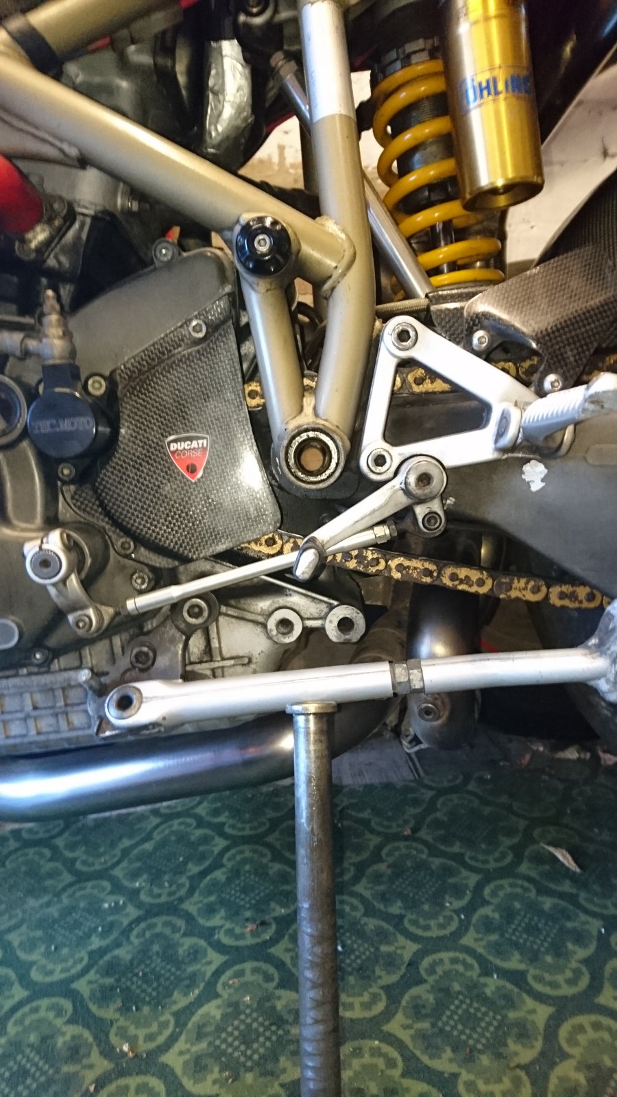

  5. Hi mate. I know Im probably being a pussy, but could you post up your photos of this operation please? Including where you support the bike / swing arm etc. I am going to try mine but dont want to make an expensive mistake and an idiots guide with pics would really help me.
    Thanks in advance.
    Richard
  6. When removing the swing arm pivot bolt on the 748/916 there is no need to support anything, it holds it self together, there are top hat bushes on ether end of the swing arm that protrude into the frame which holds it in place.
    My pivot bolt out, you can see through the hole to the wall behind, bike on the rear paddock stand only.
    Steve
