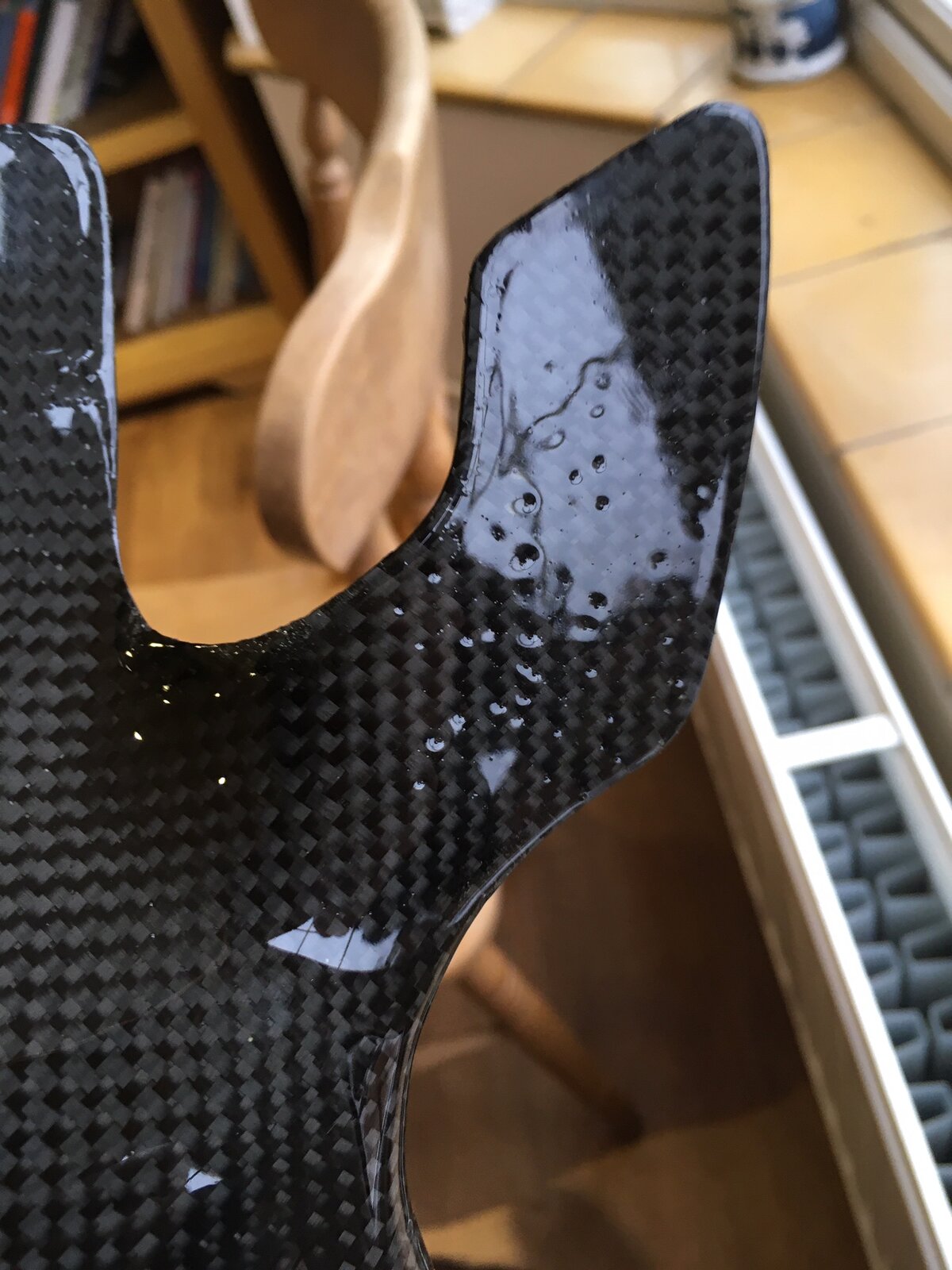

  2. Ref pinpricks - yup, wet down, tack coat, more layers of lacquer, rinse and repeat etc. I have run out of lacquer or would have simply carried on in the bathroom (so to speak) yesterday, laying additional coats that is. Its becoming a bit of an experiment for me. I know the right way, but want to see if a shortcut would work as I simply cannot afford a divorce by spraying indoors again :D

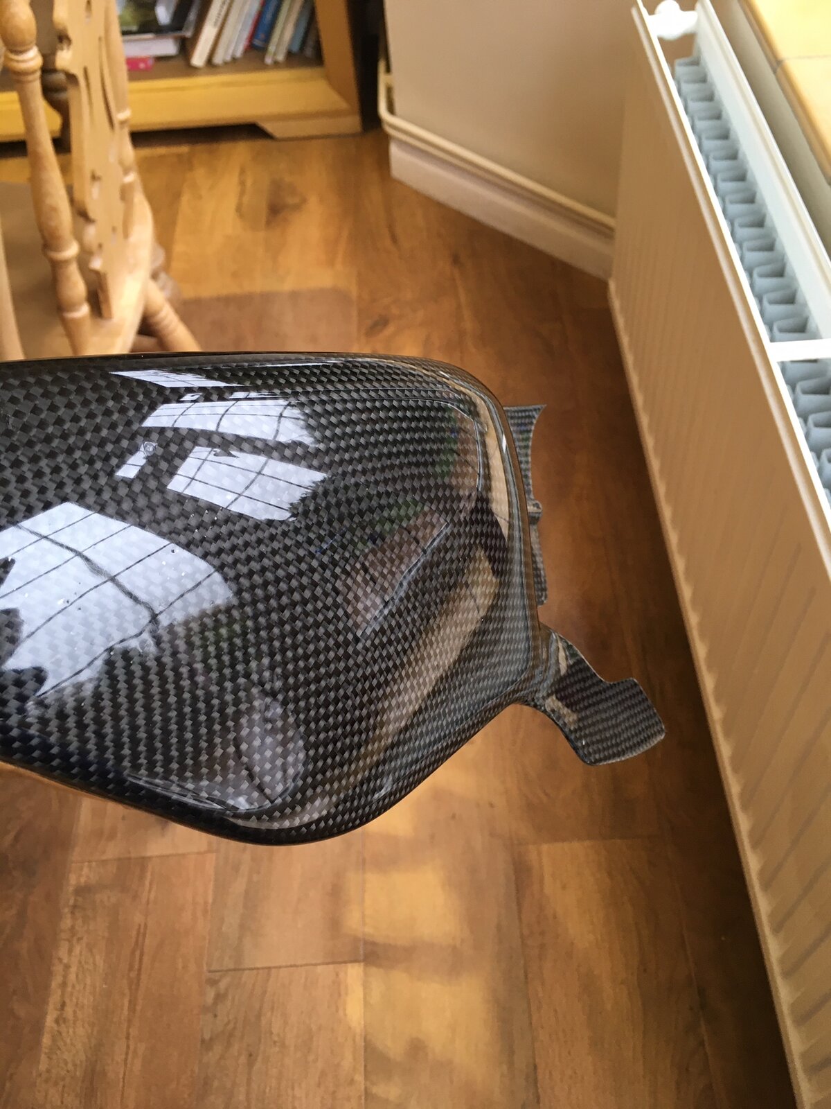

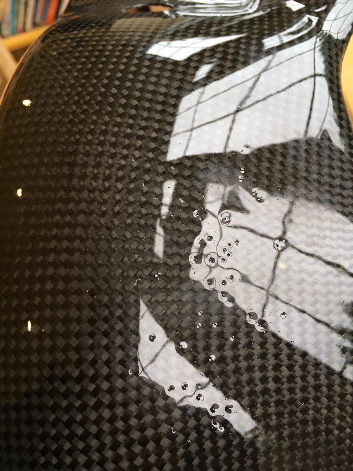

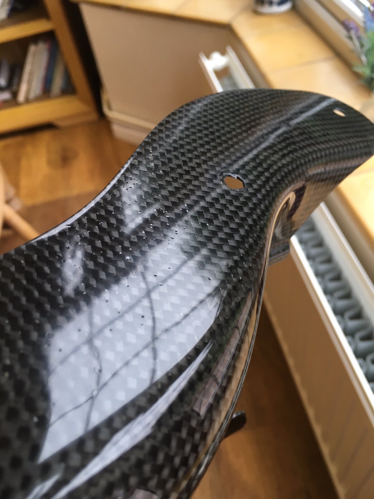

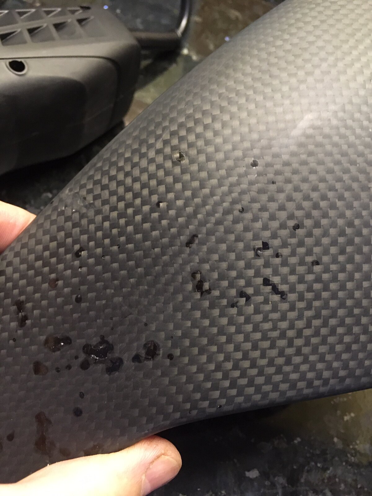

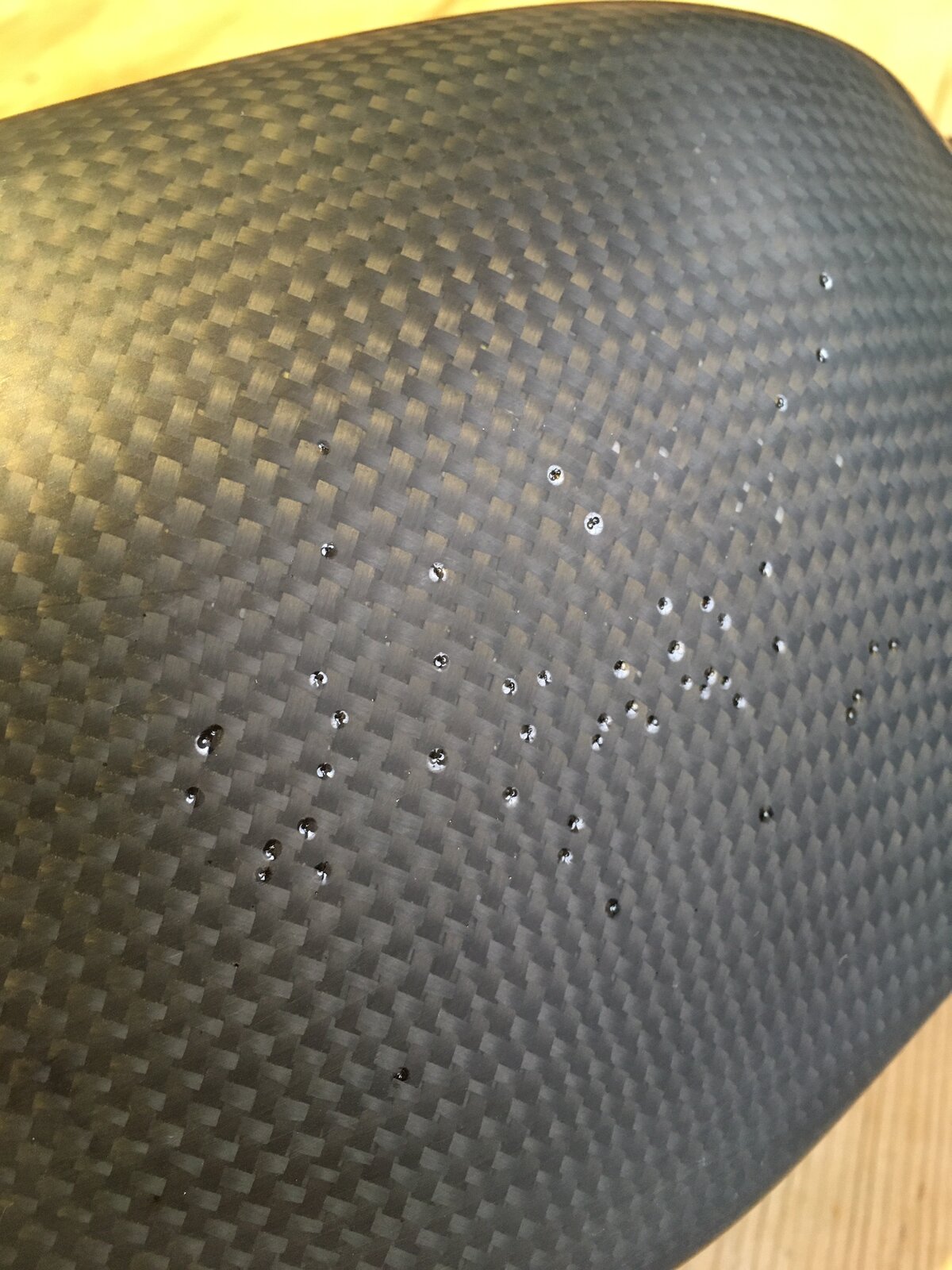

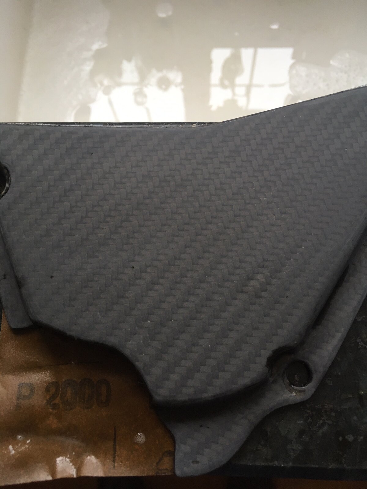

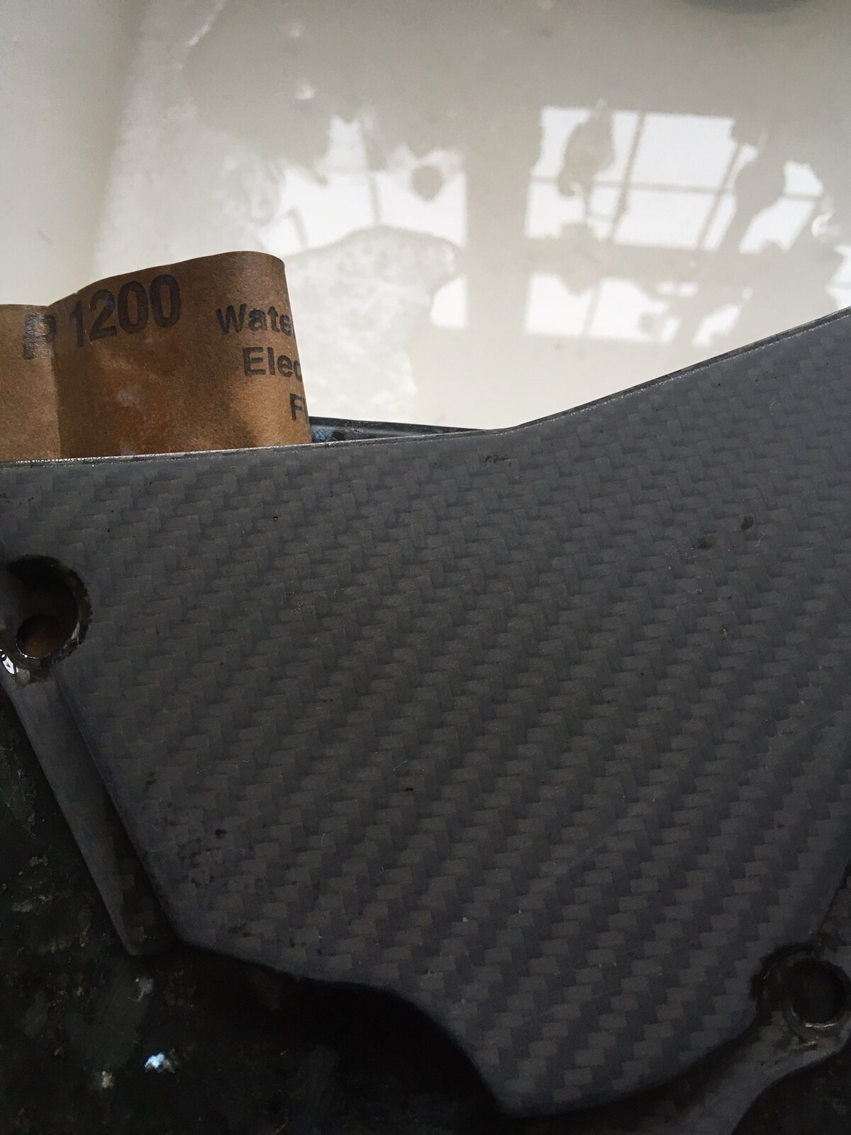

  5. Finished buggering about with my experimental fix of the pin pricks in the lacquer and also the curtain runs. No surprise, the best way would be to keep laying lacquer until the holes were filled but, as explained, I simply cannot attempt this at the moment. :rolleyes:
    The end result is not bad, especially for a fix without lacquer. The curtain run is sorted nicely. Here's what I did.
    Before shots:
    The curtain run (not so bothered about the pinholes on this surface as will be covered by the nylon chain runner):

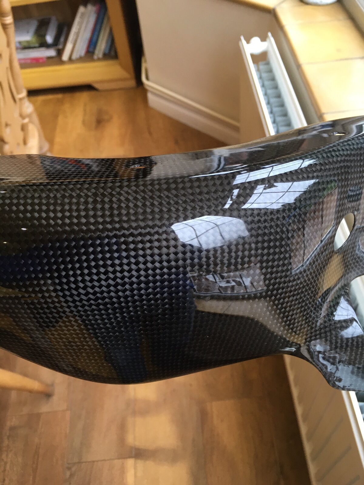

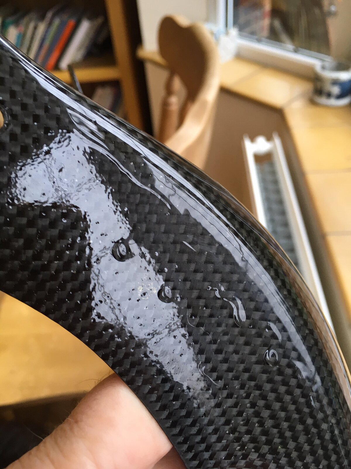

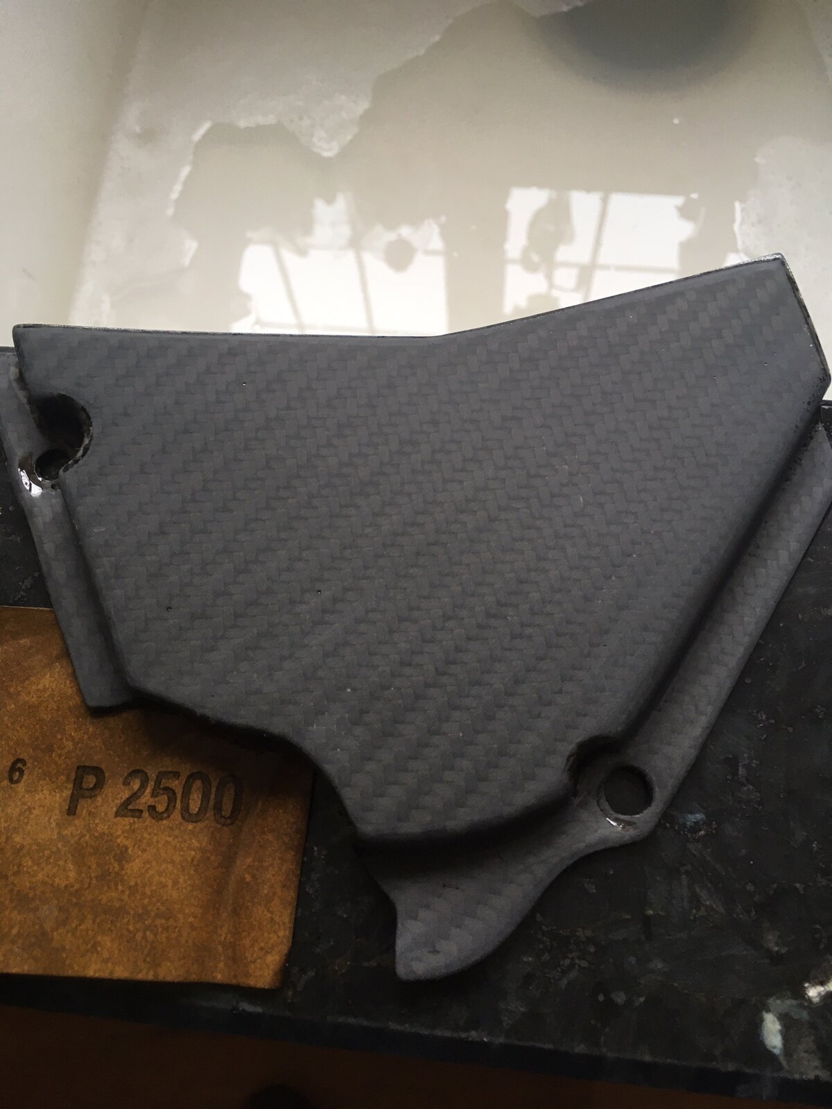

    I flatted back to show the pin pricks. Applied araldite clear resin to the pinprick areas and left to harden over a couple of days. Carefully flatted back the new resin and also removed the run by wet sanding with 800/1200/2000/2500 grit:
    Then out with the cutting compound, polish and finally wax with electric buffer:
    Like I said, not concerned about these pinpricks as hidden once fitted, but run removed
    So, not bad, much better than it was and OK for now. I would say 6 out of 10 and tried some new things along the way.
    I will fit to the bike over the next few days and post up a pic of it done. Hope this helps someone.

  9. What caused the pin pricks EJ?
  10. Age and condition of the original carbon fibre resin I think. I’ve think it must have got thin in places and the resin had stopped penetrating the carbon weave. This lets air permeate through and you get a pin prick or fish eye. It can also be caused by not cleaning the grease off a part but that is not the case here, thoroughly prepped and wiped down with acetone prior to first tack coat.
    That’s my guess anyway.

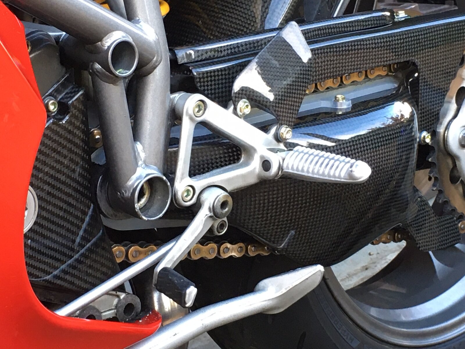

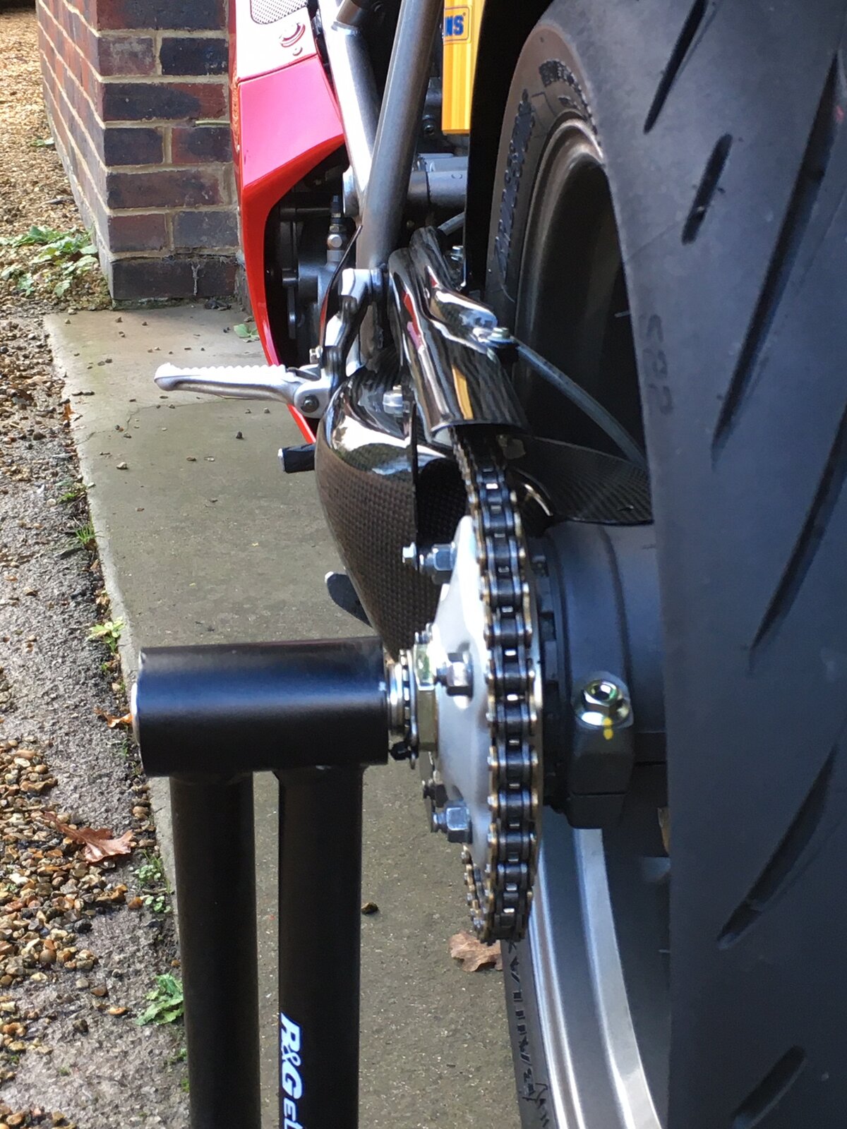

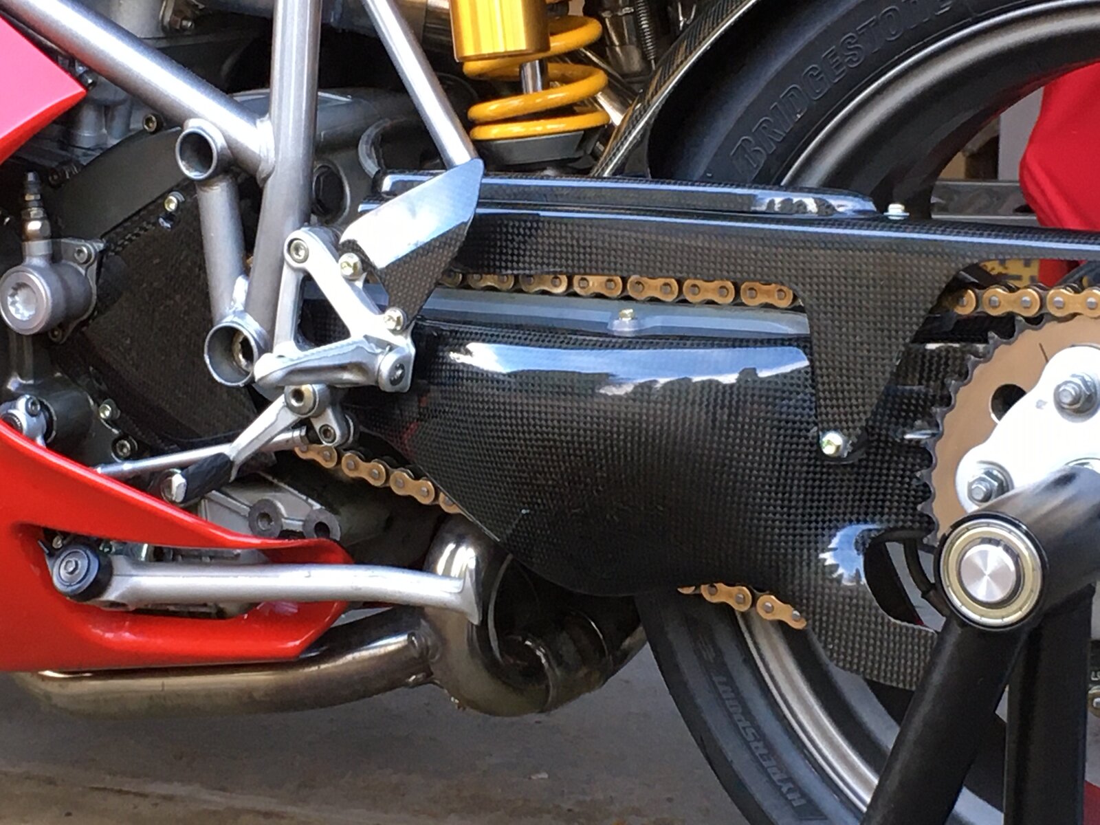

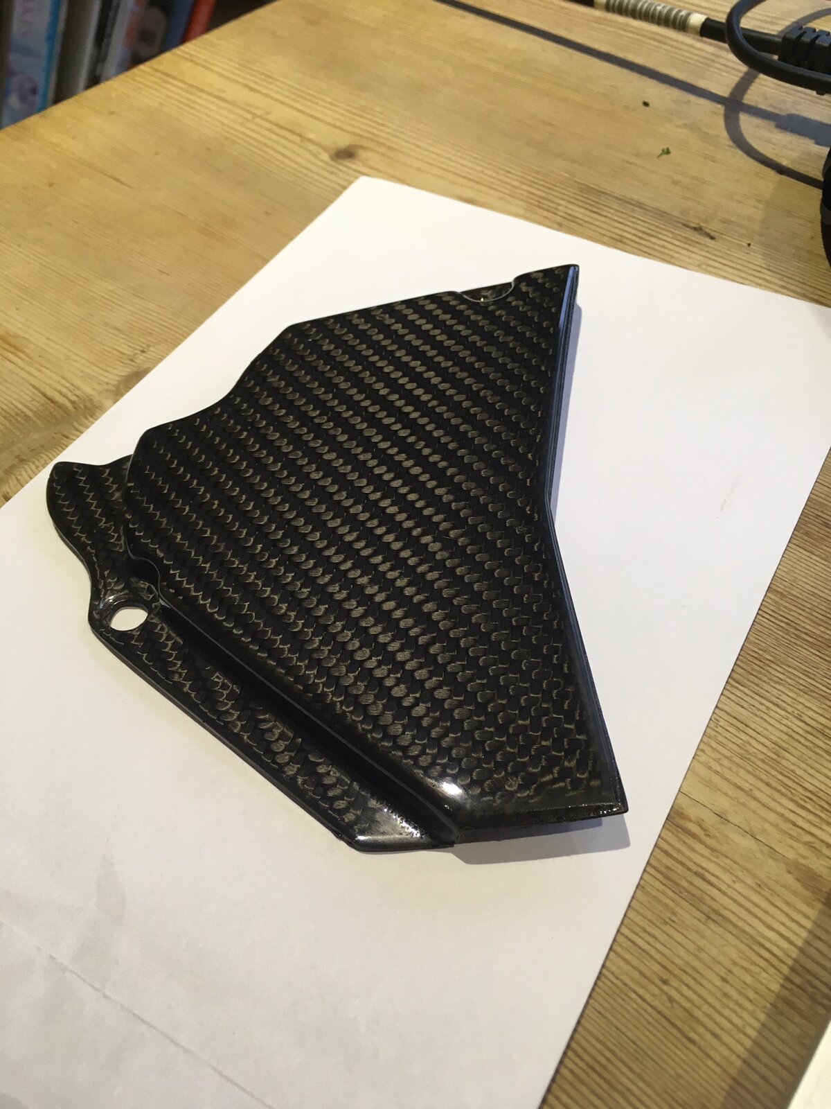

  11. And after 45 mins in the garage this morning, here is the finished product, showing both the sprocket cover and the swing arm cover. The rest of the carbon was done professionally (won't ever need to pay for this again).
    Well pleased.
    Just need to source some tasty (gloss black) rearsets per @cookster previous suggestion.
    • Like Like x 8

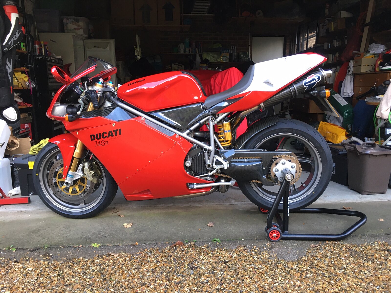

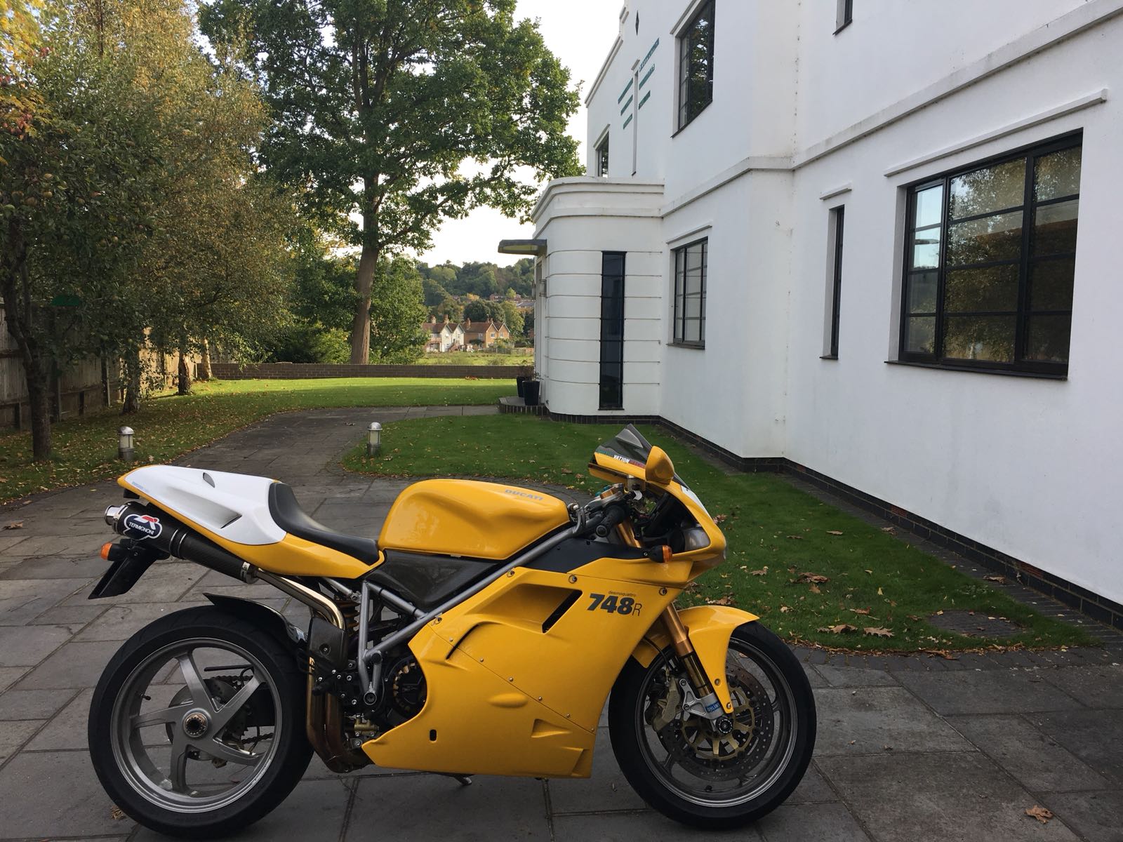

  13. Gb moto rear sets are great value mate, here's my old 748r with um on.
  14. They look great, thanks for the pic. Bikes not bad either (but what would I expect from you!).
    Checking their website they are good value as you say - £189.95 looks pretty keen. Think I might ask for a set from the Mrs for Christmas.

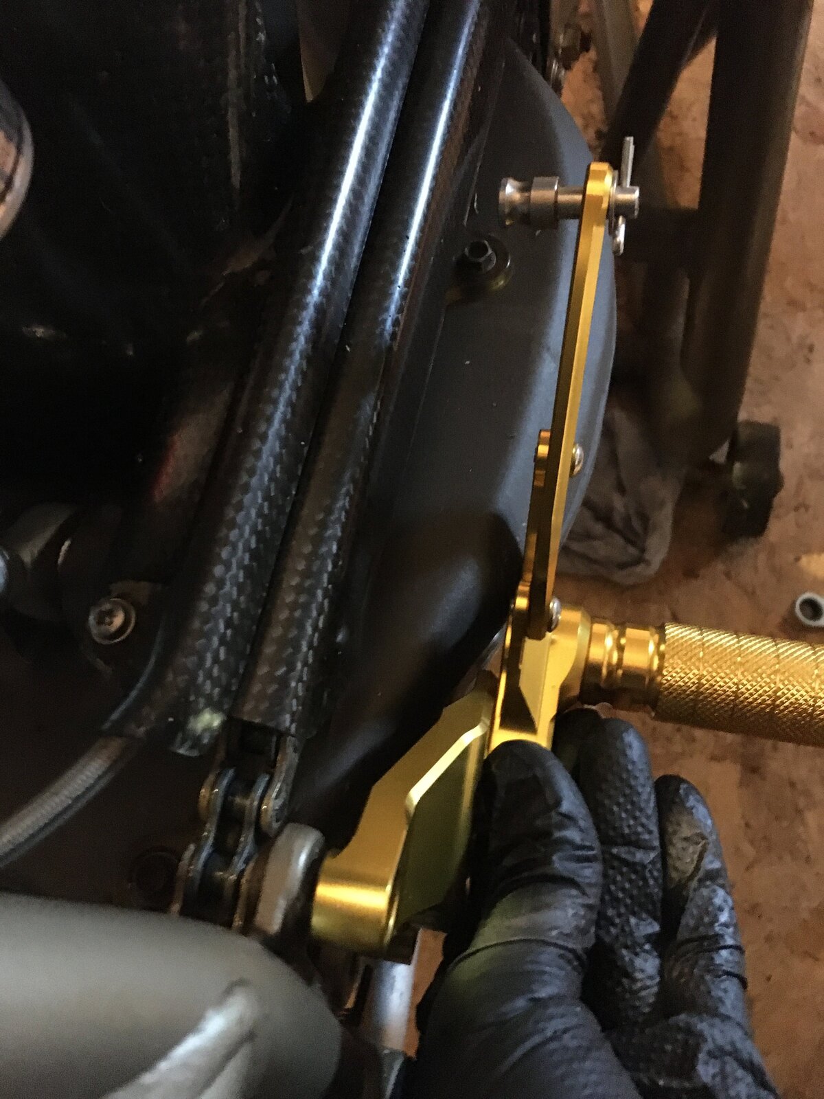

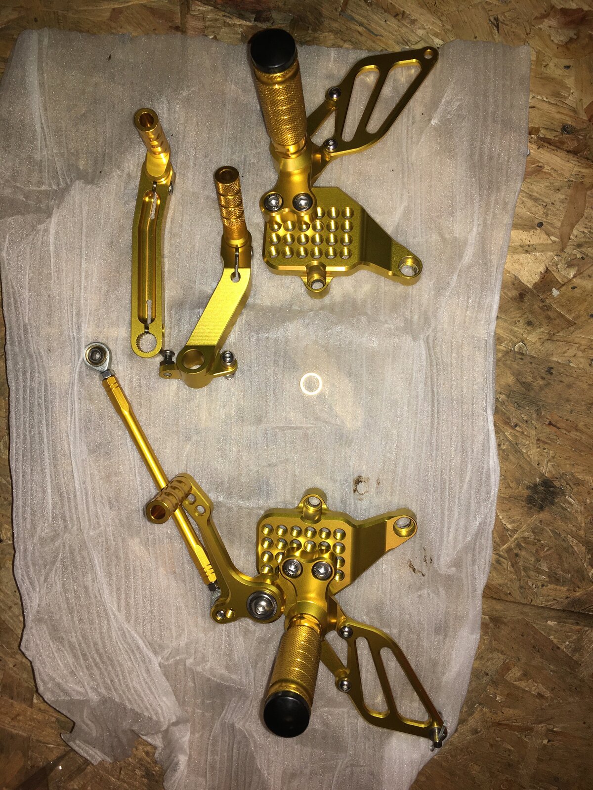

  15. I bought some rearsets for my 748, in blingy gold (being the nearest thing to yellow):D, can't fooking use them though o_O.
    Other than have the left hand peg in the most forward position on its mounting plate they'll foul the swingarm as it moves up and down. Having the foot rest in that position places it in the same position as the regular rearsets and thus, apart from looking nice, defeats the object which was to give me slightly longer between ankle and wrist (being 6'2ish).
    Unfortunately I only discovered this having removed both old sets, installed the one on the right hand side and connected up the brake and got the peg where I wanted it, installed the one on the left and connected up the gear lever, then went to set it furthest back :mad:.
    The picture below shows the peg in it's foremost position and the rear of it only barely misses the swingarm.
  16. Just wrong Paul ;)
  17. You'll be telling me a yellow Ducati is wrong next:)
  18. Not at all, yellow is one of my fave colours :upyeah:
  19. Just a little bit gauche IMHO :mask:
  20. If Jimmy Saville had rearsets...
    You can use spacers behind the mounts.
