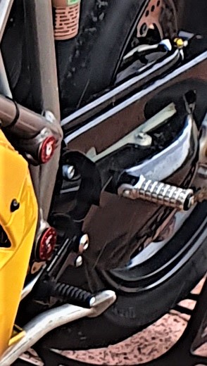

  4. I did look at that, it needs a 20mm offset on the gear lever side so as to clear the swing arm but that also moves the gear lever out of line with the gearbox spindle and at the time I couldn't work out how to affix it. I will revisit the situation.
    I presume no one likes them then :(
  5. Mate, bring out your inner Goldie Looking Chain, (only) you know it makes sense.
  6. They look alright when they're on as the bike's yellow but I can see I might just be in the minority on this :(.
    I wish mention of that GBMoto site hadn't been brought up as well:eek:, there's some nice stuff on there.
  7. @West Cork Paul, space the rearsets out then add a spacer between the rearset and rose joint on the gear change shaft.

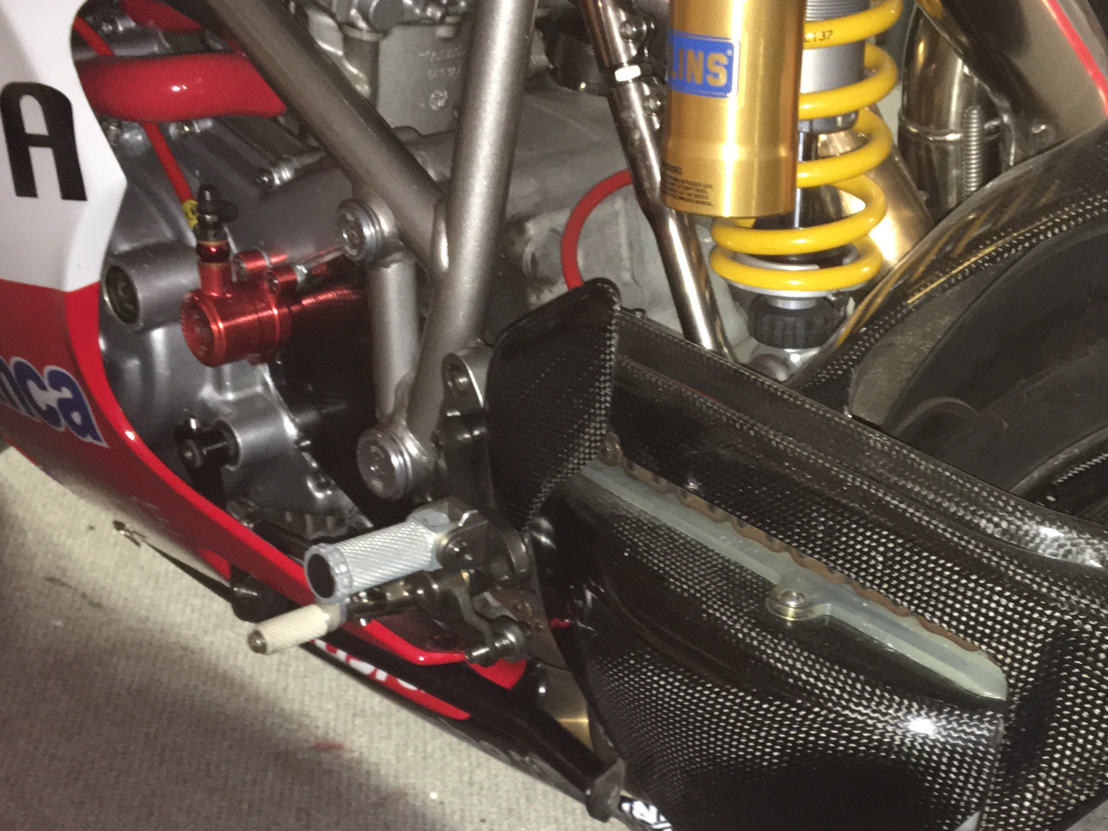

  13. The Ducabike rearsets on the 748R fit straight up without fouling the swingarm and are understated in style but a quality item :upyeah:
  14. Have you got any detailed photos of the positioning of the gear change rod at both ends mate?
    I fitted my Ducabike rearsets and couldn’t get it right
  15. Will post some on your thread mate.
  16. Thanks mate! Would be a massive help.
    I gave up in the end and decided to tackle it next year lol
  17. Just reread your post. Mine are standard rearsets but @Brouny851 has the Ducabike ones fitted? Maybe he can load some pics up for you if the linkage?
