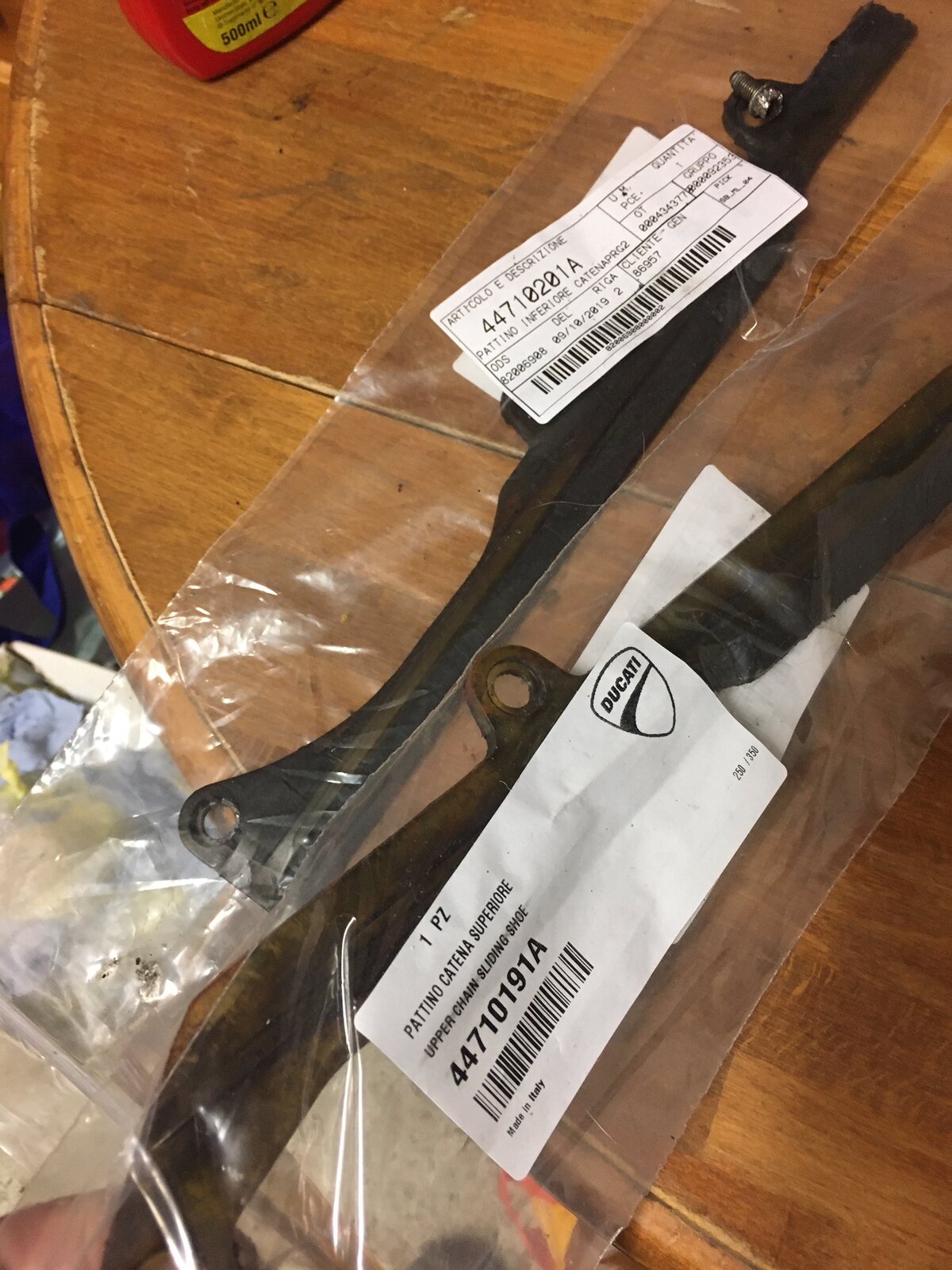

  7. Ive been a bit distracted with a new toy but have been making progress with the 748. Its pretty much back together (not ready for a finished pic yet though). Thanks to @Exige the fuel lines are back and properly located.
    I took @TelRobinson 's advice and bought new chain runners - £24 the pair.

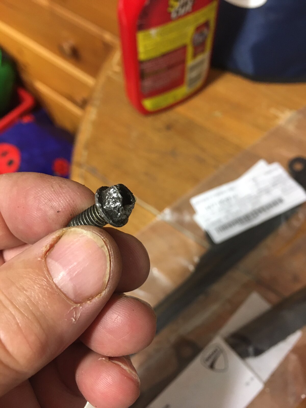

    Simple job until I got the the lower runner bolt closest to the swingarm pivot. The drive chain (over 18 years) had worn the bolt sides down so it would not accept a socket nor spanner. Much cursing, patience (I dont have an abundance of that :mad: ) and a very good pair of mole grips and I had it off within 45 minutes.
    So, if you are planning on doing this yourself, my advice would be to free this bolt before making the purchase :upyeah:

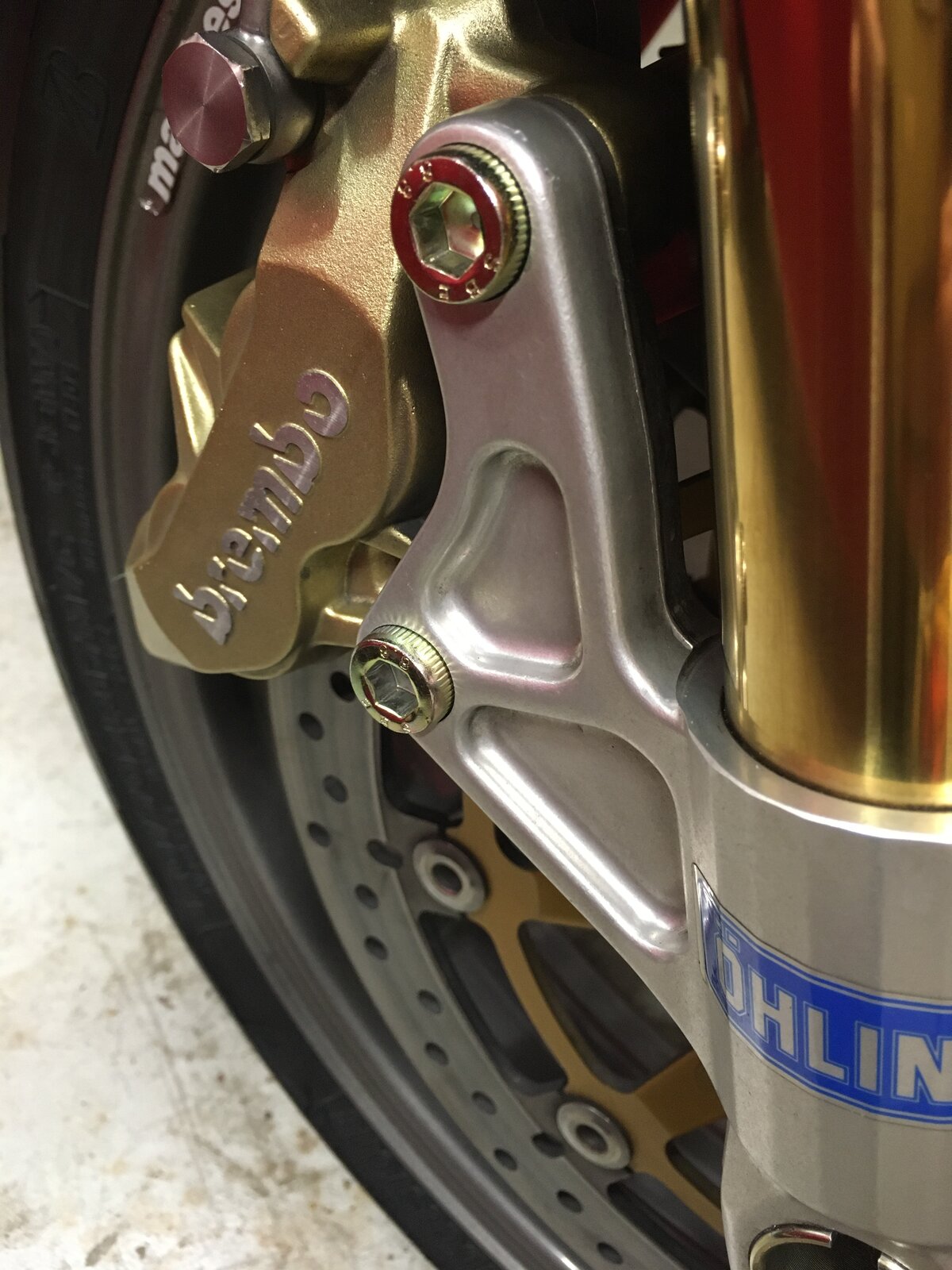

    Source a new front axle pinch bolt - the OEM part is available but apparently only HEX head (allen head for Ohlins - anyone got a spare with the ridges on the head?).

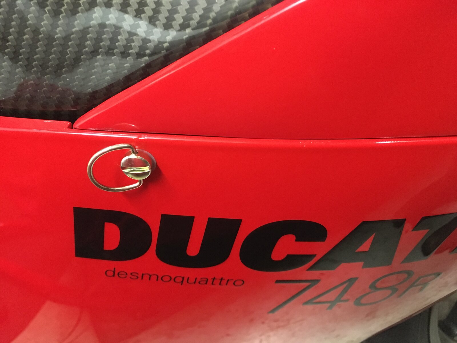

  15. Dzus.
  16. Thought you were OCD...those aren't the correct Dzus for a 748..
  17. Yup. V (too) expensive to source. But better than the Chinese black ones it came with.
  18. Buy used ones and send em to your plater.
  19. I couldn’t find any used at the time. If you know of some then I would be interested.
    The bike is for riding, it won’t be a show pony. I use my bikes whenever the opportunity arises so if does not have to be totally original. That was not my intention.
