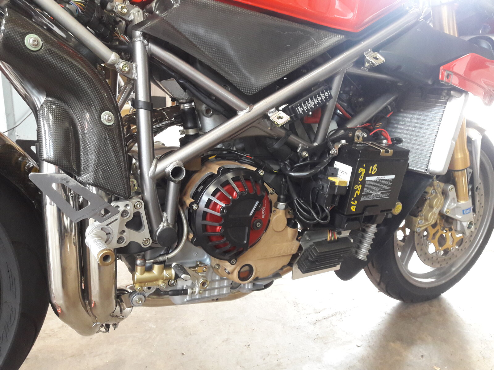

  4. You really should allow the clutch to breathe. It is likely to overheat if kept closed (hence the majority of open vented clutch covers) and the dust from the spent friction material will have nowhere to go.
    Tell tell signs it has got too hot will be a bronzing of the silver paint on the closed clutch cover by which point the clutch will be on it’s way to being fried!
    They are not just bling.
    • Nuke Post Nuke Post x 1
  5. Thanks Joe. This is sounds like advice from experience.
    The cf one had spacers fitted, no gasket with a c2mm gap. Think it could go back on reading your advice.
    Any other opinions?

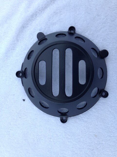

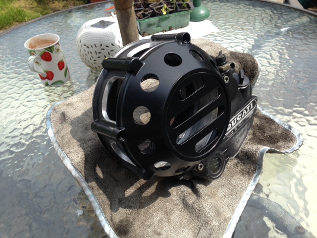

  7. Looking good :motorcycleduc::cool:
  8. Ohhhhh. Porno. Was that a standard cover at some stage?

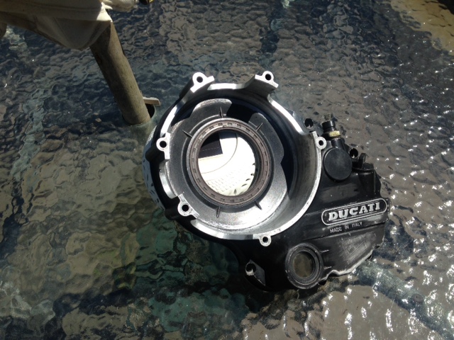

  9. Yes, both clutch casing and cover were stock parts. I used the cover from my SP4 as a pattern for the slots and holes, and for the casing I looked at various casings on google and set to with a drill, files and junior hacksaw, and voila... :upyeah:
