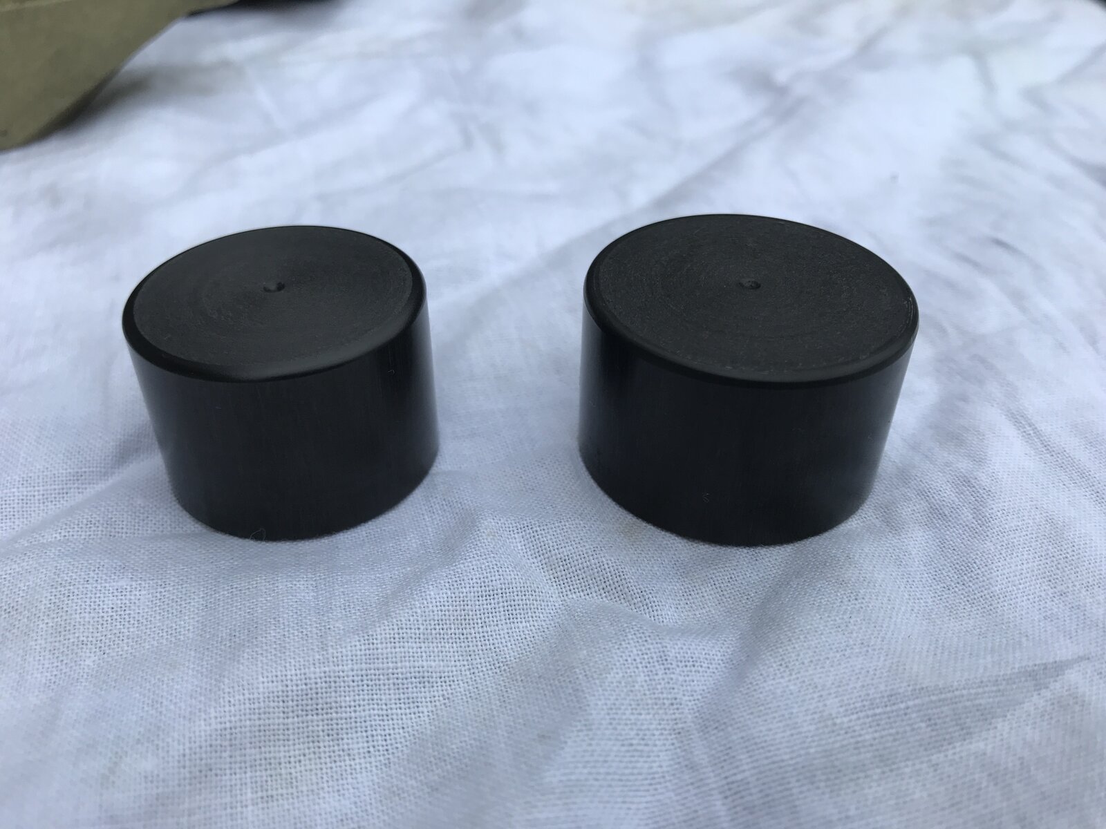

  1. 8D5EA537-693F-4B4B-9F1B-7DA72A436FD5.jpeg Morning all.
    My front discs are starting to warp, giving a bit of brake judder, and been told to replace them before the next MOT. I’ve got the standard ‘snowflake’ design but can’t seem to find anyone that sells them, so assume they’re no longer available. I don’t take the bike on the track, so fast road use only. What would you recommend replacing them with?
    Thanks

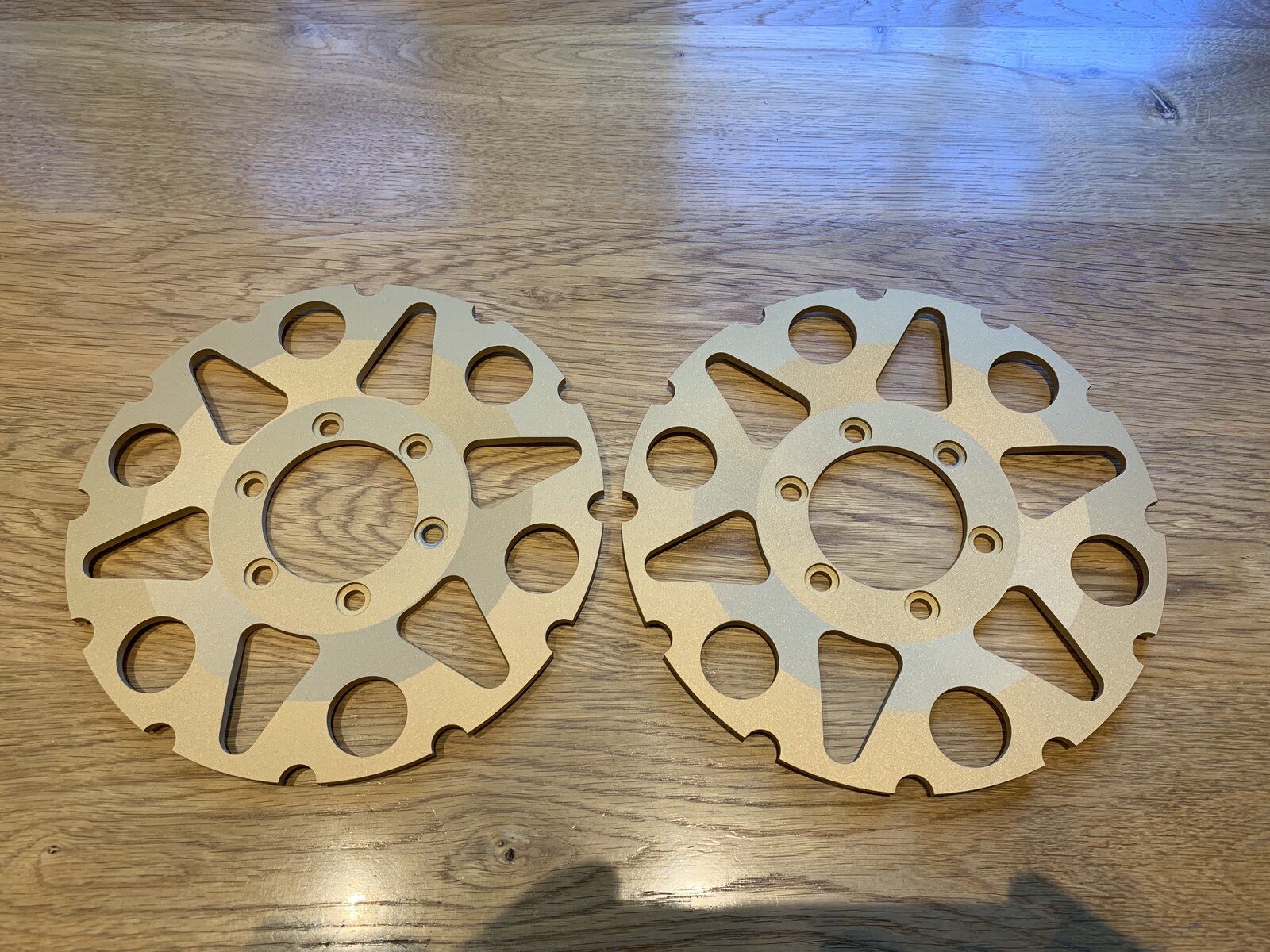

  7. I made a bunch of the disc carriers and in the slightly older style. as long as the discs are true, quite often the judder is down to the worn carriers, as they are made of softer aluminium. I got these ones made with T7075, so much tougher and they made a real difference on my discs. The rotational wear is the biggest problem, when combined with the side to side "float"
    Mine are the 12 bobbin discs, rather than the 10 bobbin ones that I think you have on your bike.
