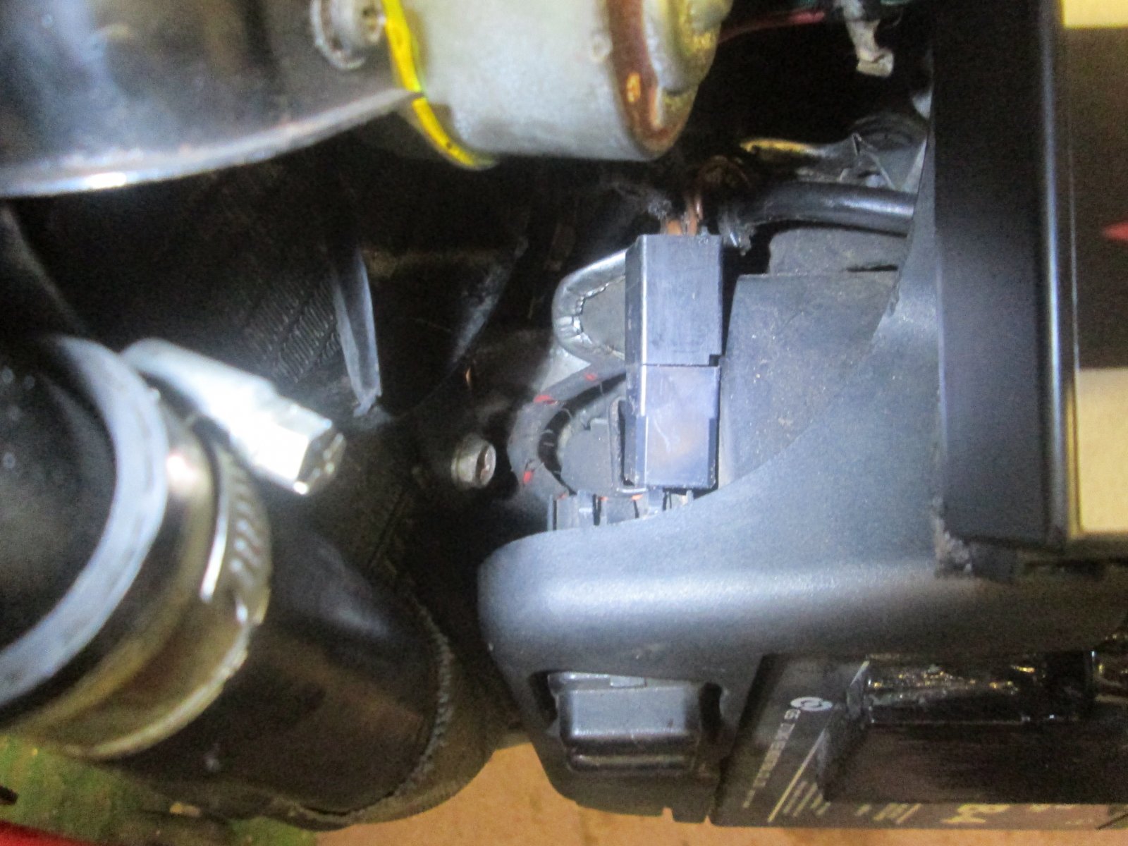

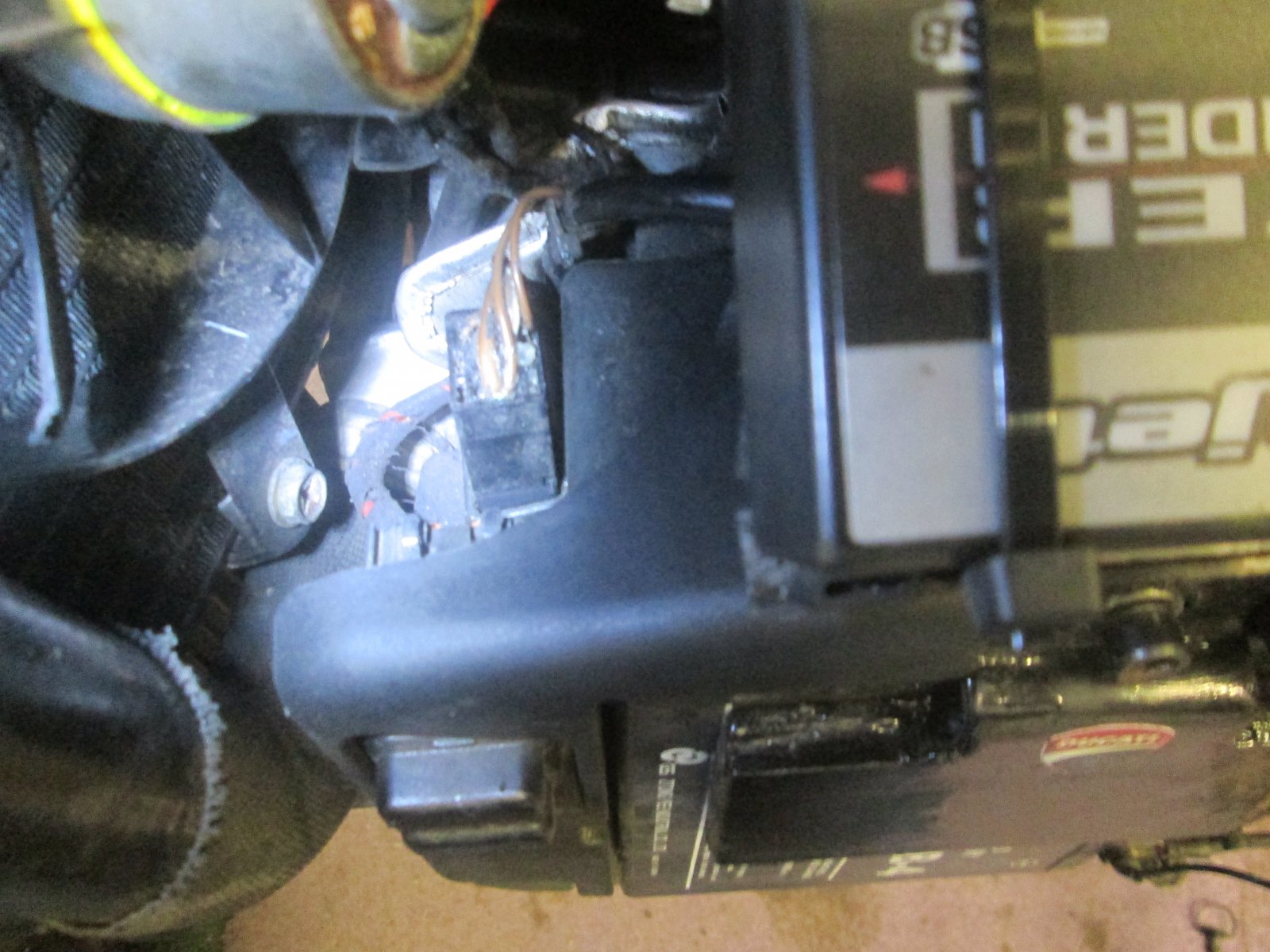

  13. any photo of relocation ( will be doing that this week,, any help appreciated )
  14. There`s quite a few threads on it. I think a guy called Chris has posted a few times on this mod.
    The relay is behind the battery box heat shield, the hardest part (if you`re unlucky) is getting this heat shield off the battery box. The relay plug has enough wire to move to the top of the battery box so there`s no need for any altering of wires, there`s a square rubber mounting point that the relay fits into. Ducati must have known.
  15. thats good mate,, thank you,,, i already have it out and replaced and was wanting to relocate it but was not sure what to do with it,, ( not even having tried yet ), but now i see where you have it and i can appreciate that .:upyeah:
  16. No probs, glad I could help.
    I did consider lengthening the wires and mounting the relay further up the frame for even easier access. I decided against it though, the thought of the extra bad connections I might introduce put me right off the idea.
  17. ha ha,, exactly my thots !! i will try where you have put it..:upyeah:
