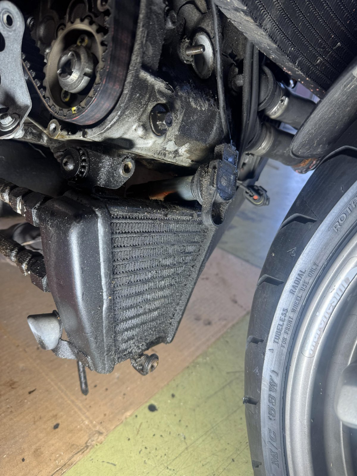

  1. I am new to my 749 and was in today getting it knocked down to do the belts, service items and a few other jobs and have found it is leaking oil.
    The oil cooler fins are quite clogged with oil gunge but doesn't seem to be leaking itself. Obviously leaking from a long way forwards though.
    The engine is generally a bit oily but no really obvious dripping (with the engine off currently)
    Once i get the engine back together i can clean it and then run it up and see what i find in the way of leaks but i didn't know if it looked familiar to anyone in advance so i can pre-order the required spares.
    Have attached a picture below hopefully. It is giving me a cam cover gasket feeling or the sealing washers that seal its retaining bolts.
    Any thoughts gratefully received
  2. wheres the highest point on the cases you can see signs of oil

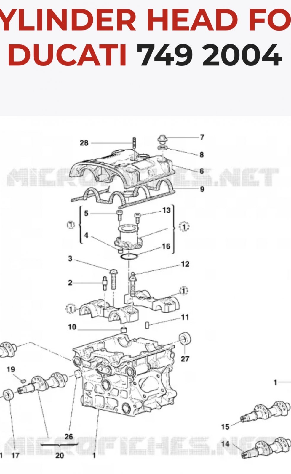

  3. The flanged nuts holding the cam cover down have seals underneath.
    All of them on my 999 were weeping when I got it and needed replacing.
    Worth checking the crankcase breather is not clogged too as it can cause a weep at any weak point.

  6. I’d wager it’s from the valve train cover to cylinder head interface, regardless of the fact there’s a gasket there.
    Take it apart, clean it up and apply a smear of 3Bond 1215 (or equivalent) to the gasket mating faces. That will prevent a reoccurrence.

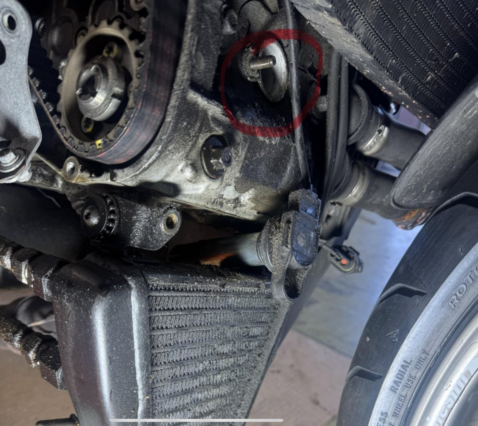

  7. The ‘stud’ circled should be a bolt.
    I have seen occasional oil weeps from this on my bike if it is not correctly tightened.
  8. Just had a bit of a look and it’s really hard to tell as the air moving through the fairing has distributed it fairly evenly by the looks of things

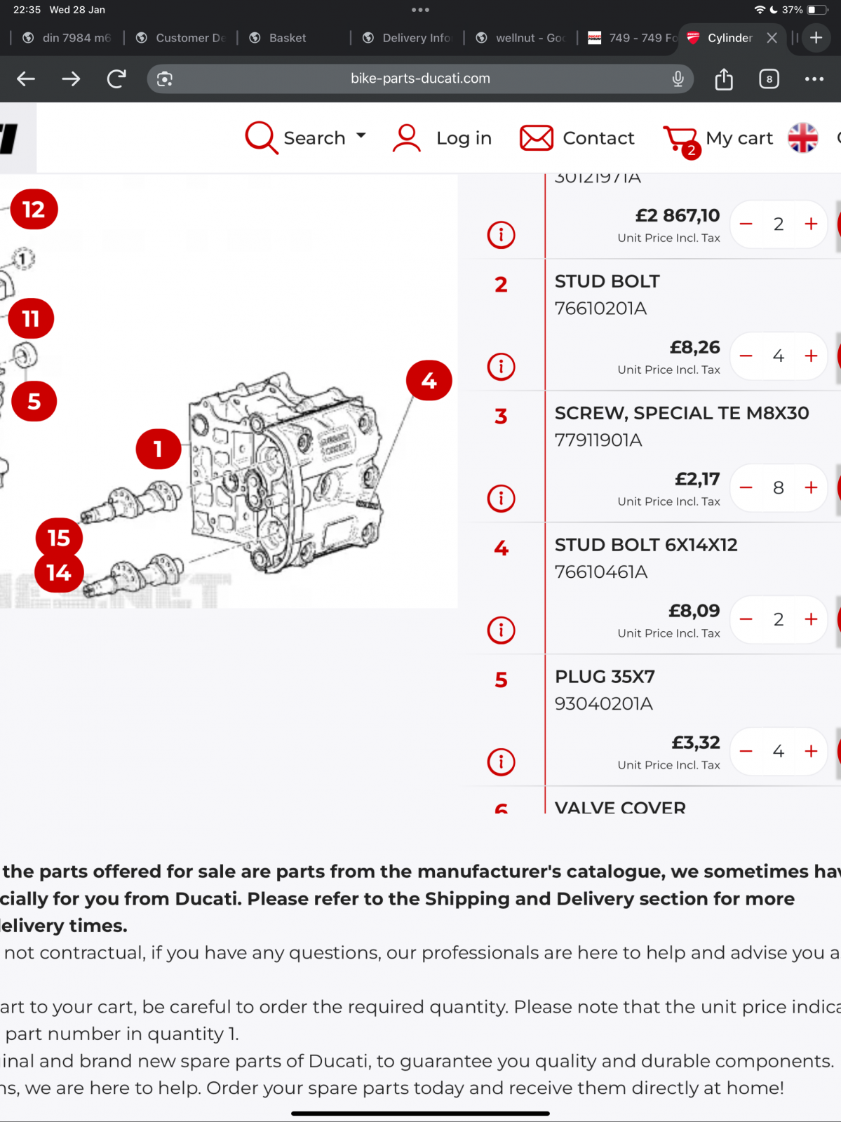

  9. good to know I think i should get a set as a matter of course so I can swap them when it is clean, ta
  10. Ok, the mount for the ignition coil? It shows as a stud and nut on the exploded diagram, are you saying change it to a bolt to seal better? Thanks for feedback
  11. Ok, will do, thanks
  12. ok, so extract the studs and replace with a bolt?
    • Disagree Disagree x 1
  13. Both my 749Rs have a bolt rather than a stud securing the coil.
    Not sure if that's standard but that's what they came with.
  14. No, he means the flanged nuts that secure the valve train cover to the head. They have a green viton washer underneath. That washer perishes with age and can leak.
    Part 7 is the nut, part 8 is the washer.
  15. I agree, I would be replacing the green viton washers and the gasket too (part#9) as it becomes stiff with age, mine leaked from there too, simple enough job to replace. :upyeah:
    Ps: I seem to remember it was tricky getting the gasket to seat correctly, so one to check...

  20. No, I do not mean those.
    My suggestion related to the coil attachment stud (Item 28 in your diagram) - both my bikes have a cap head bolt and washer attaching this, rather than the stud indicated.
