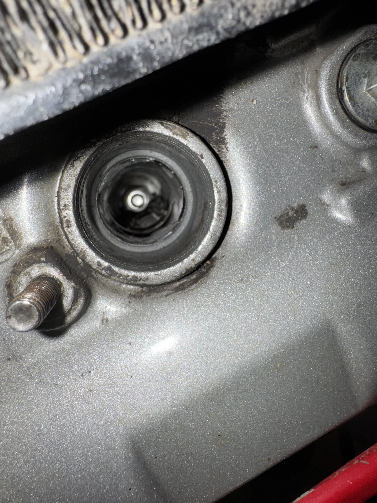

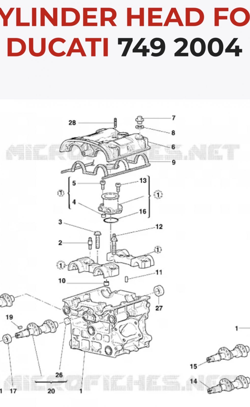

  2. I have a similar problem on a 999. I found oil around the H Cyl spark plug. I found this before it had spread further. Looking at this image, the tube, which is part of assy 1, seemed to be the culprit. The manual said to NEVER remove this and so I didn't. I replaced the cover gasket. I'll have to wait a couple of months before I can properly test this. Maybe mine is in the early stages of this issue. In my image, the shiny area below the plug is oil! IMG_3336.jpeg

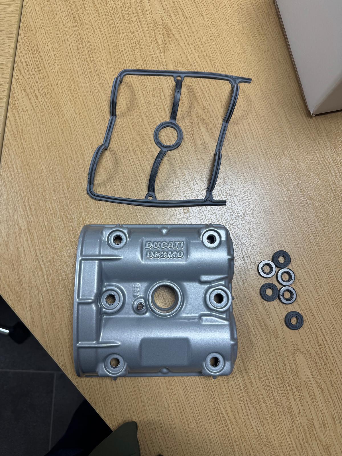

  3. Can't find industrial replacement for these washers (bonded nitrile lower/ steel upper face), looks like i need genuine.
    6 washers @ £8 each + delivery and 2 week leadtime, that's a decent coin for a few washers!
    They seem to be a sensible design (metal face to allow bolt to turn without snagging and bundling up washer) but would have been better if they existed elsewhere.
    Based on comments above, people are having success with a plain sealing washer , was looking at nitrile as it is "A" for compatibility with engine oil, is that correct.
    I have a week or so until cam cover is bac from powder coaters

  4. The valve train cover/cylinder head gasket also commonly leaks from the centre O part around the spark plug channel which allows oil to collect around the plug. Remove it, clean it, apply a smear of ThreeBond or similar RTV sealant to both sides and it will fix it.

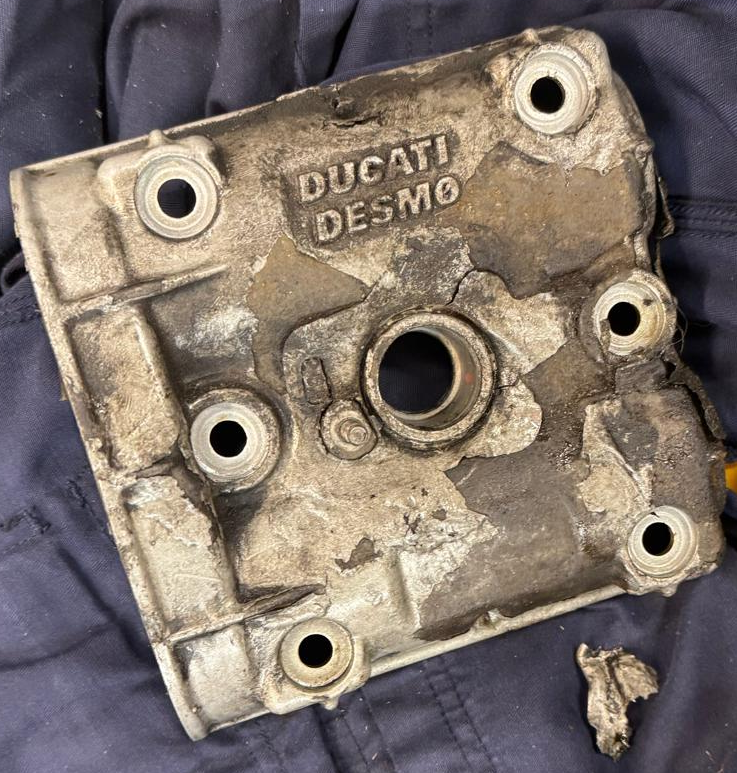

    Quick before and after images on the cam cover and various seals.
    Cam cover nuts treated with phosphoric acid solution to derust
    New plugs once the cam cover is on.
    Oil and oil filter once i have finished potentially getting crap in the engine
    Reassemble, just need air filters

    • New horizontal cam cover sealing washers and gasket
    • Repowder coated cam cover

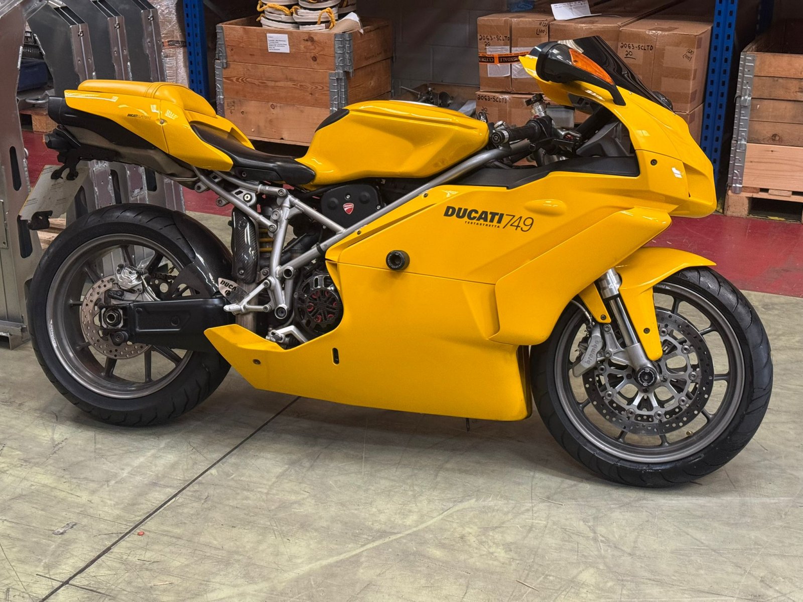

  7. Don't think we realised that it's the faster-colour one!;) Nice.
  8. I thought the golden rule was always big Ducati = red, small ducati = yellow?
  9. Mostly, yes, but I'm not keen on the 749/999 in red.
    I know - I'll get me coat!
  10. I am debating black wheels and black side blades currently. Maybe just wrap the blades so it is reversible
  11. My "small shakedown ride" ended up being 250 mile round trip Bedford to Hereford and back in the rain, mud, cold and dark over 7 hours with my other half on her bike. It all seems to have behaved so i am going to count that as a win! Will take bodywork off at some point to check oil leak situation.
