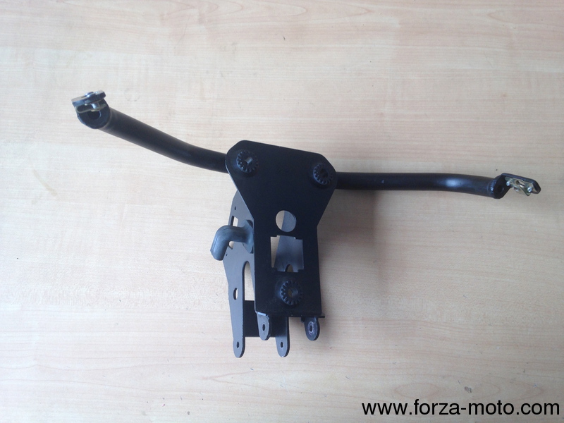

  1. Yep, that’s it. Just holds the clocks and the top of the Fairing. Works a treat with Fairings similar to the ones you have got.
    Everything held on with dzus...takes about 4 seconds to remove everything.

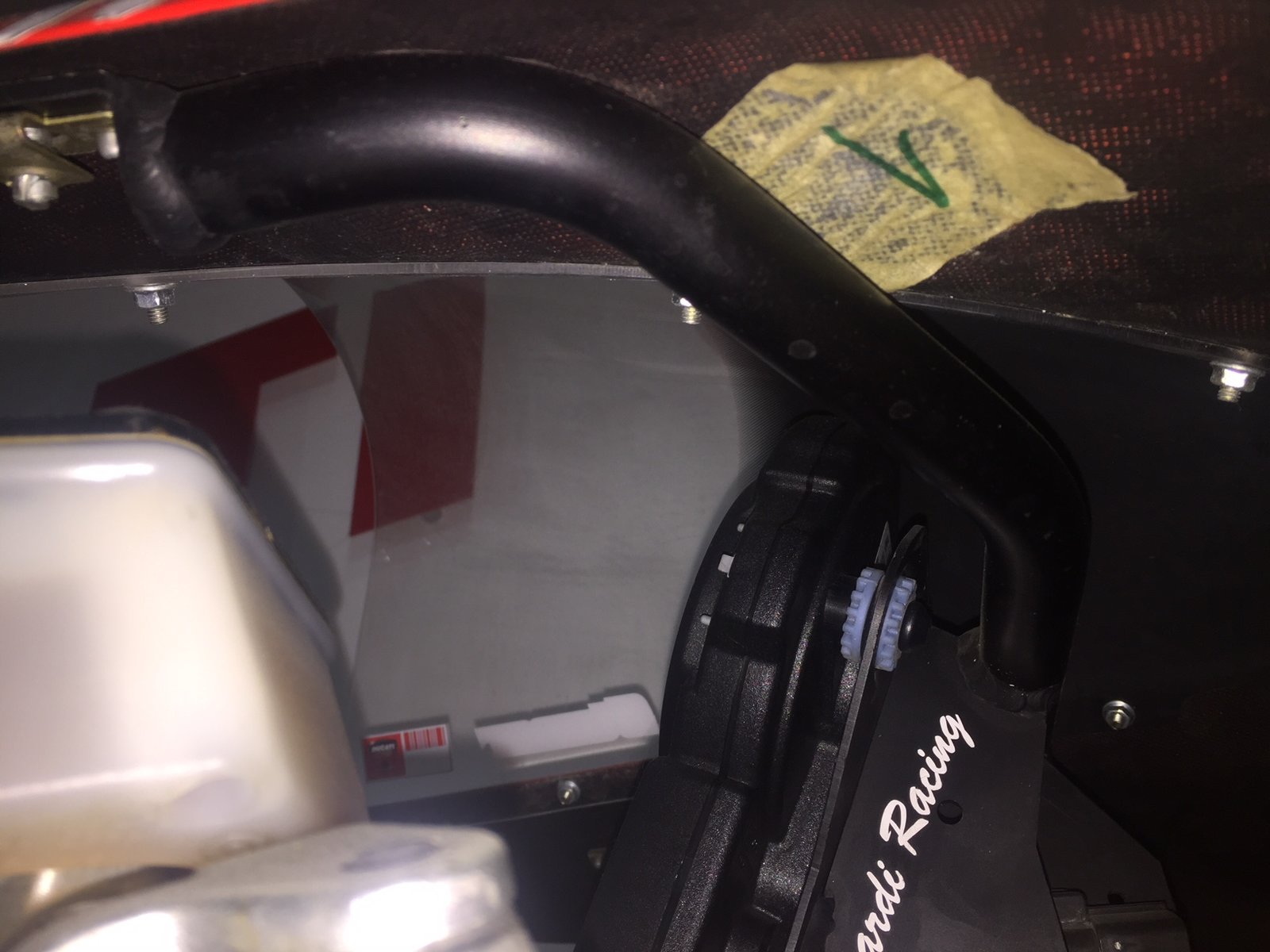

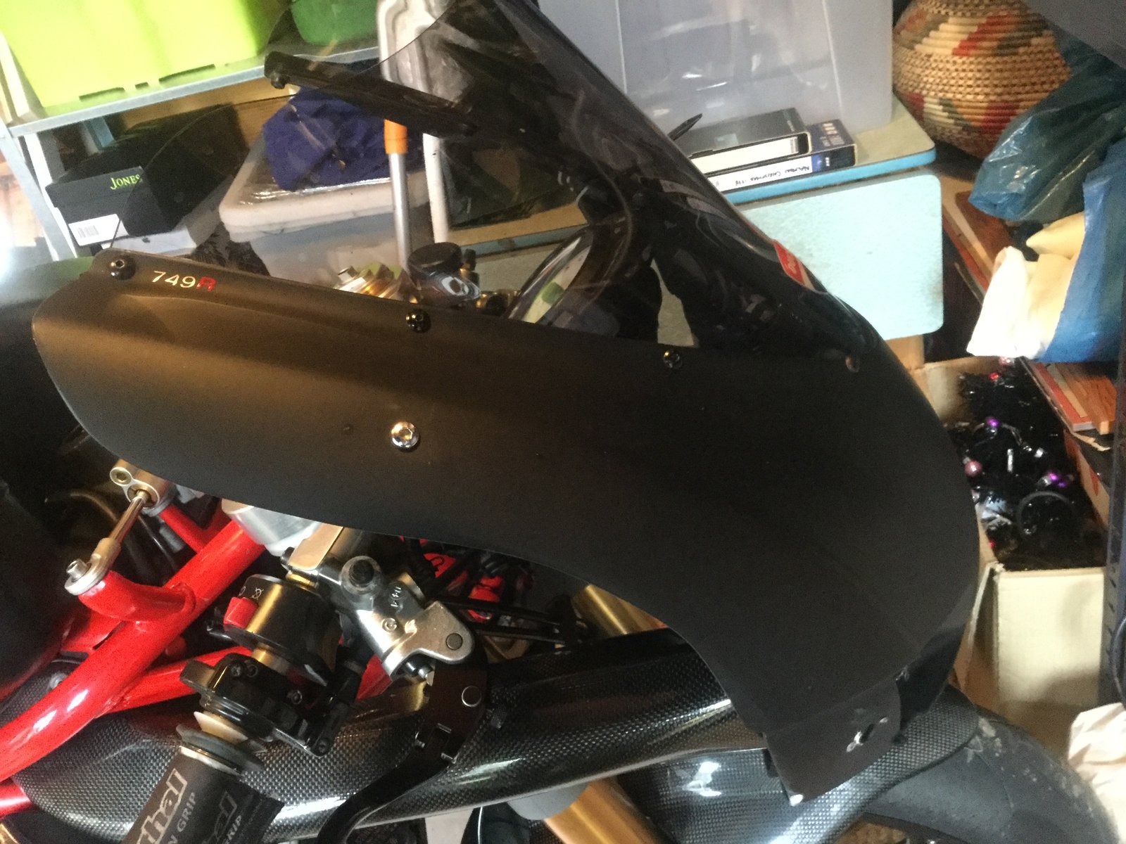

  5. Here's mine - should give you an idea...

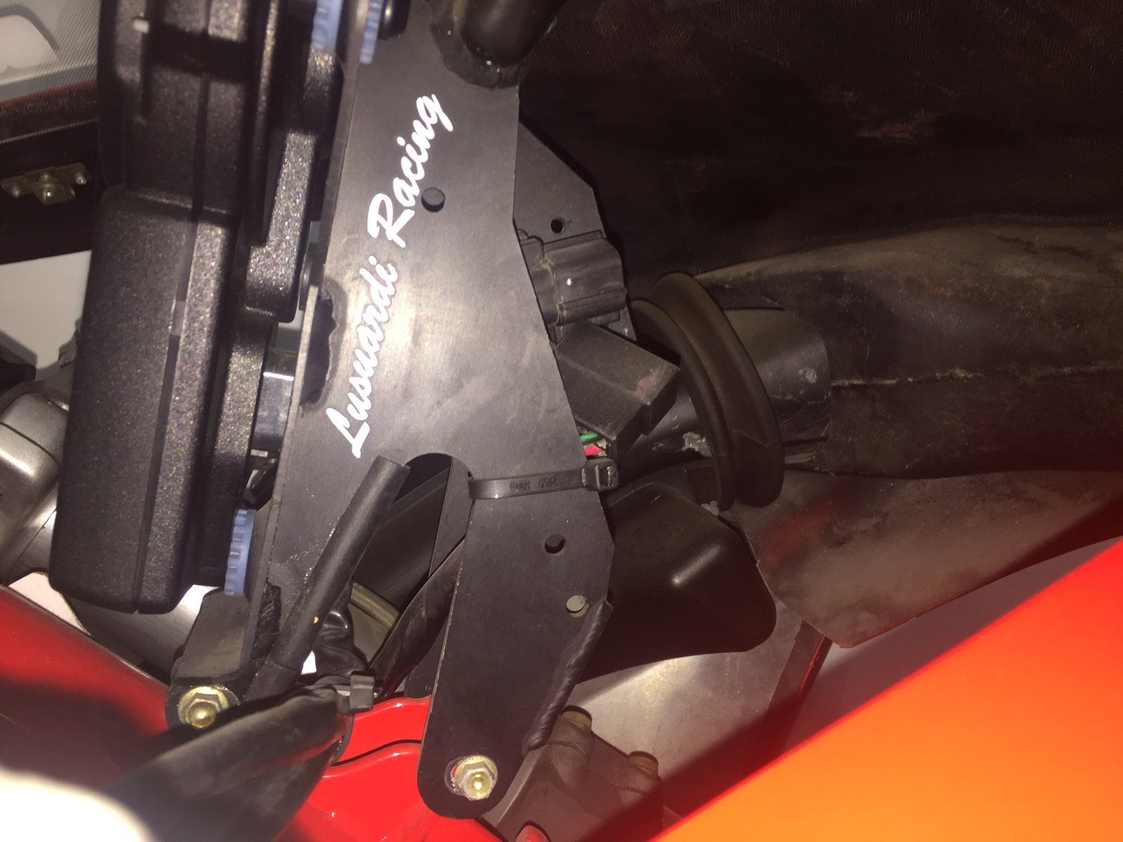

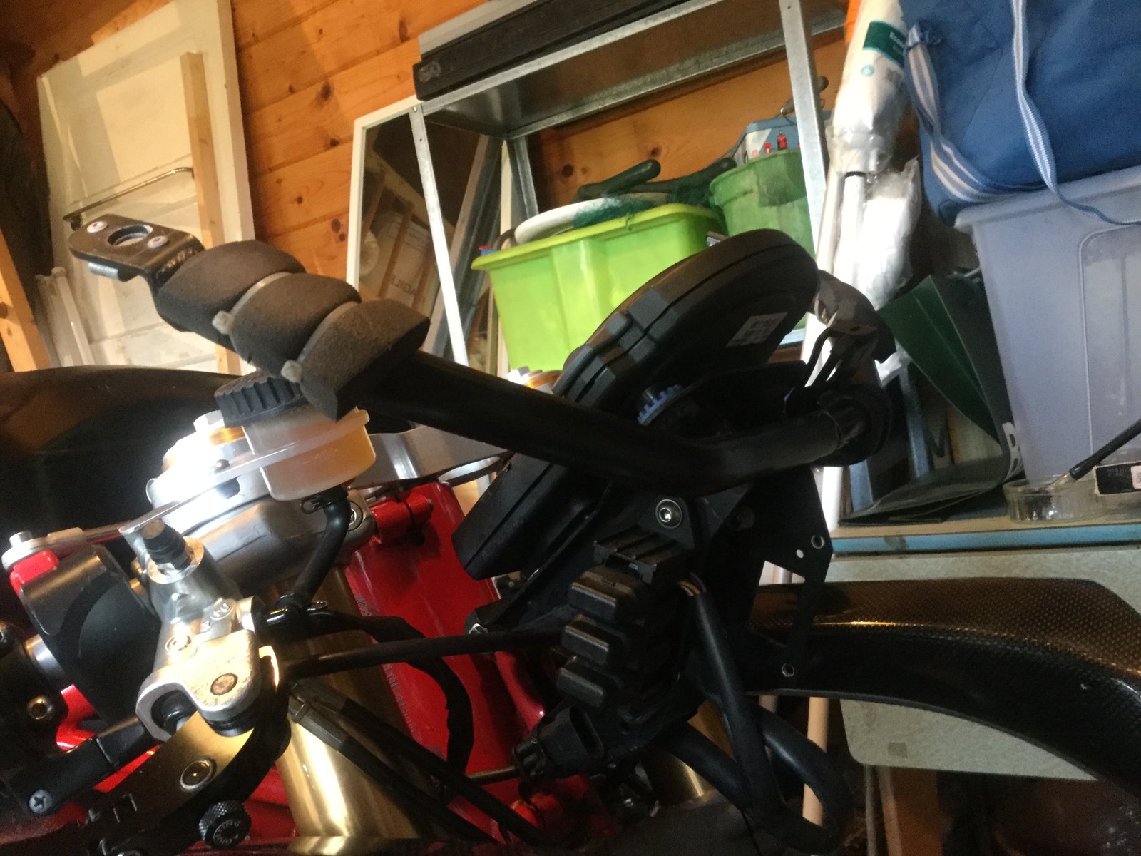

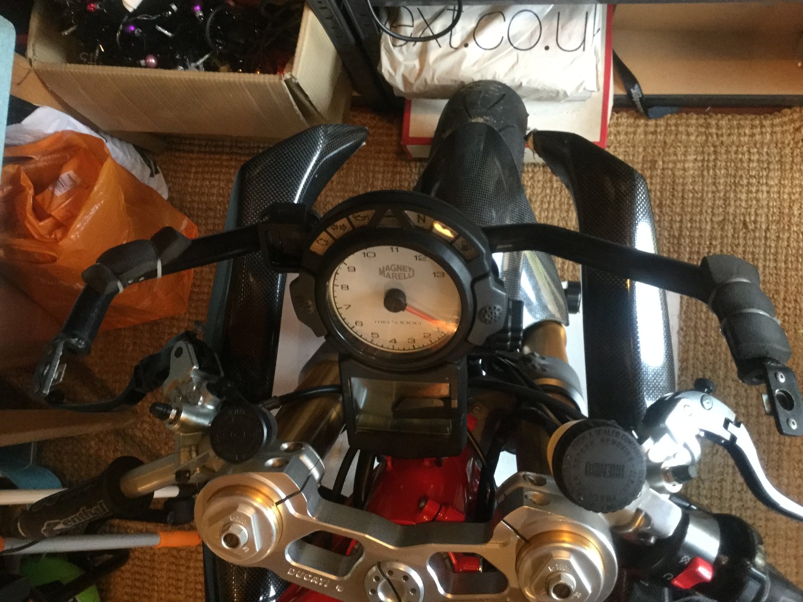

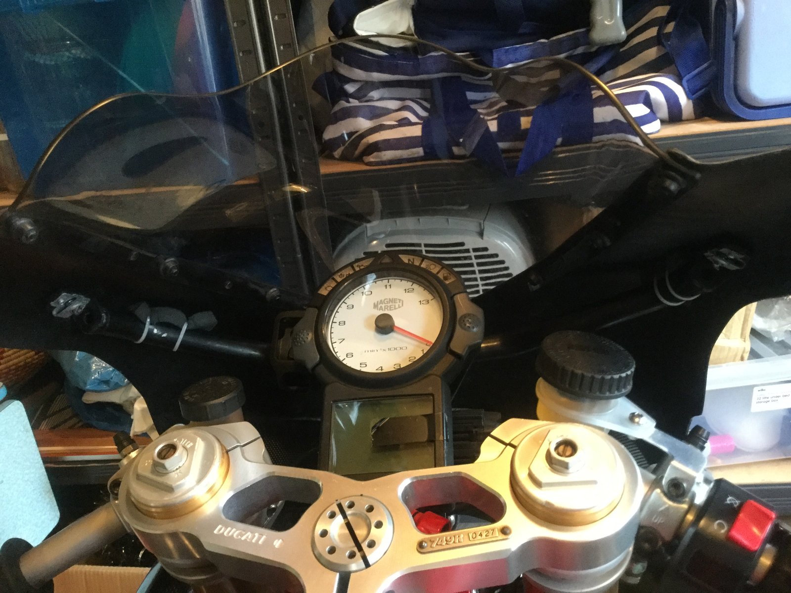

  6. @chizel here’s some pics.
    The Fairing attaches with one dzus each side near where the mirrors normally would fit.
    No attachments at the bottom of the nose.
    The side Fairings then attach to the nose with one dzus each side next to the intake hole.
    I have a separate belly pan that attaches to the oil cooler bracket at the front and I made some brackets near the brake pedal on the right and one that protrudes above the side stand. These hold the back of the belly pan.
    The side fairings have 3 dzus along the lower edge to attach to the pan.
    It’s all very solid and doesn’t rattle around at all.
    5B2A9FB4-E37A-4053-B781-100330289BBF.jpeg B51353C2-DCAC-4CF2-9816-D53FCF12B4BC.jpeg A4930712-5BAB-4332-9A3C-A2263603E230.jpeg D3421CD5-7DD2-40AF-B8FA-519D4497A10A.jpeg
  7. Ahhhhh. .. that all makes sense...
    Lot better idea of what I'm looking for now, thanks dude!
    Just rang the guys in cookys link and they don't stock the db holders ones any more but are gunna send me a pic/info of the ones they can get in for me ..

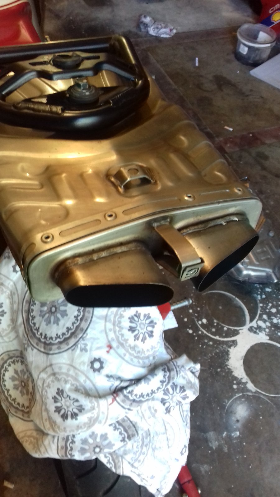

  14. Termi cans have straps and rivets.
    OEM are just welded.
    My bike came with a gutted oem can with termi size outlets and is straight through.
    #38 Old rider, Nov 11, 2018
  15. 20181111_112440.jpg looks like it's stainless maybe? Certainly different material the the 2 standard ones I have
  16. Is it an asymmetric system? Are the inlet pipes to the silencer the same diameter?
