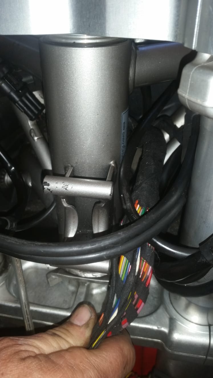

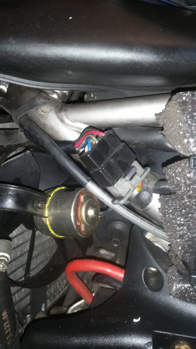

  3. Is that it in first pic? What happens to the mass of cables in the 2nd?
  4. the first pic is the ign switch etc
    the second picture is what that new front loom will connect to..
  5. so there is a connector further back on that big loom? i cant see one, do i need the air box off or something?
  6. That’s not it - it’s further aft than that.
    Why have I got a German flag next to my avatar??
  7. spy?! i think i have found the plug, its a big round job just above the battery box and links ti that ignition one... it was behind the powercomander that was cable tied to the frame... looks like i have to remove a bit of stuff to get that section of loom out between rad and frame etc... and install new one...hard to see in there... but it looks like the one on ebay has correct plug.. is £90 reasonable?
