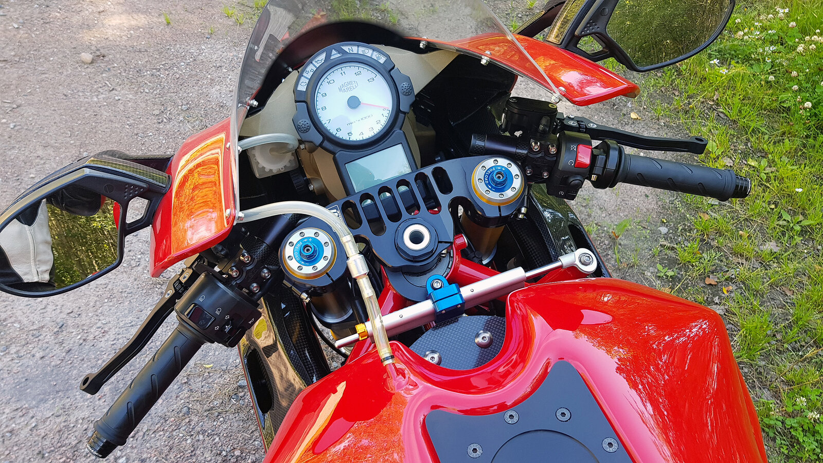

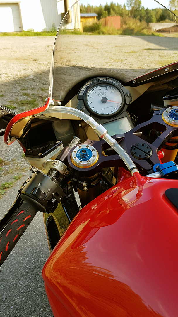

  8. It builds up quite a lot of pressure when the fuel warms up. My Beater tank made a proper bang when you opened the cap after a while. Ended up drilling through the valve to retain the original look.
  9. Maybe I've got this wrong... but isn't that the point ? It lets out excess fuel vapour pressure ? Is your valve on backwards ? My 888 flowed OUT... not in
  10. I can see the flow arrow pointing the wrong way. @jusutus
  11. the OEM fuel tank uses the oem filler assembly to vent rather than the through a vent pipe and valve like the older bikes.
    The beater tank won't have those internal pathways, and the race filler caps don't have any contingency for bleed-off unlike the oem assemblies do. They're just a ring seal and a cap, which means that there's nowhere for anything to go unless you introduce an auxiliary venting system like on the 851/888/900ss etc.
    Its the mistake lots of people make when they go and buy a cheap and cheerful race filler and then wonder why the bike suddenly gets fuel starvation as the cheap race fillers do a great job of blanking off the pressure bleed-off port.
    Also, don't forget the '49r has it to homologate it's use on the WSS kit, which is why the regular xx9 didn't get it.
  12. @Serjames enjoying your instagram content btw!
  13. I guess it depends on the valve, mine definitely wasn't two way. If I were to put it the other way around there would be a vacuum in the tank when fuel is used.

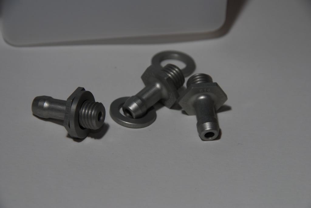

  16. Does anybody have those 10x1.5 male barb connectors to 749r tank? I found only couple in ebay and they were a bit large shaped. The ones in this picture would be perfect but where to get these? upload_2025-6-17_13-47-4.jpeg
