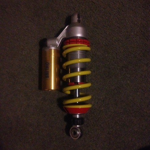

  3. here it is, ill be buying it no matter what as ive bid on it. wouldnt do that that to the guy.
  4. mmmmmmmmmmmmmm red bits.....
  5. personaly i think the red bits look sh*t. it will be taken apart red bits striped and polished. and service the shock its self. did some google and ebay searches and it look identicle to 916/998 shock.

  14. fingers crossed it is an "R" shock, i have some doubts personaly
  15. here she is , [​IMG]
  16. and the ohlins sticker on the can is 90 degrees out........

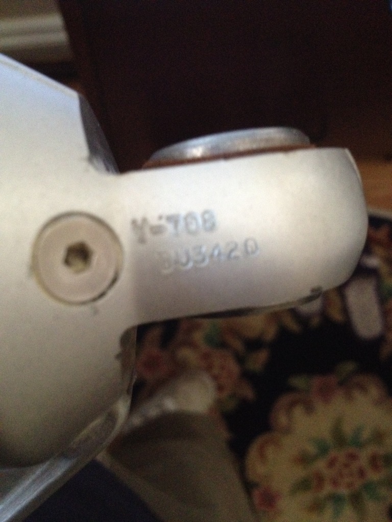

  17. so today i swung by and had a look at the shock. didnt look to good to me. looks like it's been taken it apart ,wire brushed bits (red bits and other bits) and put back together. also the bearing at top and bottom mounting points appear to be seized (although he claims they are ment to be solid and none moving parts ). he said it came of his race bike but then turns out to be his mates. over all im not to impressed with condition and not too sure it can be fitted to a 749, it look identical to a 916/998 shock. but part number seems to be du3420. most confused and not sure waht to do, do i A- buy it fix it up and see if can be fitted or sell it, or B-stay well clear.its only costing £200 in mind. spring looks like its been painted also, no sign of ohlins markings on spring too. ??????
  18. google 3420 and you get 996 sps etc...........as you can see 3240 is for 748R
  19. looks like shes going back on ebay then. cheers for all the comments and help chaps. this site is the quality!
