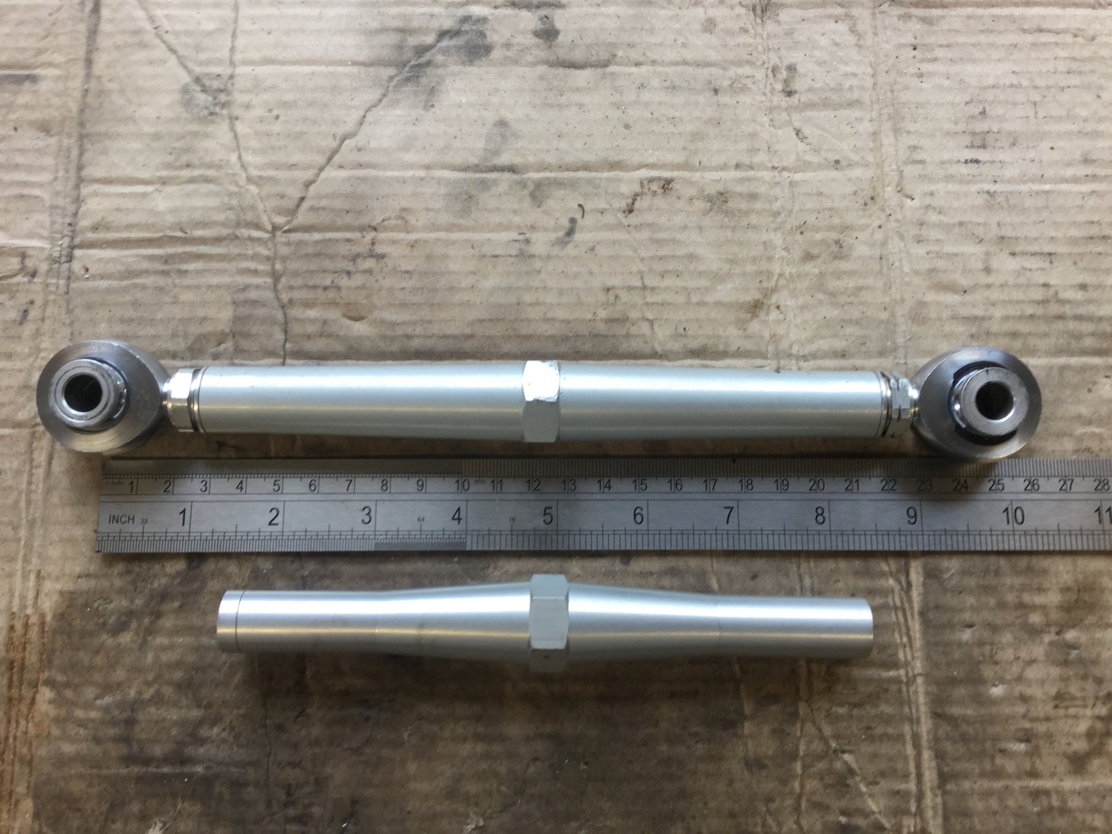

  4. Got my “standard” 749/999(R) rod off @Nelson (ta!) today and immediately went tinkering in the garage.
    I reckon that I can cut it down a bit and still maintain the 243mm centres distance I have been using on my 749R.
    The threads are deep enough to ensure at least the same engagement as I have had with the R rod since with my 243mm centre length the rod ends protrude quite a lot with the short R rod.
    Time to come clean: I replaced the rod ends on my bike last week as they were getting a bit scuzzy. I replaced them with some from McGill Motorsport however the wait for the standard L/H thread Ducati alloy locknut was about 6 months.
    I ordered some steel locknuts from McGill (5 quid for 5). Unfortunately....I may have nipped one up a bit much and think I may have cracked the R rod! There is a teeny longitudinal mark about 2mm long at the edge of the rod on the outside. I cleaned it up with a fine file and emery and it disappeared. It was probably there all along but for peace of mind, I thought I’d rather replace the rod rather than have my suspension collapse on track.
    I will get the R rod NDT inspected at work to check sometime but in the meantime I will use the “cooking” standard rod.

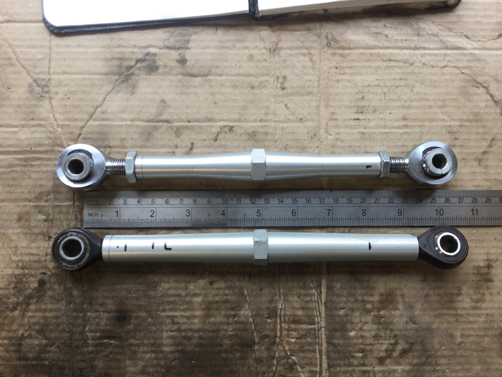

    Took my R rod off and compared to standard rod. As expected, standard rod too long by 40mm.
    Marks on longer rod show the depth of internal thread.
    I decided to cut of 15mm from each end of the long rod as I determined that it would mean the rod ends would be better seated in the rod, rather than sticking out so much as they were on the R rod.
    Cutting the ally rod was a breeze.
    Unfortunately, due to the depth of internal threads, the rod ends bottomed out before they could be screwed in sufficiently to achieve the required 243mm centre distance.
    Bollocks...didn’t have an M12 x1.25mm tap, LH let alone RH, so decided to cut 12mm off each rod end male thread.
    Seven, yes seven, hacksaw blades later, I had cut down the two threaded parts of the bearings.
    Put them all together and all looked great! Reduced the centre length to 241mm as I think It was like that a few years back.
    One last thing...

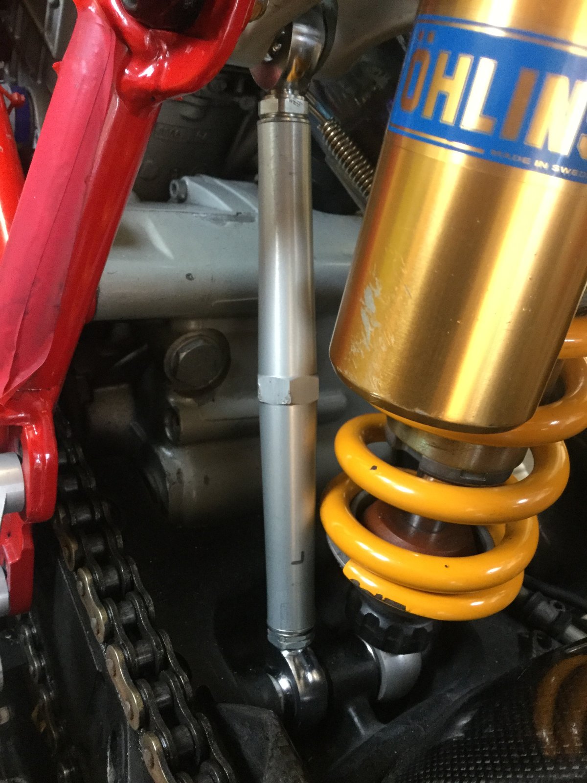

    Put the rod back on the bike...blimey it’s tight on the shock spring! Got a couple of mm space, now I know why the R rod is fat in the middle but then tapers to a parallel end - it’s to give clearance on the spring.
    Simples....

  7. How much clearance will you have, once the swingarm moves up n down?
  8. As shock compresses, the clearance increases. I reckon it’ll be ok even when it extends as I checked it while on the ABBA stand with no load on the wheel.
