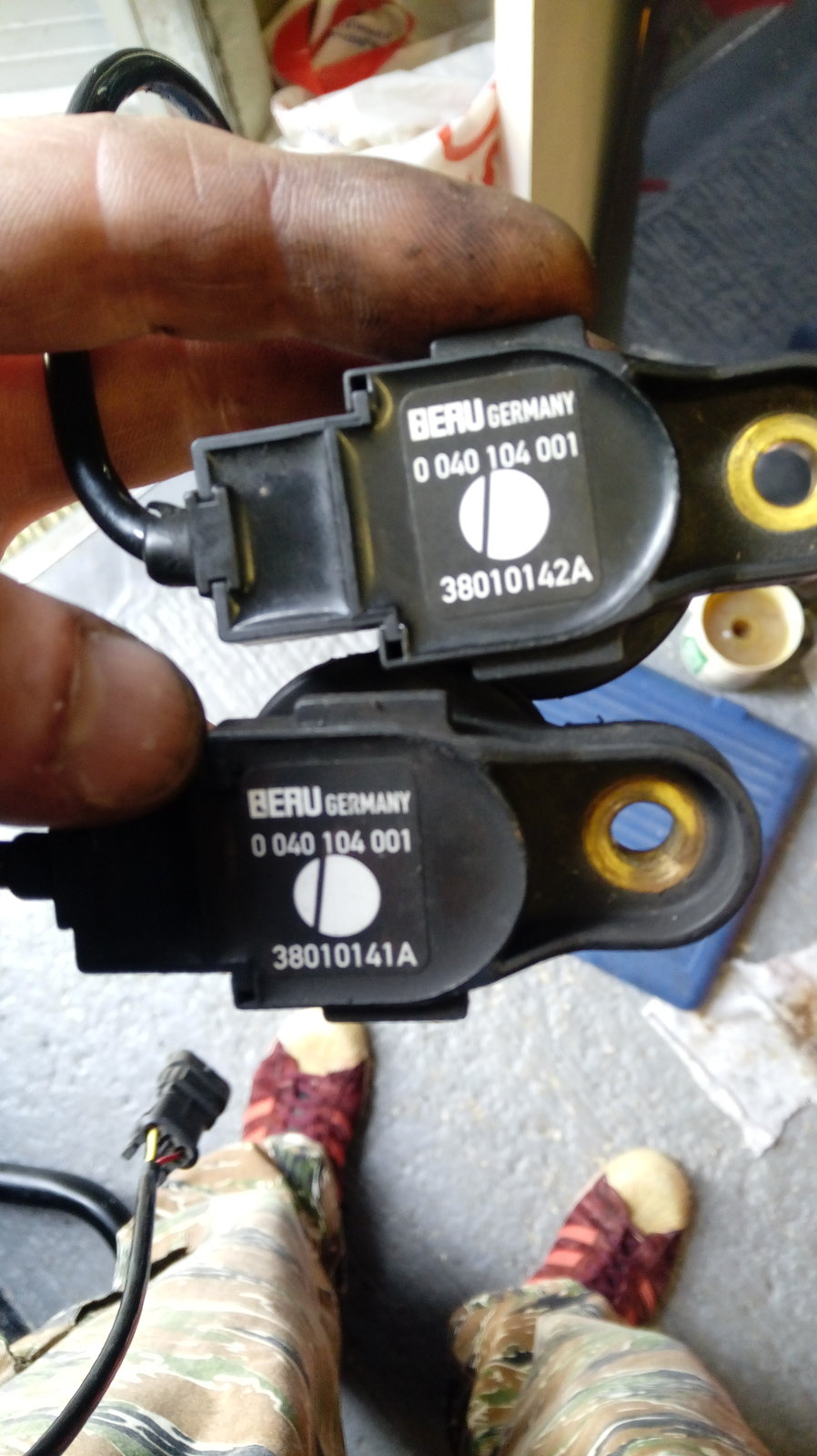

    Was going to swap coils over from my 05 's' but the codes different, are these interchangeable?

  2. I think they were just redesigned with longer lead to stop so much crap getting in the front one and causing it to fail. I'd swap as a test.

  3. Seem to remember that the only reason the codes were different was to assign one number for the front coil, the other number for the rear coil. Just a parts department thing!

  6. When my 999 dropped into one cylinder last year, I tried replacing the front coil first but unfortunately it was the ECU at fault, so the replacement coil didn't help.
    While checking out coils I found that there have been a number of updates to try and make them more reliable but they are all interchangeable.
    So your 05 coil will work.
