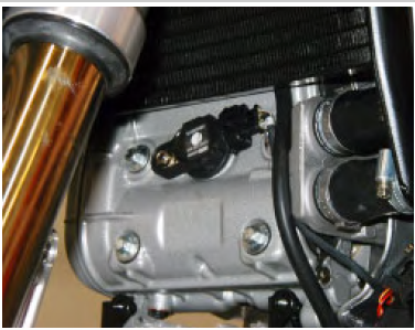

  6. so is the coil easy to replace,whereabouts is that,and can i test it?
  7. get the plug out first, dry it and heat it up in a gas flame or summit ...see if that cures it first!
  8. It's on the front cylinder head behind the fairing Vee panel, directly onto the spark plug. Simplest test is to swap it with the rear one and see if the fault transfers with it.

  9. NICE! did that,dried up the damp stuff,squirt of WD40 on the coil connectors,plug back in and she's a goer!!!thank you all so much,had enough doom and gloom for the moment and this is a WIN!
