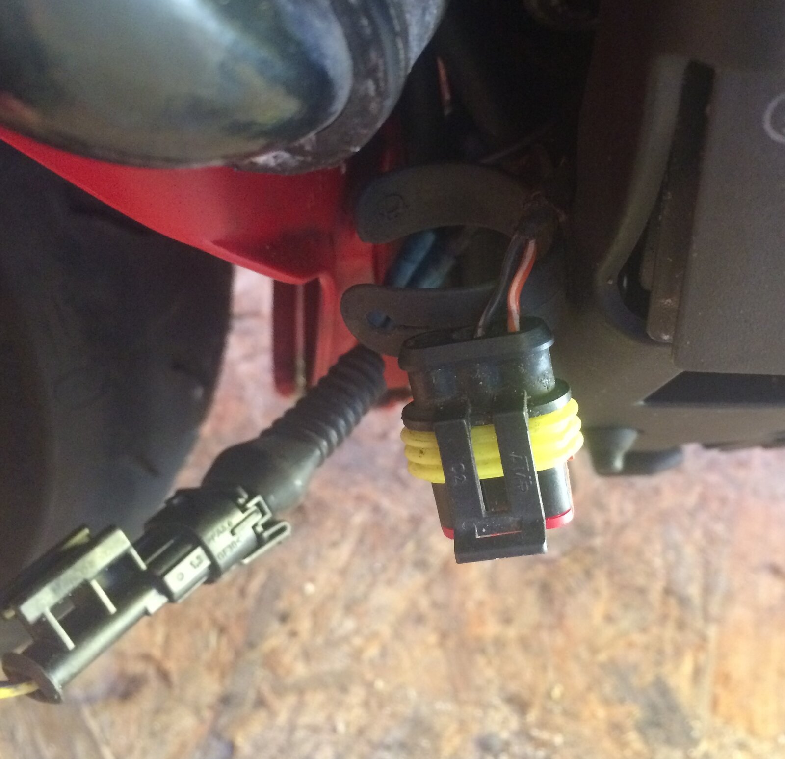

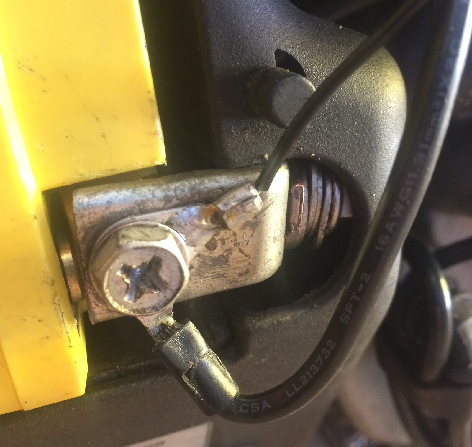

  16. IMG_2473.jpg IMG_2475.jpg as you can see there is a whole bunch of stuff earthing to the negative battery lead,not sure how many issues this bike has had previously although she has only done 10k miles.
    if this is the diagnostic plug then it only has 2 wires and three holes,normal?
  17. Yes. The central black/violet wire is the ground, the orange/white wire is the diagnostic K-line.
