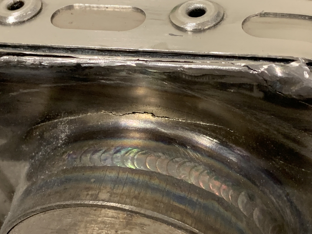

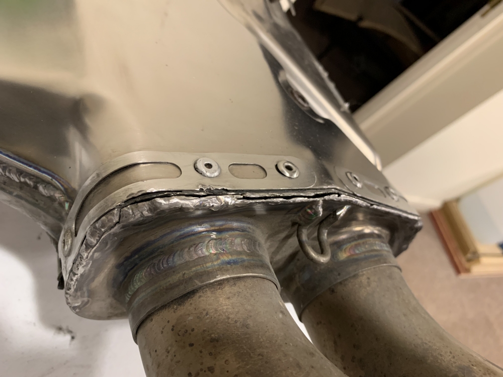

    One of the things needing immediate attention was the split titanium (I thought it was stainless, but I've been reliably informed that because it sparks white when grinding, it's titanium) silencer. Piccies ....
    As you can see, its fooked!
    I called around maybe half a dozen welders in Suffolk & Essex, whatsapp'd them these piccies and they all said "No can do".
    Fine, I thought, I'll get a new second hand silencer. The keen eyed of you will have noticed that its a symetrical silencer. I could only find the assyemtrical variety. Bugger I thought.

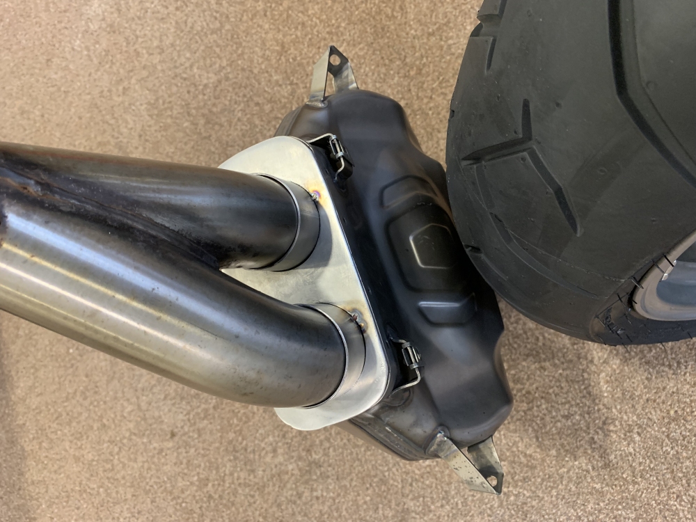

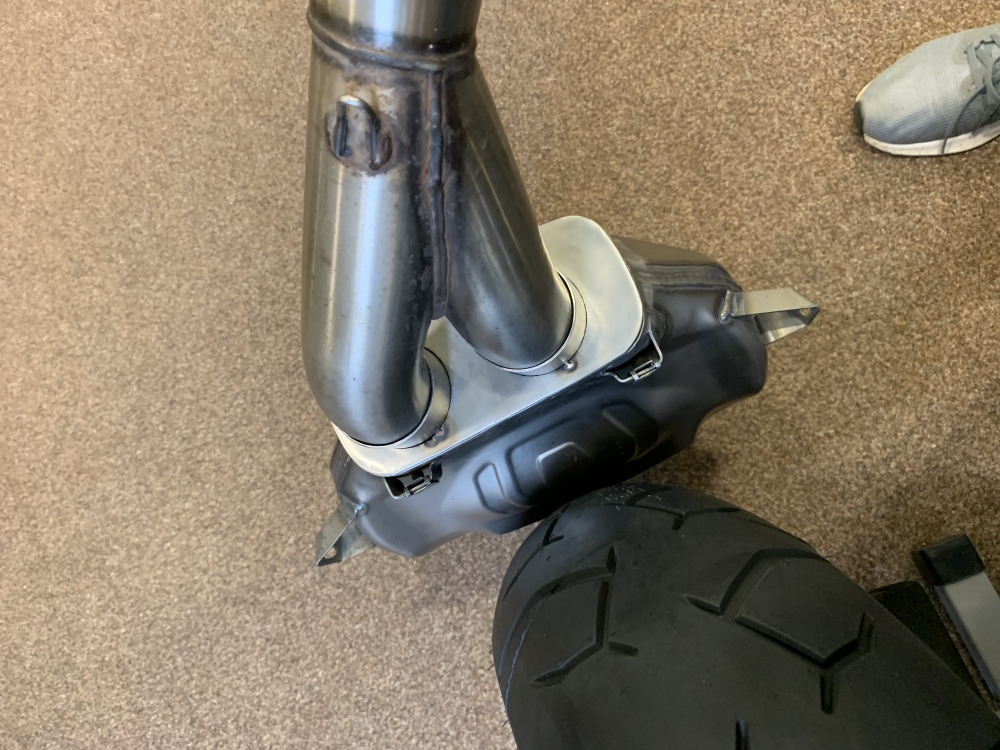

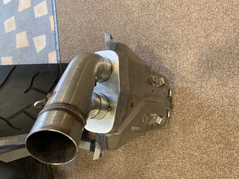

    My brother in-law suggested I try whojamaflip in Clacton, I gave him a call and he put me onto JCG Engineering. Well this guy, John, has saved my bacon. He couldn't repair the previous rubbish repairs but he could sort out a new fitting doodah using the pop riveted (in stainless) band that goes around the termi.
    He tacked up the below and asked me to test fit before welding up proper..

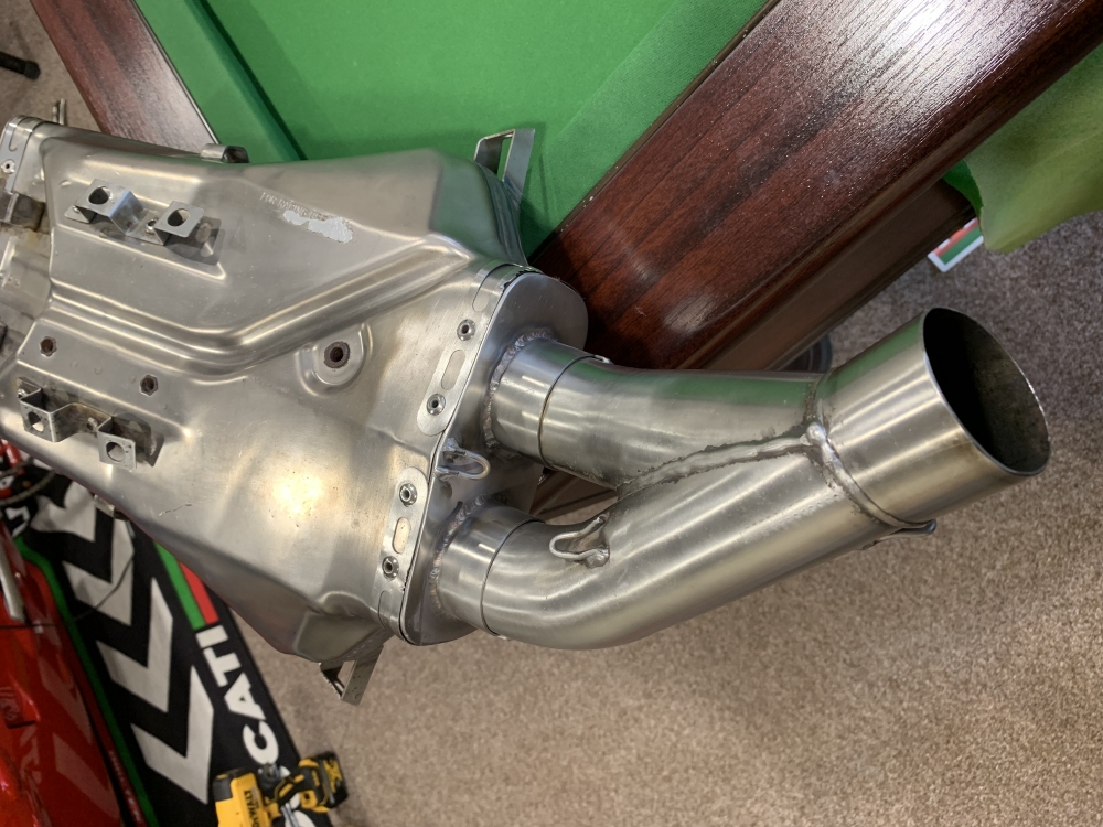

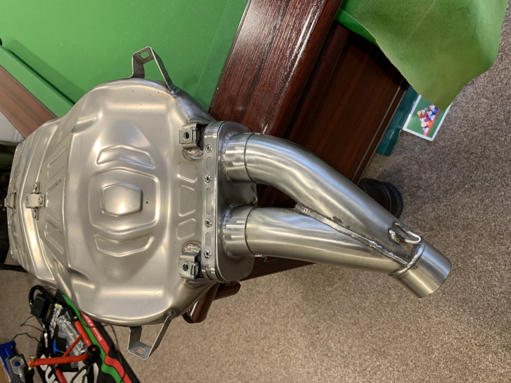

    It fitted perfectly so I whipped it back to John and got this back...
    I'm well chuffed. John is an artisan. His CV is well impressive with Aero, Rallye Cars and Racing bikes. He fixes holed/damaged petrol tanks for motorbike race teams. He charged me £250.00 for the repair, which I thought, considering my options, was very reasonable. I stayed up late last night refitting it all and it went together perfectly (apart from the krypton factor that is the rear light/heatshield/plastic/fibre washers wuck fit).

    Is the new plate also titanium?
  3. nice job,
    also don't forget Phil Smith from Storm performance fabrications ( SPF) as he has done a few exhaust repairs for me in Ti and the works is always to a very high standard.
  4. Hi Ricky,
    No the new plate and bores are in stainless, but I see above that Storm Performance does repairs in Titanium.

    My end can had had a poor previous repair but John cut that away and fabricated a perfectly fitting plate/flange with the two bores/pipes/whathaveyou and it works perfectly. The plate/flange slid into the muffler bit and was riveted in place using the existing band. Been out for a bimble :motorcycleduc: to scrub in some new tires, and it still sounds very Ducati :grinning:
