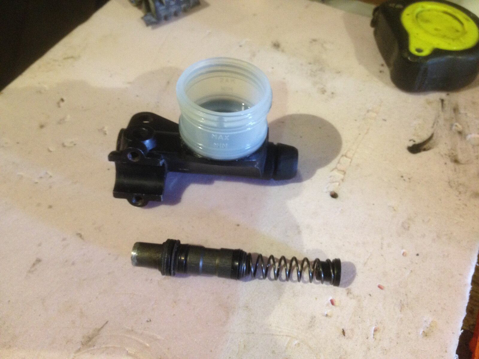

  4. This is it in bits. I will need a new seal kit so if you can send me the ordering details please that'll be great.
