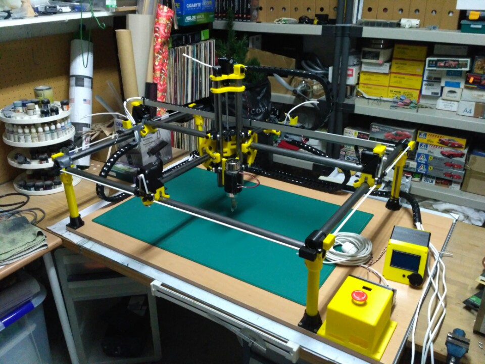

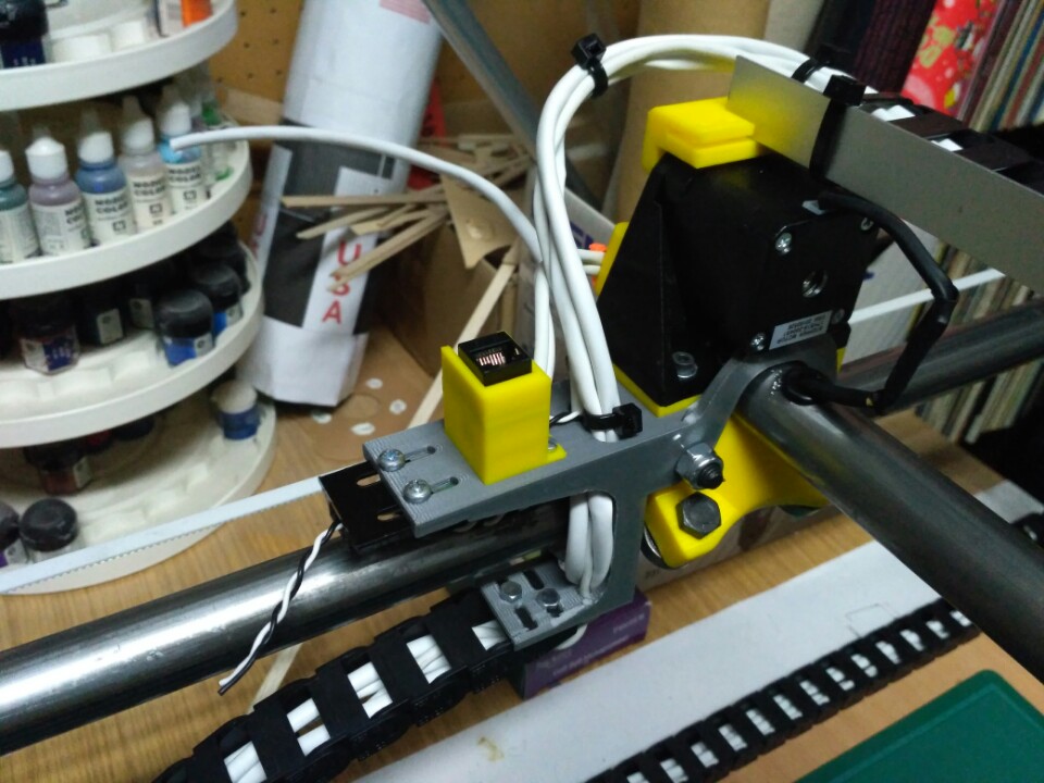

    In the meantime, I've been also very busy trying to finish up my home made CNC Router that I will need to cut custom made pieces for the dashboard and seat (amongst others)
    It is almost finished, but his has stolen nearly all my free time. (I've been learning a lot on CAD desing, Arduino programming, CNC projects and informatics that I had very rusty)
    This is how the machine looks like now.
    Almost finished. I'm now fiddling with the electronics (a pesky nightmare. Too many little connectors crowding in a very little space), and I had to go back to the drawing board many times until I managed the way to route all cables along the mobile axis.
    Every thing is done with a 3d Printer and cheap chinese electronics. No manuals. Trial and mistake, luck and frustration...

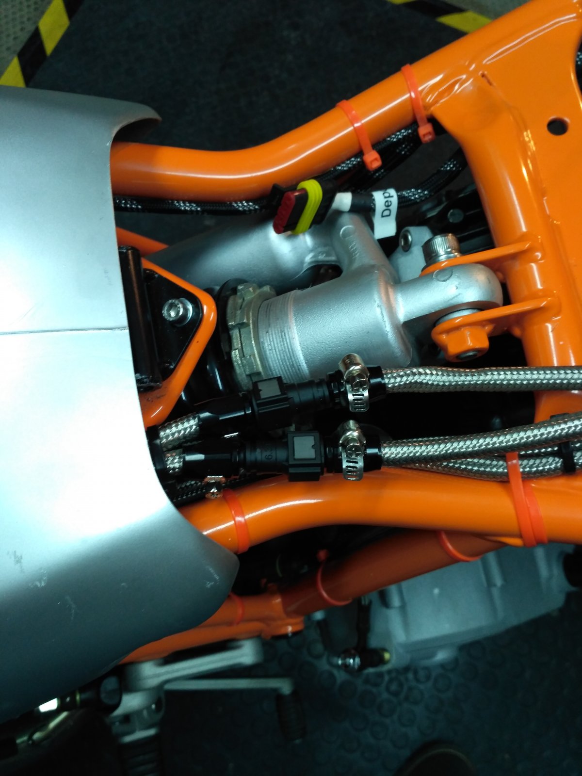

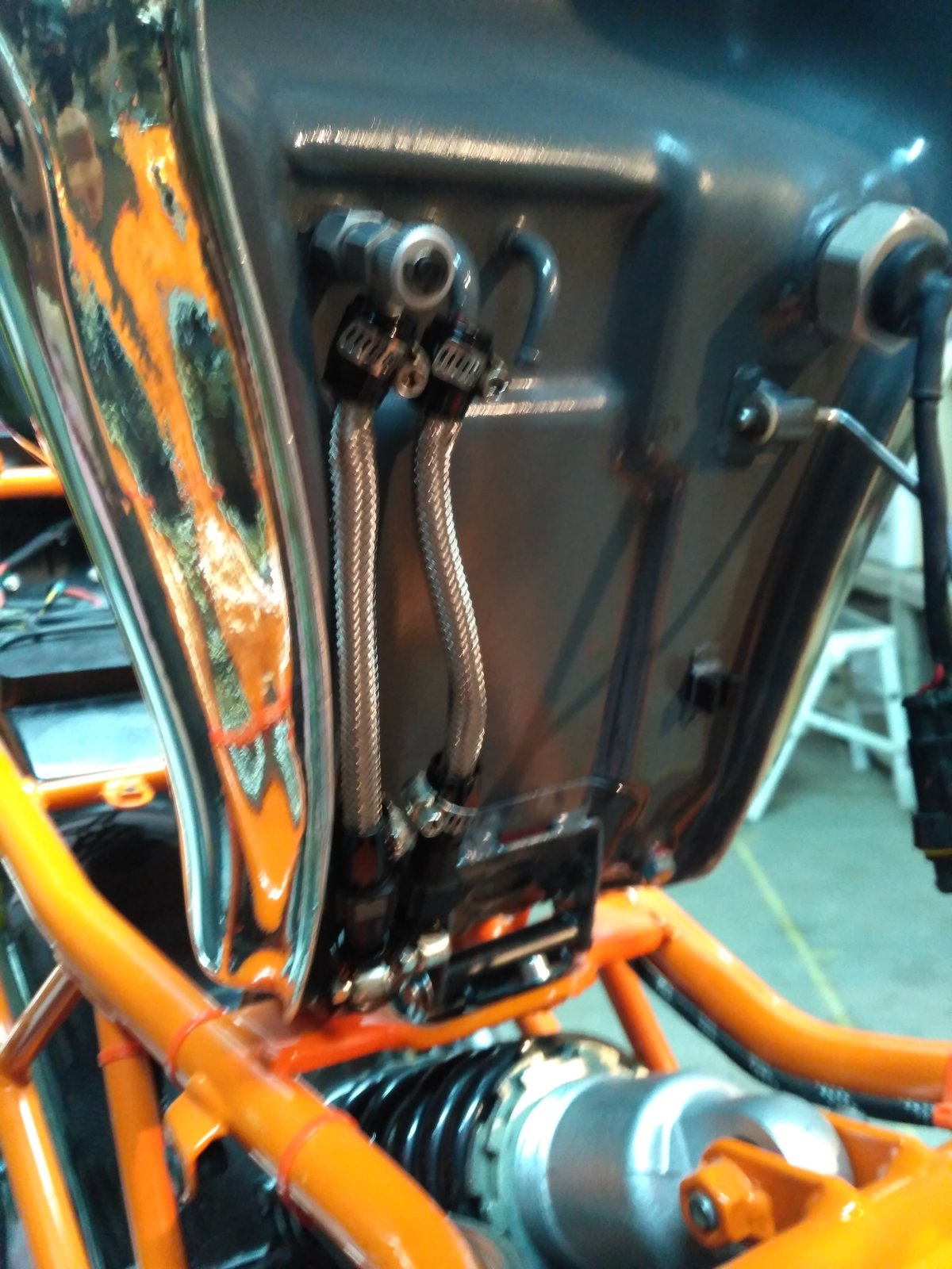

    I finished the fuel lines using some fuel braided lines and quick coupling connectors (idea I borrowed from Wolfram)

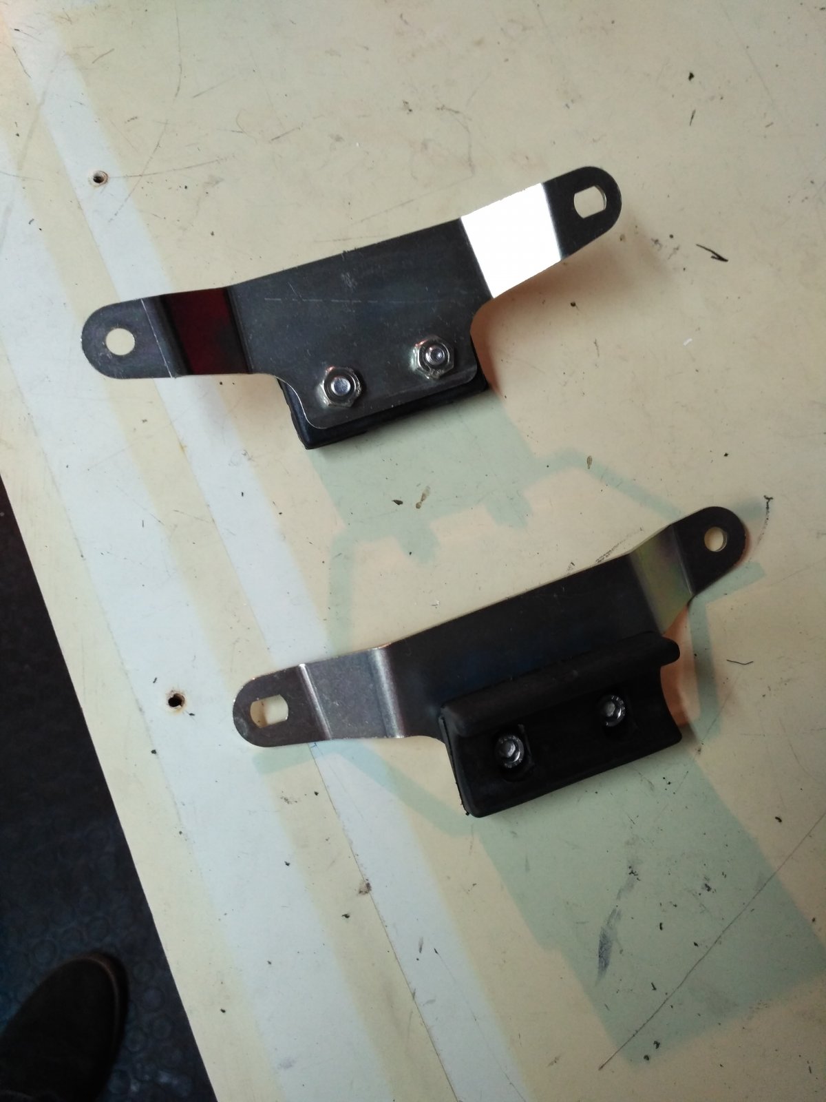

    Also would like to thank Gary for sending me his templates to cut the solo seat support brackets, that were cut in steel and folded at 15 euros each on the same ironsmith shop where they fabricated the battery box
    This is how identic to the OEM part they look. (at a fraction of the cost).
    Thanks Gary, I owe you a big frozen beer for this. :) :)

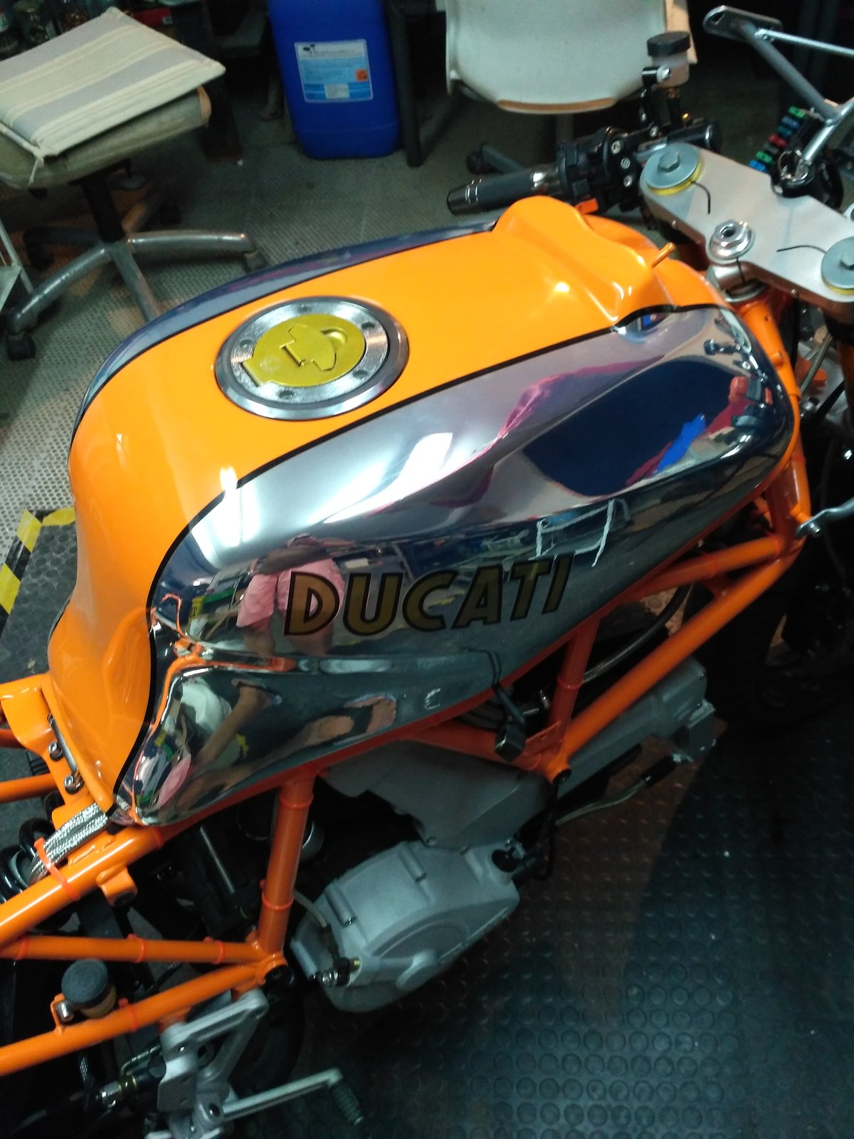

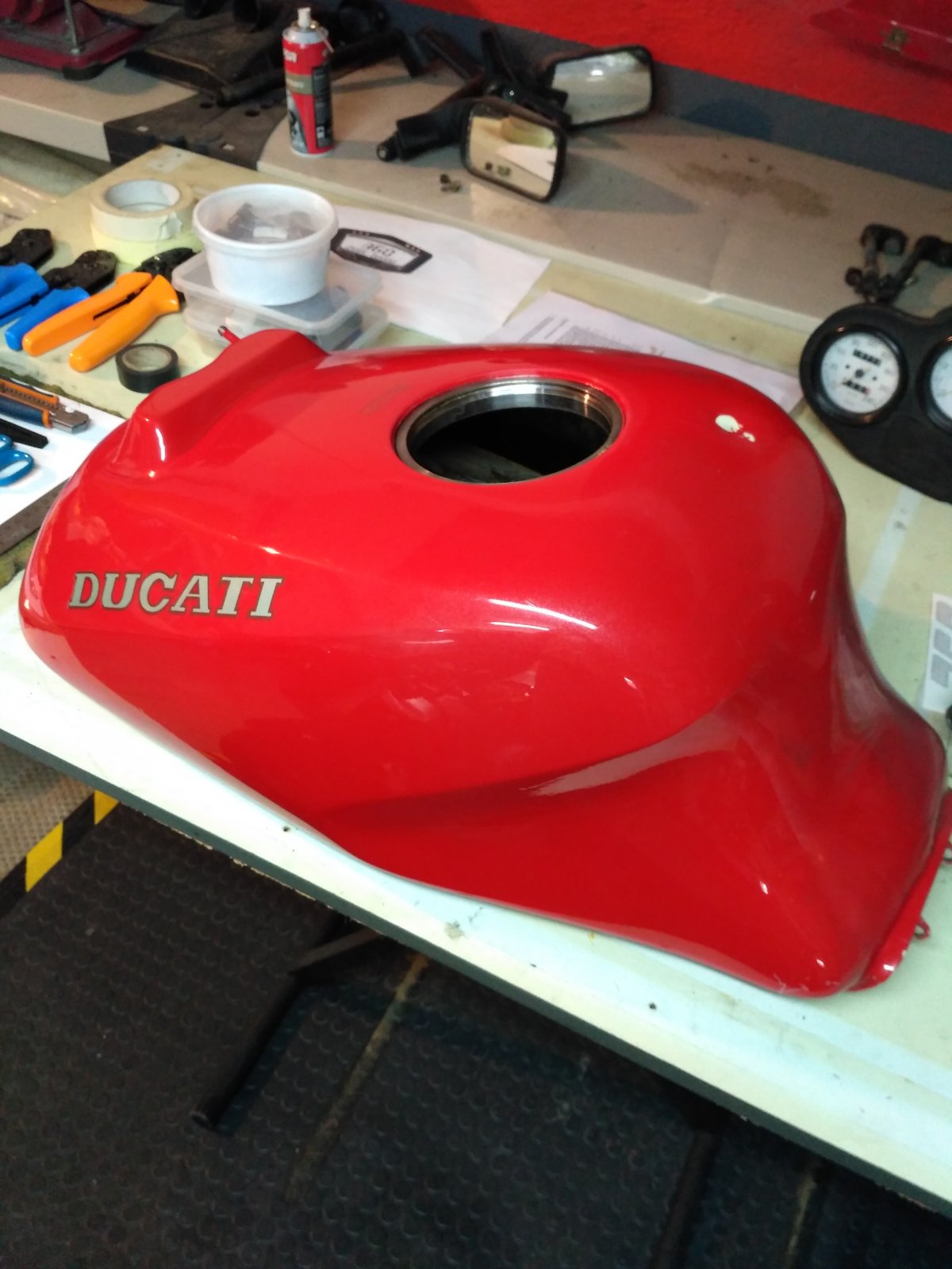

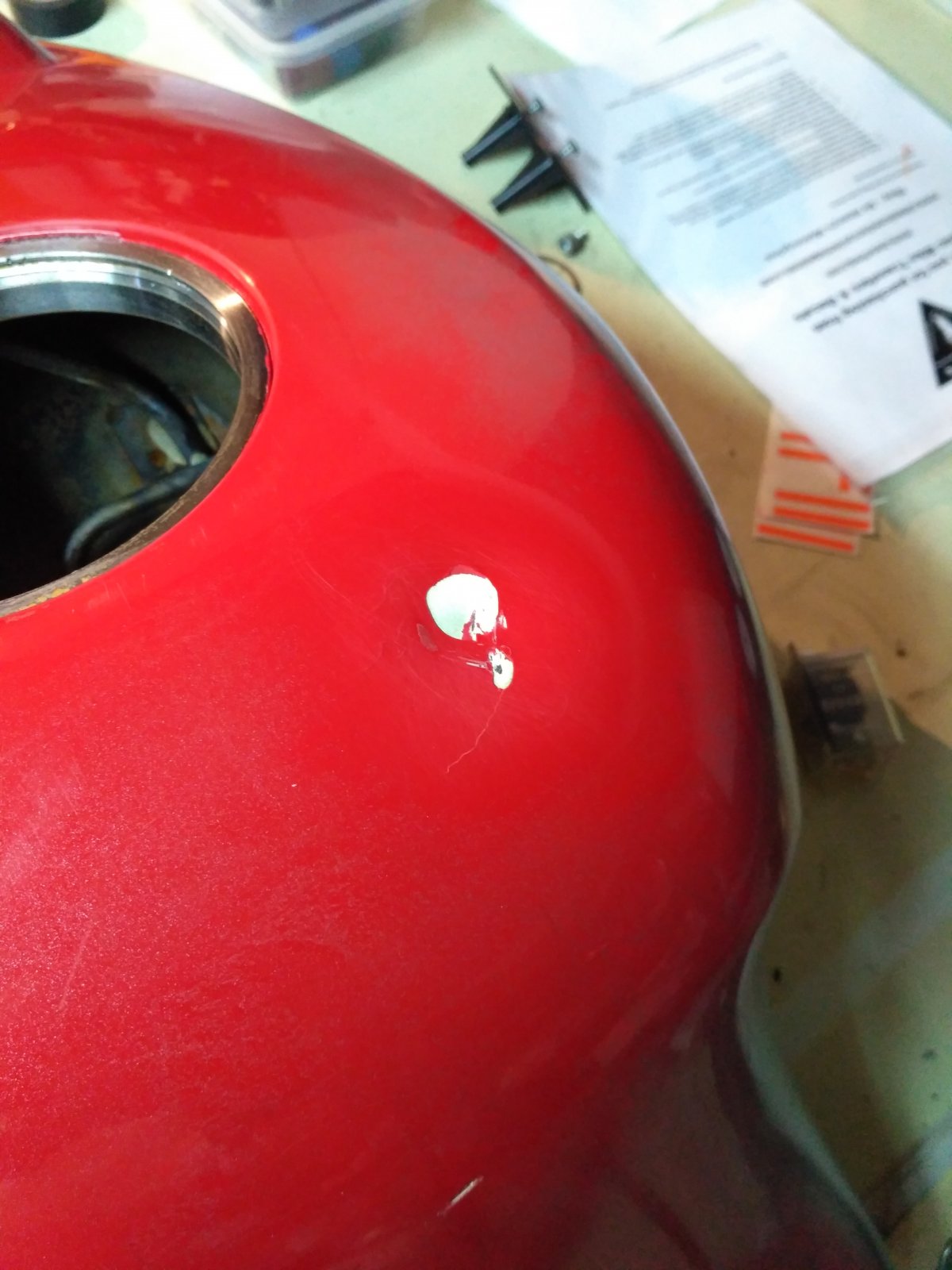

    I have fully dissasembled the tank
    It has an small dent that will have to be repaired

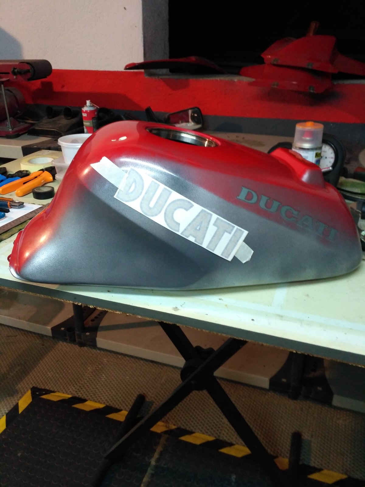

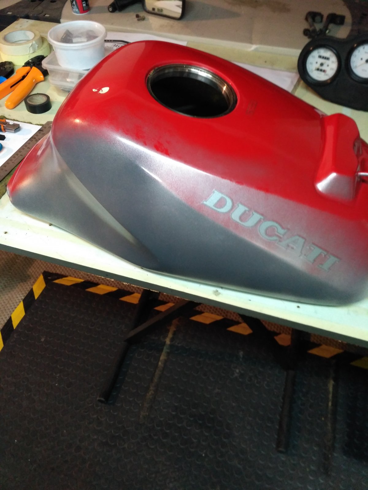

    And did some color testing with spray can to figure out how it would look chrome painted.
    In reality it will not be chromed, but water chrome painted (a new technique that allows a durable mirror looking chrome finish in any surface)

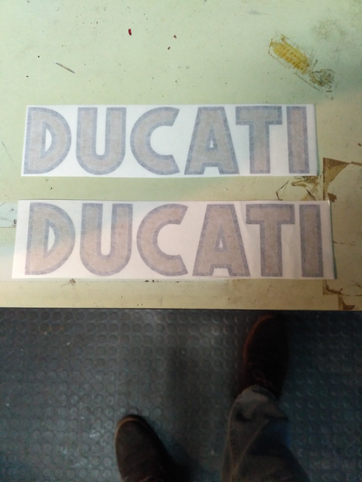

    At this point I went a little bit ballistic, and decided also to use different DUCATI stickers for the tank sides. Choosing the vintage ones in gold with the old letter font
    It will look close to this when finished

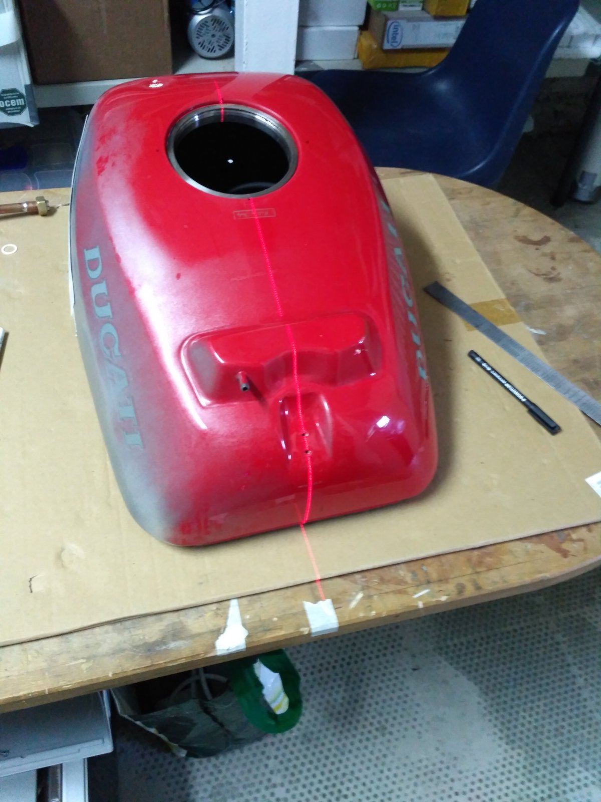

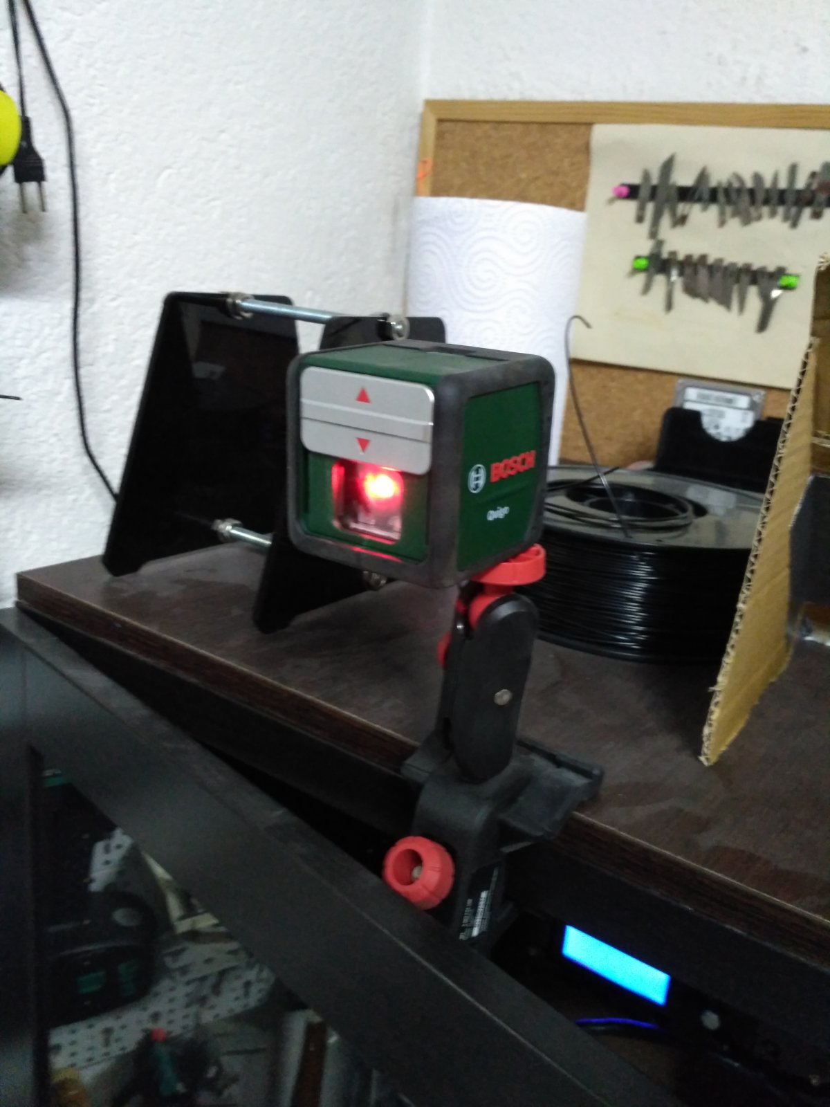

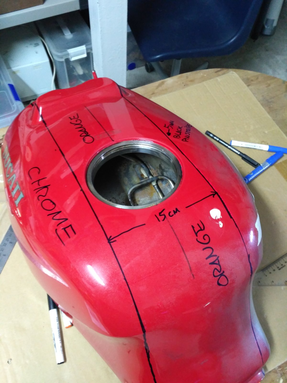

    It will also have a long wide GULF orange stripe along the upper part of the tank (pinstripped in black), so I got my handy laser beam
    Found all the straight lines needed.
    And painted all the lines that will help the paintshop to follow my instructions (hopefully)

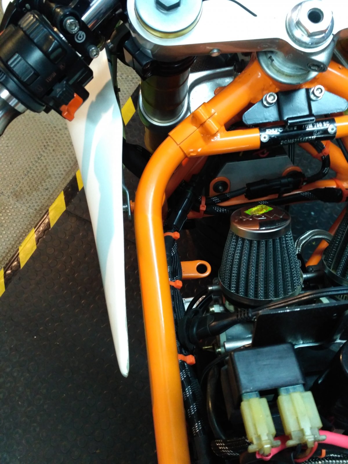

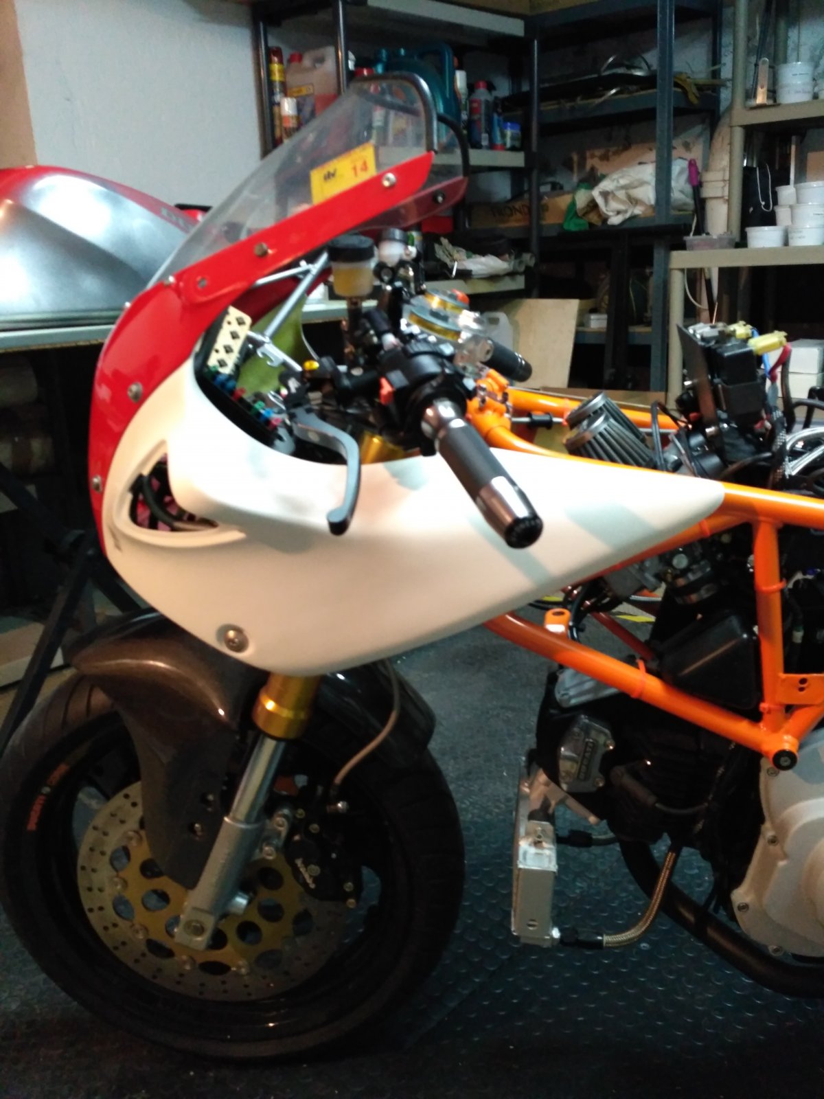

    Also finished the adjustment of the new bikini front fairing
    But the fins have no attachement points, and it looks like they will vibrate a lot when the bike is running (if it ever does...)
    So, some headscratching and out of the box thinking will be required to figure out how to fix the pointy part of the fin to the frame in a concealed, easy to dissasemble way...
    Back to the drawing board for some time...

  9. To fit the pointy part of the half fairing, there should be an M6 threaded boss behind the forward vertical frame tube which the OEM fairing was attached using a 'Z' shaped backet - unfortunately I don't think it will work in this case, because the pointy bit seems to be too far forward.
  10. It is indeed Al..
    And worst of it, the pointy bit is very tiny and thin to work in it.
    I will have to figure out some sort of hidden boss connecting to a rod or screw on the frame similar to this.. (credits to a very nice thread of Ducati Up North forum)
    But mine will certainly involve 3d printing, CNC milling and lots of glue.. :) :) :)

    By the way, tank is now on the shop being refurbished and painted.
    hopefully back home in one week
  11. Hi Gents,
    Way loong time with no posting, but work has not stopped.

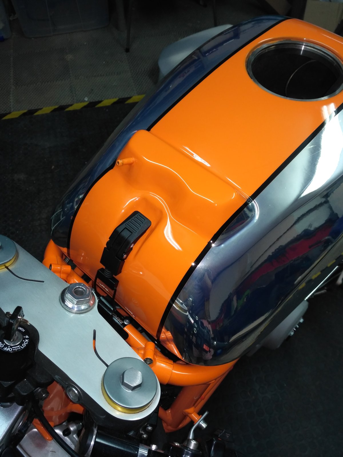

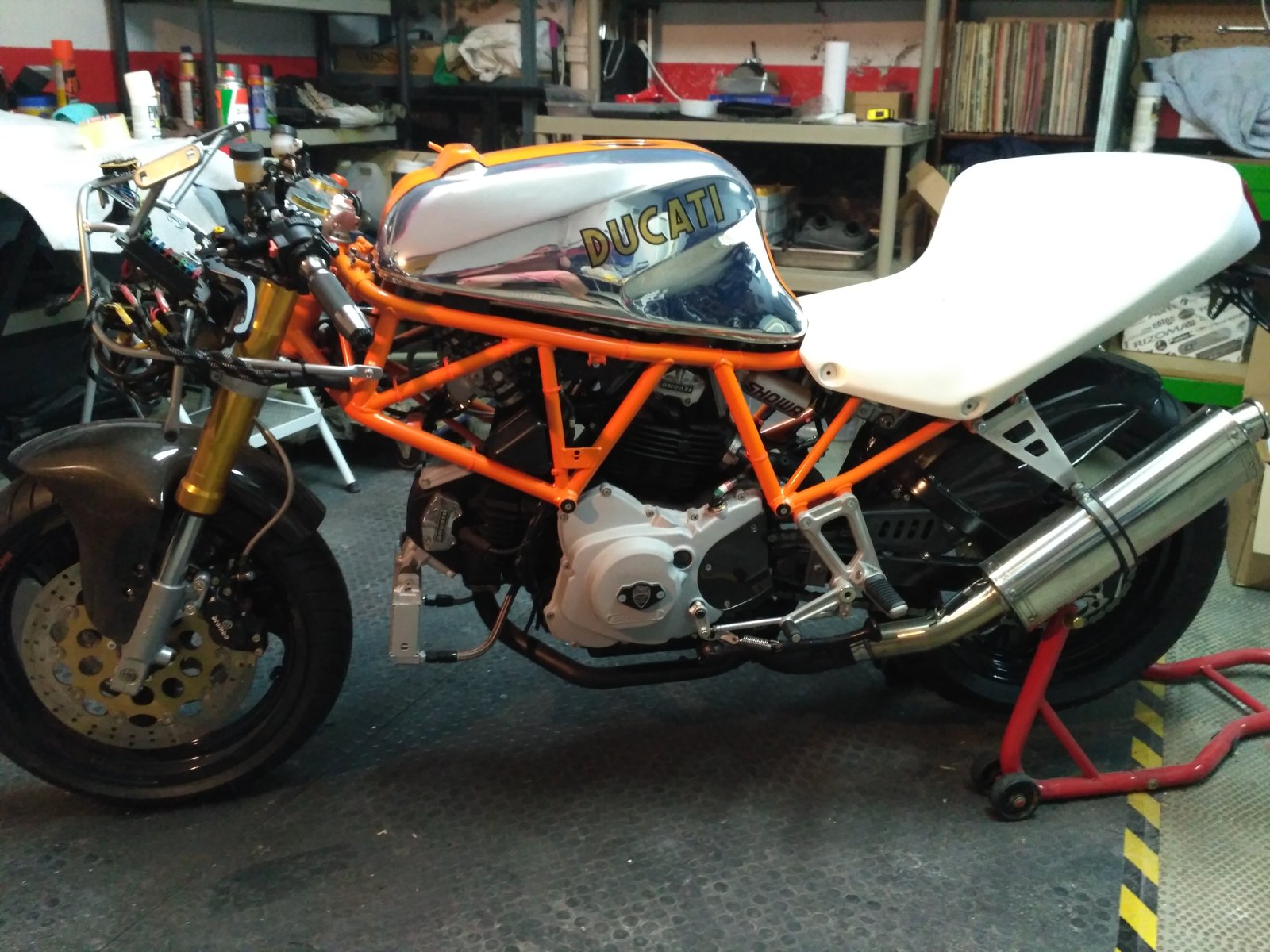

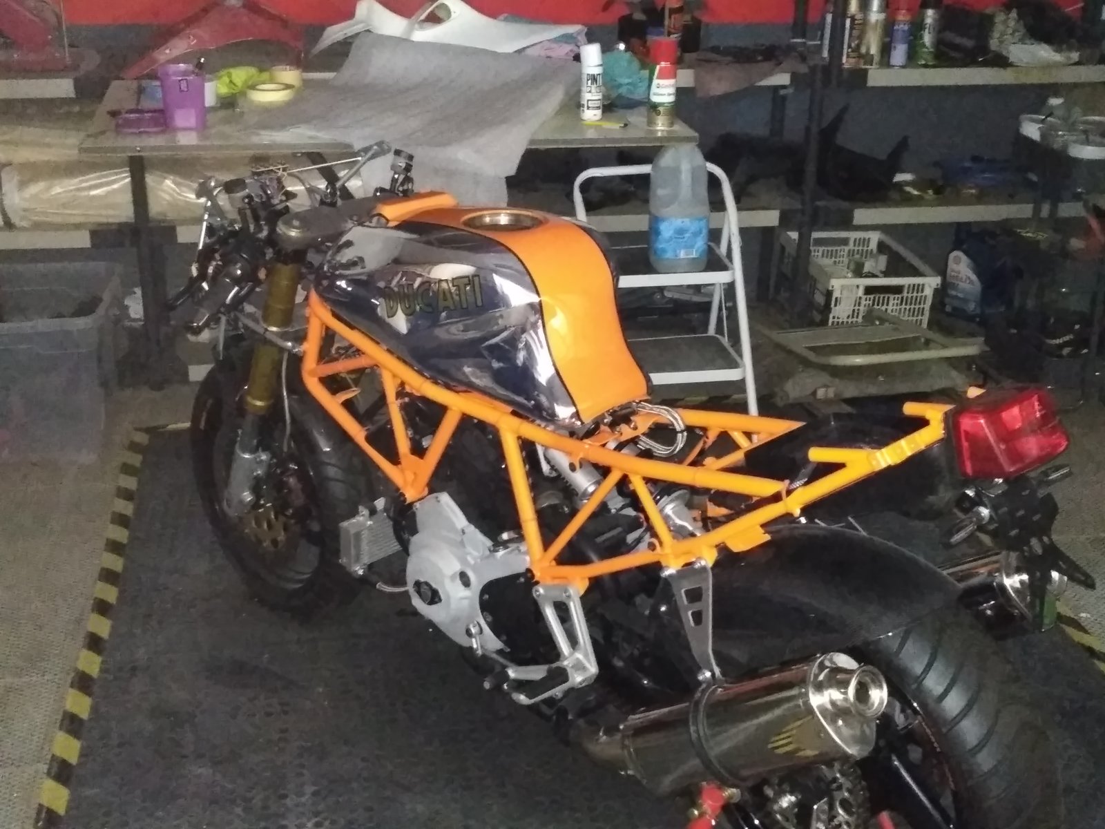

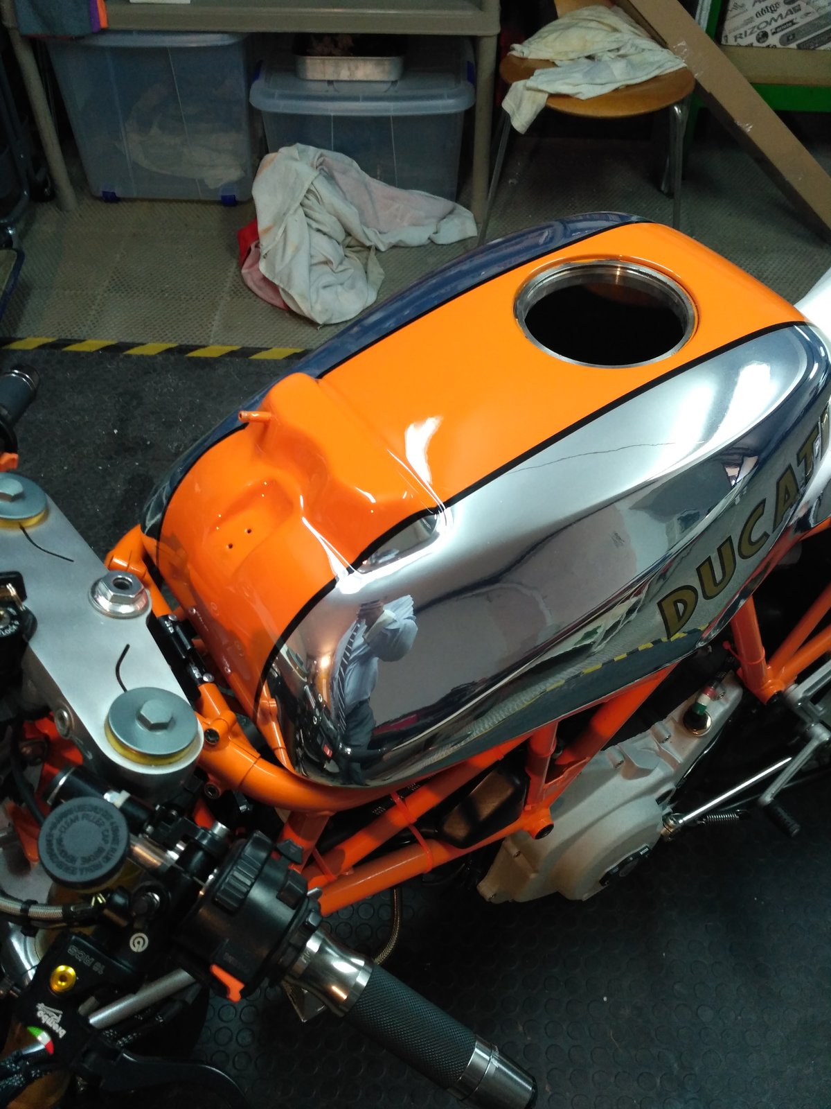

    I got the tank chromed and painted
    Awful garage light on the pictures does not bring out the real orange color :mad::mad: that, in reality looks like this

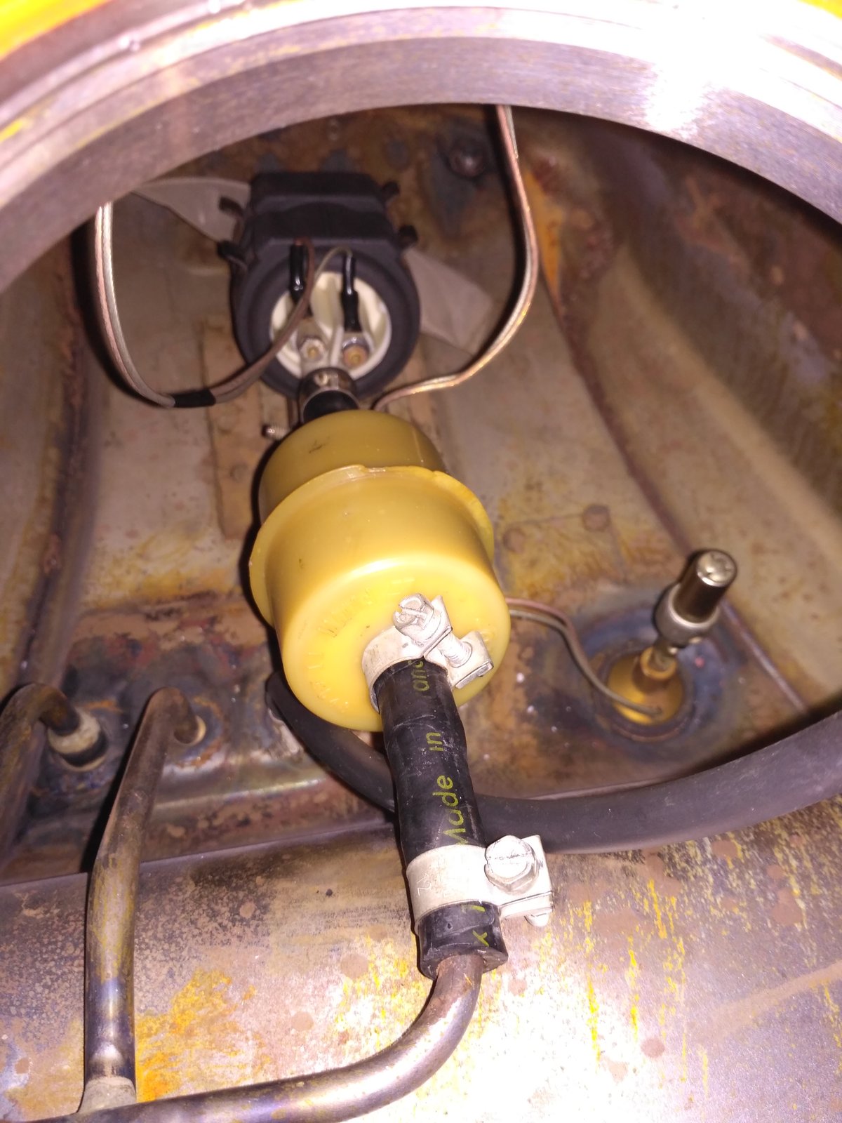

    Now that the tank is finished, a quick afternoon in plumbing and installing pump, lid, and
    frontal strap
    Opinions and comments welcome. I know it is a very unusual color combination, but she, definitely, is going to be a looker!

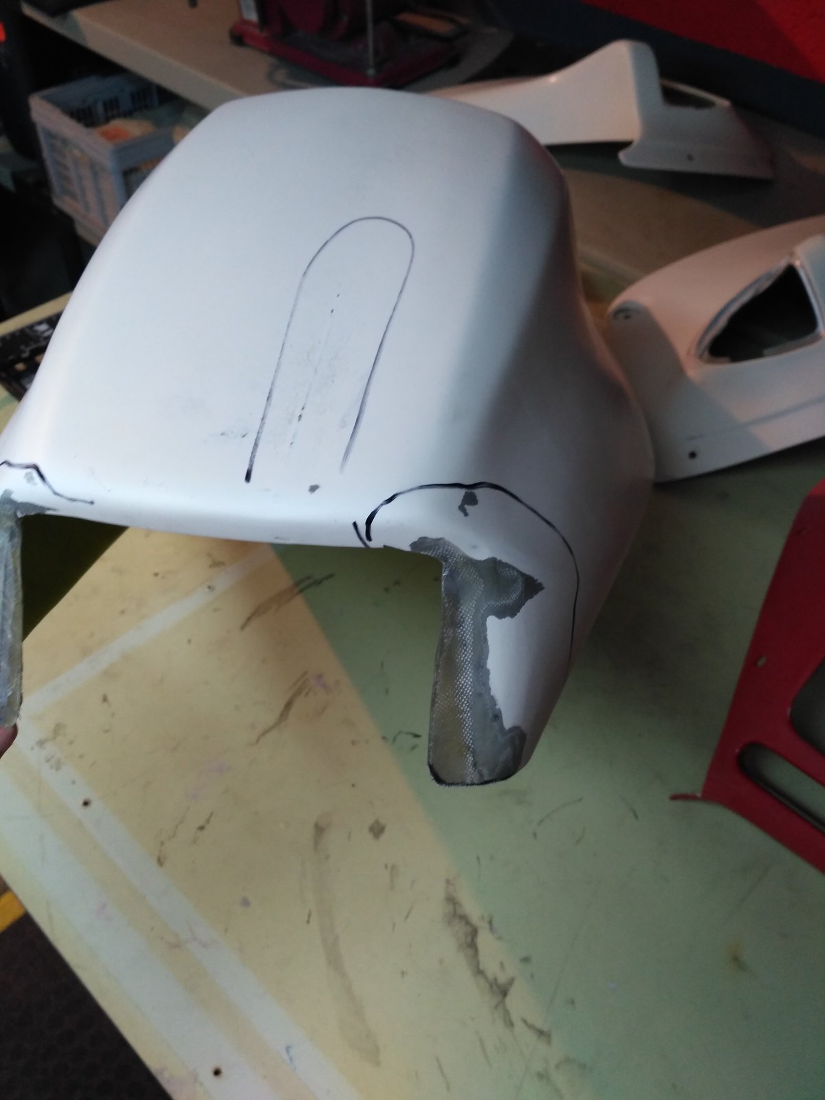

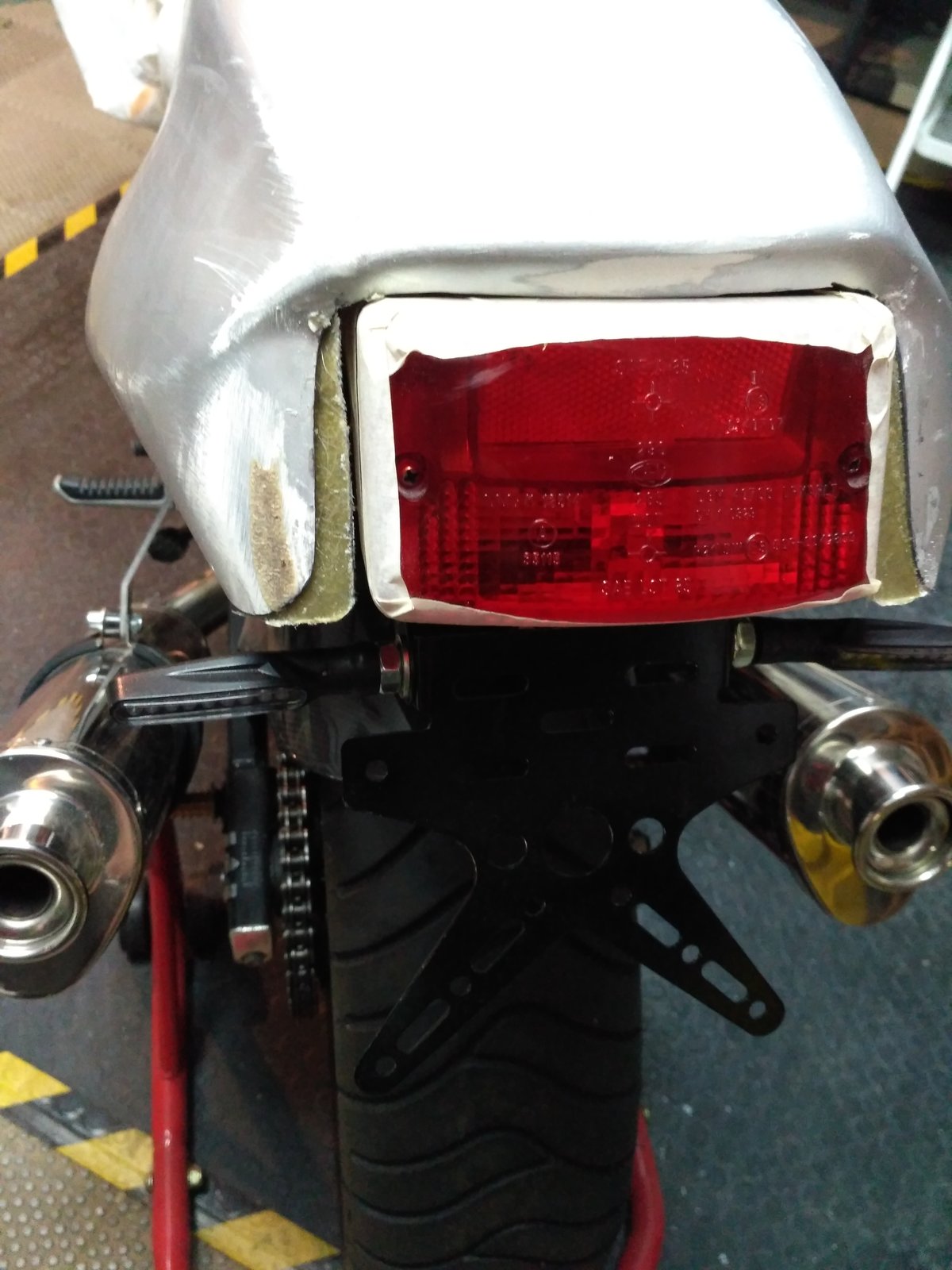

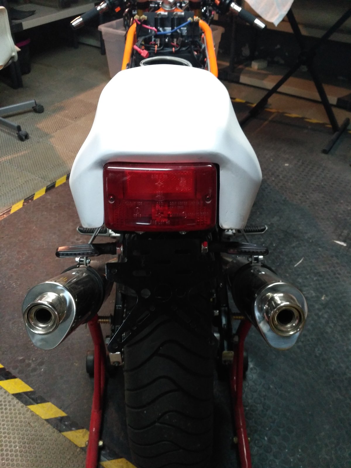

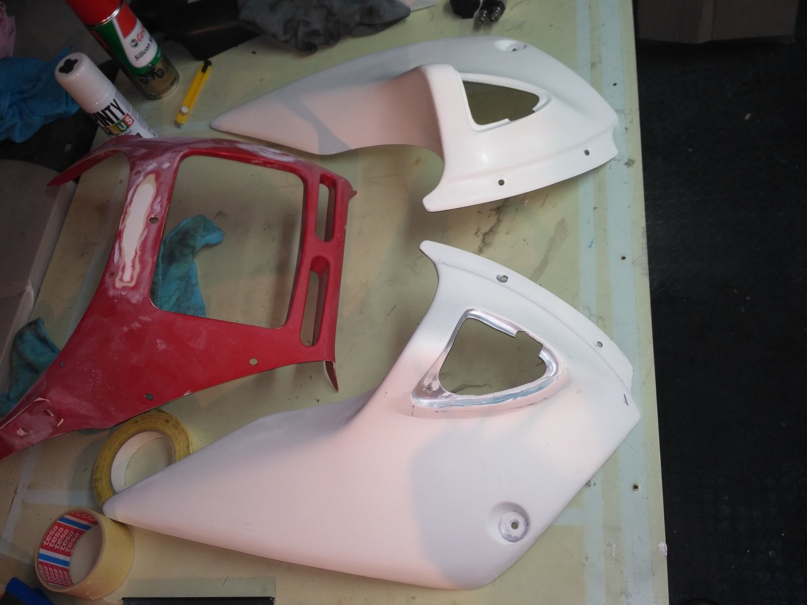

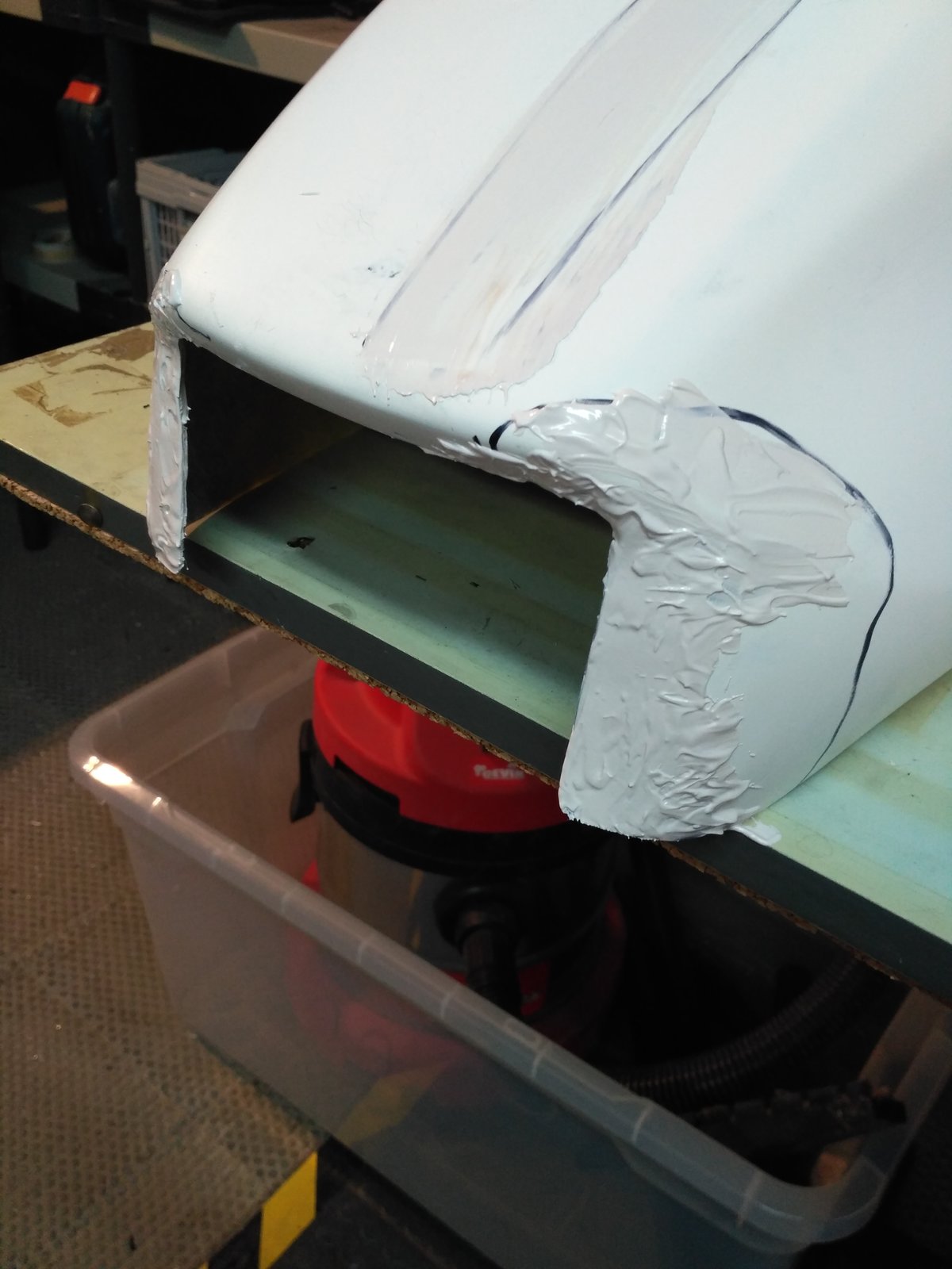

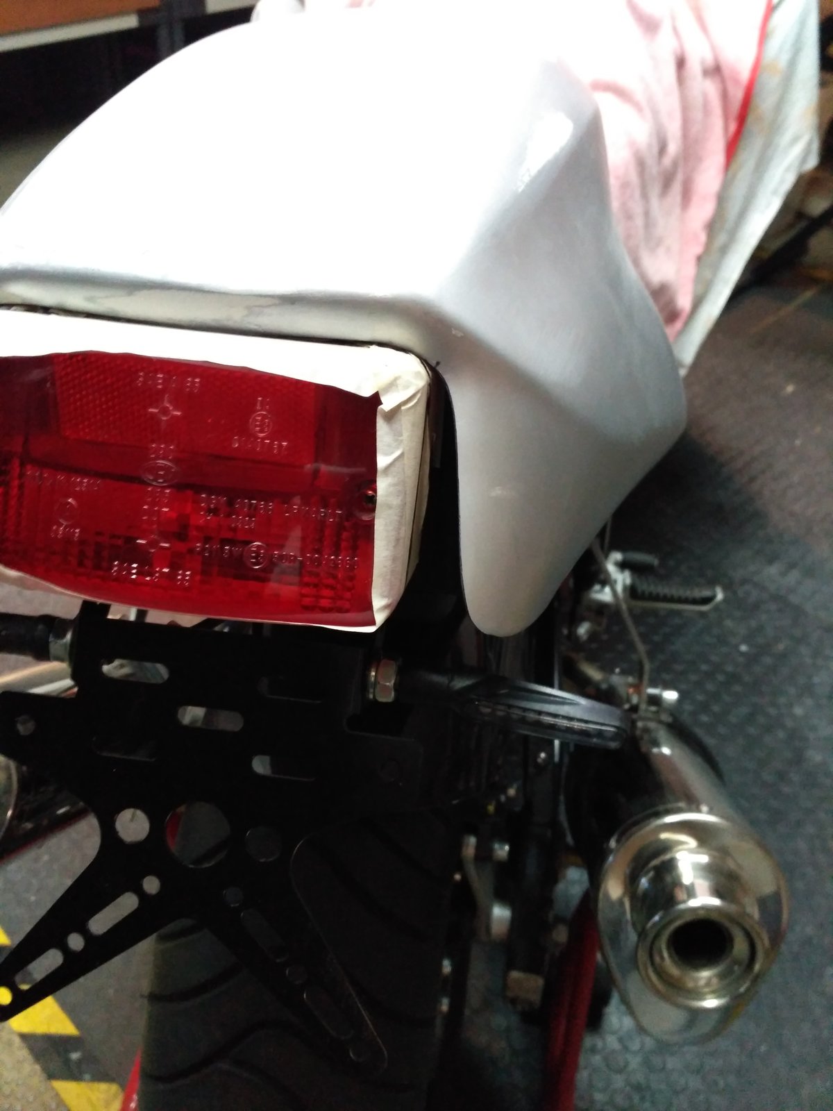

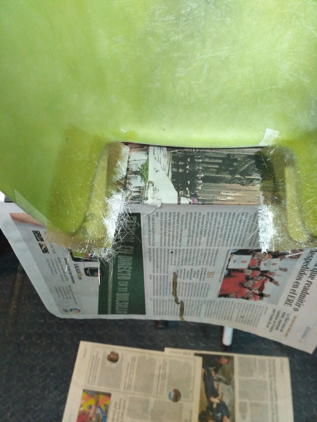

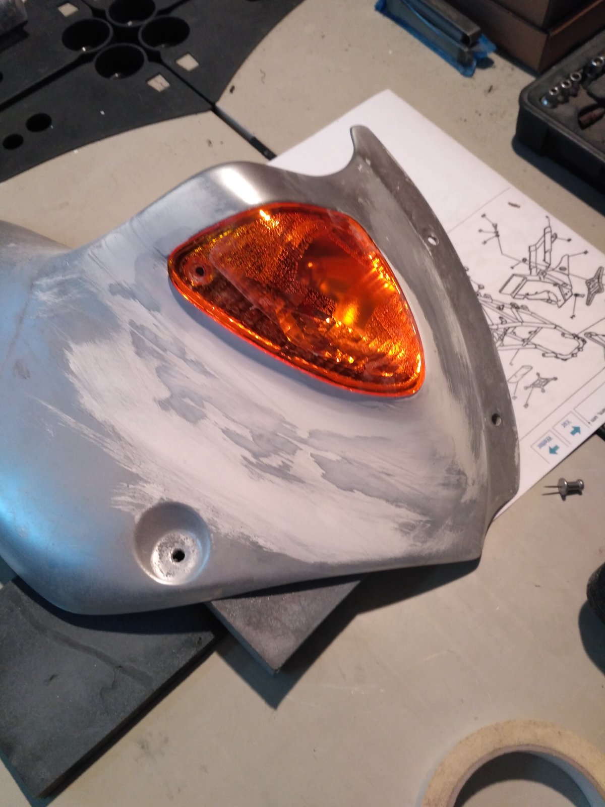

    The solo seat fairing I bought in Ricambi Weiss was cheap (good thing) but did not fit well on the rear (bad thing)
    As you can see, the ends do not embrace the rear light properly and, what is worst, they are not even symmetric.
    So some fiber work was required.
    IMG_20170514_132524.jpg IMG_20170519_170204.jpg IMG_20170520_185809.jpg IMG_20170521_175916.jpg
    Hours of sanding, fiber dust breathing, (man, I'm getting old for this.. :oops: ) and some gross talking afterwards, the result was acceptable
    Same sanding treatment applies also to the front end and Bikini fairing

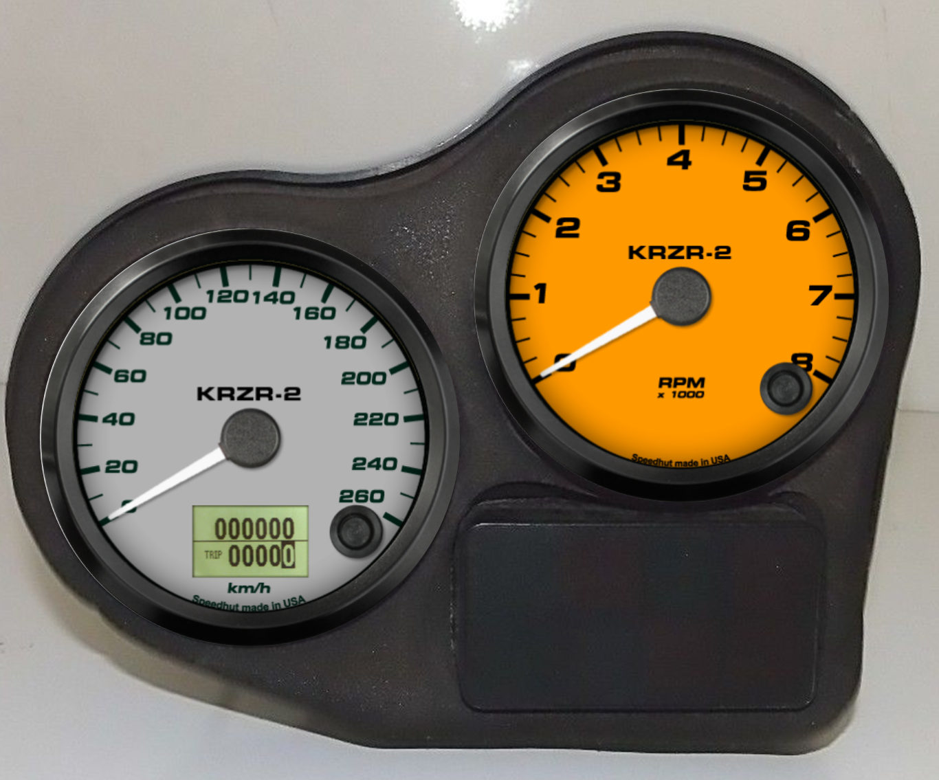

    For the seat, i will cut some 10mm. thick nylon plates using my CNC cutter, and i will pad them a send to trim in a professional upholstery (I'm totally unable to sew a shirt's button)
    For the dashboard, I'm planning to reproduce the original one with a bit of hi-tech solutions.
    I don't know if you are familiar with this guys in USA http://www.speedhut.com/
    they produce custom made gauges (speedos, tachos, fuel, etc..) that you can build to your specification.
    Speedos are GPS controlled, so there is no need of cables, magnets, etc.. and tachos are digital with the possibility to add gear shift lights and so on.
    I've done my own design (still a work in progress) and it will look similar to this.
    Those gauges are some 20mm thick (gorgeous) and, therefore, I can not use the existing dash of the Ducati, so I will have to fabricate my own.
    How!??

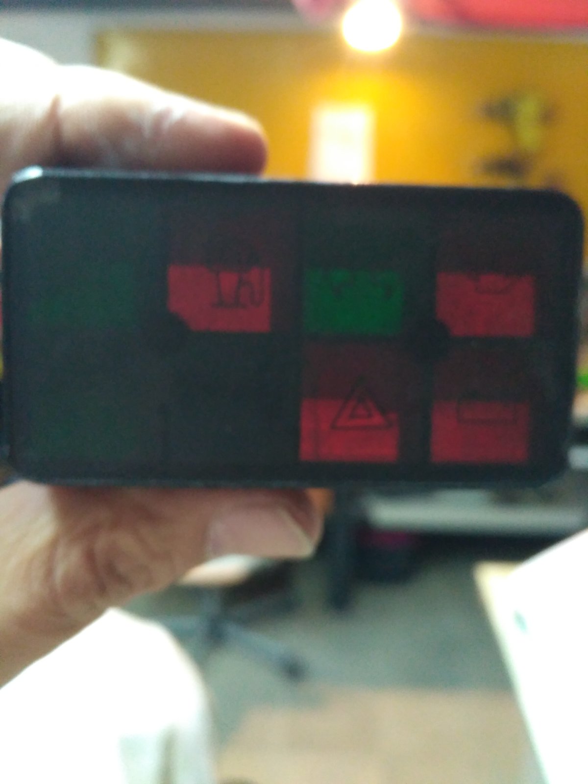

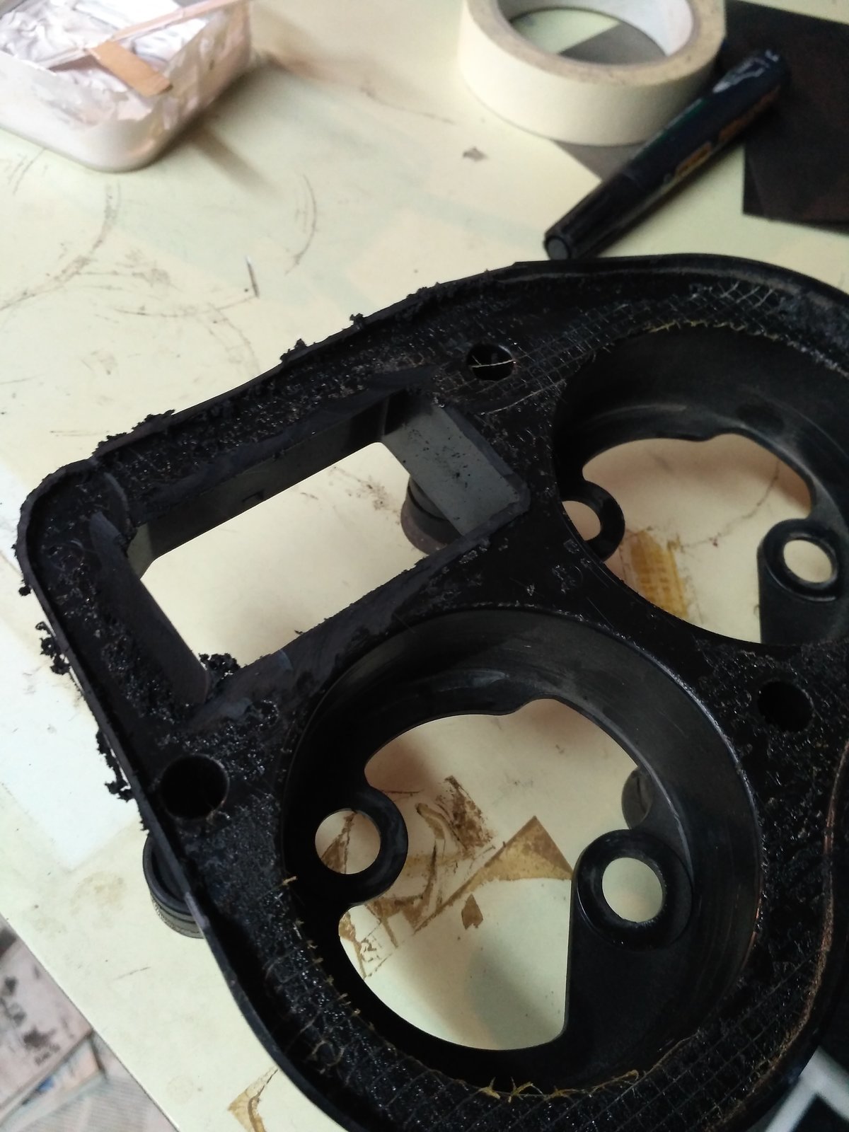

    First I will cut from the old one the lights box that I will be re-using
    Then, let's go crazy.!!..

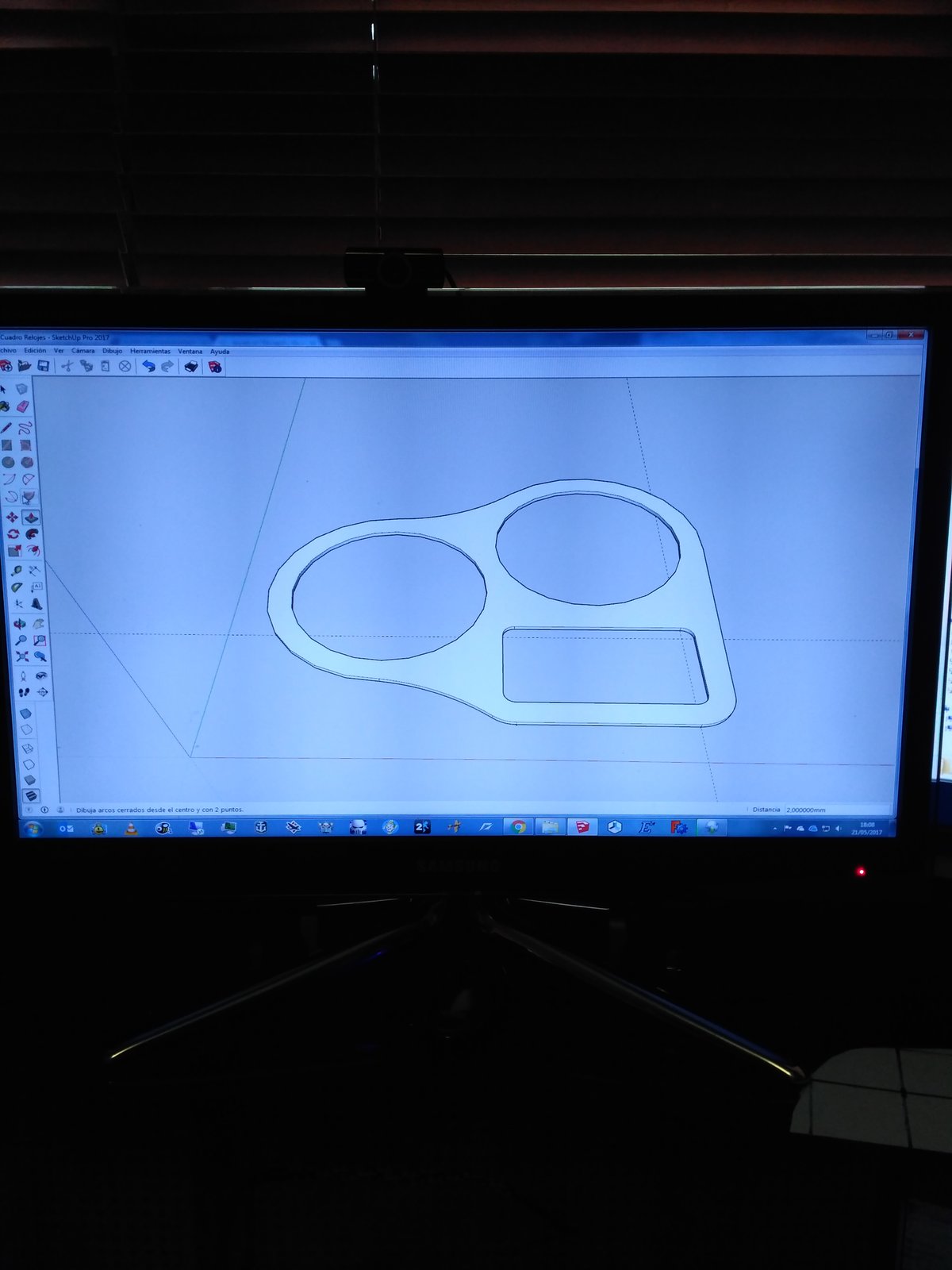

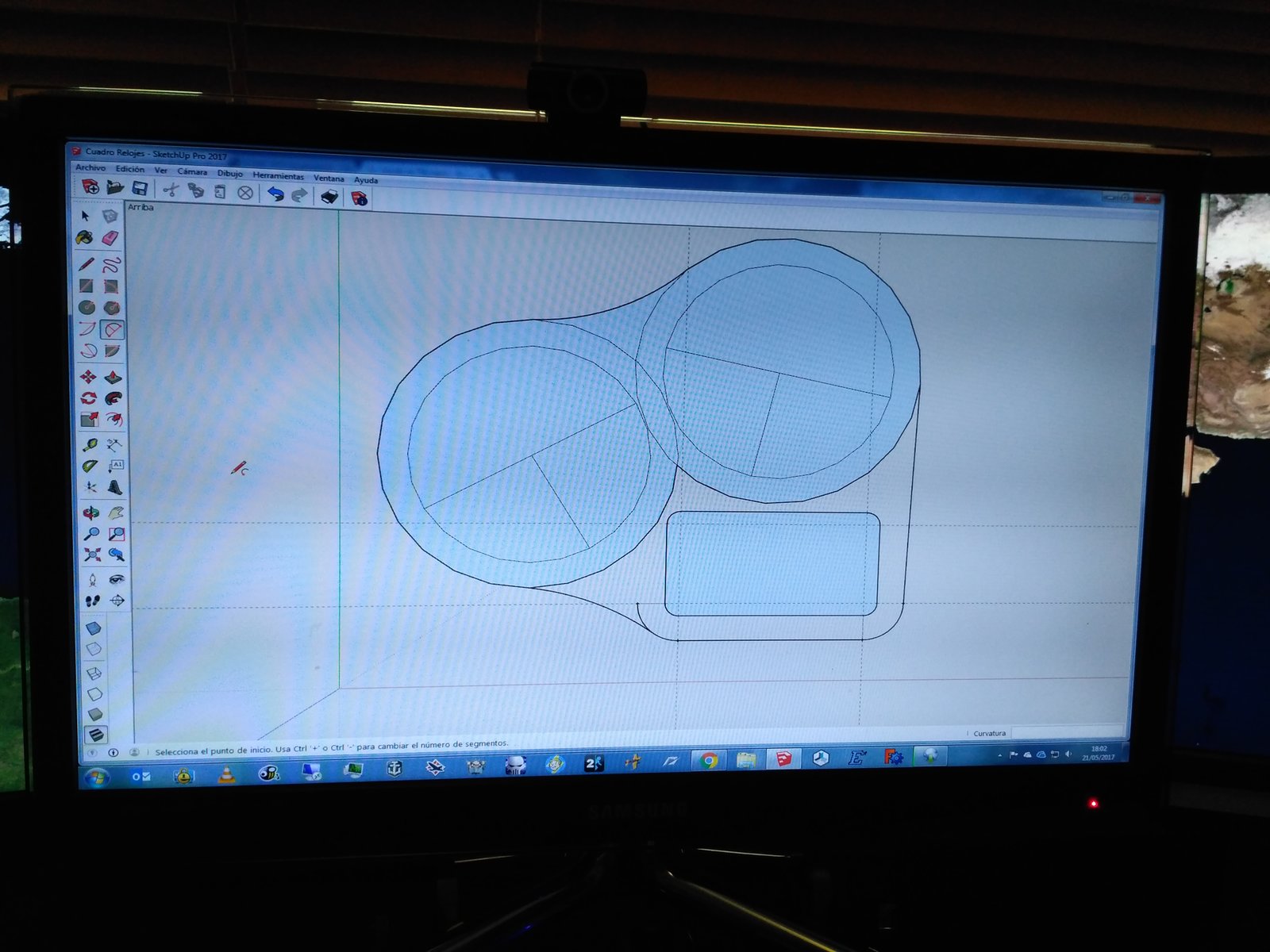

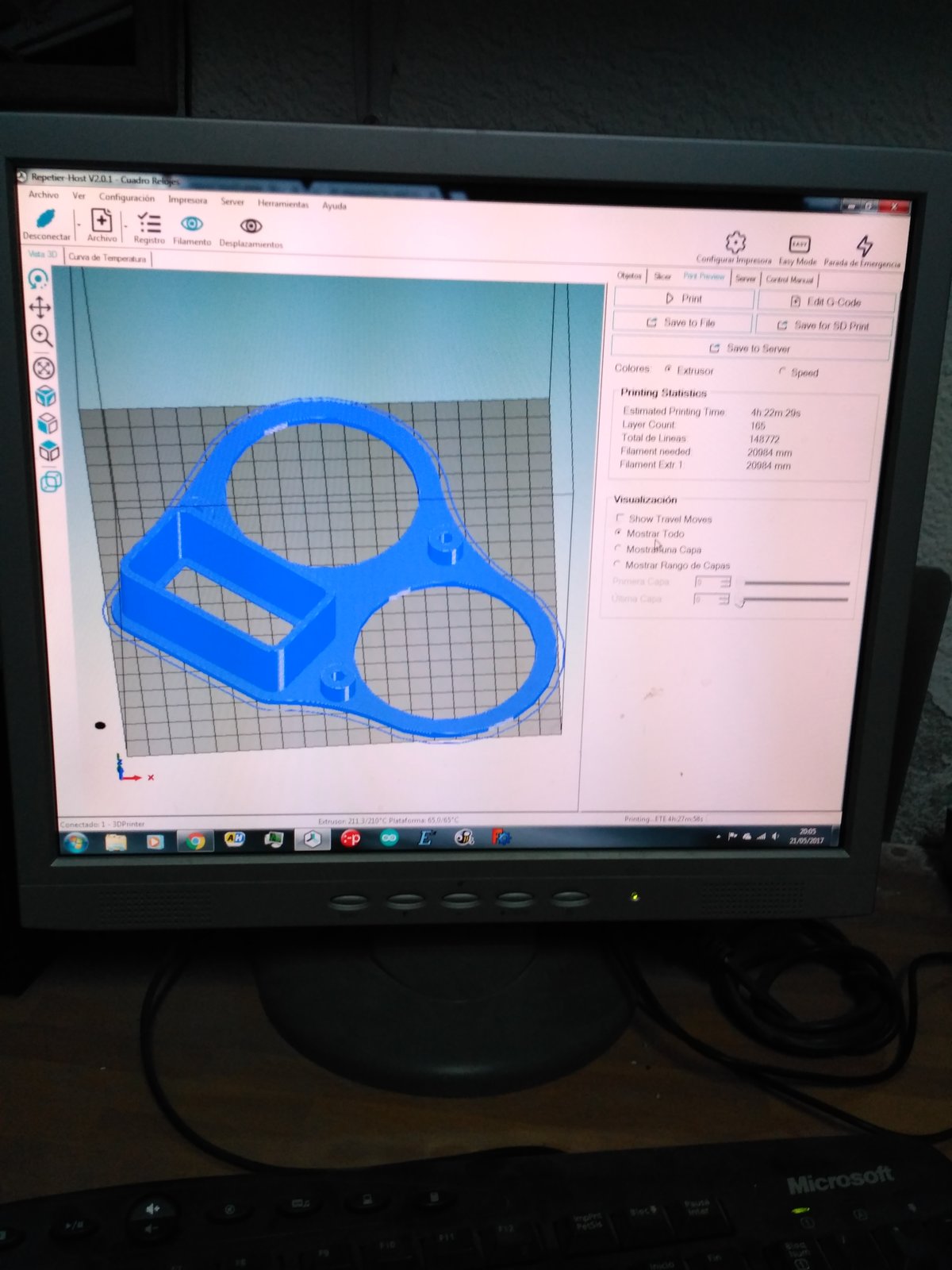

    Using a CAD software I design a new gauge frame that fits the new clocks (SpeedHut measures in inches and the gauges are some mm. wider than the originals)
    Once the prototype is done, I will fabricate it using the 3D printer (total cost less than 10 euros)
    Afterwards I will use the CNC cutter to cut a 2mm aluminum plate to use it as the visible face of the dash (plus to add rigidity to the set)
    Sorry still no pictures of the finished thing. I will post them after summer.

  15. Hi Al, mine will be finished in satin Aluminium.
    I'm now a bit stuck because the size of the gauges frame is 210mm long and my 3D printer printing space is only 200x200
    I have to figure out how to solve this (without buying a bigger printer bed)
    Defeated by a 10mm piece of plastic.. wow!
