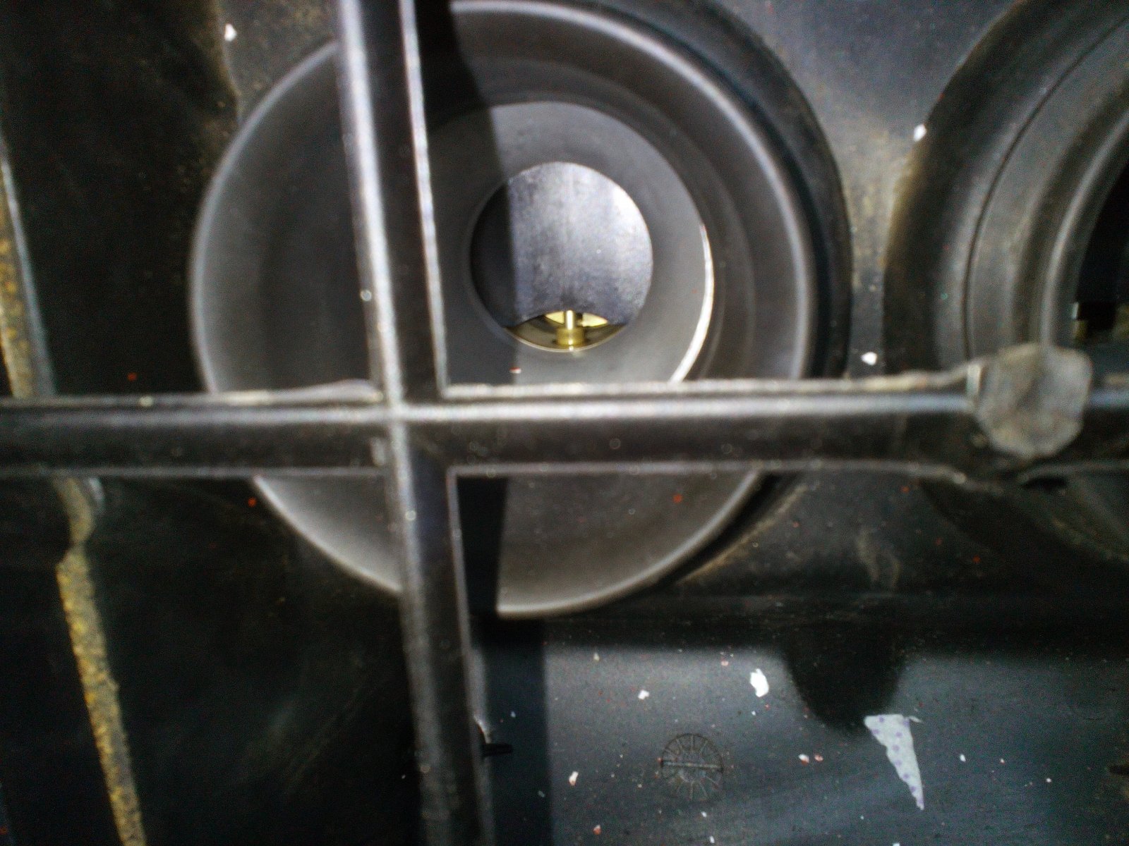

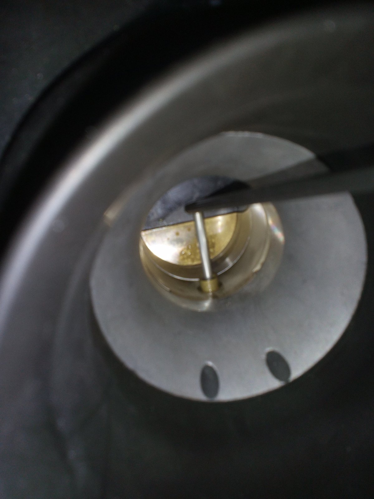

    Here are a couple of pictures of the "sliding black doors" I was mentioning
    Is the black thingon the bottom of the funnel that - when is closed - lets you have a peek of the carburetor needle underneath
    when you rev up the engine there is a clear suction sound and the black lead slides upwards to look like this.
    Well, this only happens in one carburetor. The other one stays closed.
    If you push the slides by hand you clearly notice some sort of "elastic" resistance and a soft suction noise from the one that operates, while the "broken" one does not present any elasticity at all, it just dont work.

  2. Those are standard Mikunis. As @Arquebus says, if one slide is not moving, the rubber diaphragm will be damaged, so no vacuum to lift the slide. Replace both.
    Fit a jet kit with new needles while you're in there and set the float height to 14mm for both carbs. Check the pilot screws are not seized in their threads. If they are, it is possible, with patience, to drill them out and replace them. If you do need to drill them out, ask me how. I have done it successfully and was able to tell someone else how to do it successfully too - no guarantees though...

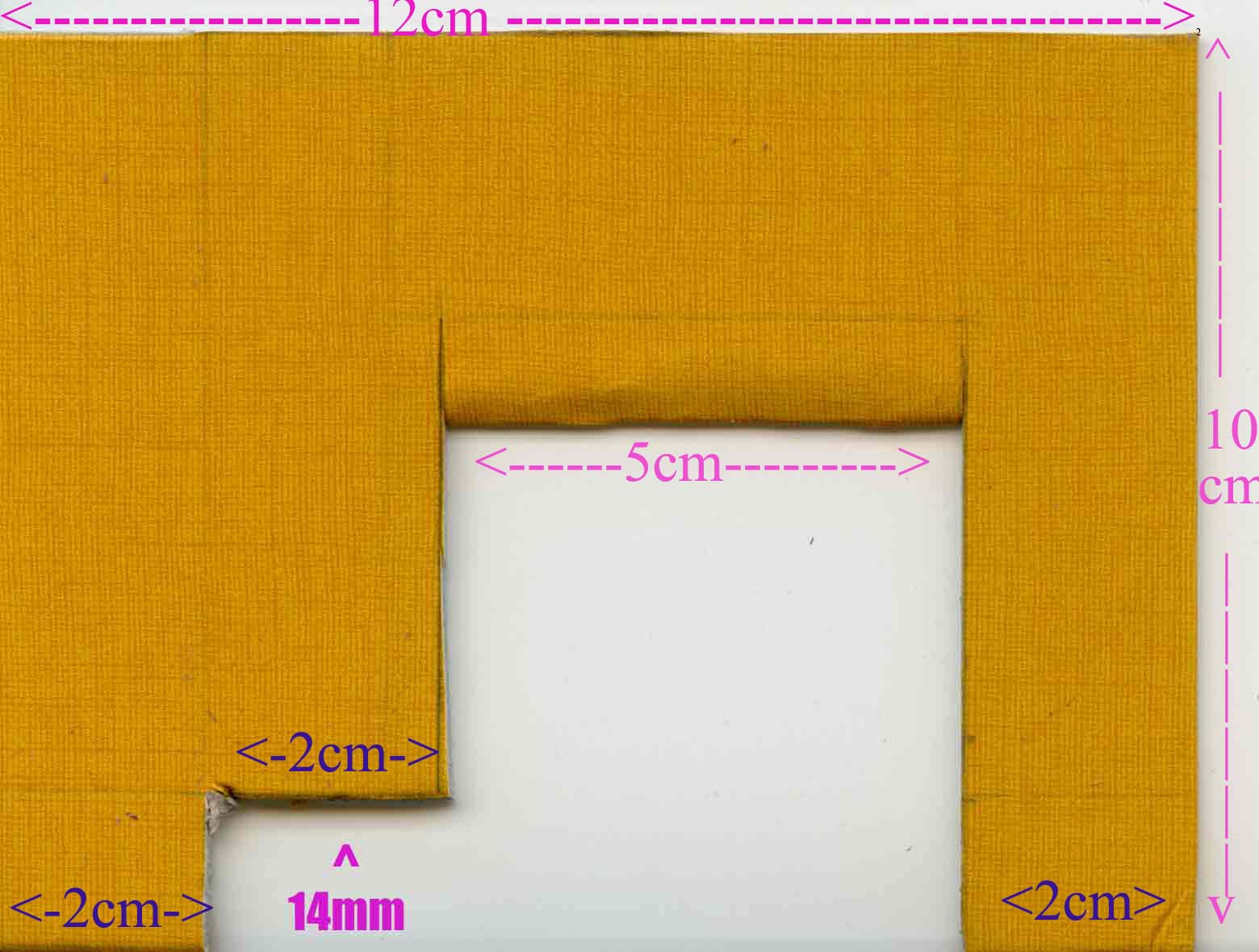

    I can let you have pictures of a template for setting the float heights accurately.

  5. Don't alter the float/fuel levels until you have replaced the worn or damaged parts in the carbs.........The level is normally set correctly at some stage in the bike's life.
    If you do alter the height, make a note of what they were before you alter them so you can revert to them if necessary.
    The 14mm is an arbitrary measurement and generally it isn't correct.........This is because the pilot jet circuits are reliant upon the float/fuel level as well........this also means that the pilot circuit is in use for quite some way up the rev range, until the main jets take over..........alter the height and you can upset the idle and low revs running.
    For example, when I first checked mine, one was set at 12mm, the other at 9.5mm..........For both, I tried 14mm, then 13mm, then 12.5mm........I still think they could be lower, IE, both at 12mm.
    Definitely one of the diaphragms will be split when you finally expose them............If you get really stuck for spares, I have several float assemblies which are used but probably serviceable..........I may even have some used diaphragms which may be OK.
    Incidentally, when you get the carbs apart and have the main jets and needles, plus the springs on the bench; take a photo of them and post it on here.........that way we can see if you already have a Dynojet or similar kit installed............with those exhaust cans, I expect you may have.
    You may also find that the float needle valves need changing..................unfortunately it seems that replacing the whole float assemblies is the best way to do this..............you can get the needles separately, but that's no good if the seat in the assembly is worn.
    When cleaning out the carbs, make sure you clear the cr*p out of the pilot circuits and don't use rags which let small fibres come off them........these can block the pilot circuits.
    This a template for a float height measuring tool I made. This makes it really quick and easy to measure your float height accurately. Without it it is really tricky to judge properly.
    You can always make more than one for different heights

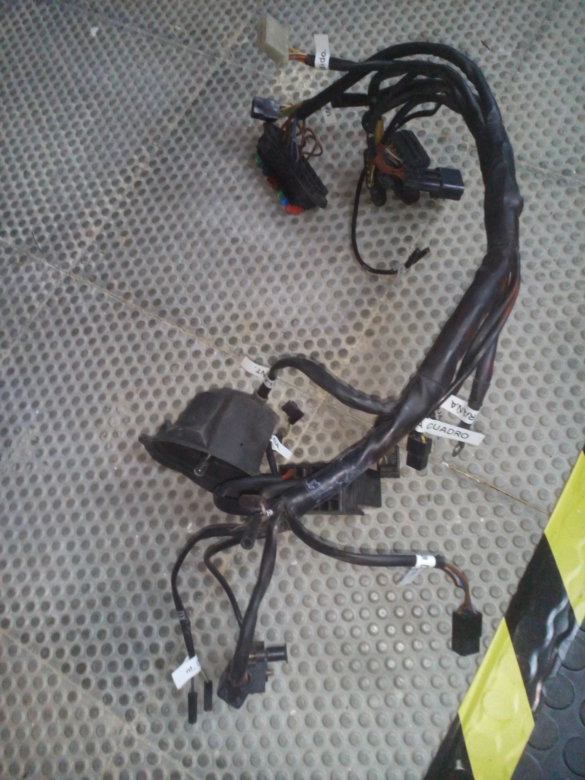

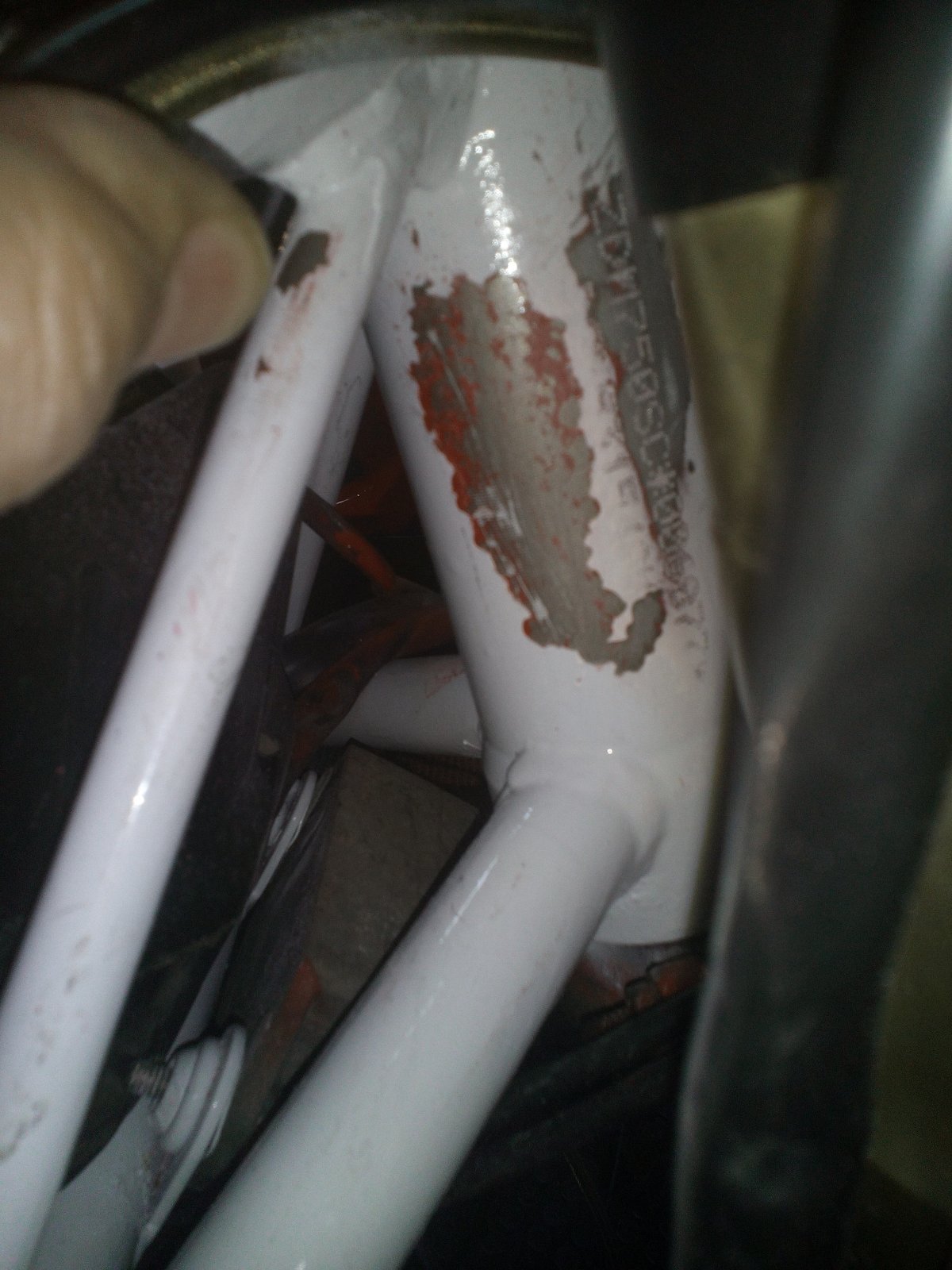

    Just removing the front electric loom and carefully tagged all pigtails to be able to reconnect them back (I will reposition some of them following DutatiSuite ideas)
    As you can see, the frame has been painted several times coat over coat....
    and paint was liberally sprayed all over without care (tsk, tsk..)
    No worries, it is just a matter of brushing, cleaning (spread wax, polish wax,... little grasshopper..)

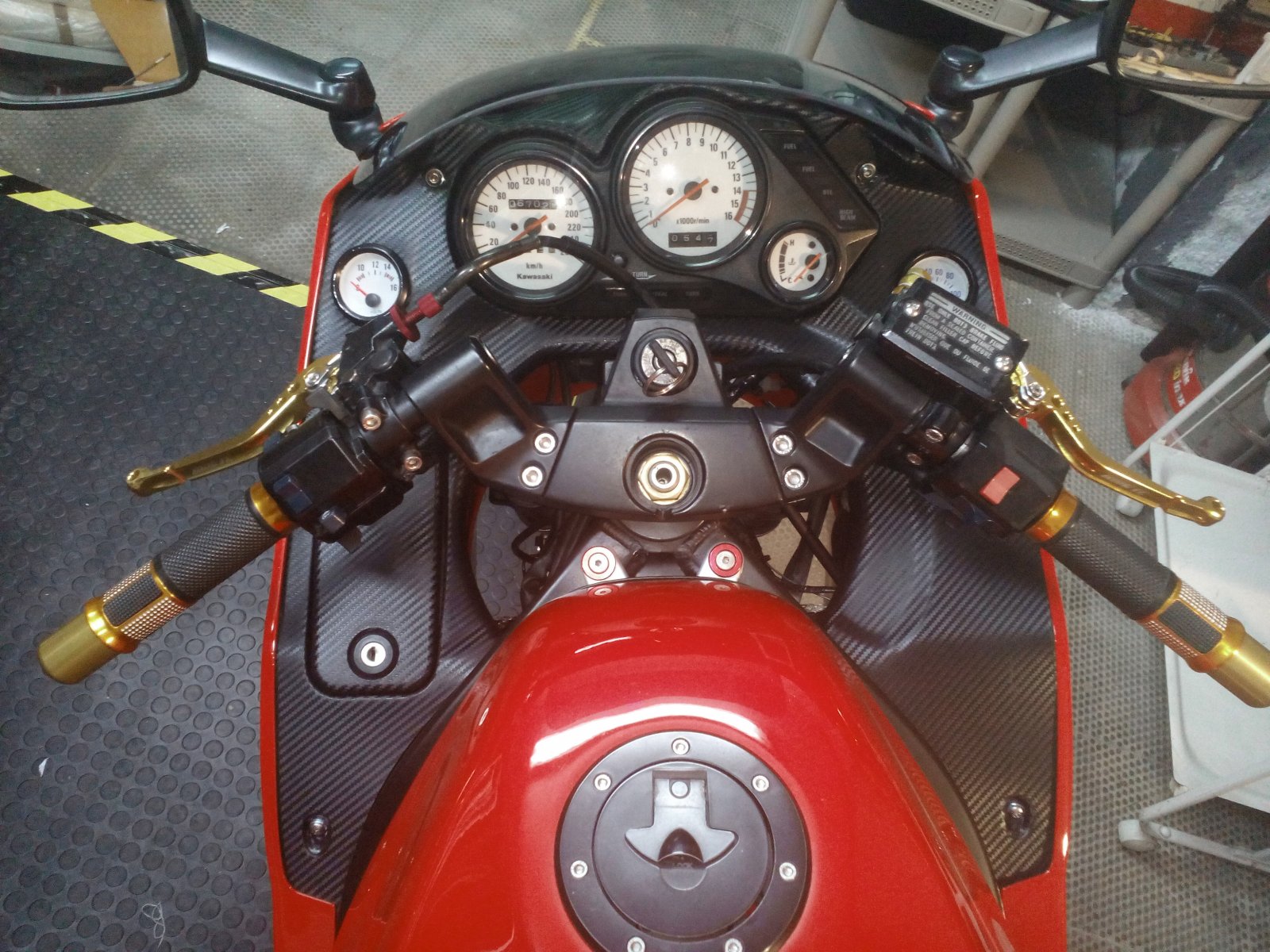

    Regarding the bars and clutch and brake levers, mi idea is to do something similar to what I did on the Kawi.

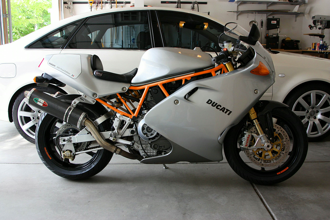

    I also like the white frames. But in this case I think I will go to a totally different paint schema.
    Not made totally my mind though, but how about something similar to this?
    Its kind of weird trying to imitate the 900 FE colors, but that orange frame....!
