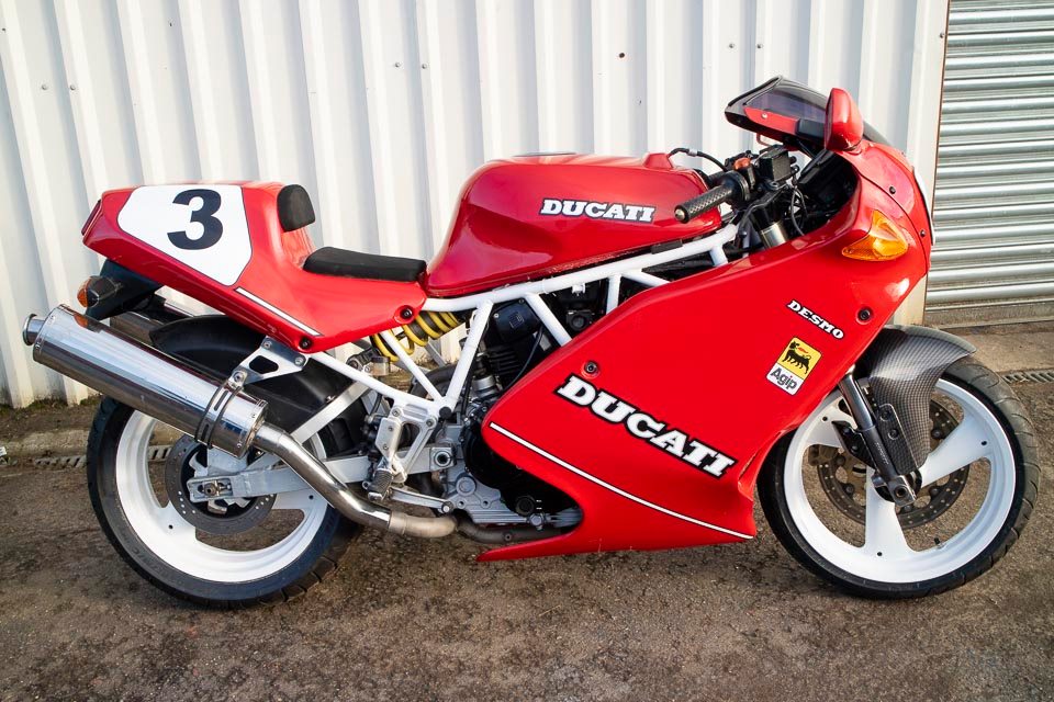

  1. Hi all,
    I have a single disc 750ss and was wondering if it was worth getting a twin disc set-up? I have seen various bikes bikes being broken with twin discs, so would that be an option? Would I need a different front wheel? To be honest the bike is not raced or thrashed, so it would be more of an aesthetics (vanity!) upgrade.

  5. That bike looks amazing but is crying out for a second disc, JDI :)

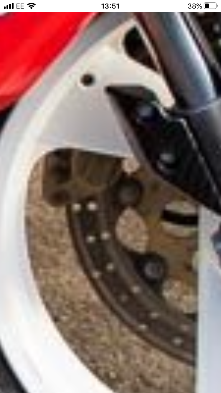

  14. Don't I also need a right side fork?
  15. no, as said, the little cover will reveal the presently redundant caliper fixing on the R/H fork leg.
