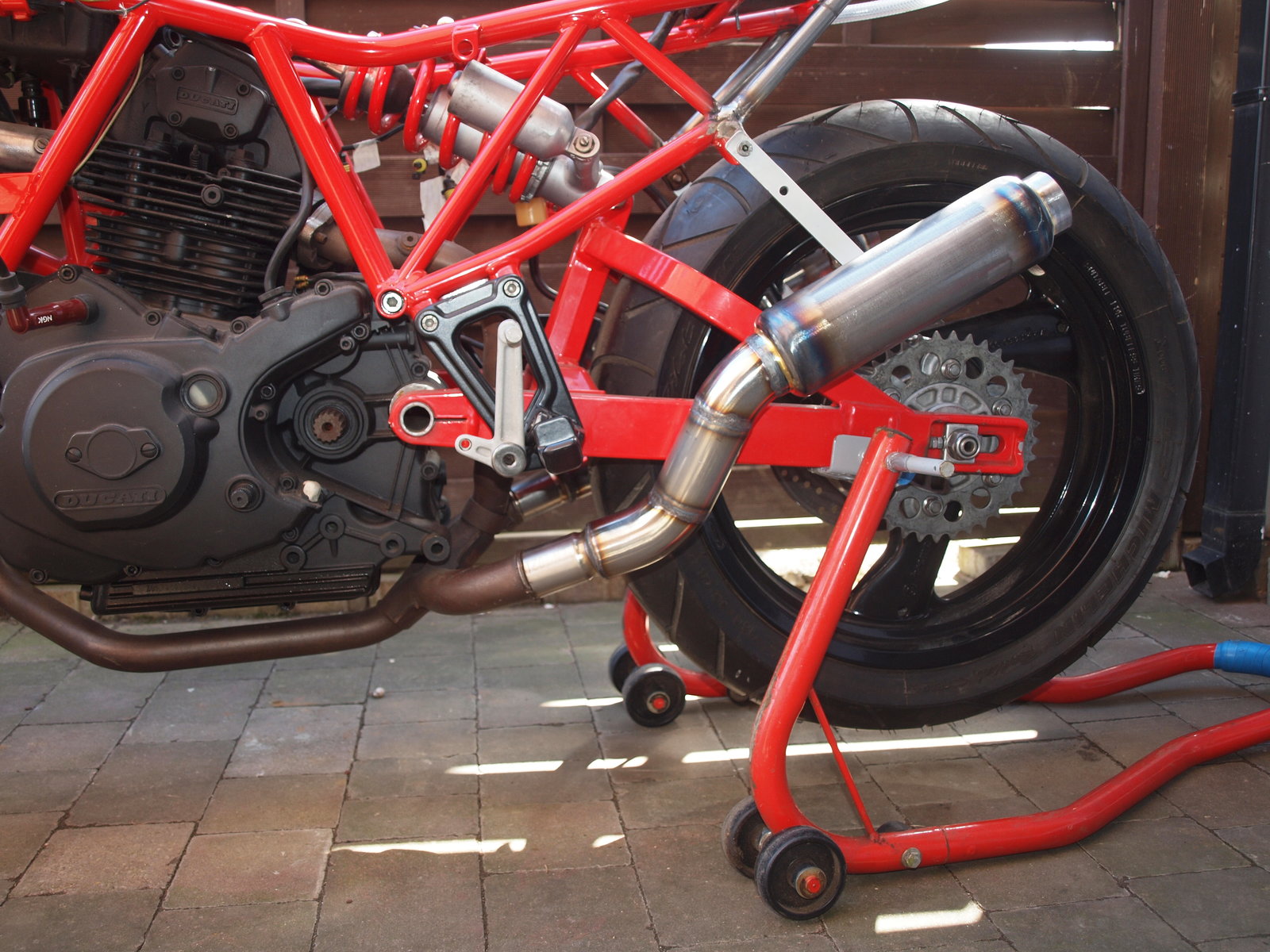

    Been a long time and quite a few things happened to get in the way of the build Finally got the exhausts sorted
    Also cut down the rear of the frame, welding in a new piece
    Now need to get the rear curved end made

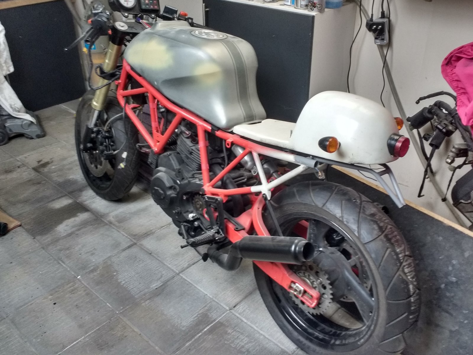

  17. It lives. Been a long time. Life gets in the way sometimes. Anyway, some things have been done to the bike
    We're getting there
    Monster Loom fitted
    Monster speedo
    Exhausts by Fecked, though they are too loud so looking for similar that are quieter...........suggestions?
    Double disks on the front to balance the look
    Fired up first time after 5 yrs.......hoorah!
    All done without any welding skills, just "Oh well, gotta learn sometime"
    The indicators have been removed from the seat
