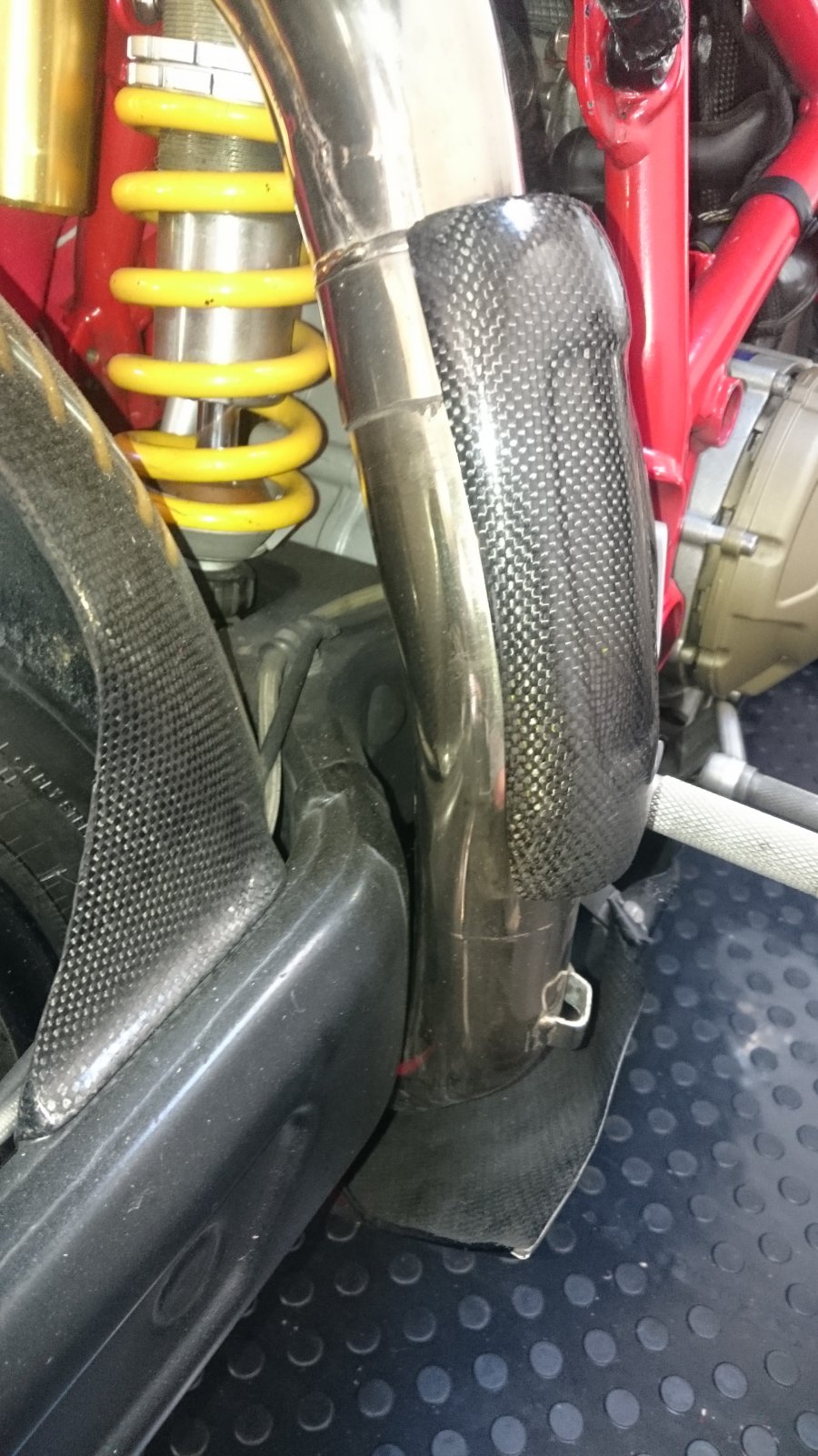

  5. @Lucazade here are some pictures showing my old style system DSC_0467.JPG DSC_0466.JPG
  6. On some systems, you have to grind off the exh mounting bracket behind frame.
    On R models, these can be unbolted but on non R frames a grinder is needed.
  7. Yes I can see that came to same conclusion today, made the pipe closer to Swingarm flat so have more clearance, now just need to grind off that mount
  8. You could just buy an R...save the grind of..errr....grinding.
  9. Rick can you do photo of the pipe that goes near sump and where it's bracket attaches to rear brake bracket?
