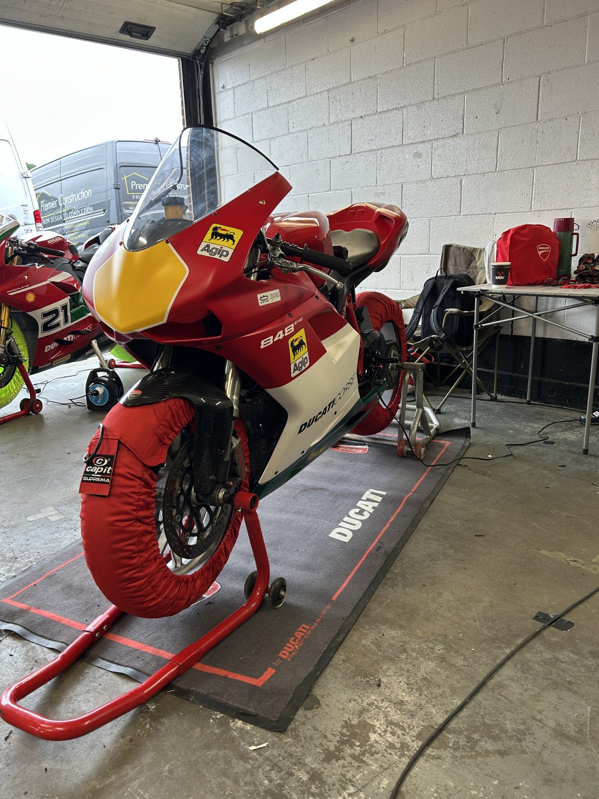

My track bike went bang on the sighting lap at Brands a couple of weeks ago. Fortunately I noticed an odd noise as I queued in pit lane that got louder as the sighting lap progressed, so switched off and free-wheeled back to the pits. Front cylinder big end shells had melted. Looks like I need a replacement crank, con rods and maybe pistons. Due to cost, the alternative may be part out the bike, but that feels like putting down the family pet Sympathy, optimism, help and cheap parts gratefully received
