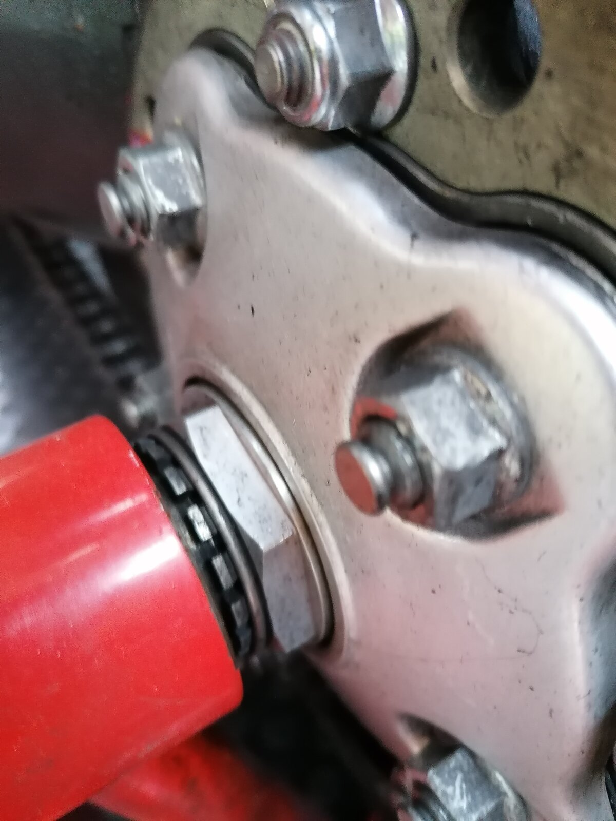

  1. No, everything put back the way it came off. The only thing I have not reinstalled yet are the large circlips. I don't just mean hard to turn, it would not budge at the torques setting suggested. I admit it's an odd one.
    I even undid it all to check the wheel was properly aligned and in place, lowered the settings repeatedly till the wheel turned at 100nm. Unless I am missing something vital in the methodology I can't see where something so simple is going titts up, it's not like I have not done it dozens of times before on other bikes.

  2. On your picture it does not look like the axle part of the hub has come fully home. There should be threads showing after the nut is on, and you should be able to see the holes for the lock clip through the nut castellations.

  4. Are the cush drives hitting the aluminium eccentric adjuster?
  5. Brake calliper bolted to the wrong side of its bracket not allowing hub to slide fully home?
  6. I'll check that as well to be sure but I don't see how they could be as it was all done on the bench. as you tighten the nuts it pulls them in. If they were proud I would have noticed. But everything will be double checked and I will report back.

  10. The wheel nut only retains the wheel.
    The nut on the chain side holds the shaft onto the bearings and retains the sprocket and cover.
    Do you have a gap between the cush and eccentric?
    Did you put the washer/spacer on in the correct order?

  12. Are the sleeves still inside the bearings within the eccentric?

    It appears that tightening to the correct torque, like you say, allows the nut to tighten and apply compression against something which actually locks the wheel. Loosening the nut to 100Nm releases the compression sufficiently to allow the wheel to turn - this is perplexing and should not happen.
  16. I still think it’s the brake calliper been fitted in wrong side of the bracket. If this was the case and the nut was tightened to correct torque, could this be pulling the pad onto the disc, effectively locking the wheel :thinkingface:
    Stick a pic up of the brake calliper from underneath showing the bracket and I will shut up.
    If the previous owner had done this (wrong side of bracket) that would possibly explain why the nut was so loose. It’s the picture showing the nut in the stub axle with no thread past the nut that is making me think this.
  17. Problem solved. Just had another crack at it and disassembled everything; seem I put the conical spacer in back to front so it was clamping the whole thing tight - Ockham's razor in action.

  20. Looking at the pic of your sprocket side, the nut appears to go into a chamfered/countersunk recess.
    On my M1100, the nut flange is in line with the plane of the boss on the cush drive retaining plate. I'd expect your 848 to be similar.
