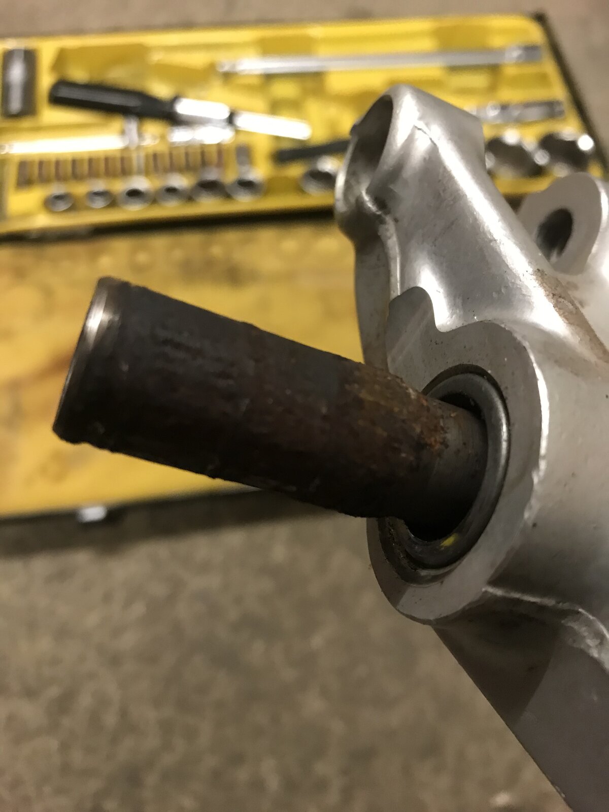

  5. I’ve just had exactly the same fun with mine! Tried and broke everything you have! Really bad design, crap access, coupled with ferrous and non ferrous material corroding each other, especially when wet. My tie rod bolt was seized in arm aswell. Was changing shock anyway and I found a nicer swingarm for not much money so just replaced both. Still needed to get tie rod off, so took it into work and heated the area on swingarm around bolts with Oxy Acetylene, not much, up to about 150c and quickly impacted both of them off. Had to grind a small hex socket to get it through access hole.
    Got some new bolts from Rapido and put back together.
    It’s worth taking the swingarm out to grease the axle, had to knock mine out all the way and was “dry as a nuns c…!”

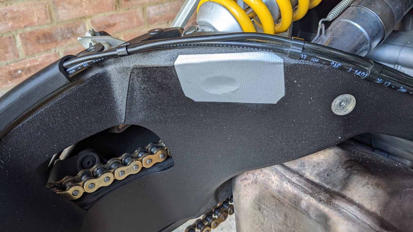

  11. Well .....I removed mine (1200 multi) ..came out ok ... used ceramic grease ...had a bit of a struggle getting shock to align ....so I removed top bolt ...luckily easy to get to ....hard to tell what's happening still when re fitting bottom bolt but all ok. Had to compress shock to get top bolt back in ....but better messing with that bolt than trying to align the troublesome bottom bolt. Applied gorilla tape patch over the bore on the swingarm ...I already had one on and it's remained (very).stuck was hard to get off ...needed heat and solvent.
    • Useful Useful x 2

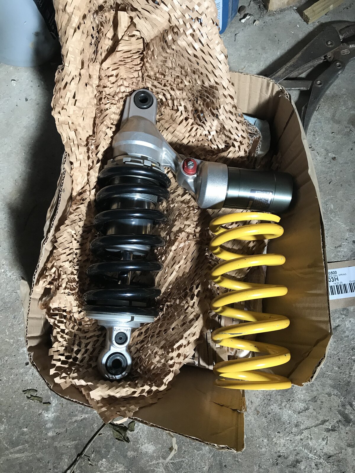

  16. Replacement shock, re gassed and spring fitted ready for action.

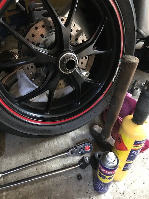

  17. So today was strip out day, got my neighbour round to sit on the bike so I could undo the rear wheel, broke a Snap On ratchet and a 900 long breaker bar, is now booked in at the local bus garage to undo the nut, bike really does not want to come apart.. IMG_0604.jpg
