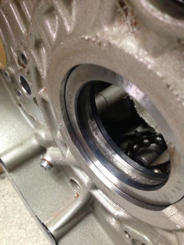

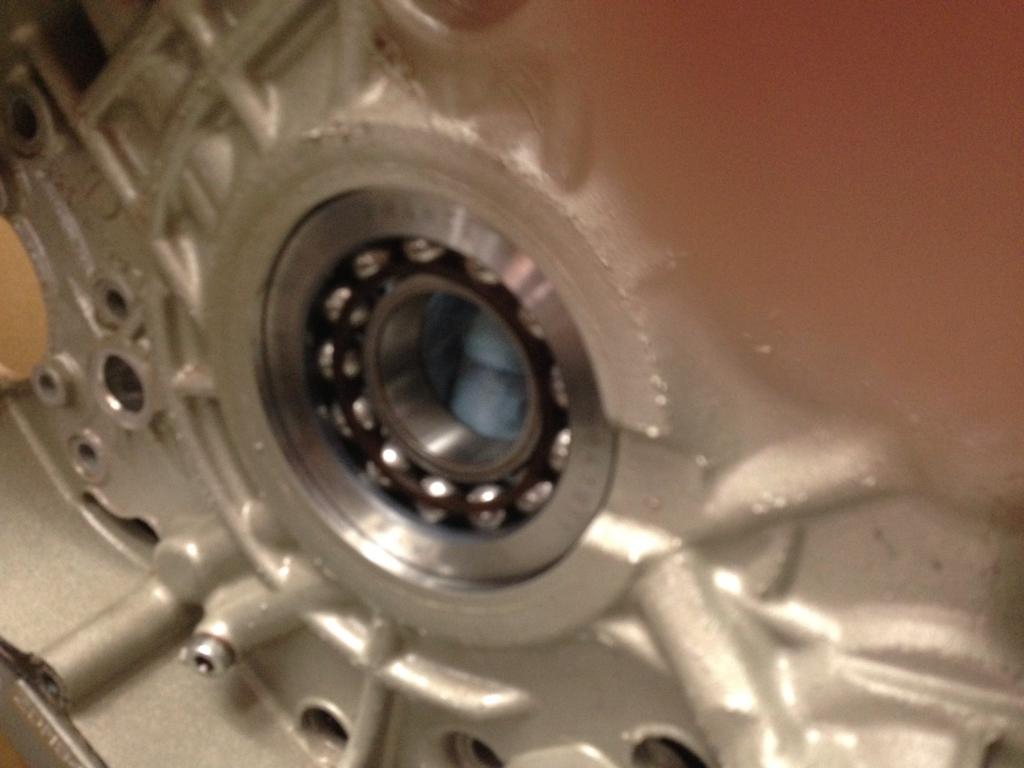

  7. Here's a pic of the Damage
    French cheese!

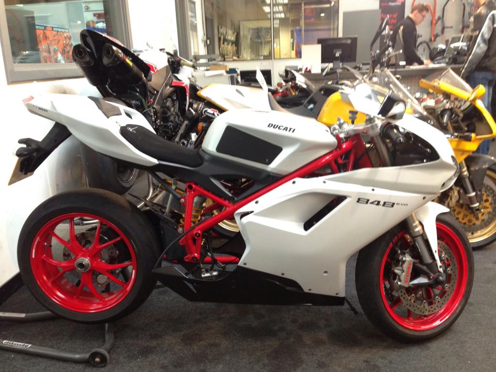

  8. Poor Duc
    #28 Fire_2, Sep 18, 2013
