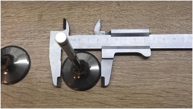

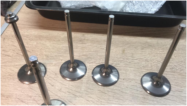

    For the first, we try to rebuild heads like “R spec”: we designed and made to order special titanium 6 mm valves 34mm and 42mm (the same size as D1098), valve guides and seats were made by ourselves, and we installed cams from D1198, with valve lift 13mm.

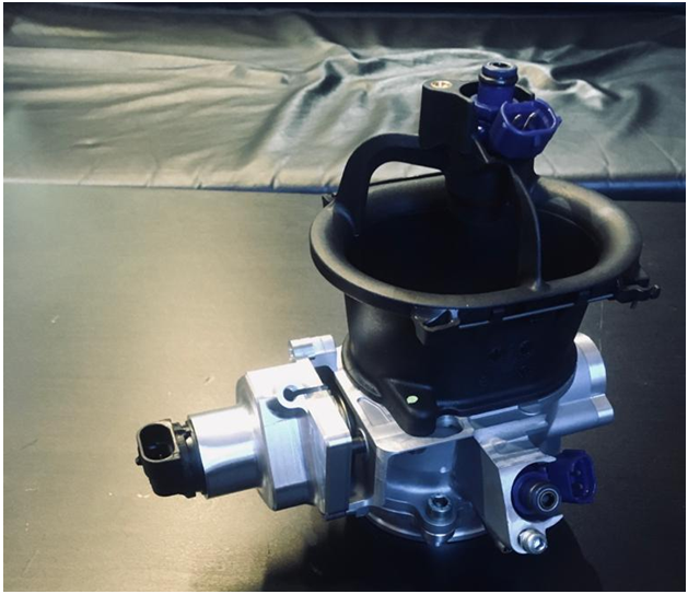

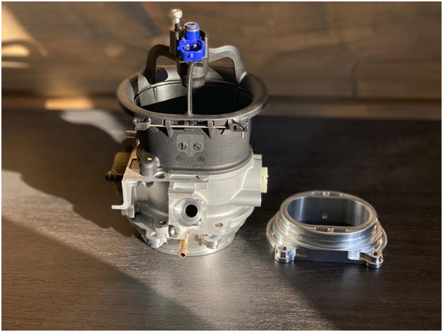

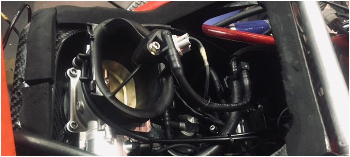

    Another problem for D848 (and 1098-1198models) is a throttle body (tb). It makes a lot of troubles during mapping and does not let to make good result. We decided to change it for tb from D959, for correct injection. After some research we made CNC kit for reinstallation of 959tb for manual operation and install everything on the bike.

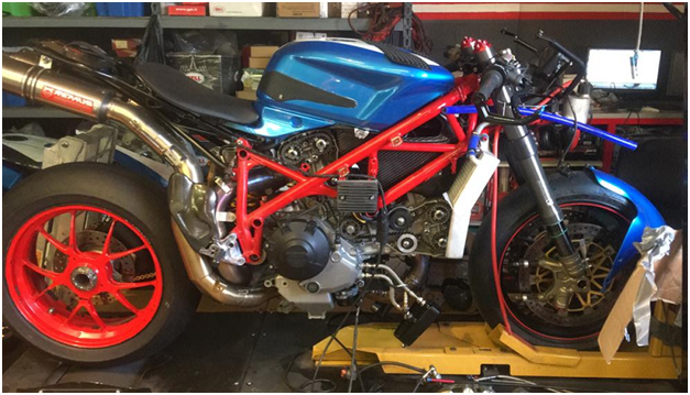

    The spec list:
    Engine:
    1040 BBkit
    Shafts 1198;
    Valves – titanium, standard size, specially made according our spec in Russia;
    Valve seat and guides made by us from special beryllium bronze;
    Connecting rods – Carillo steel;
    Pistons - Pistal HC 104mm;
    Crankshaft – polished and balanced by Ducati Kaemna (thanks to our friends and partners – Rudiger and Hauke)));
    Generator assembly – from MV Agusta F3 675… lighter (set weight is about 2kg), smaller… and more powerful))));
    Full head porting and special squish gap made by us:
    Other:
    D959 Throttle body with 2 injectors per cylinder and manual operation;

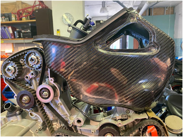

    Air box - oversized from DM Meccanica;
    SBK racing wiring harness (thanks to Gian Piero Tamburini)));
    ECU - EVR (based on Microtech);
    Exhaust – full Remus;

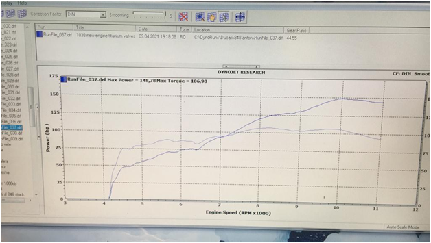

    The first result on Dyno (DynoJet 200) – 148 HPRW.
    With engine map for D999r (as it’s nearer to our parameters) without correction. We think, after some work with the map on Dino, we can reach more than 151-153 HPRW.
    As you can see, after 10000RPM power is going down, although we planned that it is to be increasing up to 11-11500 RPM. We think that the problem is the exhaust system, which cannot provide the necessary gas dynamics??? May be some else? Ideas?!?))

    What cam timing are you running? What is the diameter of your exhaust? it looks very very large...

    Cam timing is standard for 1198 - 18/58
    Exhaust diameters: from cylinder - 58,5mm, middle - 69.5, tail - 60
