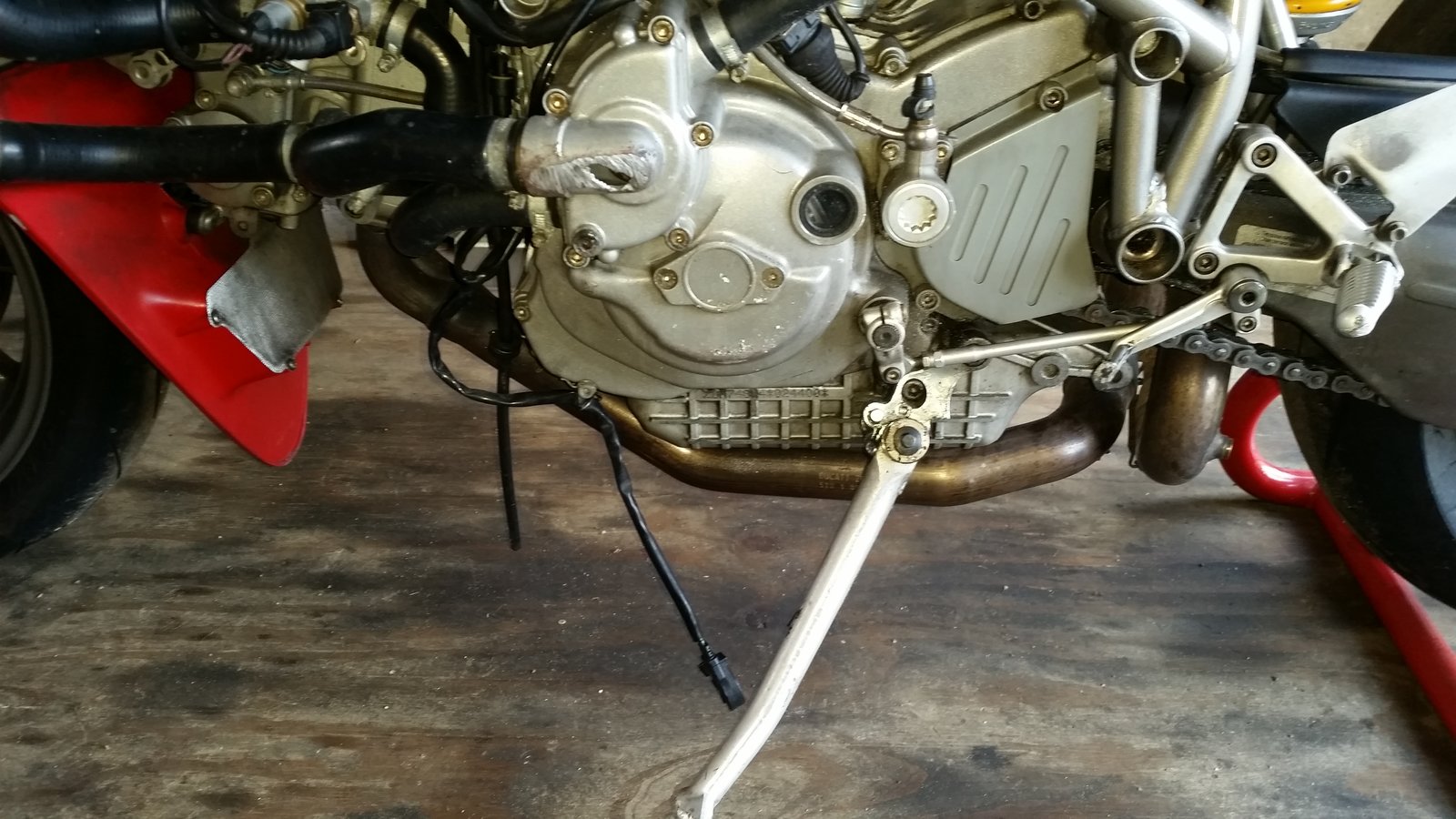

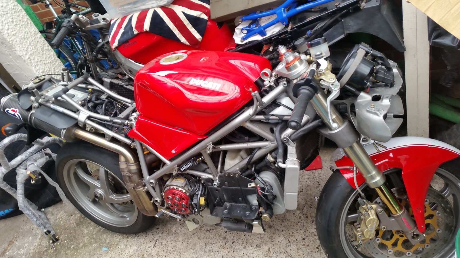

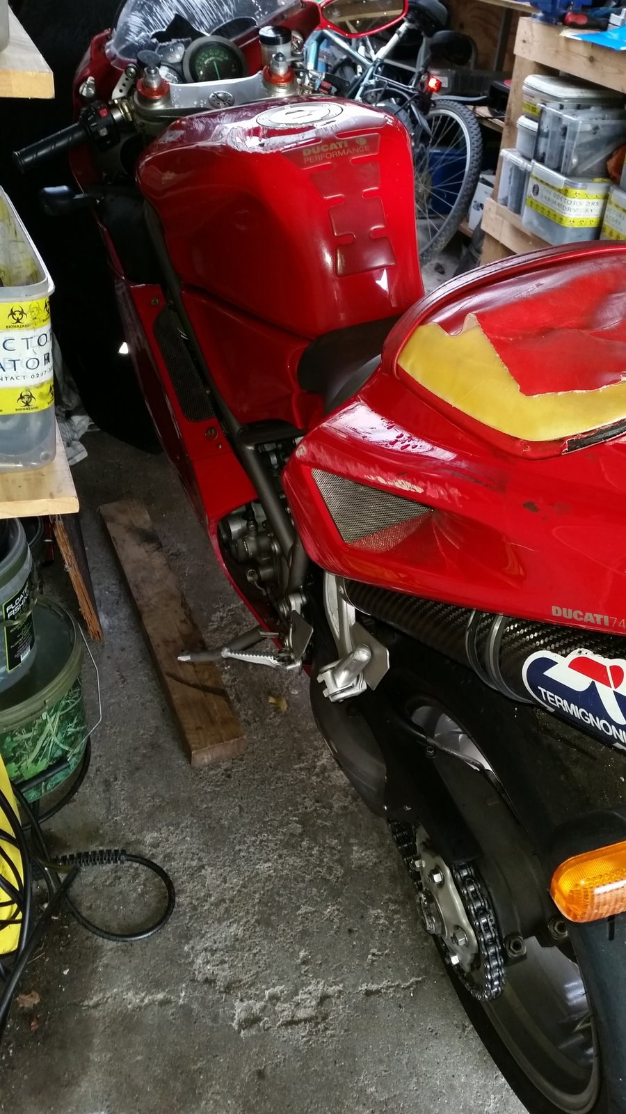

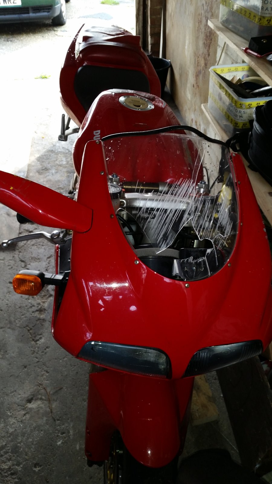

  1. Bought a crash damaged 748s in September 2015 . Had a 853cc conversion from Protwins , Marchisini wheels , Ohlins rear shock , slipper clutch and Termi exhausts with chip and dyno mapped Power Commander 3. Almost finished the project now and hopefully get it running this weekend . 2015-09-17 08.54.17.jpg B 2015-09-17 08.55.04.jpg

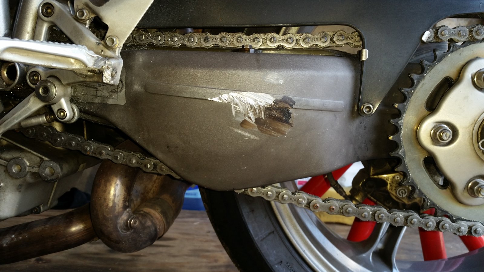

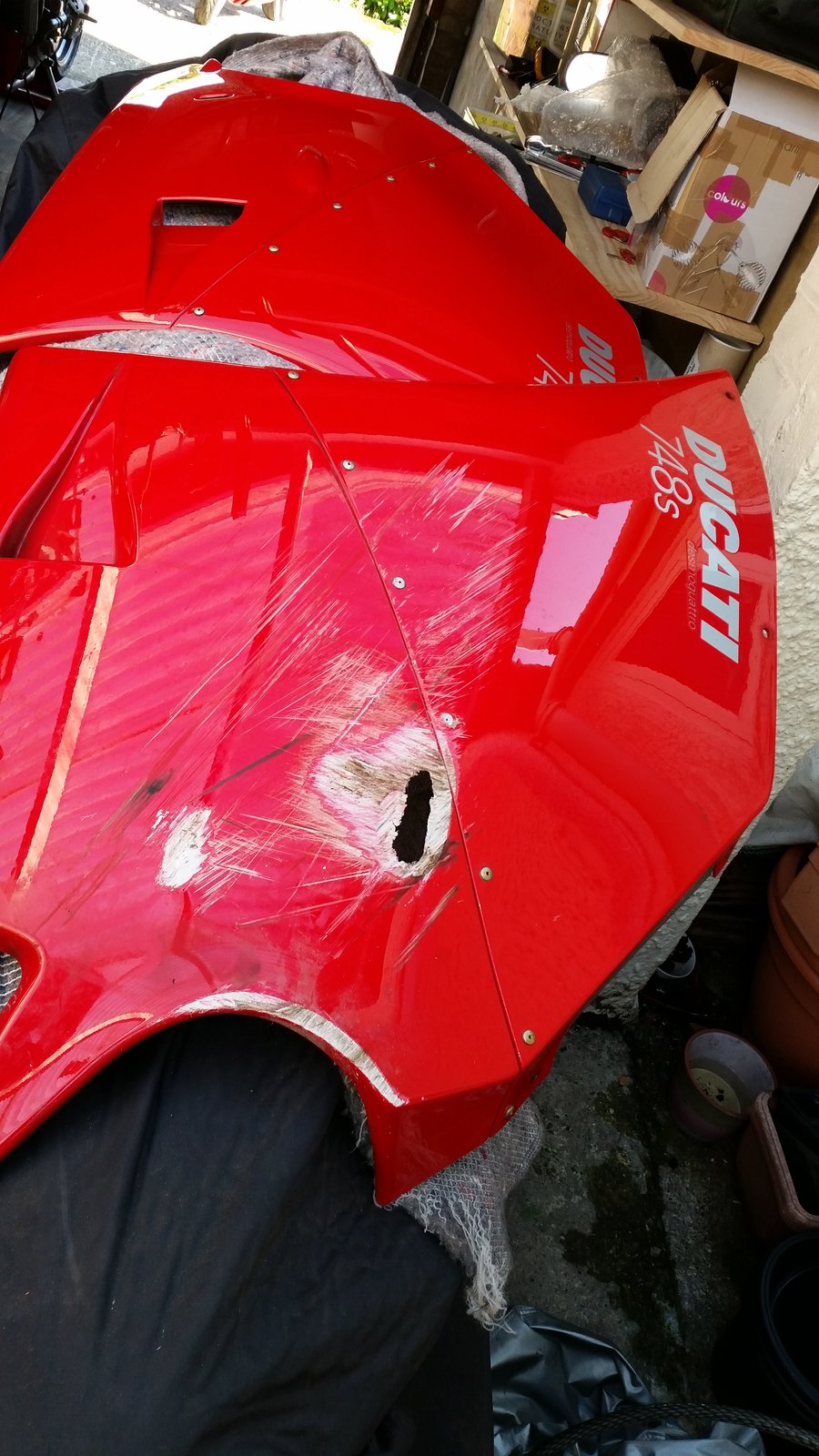

  7. Do you think you'll be able to polish out the rest of the marks!!! just outa interest how much did you pay for the bike, looking for a 748 project for myself.:upyeah:
  8. Already polished out will post a pic today. I paid £1400 back in Sept 2015 .

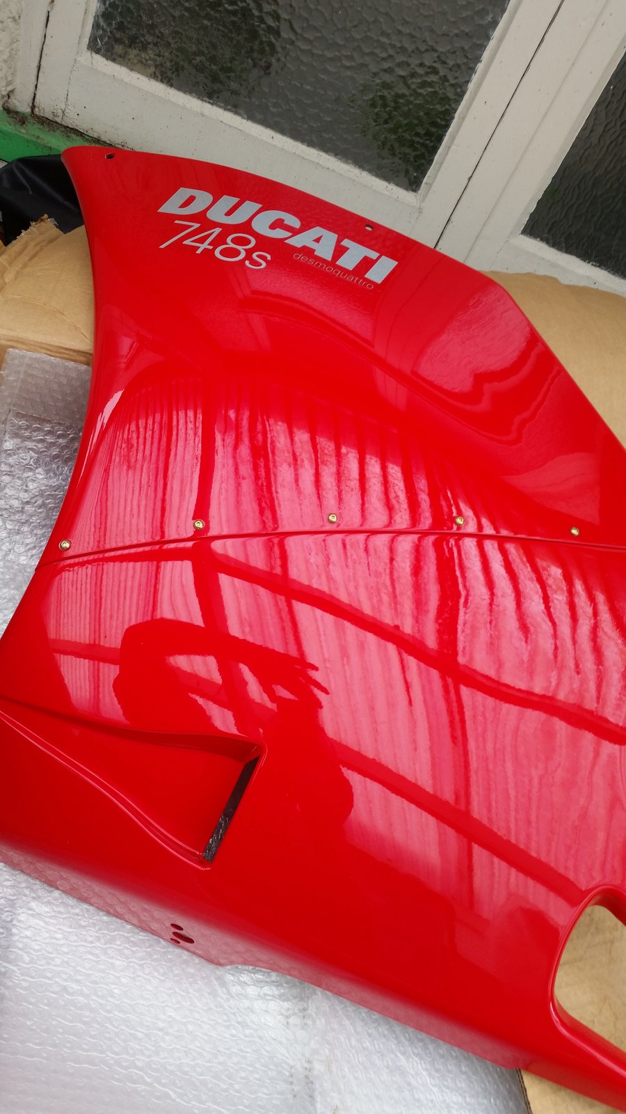

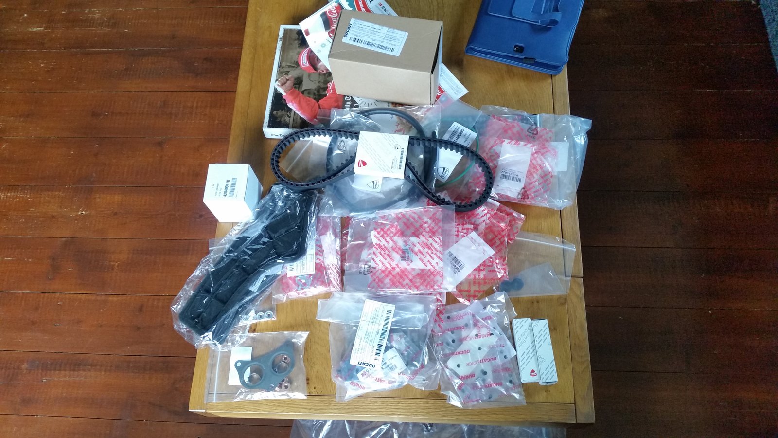

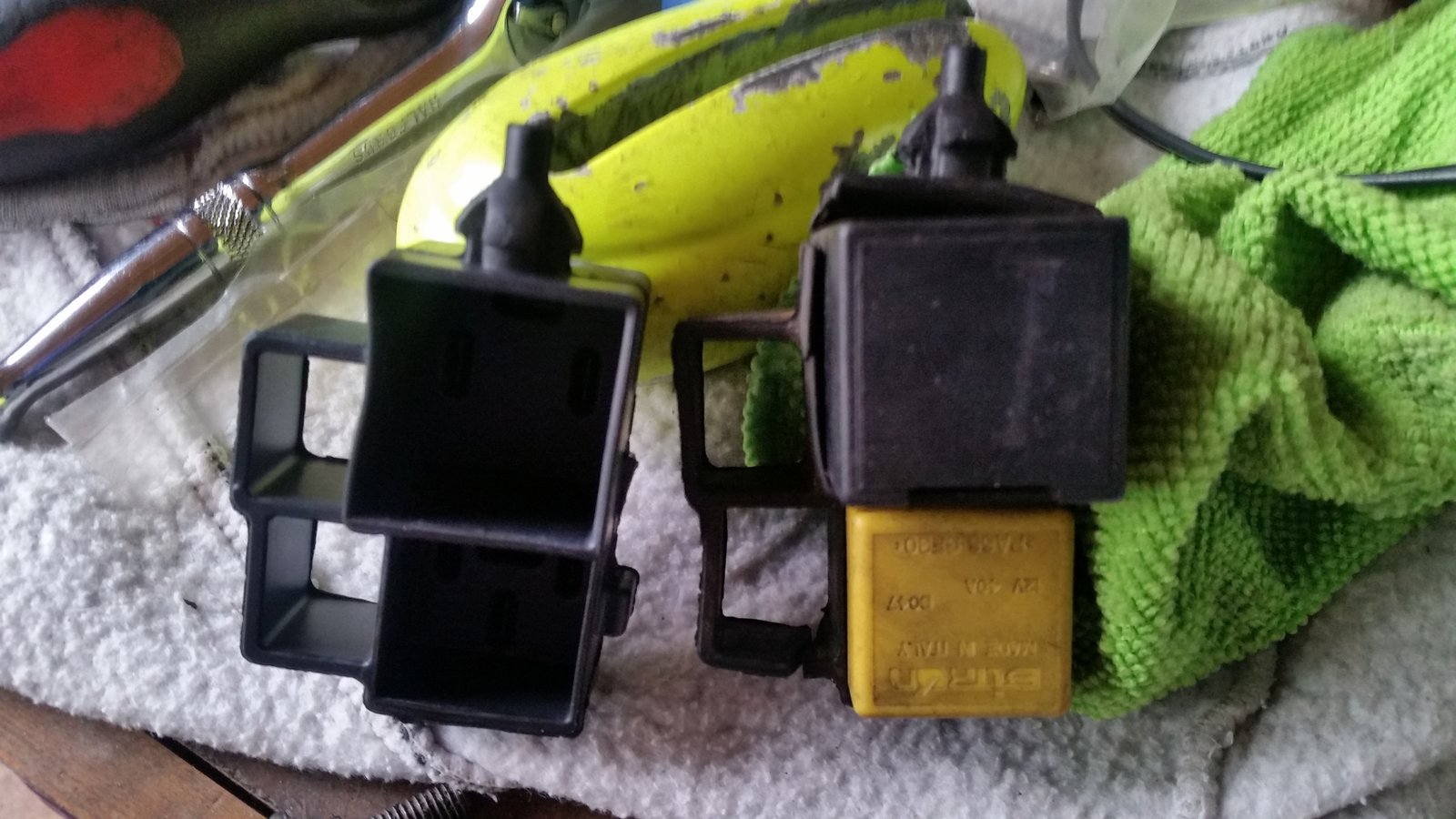

  10. Goodies from MotoRapido . Some of the parts were very reasonably priced I thought .
  11. If that panel is anything to go by I look forward to seeing the finished bike.
