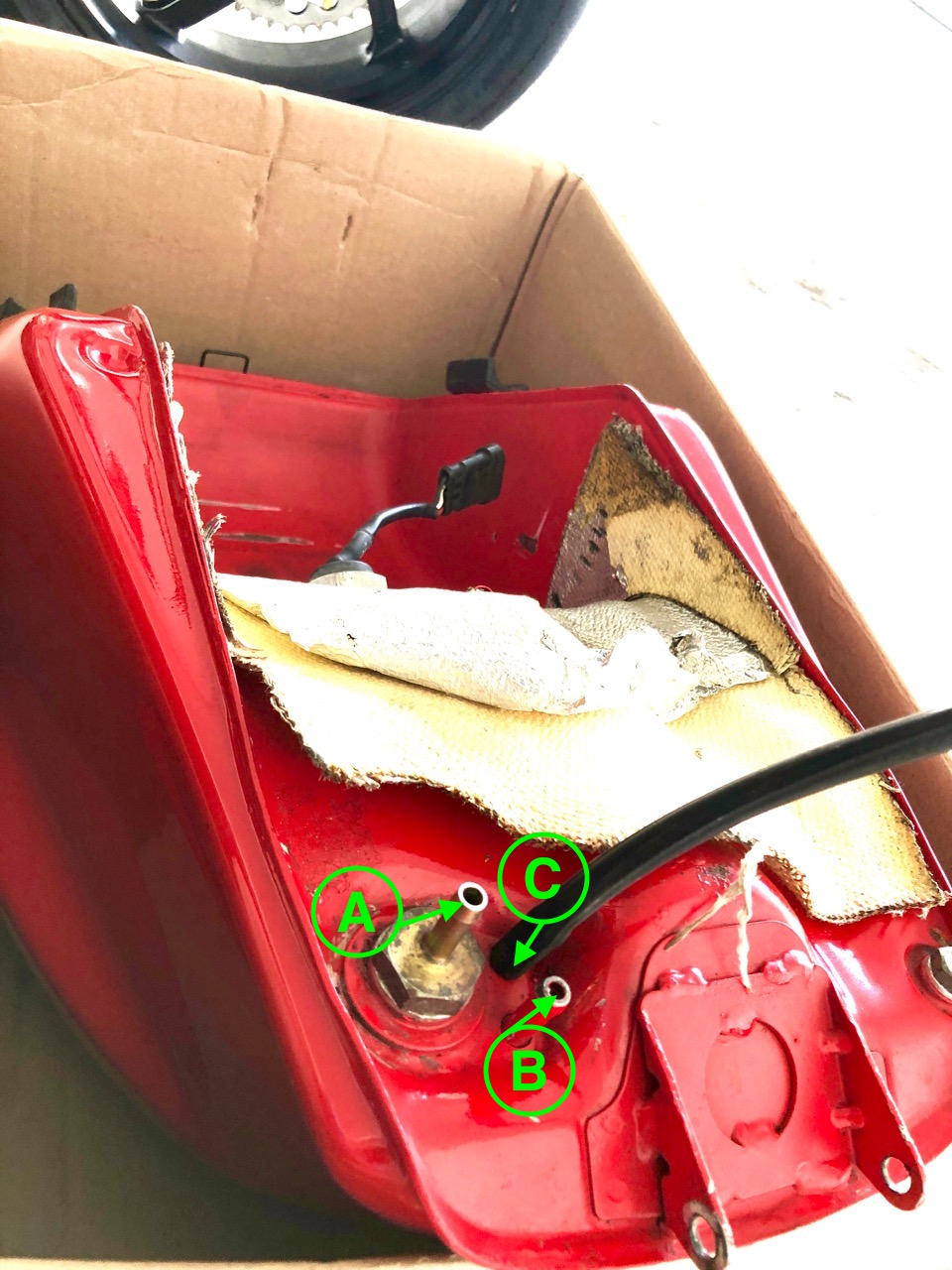

  6. Next question... Can anyone advise the correct fuel tank connections on a 888 fuel tank (picture attached below)?
    A :
    B :
    C :
    Also just to confirm the fuel flow is :
    Fuel tank > horizontal cylinder > vertical cylinder > pressure reg > tank return (?)
  7. A is fuel return from pressure regulator
    B is fuel to Vertical
    C is overflow from filler
    Flow is tank > vert > hori > reg > tank ret..
    I stand to be corrected..
  8. Thanks @ducati dad - does it matter if you go to the horizontal or vertical injector first with the fuel feed?
    Diagram updated below
  9. Not really sure, I shouldn't think so. It's just that the other way follows the natural flow as described.

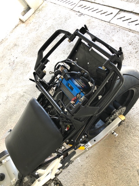

  12. Well, yesterday was a big day. After getting the ST4S loom rerouted and with extending a few cables all the electrical bits are now in the tail. I’ve added a shido lithium battery in there too and it all fits nicely.
    I have a standard Hypermotard 1100 ECU so I plugged it in and sure enough with ignition on, the fuel pump primed. A press of the starter and she turned over. A few quick checks, another press and she started!
    Quite an amazing feeling after such a long journey.
    I now need to work out what to do with the ECU... I was hoping to get the Hypermotard 5AM ECU flashed with an ST4S map but I’m not sure that’s possible? Or, I guess I need a 59M ECU suitable for a 996 engine without an immobiliser?

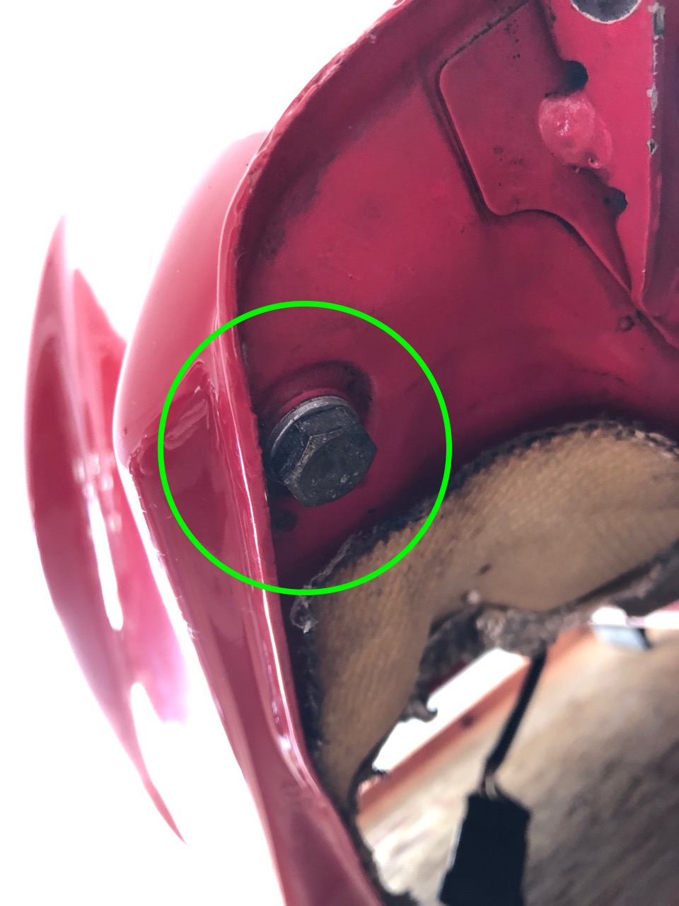

  13. Also had a leak from the fuel tank, theres a bolt at the back underneath and it seems to be leaking from there. What is that bolt for ? Maybe I can remove it and add some kind of sealant around the thread ?
  14. It's so you can drain tank down....
  15. Agree, just a drain - didn't think the ST's had them.
    Just remove and seal with gasket or suitable sealant, job done :upyeah:
  16. Thanks for the replies, I'll give it a dose of Loctite 242
  17. The washers are cheap enough as they’re probably the same as the sump washer - an aluminium crush washer.
    For a more elegant solution theres always dowty washers.
    What size do you need?
  18. Stein Dinse list it as P/N 85211971A, size.. 8.5x14x2 common to a number of models.

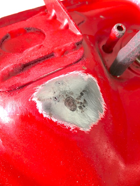

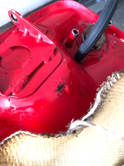

  19. mmm, seems I have another leak, this one a bit more serious...
    Whats the best way to fix this?
