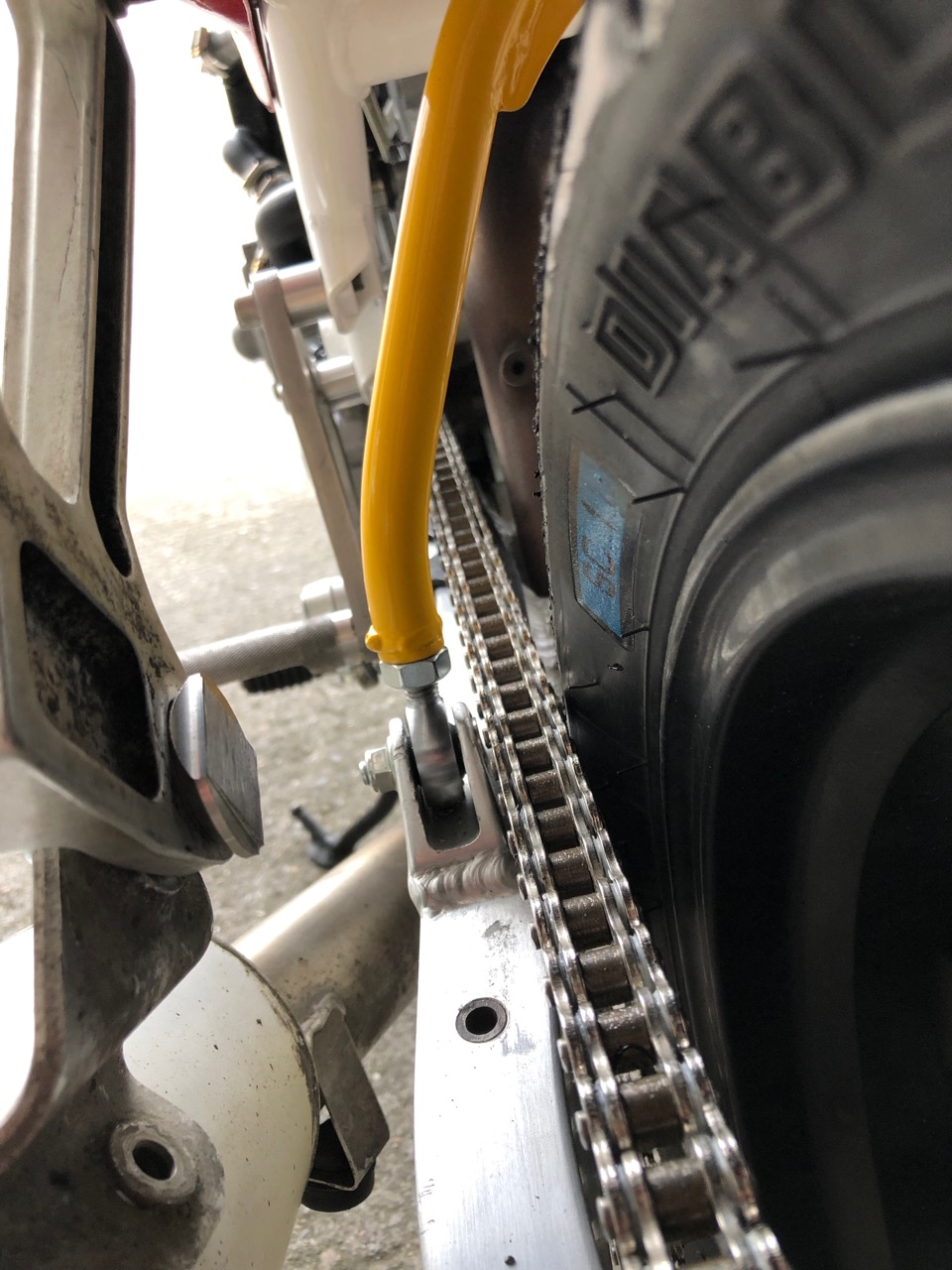

  1. Progress on the chain alignment yesterday, some extra lock washers were modified to become spacers and all good, clearance a little tight with the 180/60 Pirelli Supercorsa rear so I might need to change that for a 180/55 later on..
  2. Is a 180/55 any narrower?
  3. Apparently, the profile means it sits differently and therefore a little narrower (as well as less tall)
  4. Theoretically still 180 mm wide though, maybe worth considering a 170 tyre?
  5. It appears the 170 is no longer available (in the race tyres I use)
    The chain was fitted by Jason Griffiths yesterday and he knows about tyres (Pirelli UK race manager)
    He was confident a 180/55 would give a little more clearance
  6. It shouldn’t be, but that doesn’t mean it isn’t.
    Worth a punt as recommended.
  7. Every day is a school day - cheers :upyeah:
  8. I know! I wouldn't have thought that either

  12. Happy enough with the chain alignment for now

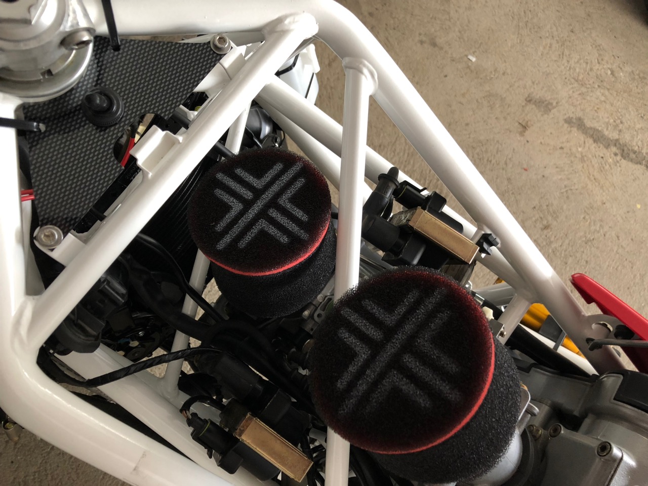

  13. Going to run with these filters for now until I have some time to make an airbox

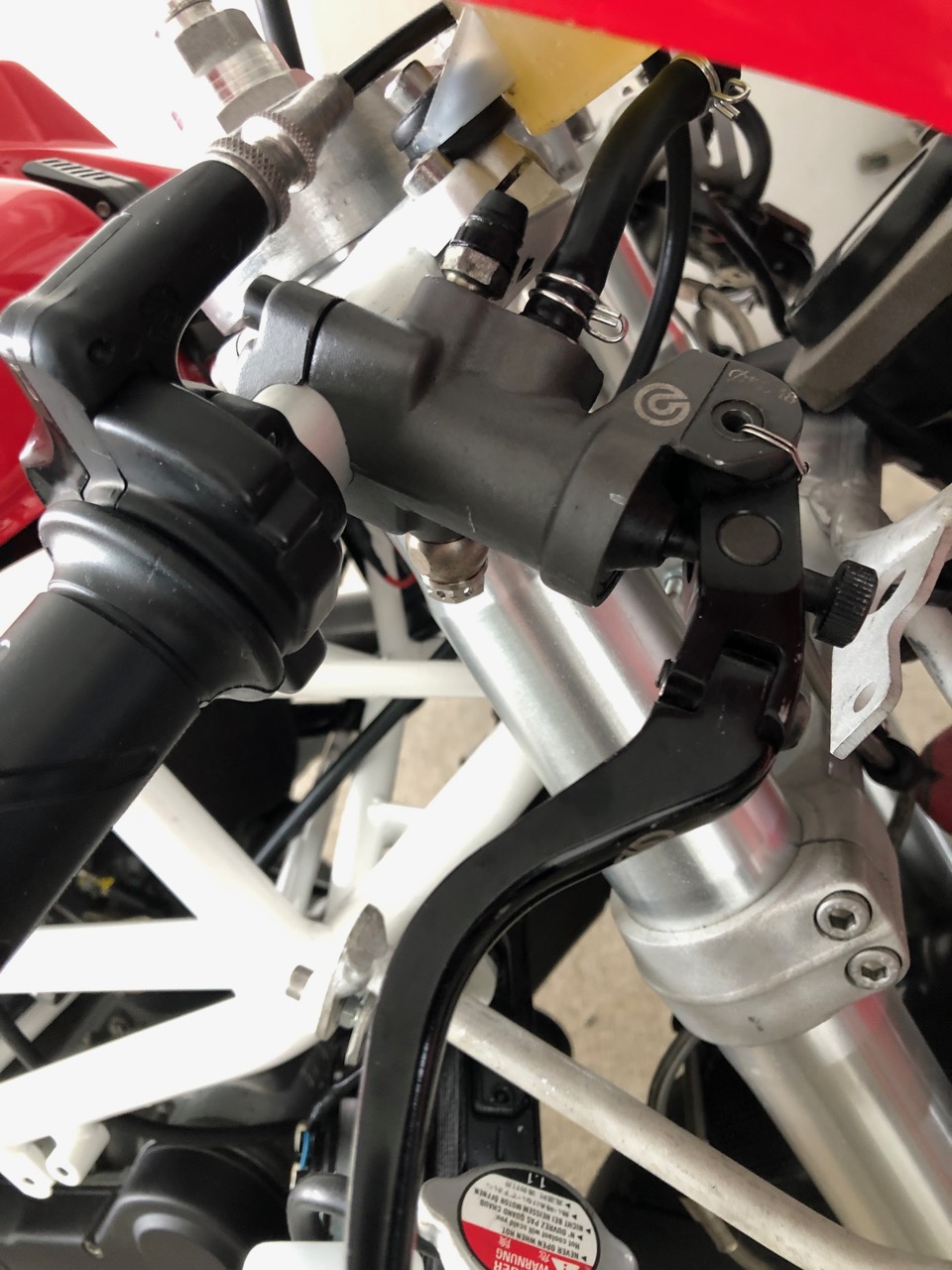

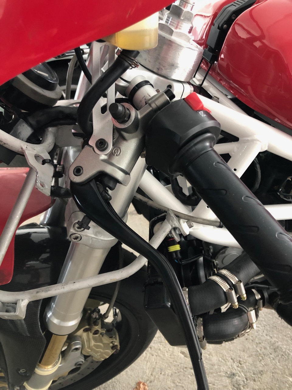

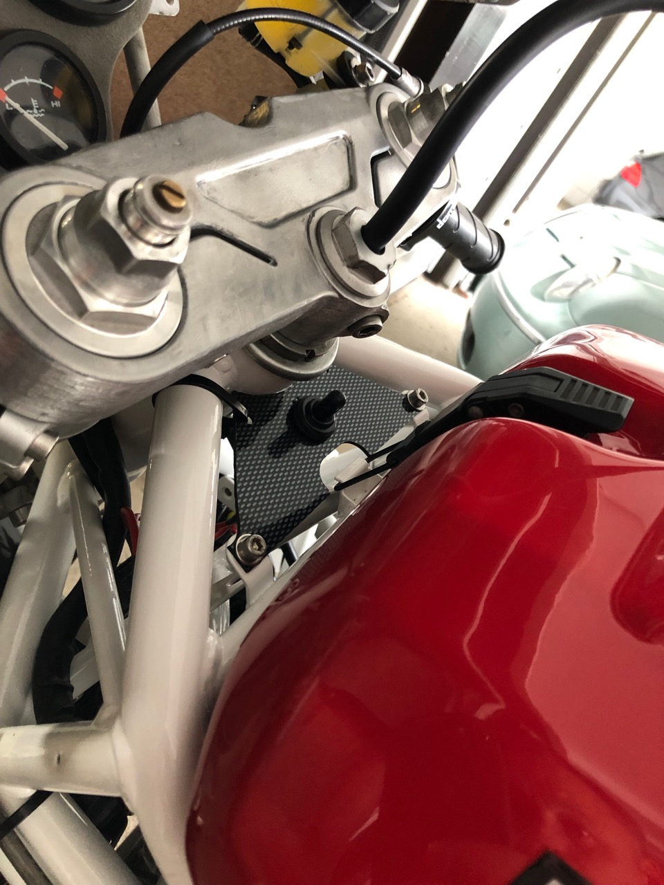

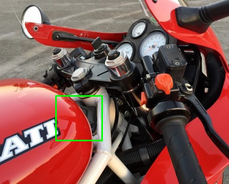

  14. 19X18 Brembo racing master cylinder installed
  15. The Brembo Front Brake master cylinder takes up quite a bit of handlebar space so, this required the stop/start switchgear to be moved to the L/H handlebar. At the same time I installed a 1098 radial clutch master cylinder

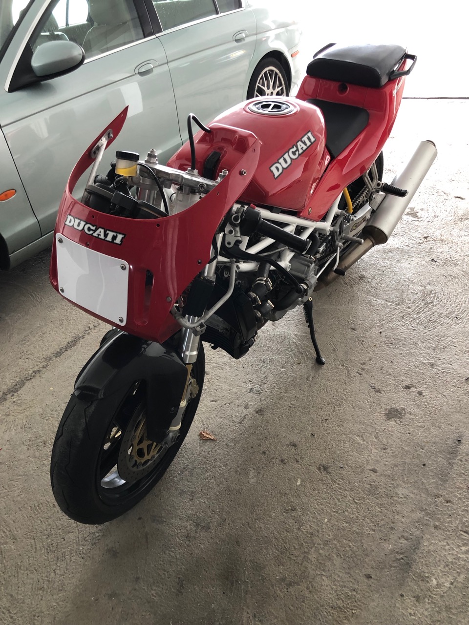

  16. Token gesture of a fairing until I sort out all the scrappy bodywork and get it repainted
  17. Taking shape, exhausts are still killing me though..
  18. It’s looking good:upyeah:

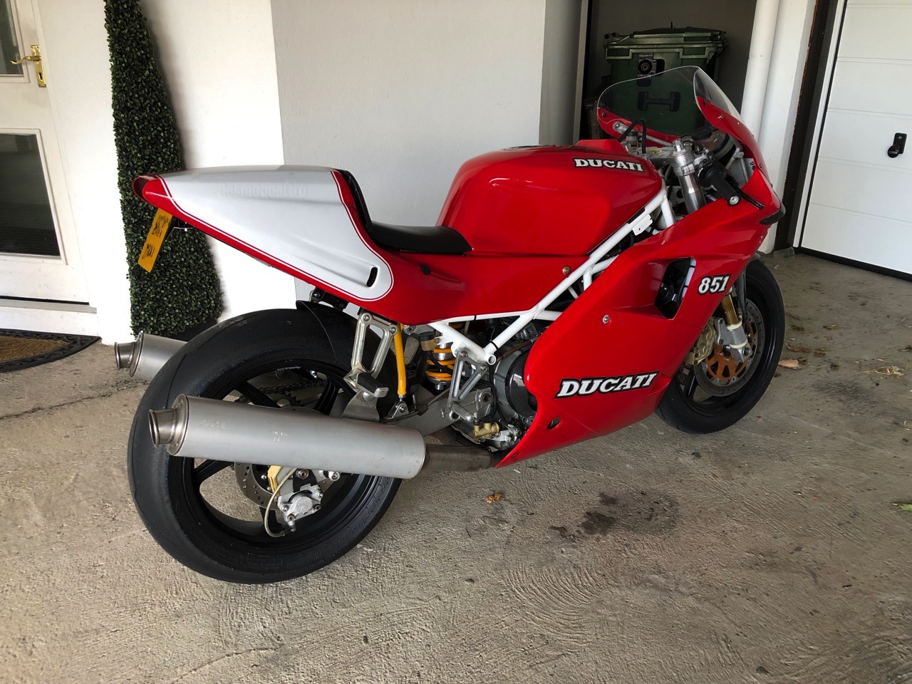

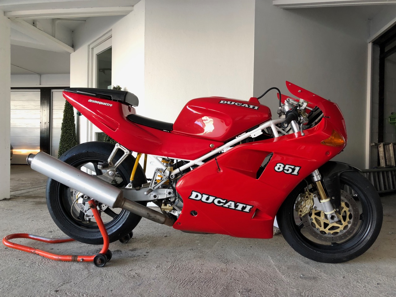

  19. So, after a few niggles including warped discs the bike passed the Manx vehicle test and I have been out riding throughout the MGP / Classic TT. Even won an award at the Italian bike night which is nice!
    Over the winter I will sort out a few minor issues and perhaps have a go at making an airbox although the bike runs great on the pod filters
    So for now a few finished pictures..
