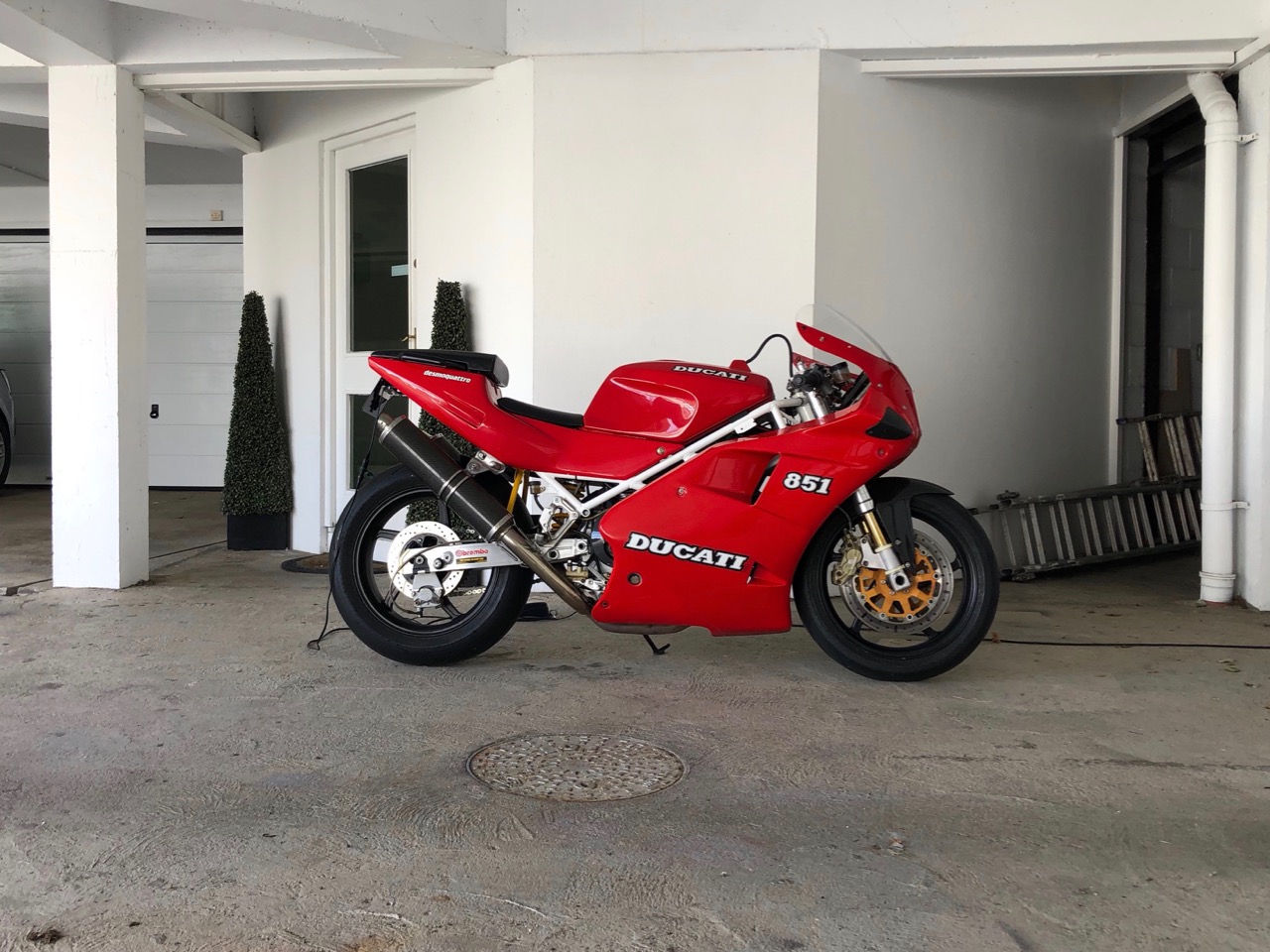

    Looking into options, OEM, Newfren and even GS650 friction plates can work apparently!

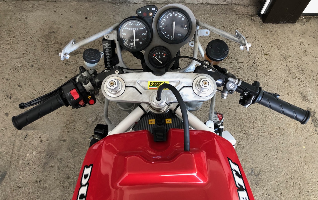

  4. After struggling with wrist comfort I fitted some Gilles Variobars, huge improvement

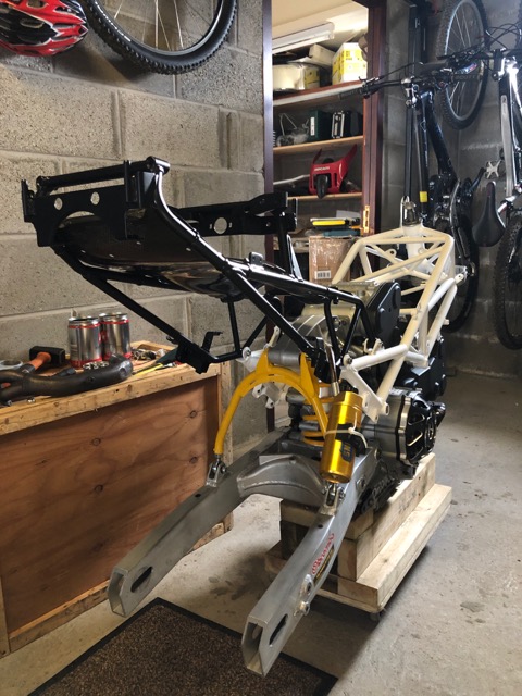

  8. Hey Darko,
    Great thread, very nice job you did.
    You did powder coat the frame. Do you remember which color you did and why?
    Thinking of powder coating the frame of my 851. Some people state that OEM color was very white like RAL9016.
  9. Thanks @Jakepeewee !
    From memory we discussed this and the company suggested an almost pure white (after trying different colour swatches) sorry I don't have an exact RAL code though..
