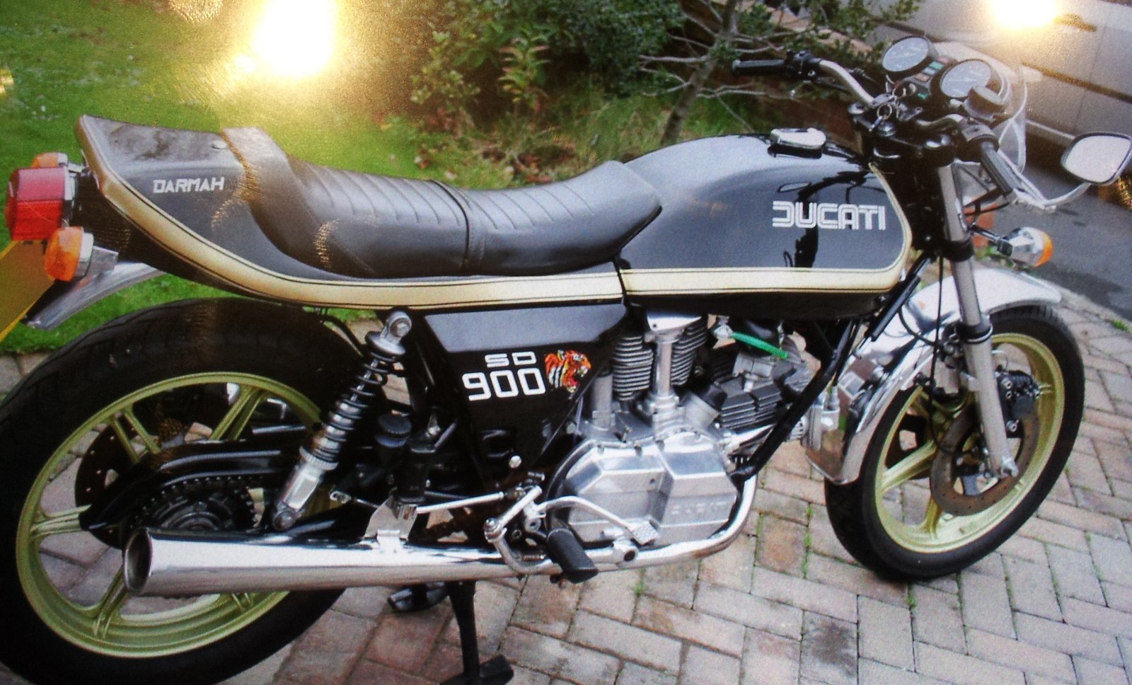

  15. Wow !! 1978, 14,000 miles, what a beauty. Should I upgrade to a modern ignition system, or is the Bosch OK ??
  16. Could we have a peep please?... and if its running ok keep it STD.....
  17. can you see this ?
  18. I am going to mid-Wales to view on Wed AM. I understand that it has been run only twice in the last year, and then not at all for the previous eight ! Might take a few covers off and squirt some oil down the drive tubes and a little in the plug holes and a good few kicks before trying to fire up.
  19. Already done.
